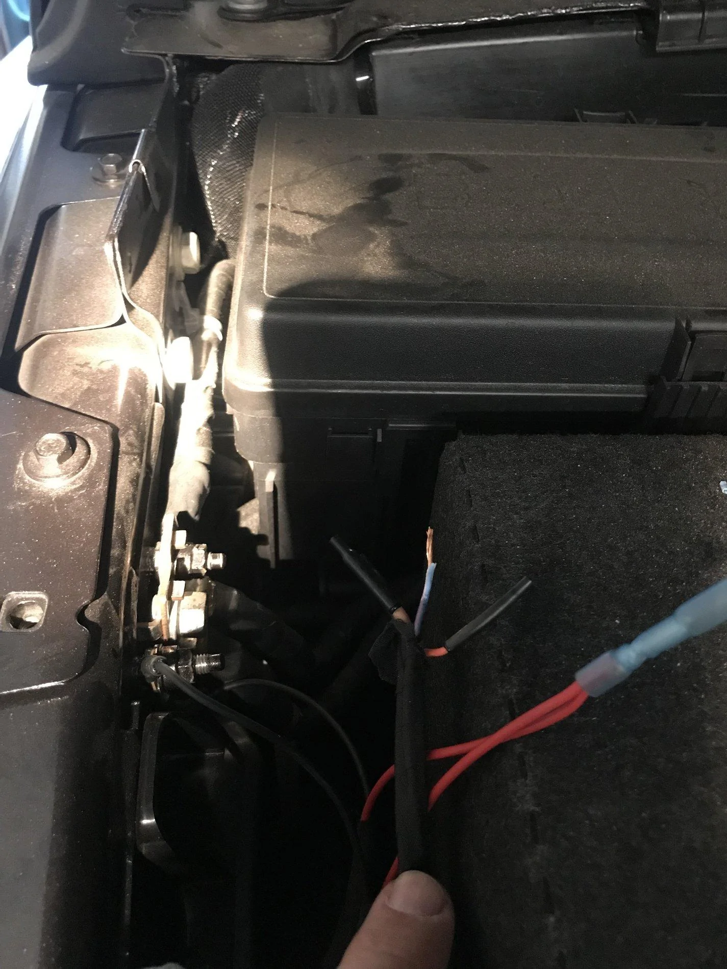

Jeep Wrangler JL Mopar 7” light help AB32D98A-D888-4D21-8F48-E40A7D8C8BF5
I wanted to post a pic of what has been done. I pre spliced the two lights together and grounded to the bolt on the left. I’m just now sure in my #4 pink and blue wire can handle the load. Thanks a ton in advance for any help. I hate electrical!

I used the pink and blue as well. For the mopar lights they require aux 3 or 4, which is the orange or blue//pink.

These lights do not have an inline fuse and aux 3 and 4 are 15amp vs 1 and 2 which are 40 amp I believe

Yes that is my understanding also. I used aux 3 and works great! those lights are crazy bright and well made. Expensive but now that I have them, they are very nice. Thanks for the advice!

Page 183 of the owner's manual shows the wire colors and amps per switch. Thanks Sloxkhart98 for your help.
