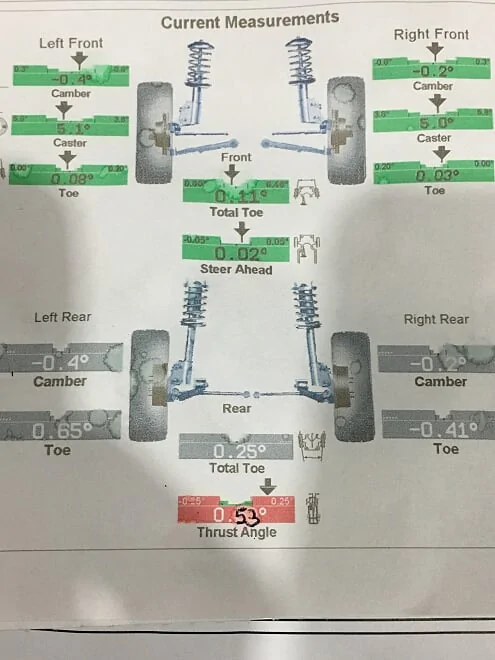

Has anyone measured the actual length of the springs on the Mopar 2" lift - part 77072395AB?
I'm specifically trying to find out if there is a difference with the rear springs. The way that I read the directions is that:
68414066AA = Left Rear
68414068AA = Right Rear
My installer seemed to accidentally install these the opposite way.
Since having the lift put on I have been having issues with the steering, constantly needing to make little corrections while trying to drive straight - it's worse at higher speeds. I did not have that issue prior to the lift..
I have read multiple threads about this, but I'm wondering if either the rear springs could be an issue or something with my alignment.
As far as alignment goes it looks like this now:
