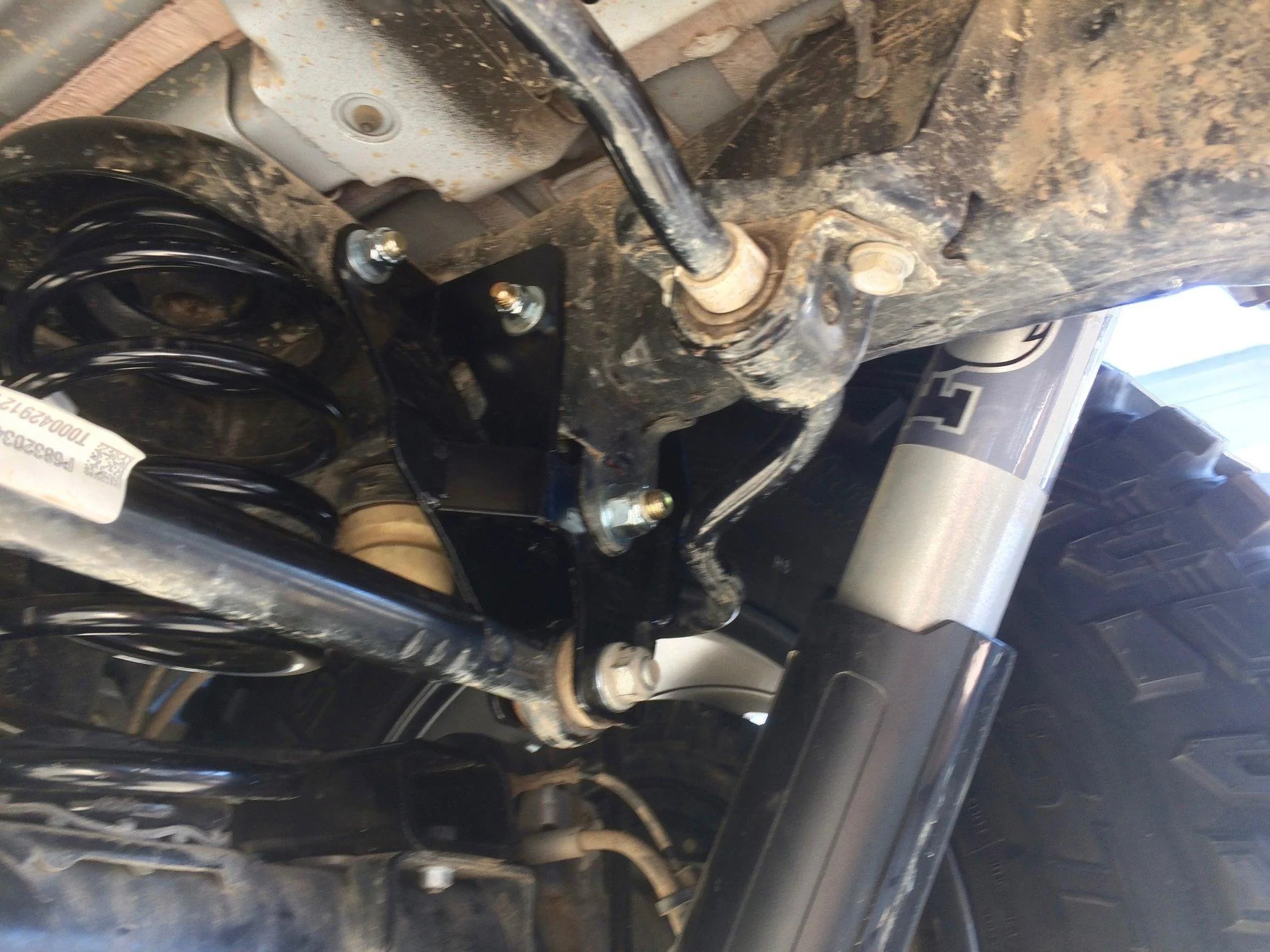

Superlift T.B. relocation bracket was $40 and got rid of an annoying tail wiggle. It mounts not only to the stock track bar bracket but also through the frame and onto the coil spring pocket. It’s not going anywhere...
That is a much better solution for a trail vehicle, thanks for posting.

My Teraflex bracket does nothing to strengthen the bracket-to-axle welding points, which was the weak point on the Grand Cherokees. It may be that the stock JL bracket is inherently stronger (or maybe not) than the Grand Cherokee’s, but I prefer not to be a pioneer in this area (broken trackbar brackets require trail welders to fix) so I’ll switch to an adjustable trackbar.
I guess I need to be more specific.......
Many TB brackets have the availability to strengthen the bracket on the axle by way of a u-bolt.
An adjustable track bar wont keep your factory track bar bracket from tearing off. I have ripped one off myself.
