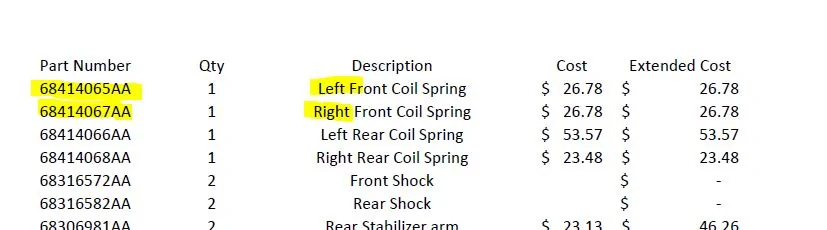

- They did not remove the rear spacers from the previous lift, So the car is 2" taller in the back that it is in the front.
- The coils with the blue tag were installed on the driver side, the red tags on the passenger side. Reading the forum and the mopar lift instructions (which have screwed up illustrations by the way) I understand they are swapped.
- The lower front coil isolators are made of black plastic on both side. The pictures I saw in the forum of the new isolator that corrected the spring bow are grey. Did I get an old lift kit?
