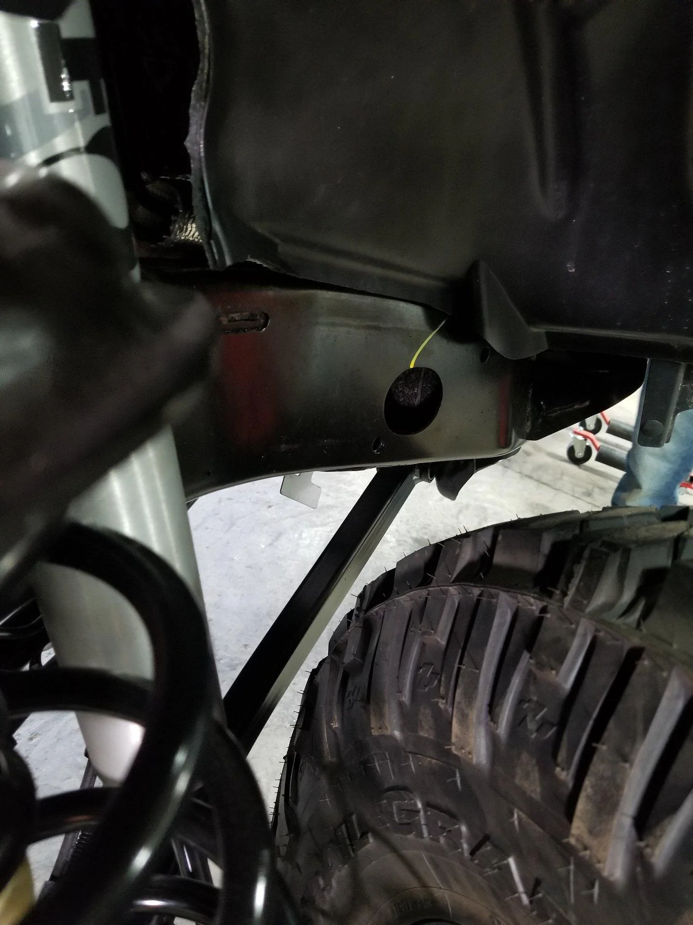

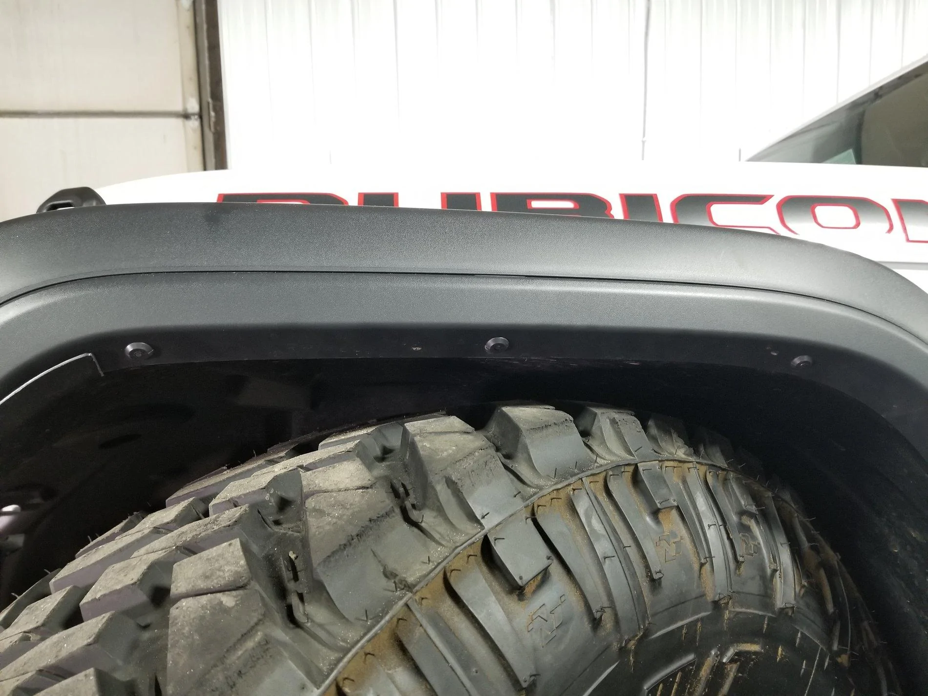

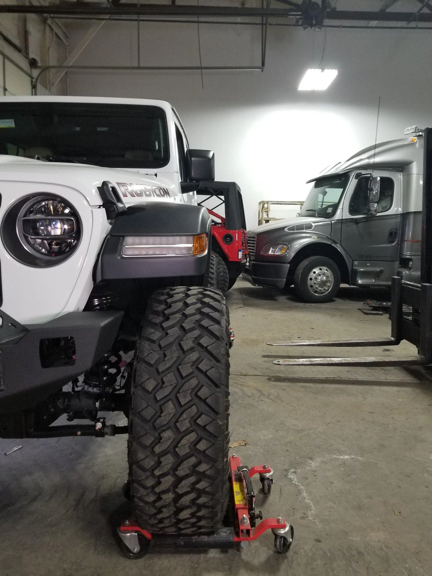

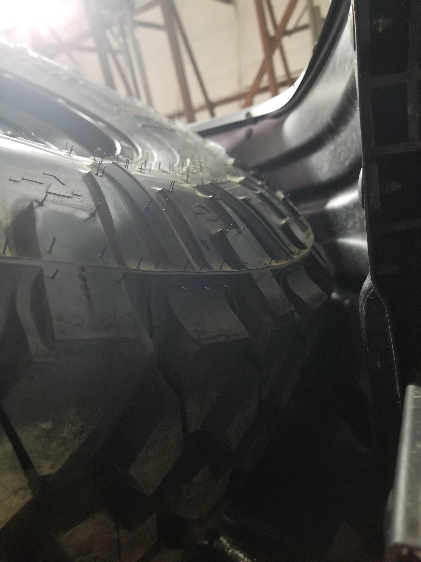

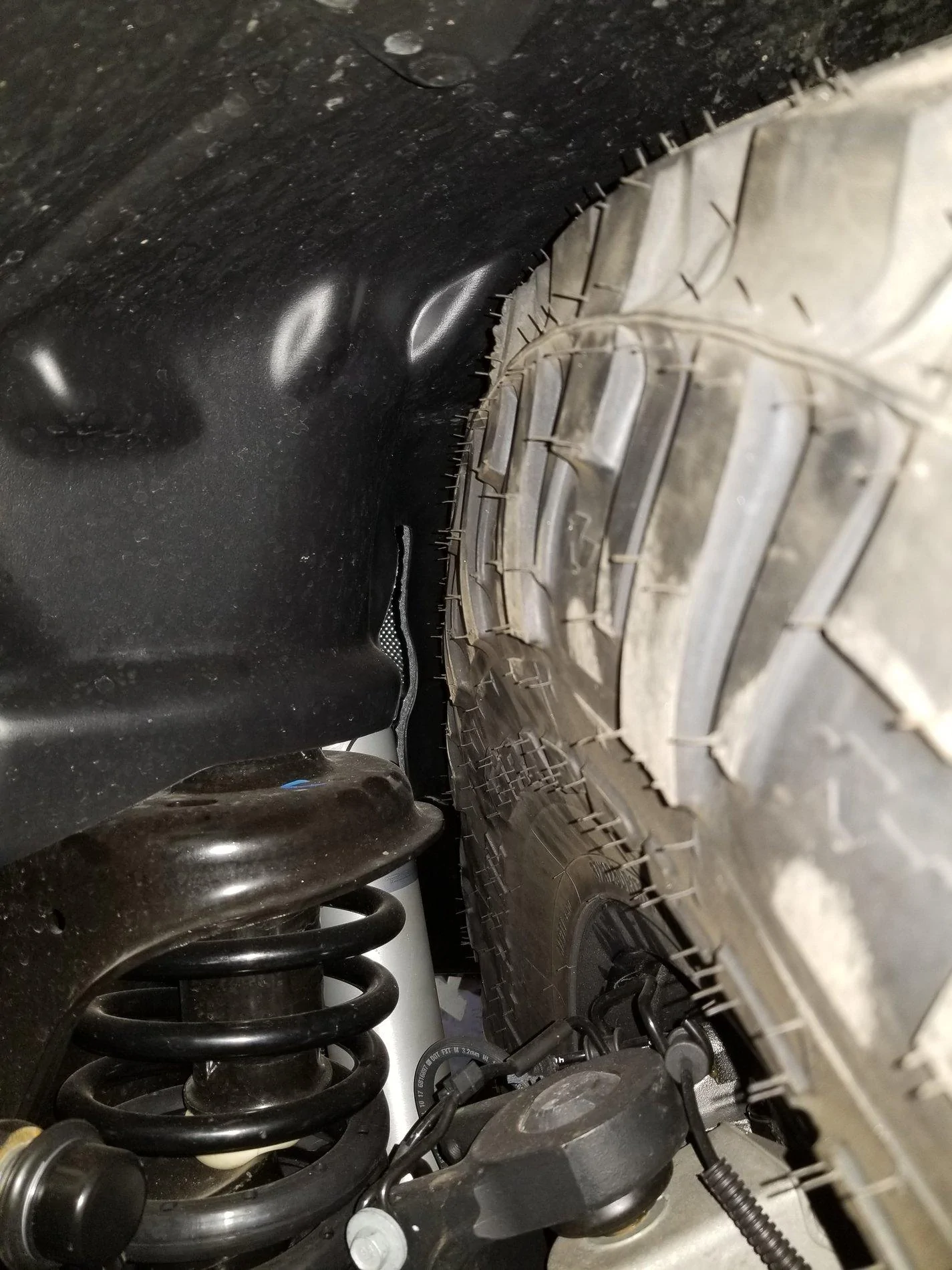

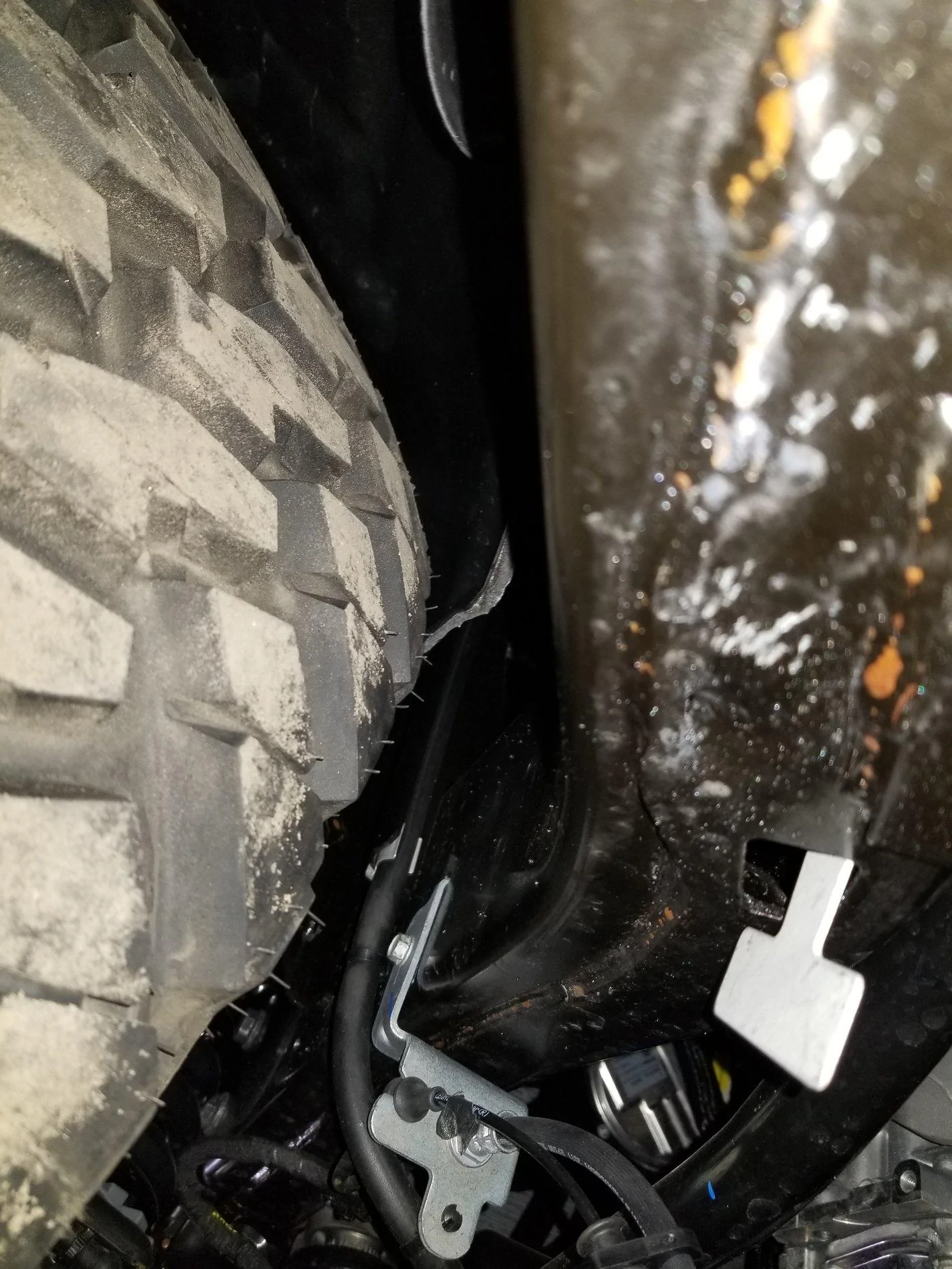

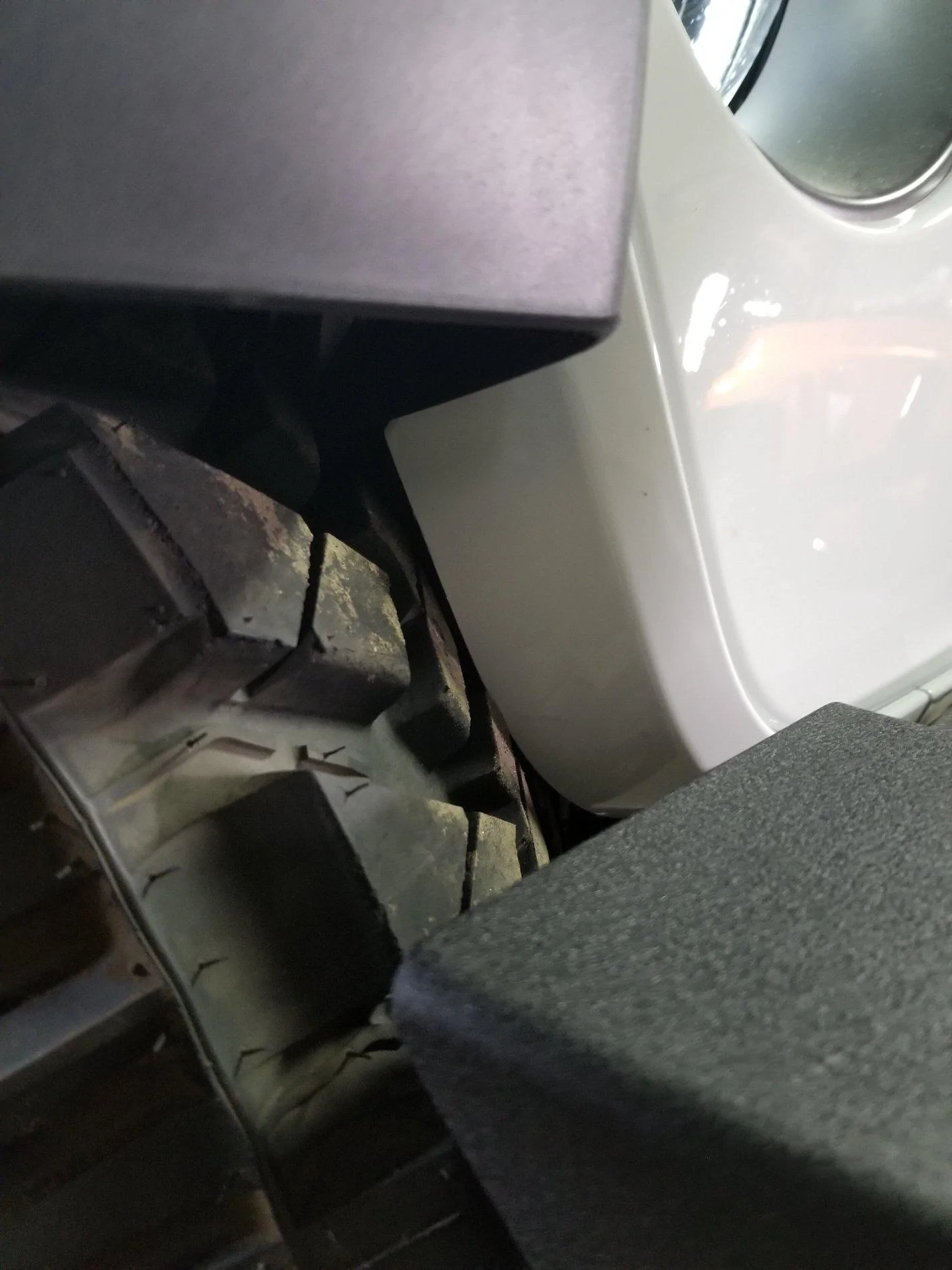

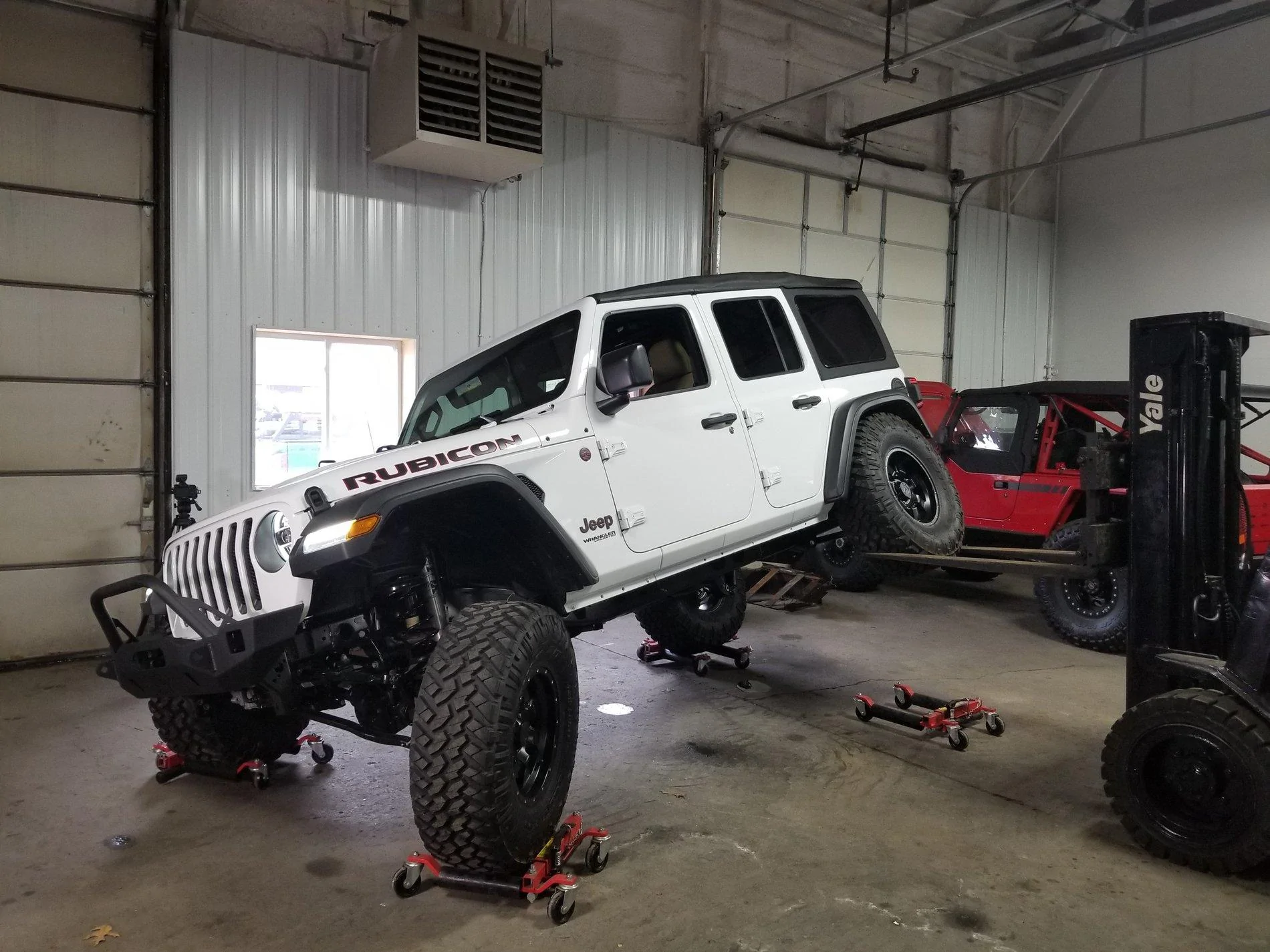

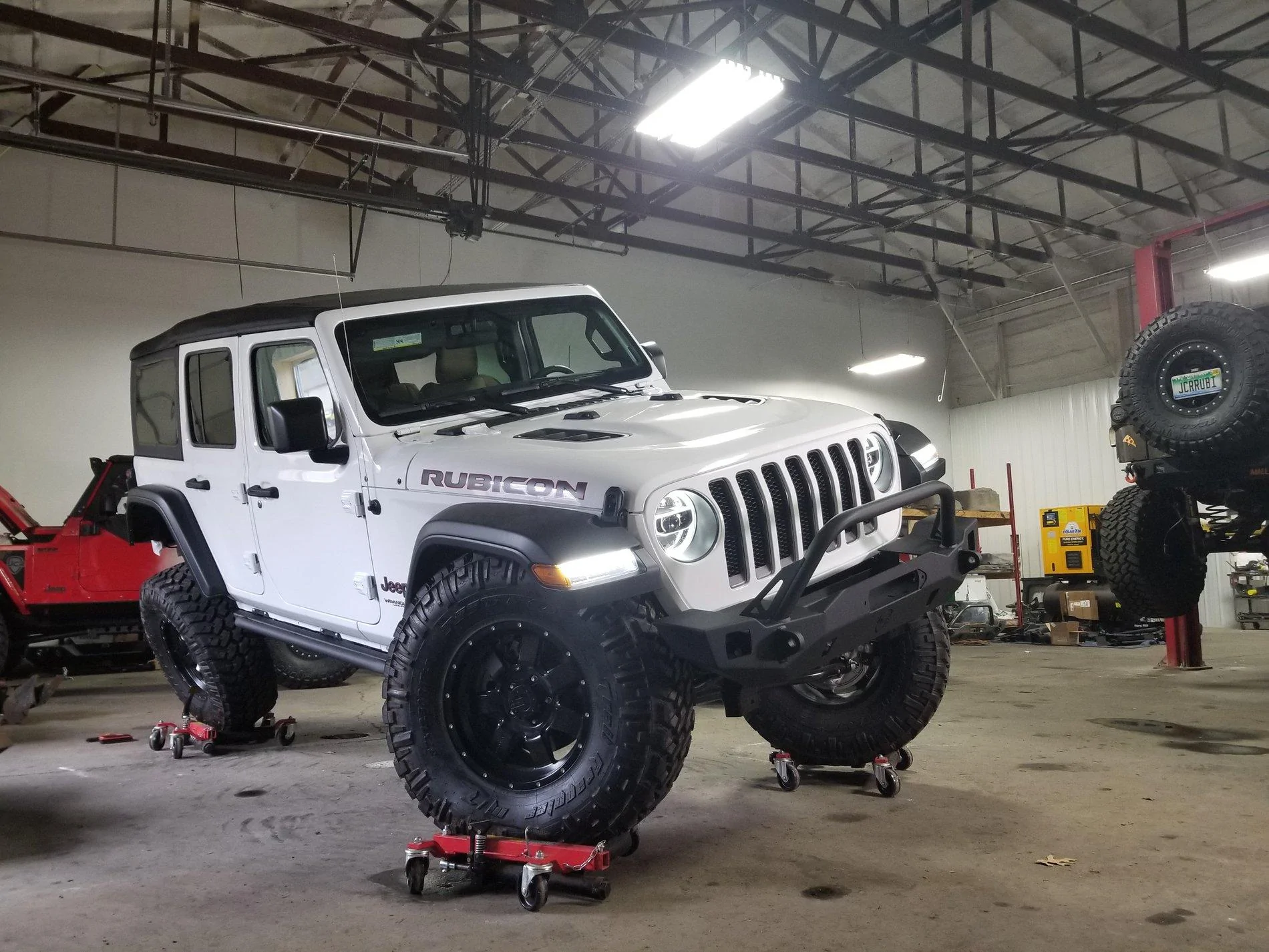

Was doing some clearance testing on our mid-width bumper and thought these photos may be of interest:
- Lift is a Mopar 2" with the kit's bump stop extensions
- Tires are 37" Nitto Trail Grapplers
- Wheels are Mamba M14 Intel 17 x 9" with 5.47" backspacing
