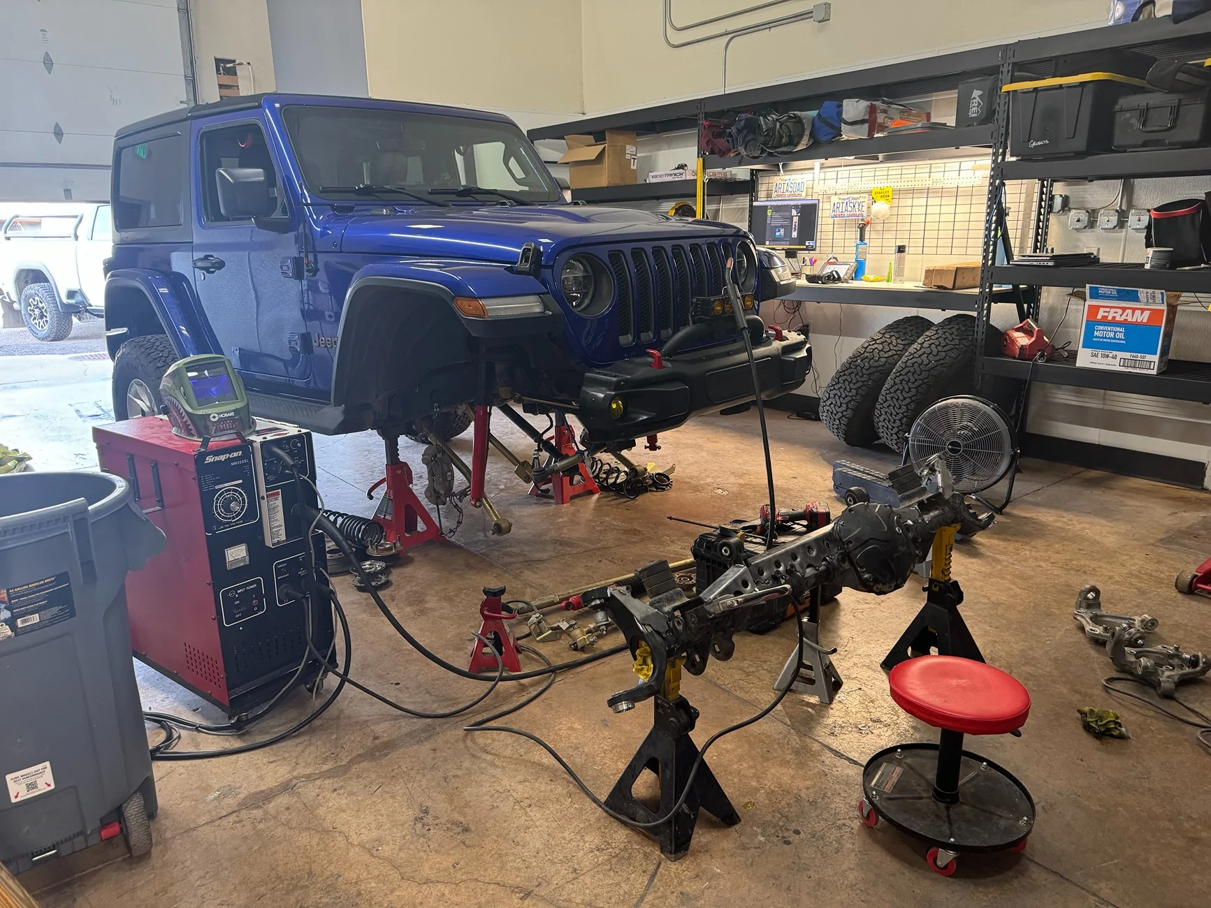

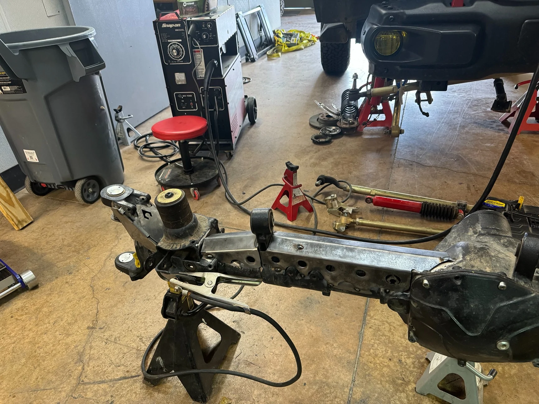

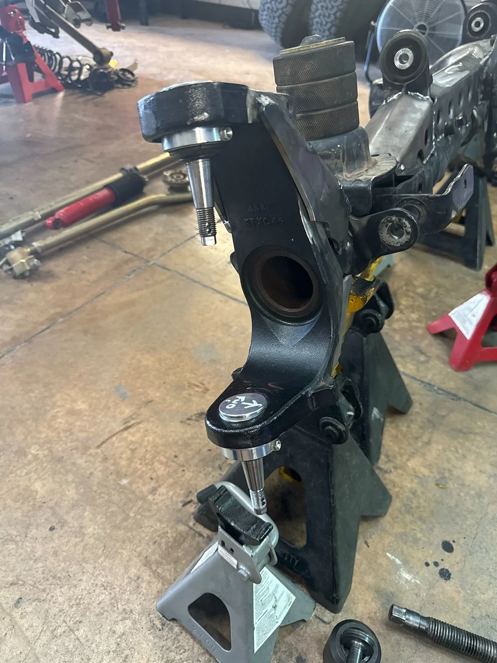

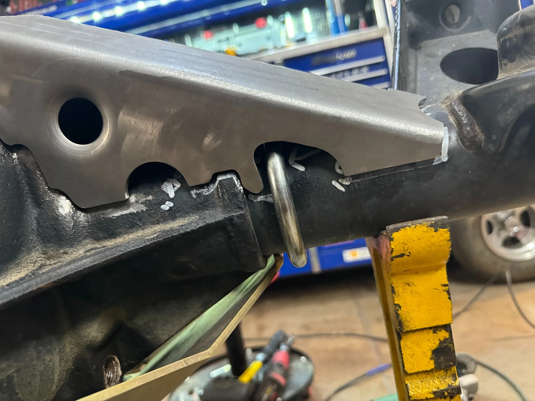

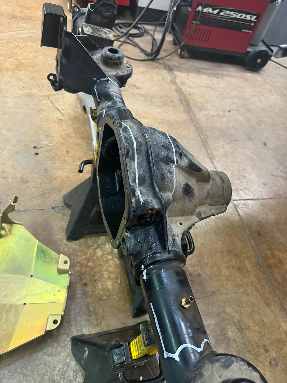

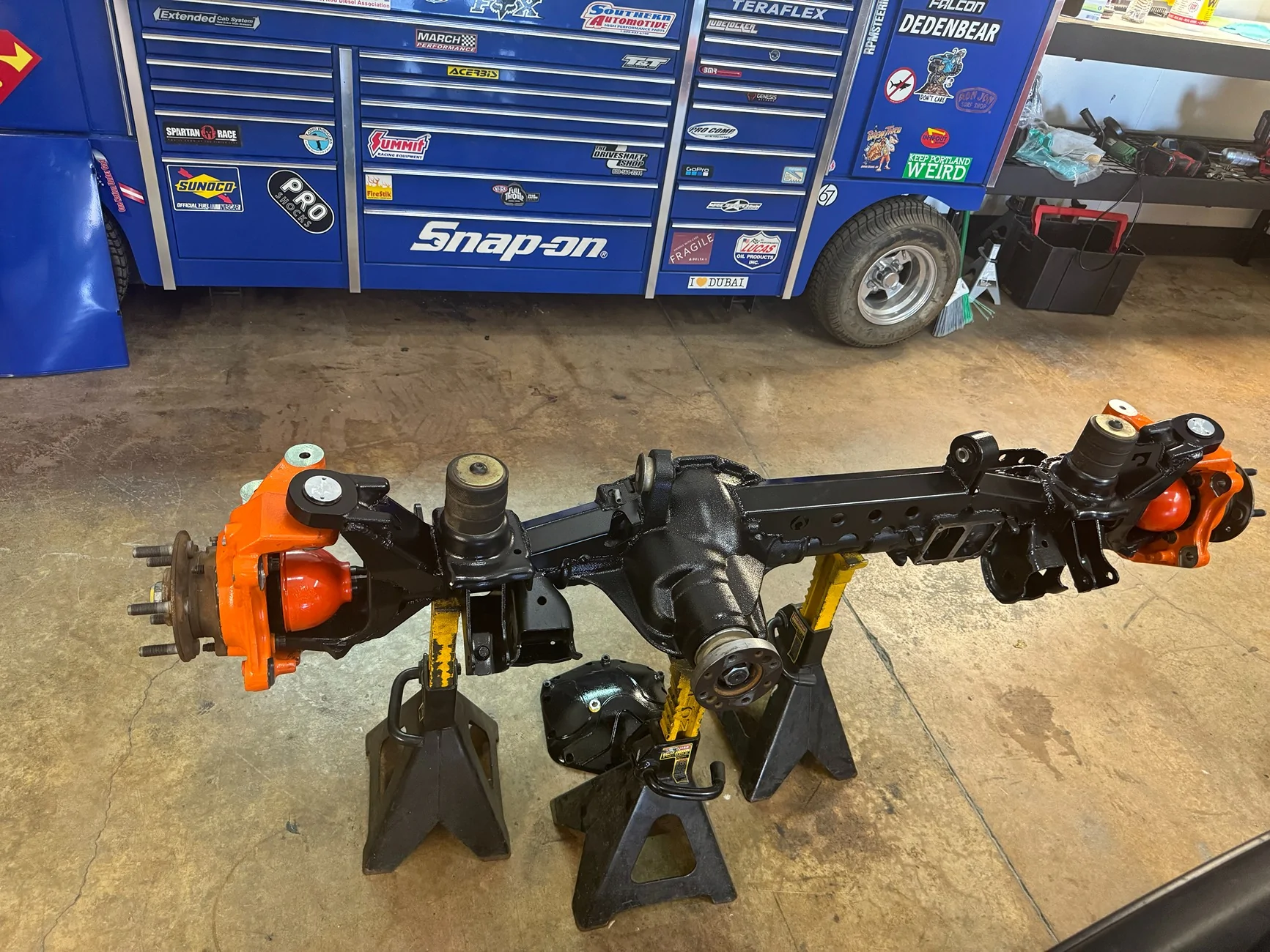

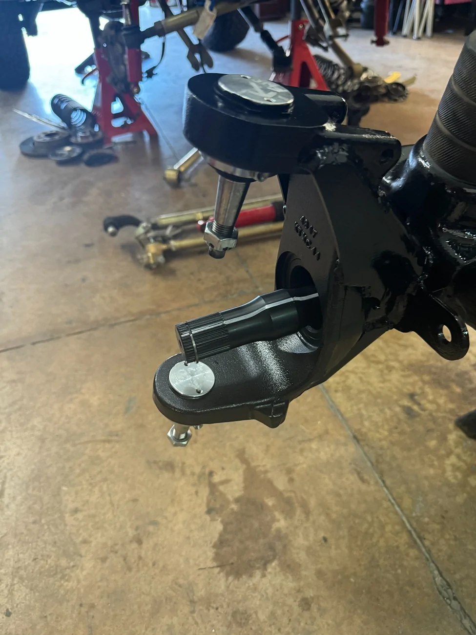

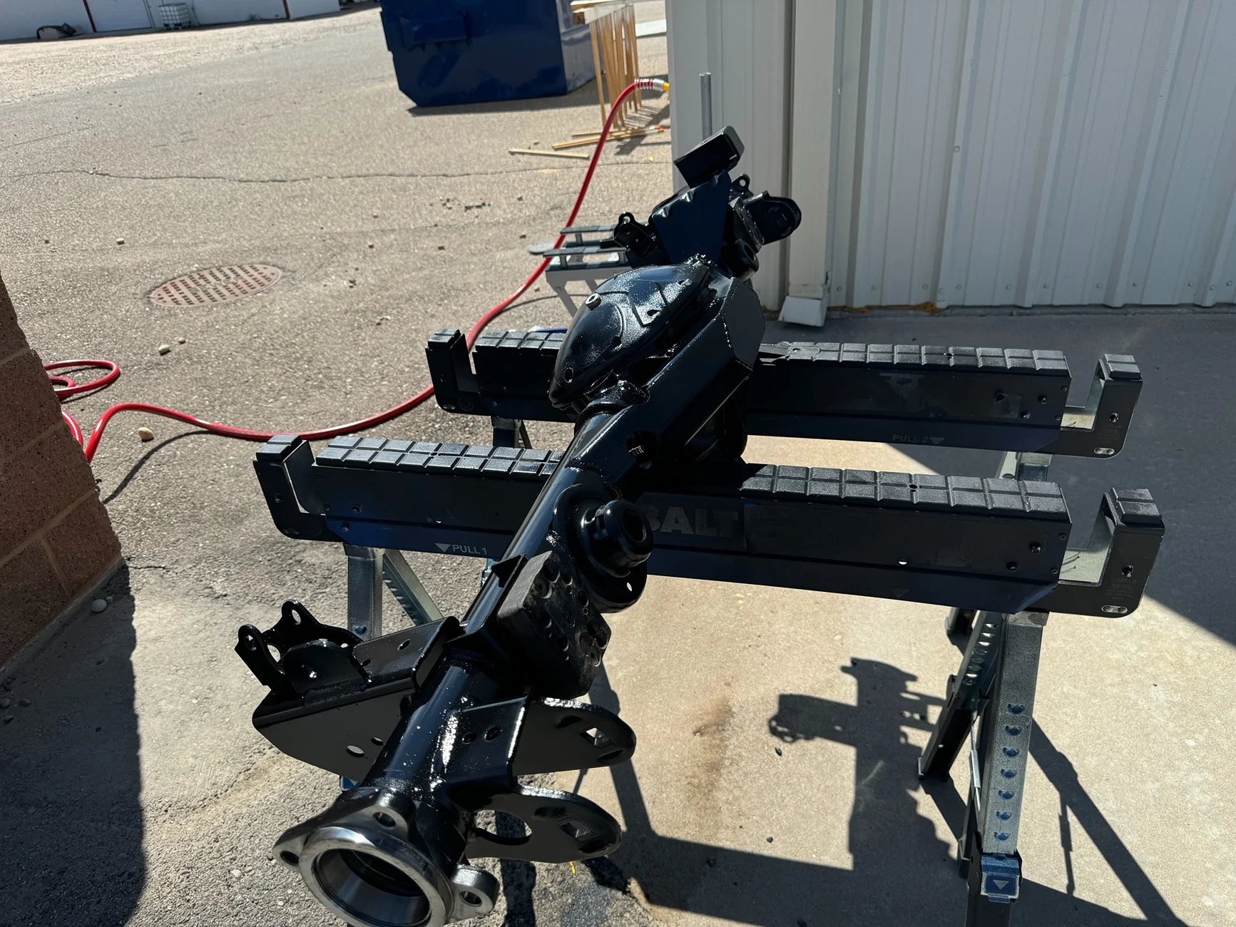

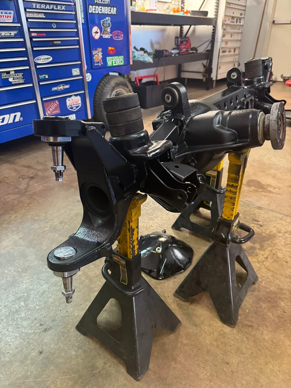

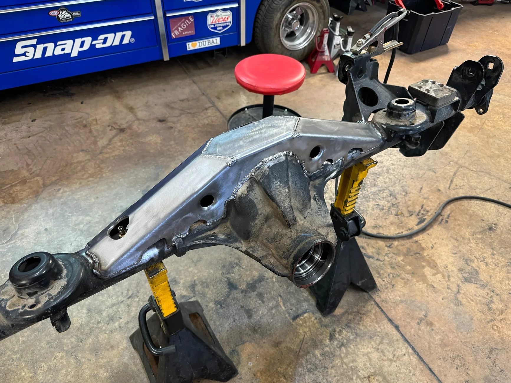

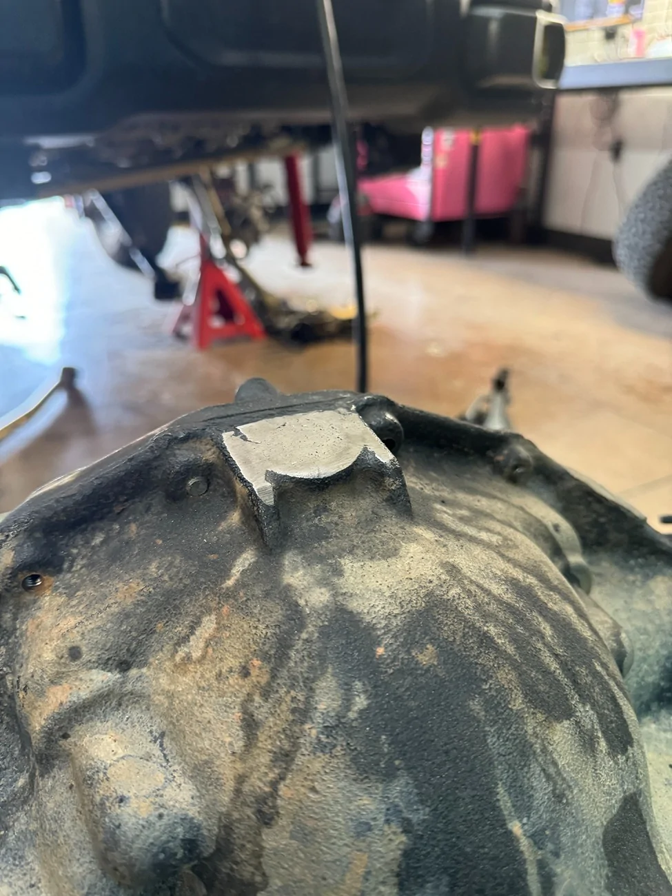

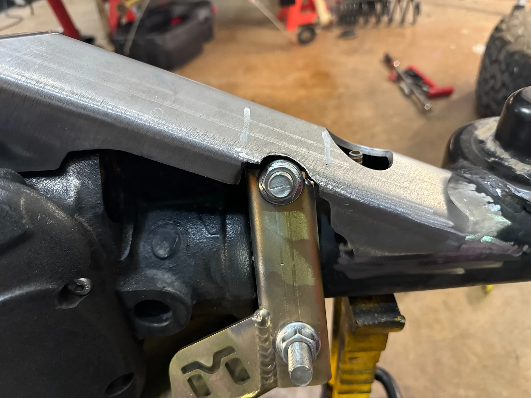

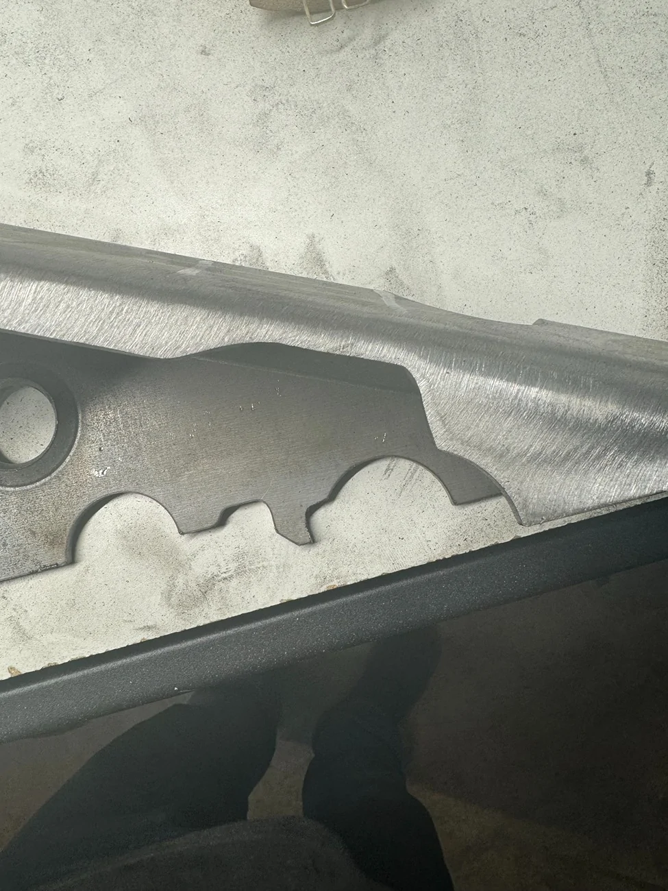

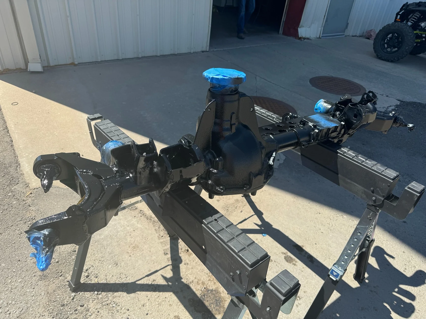

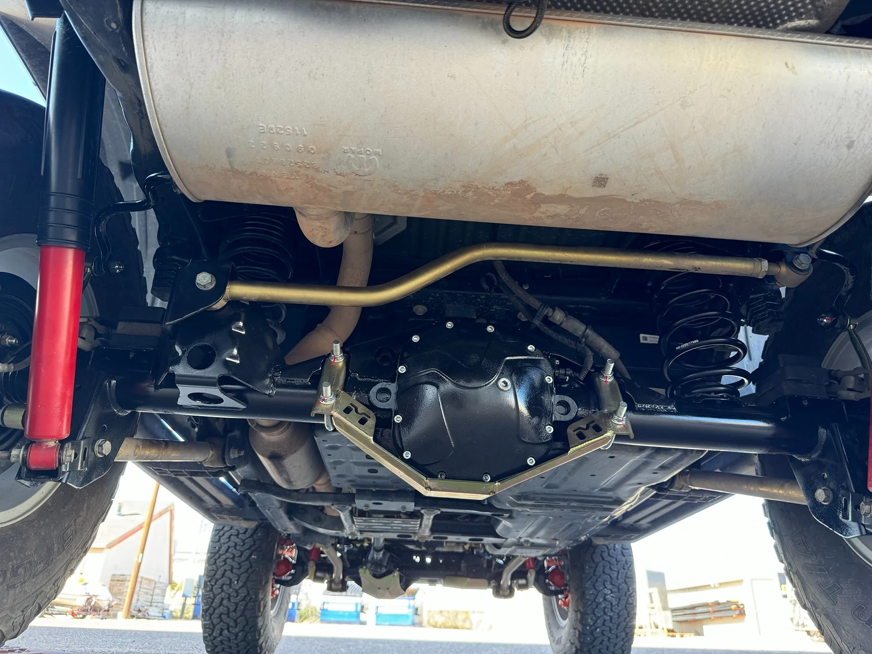

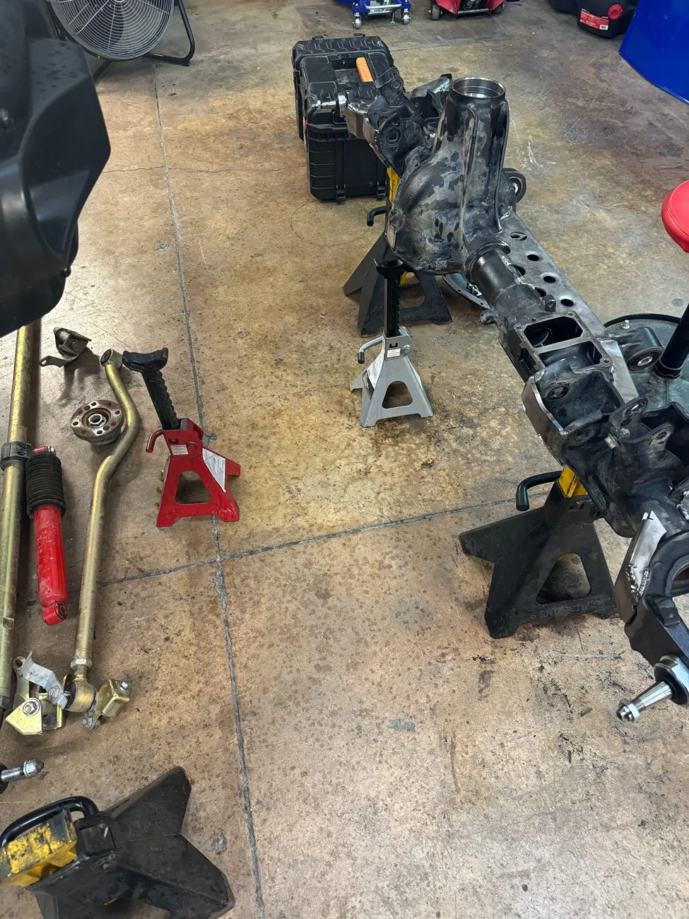

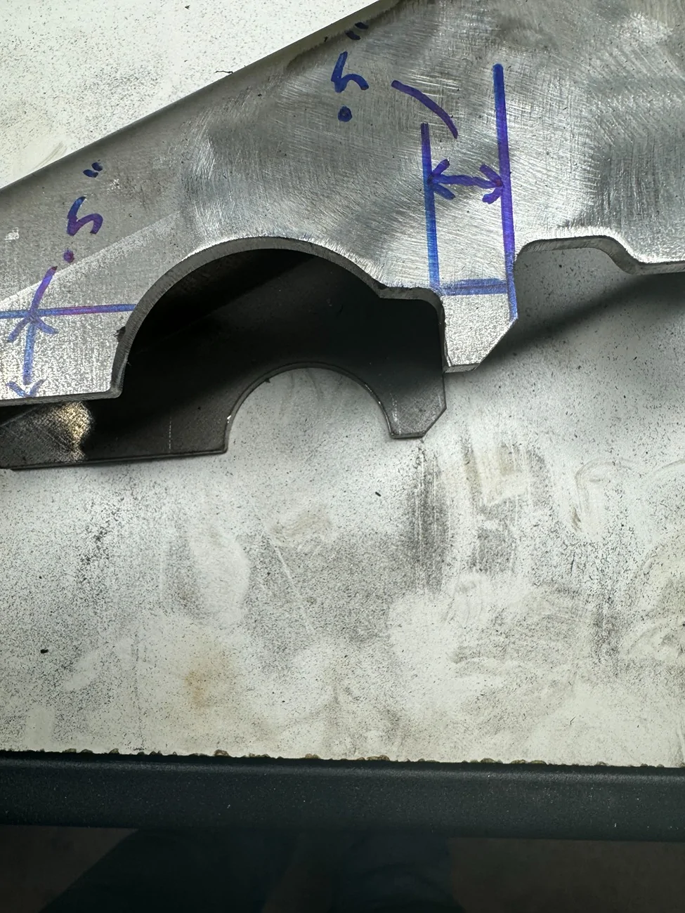

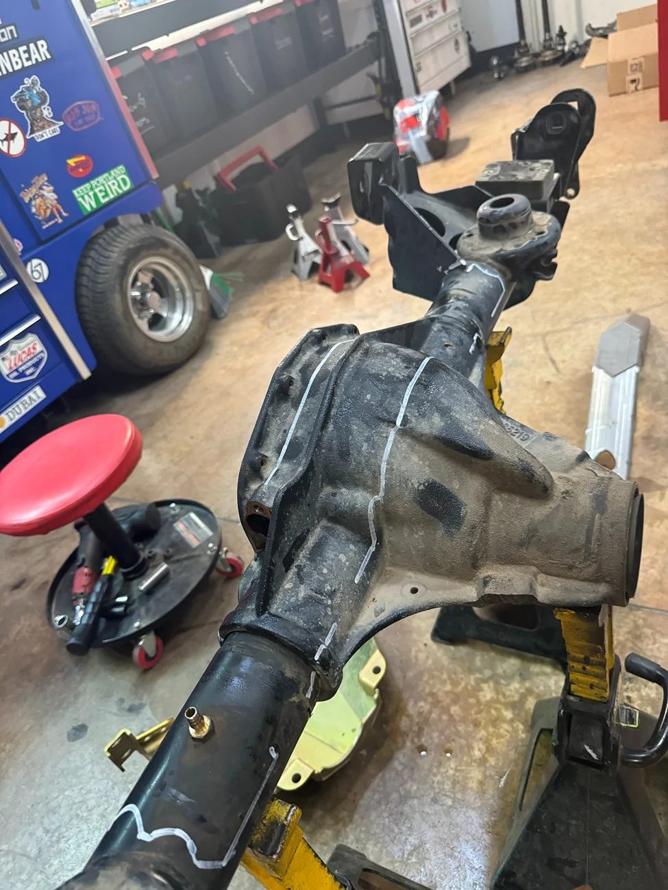

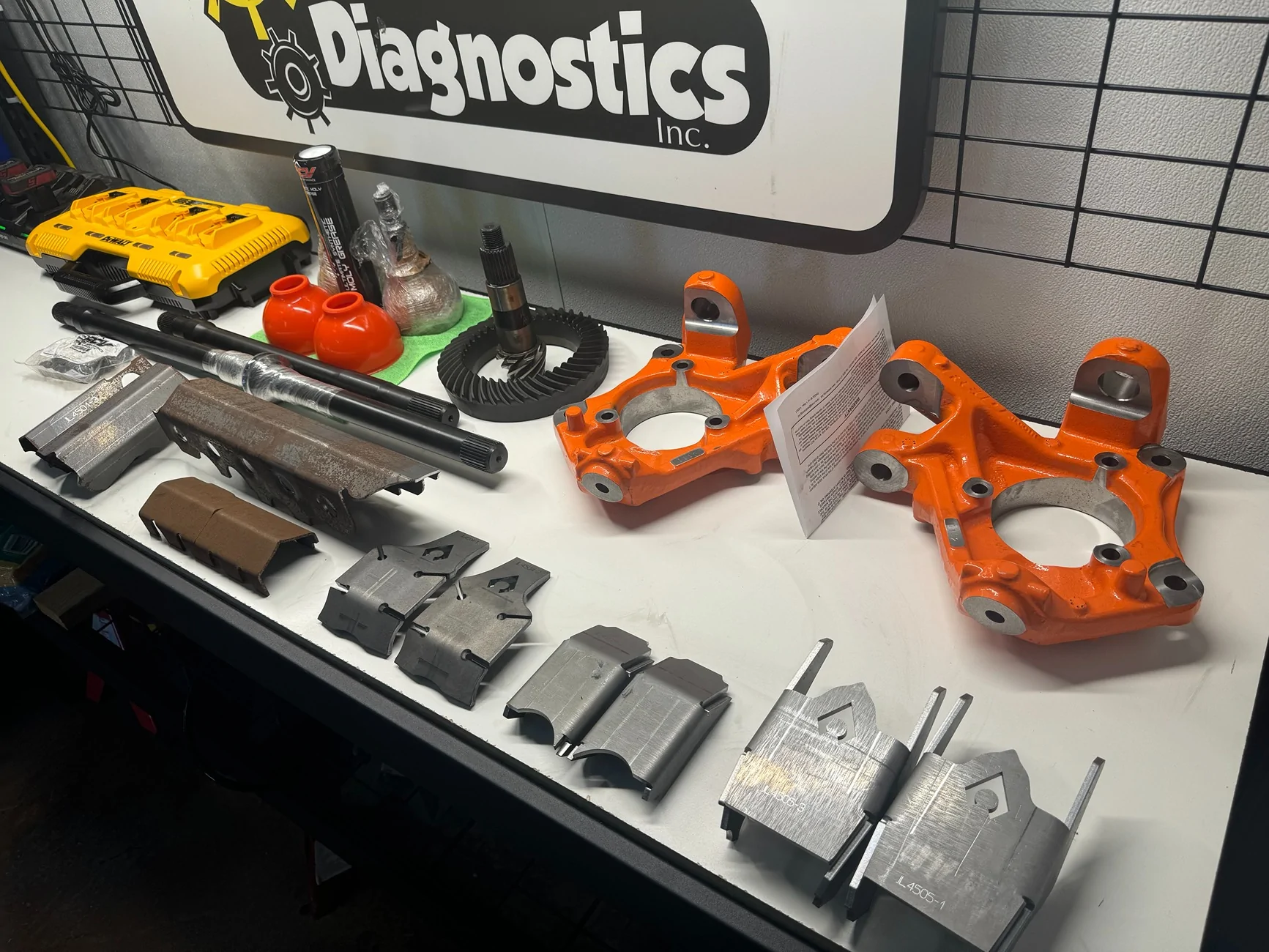

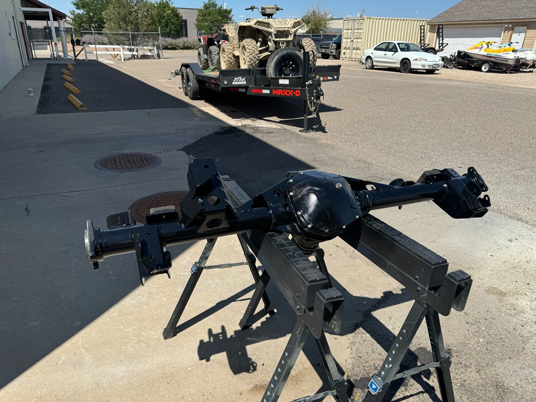

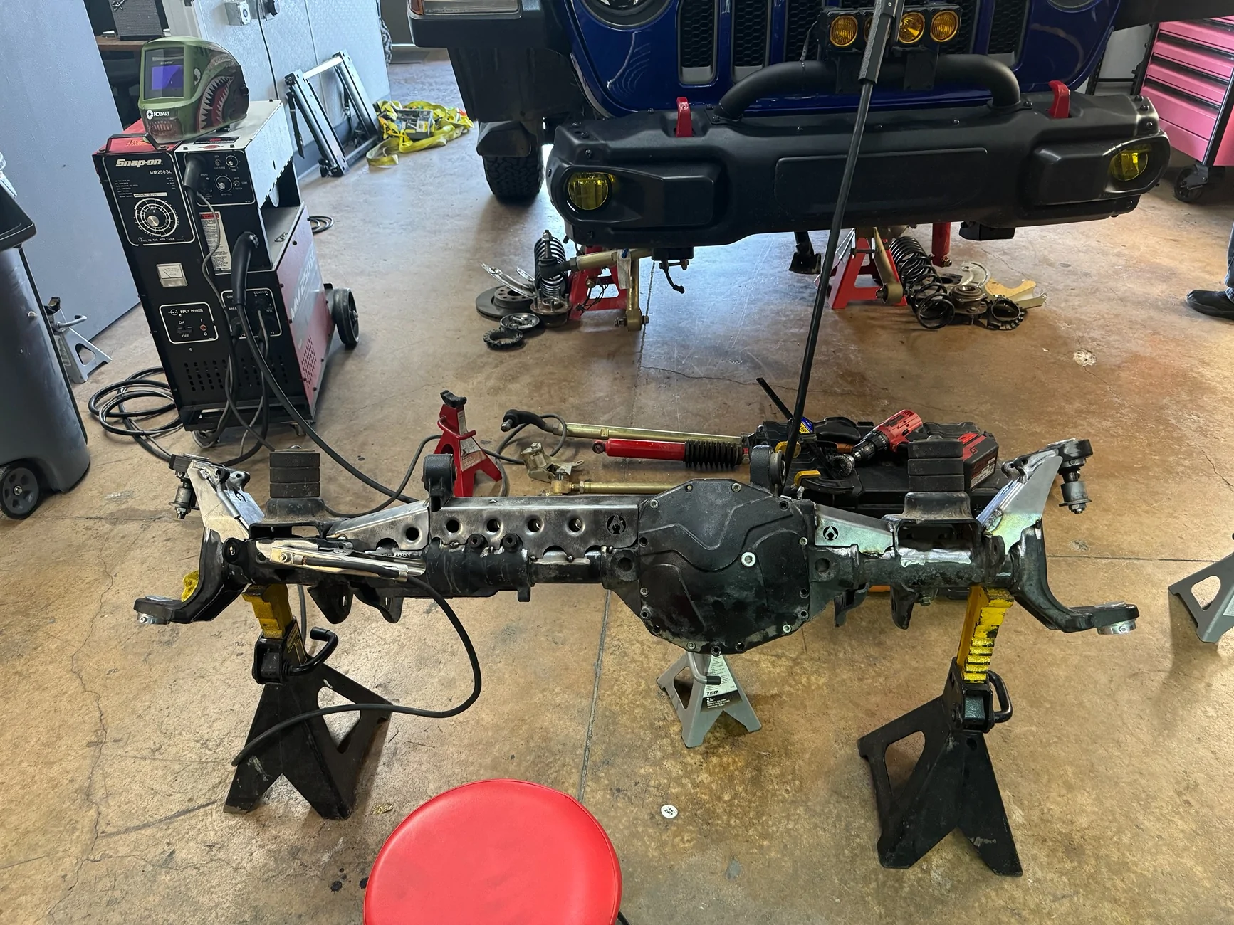

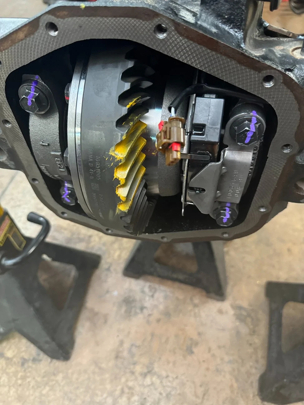

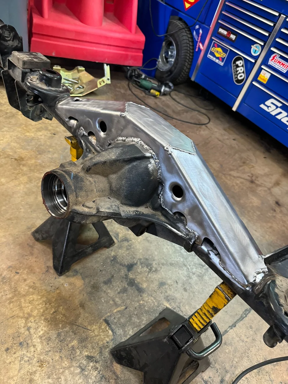

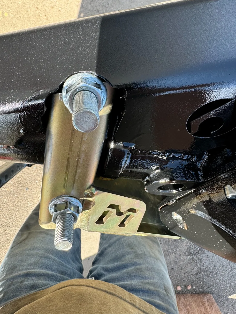

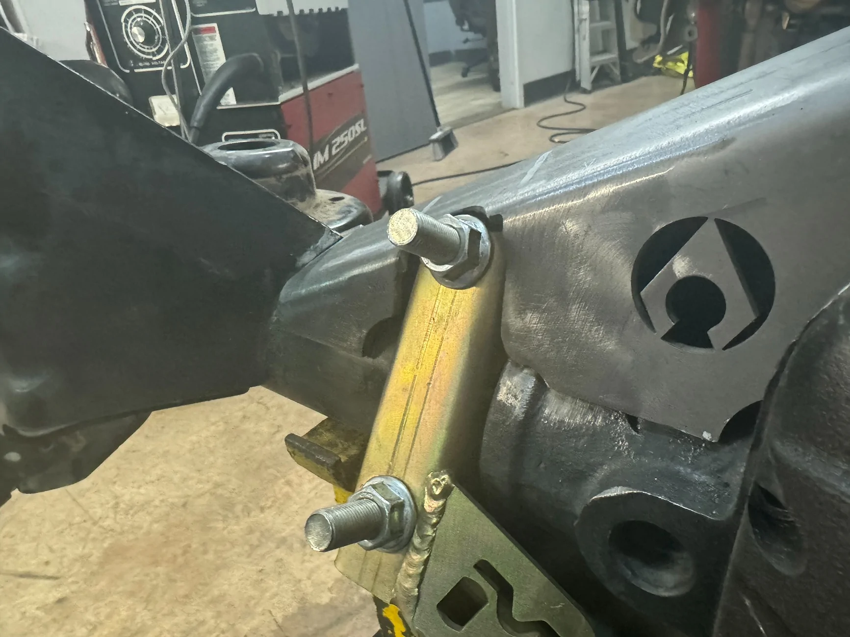

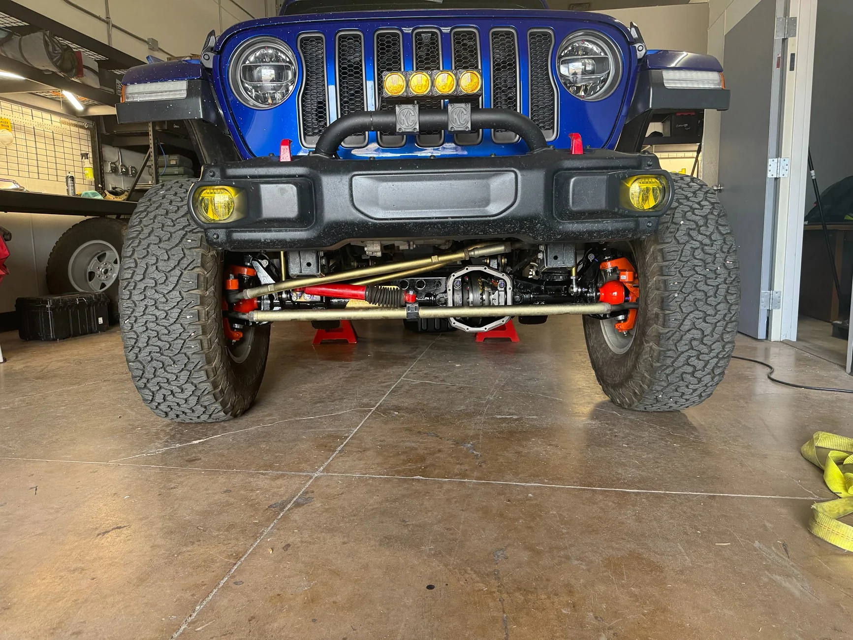

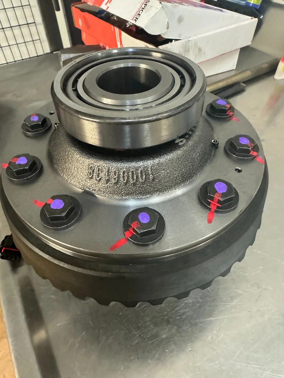

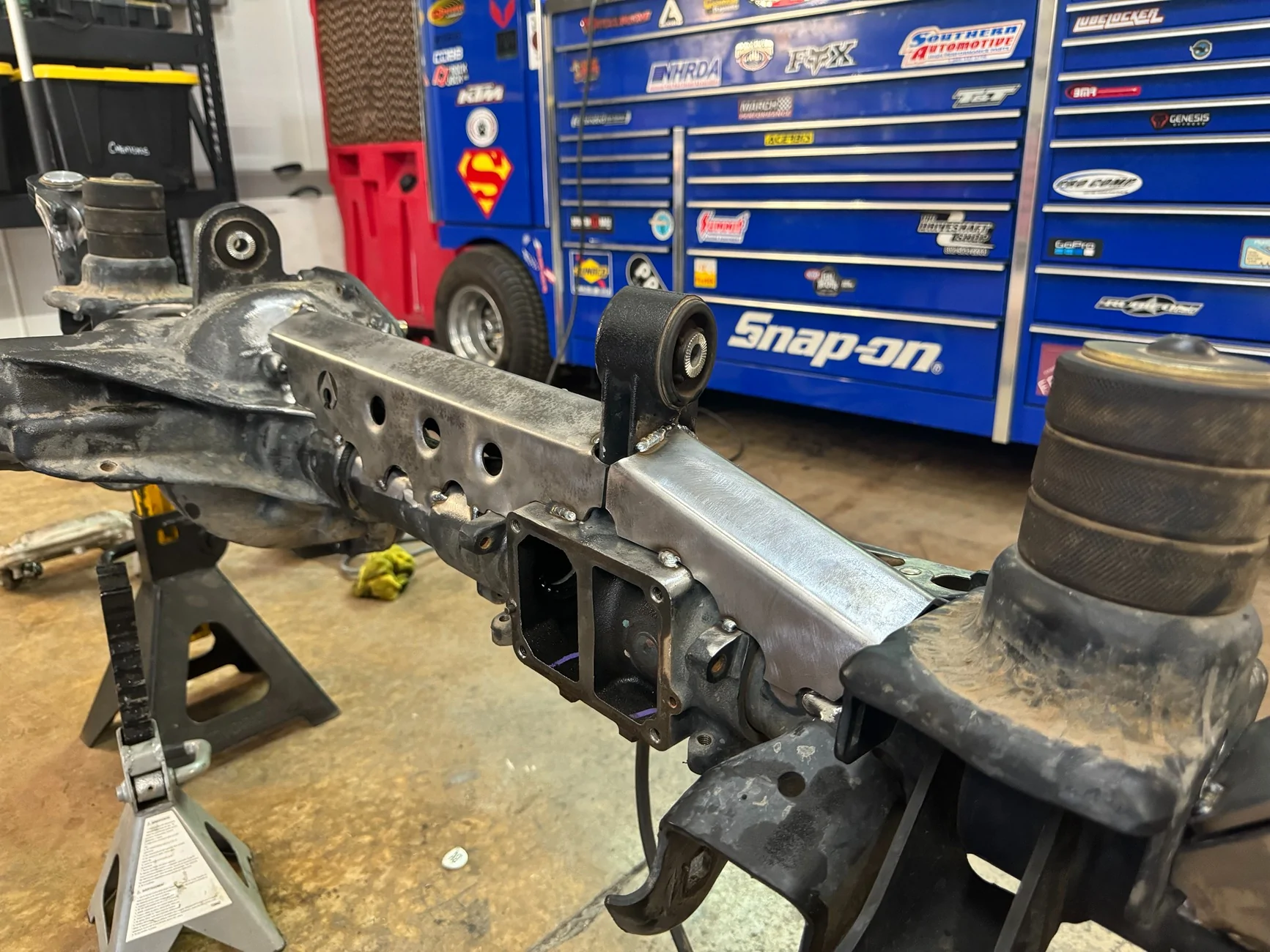

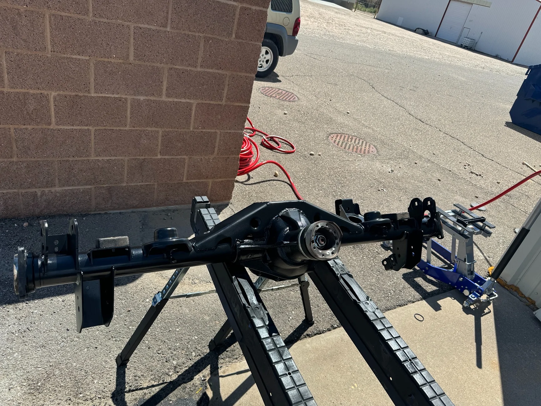

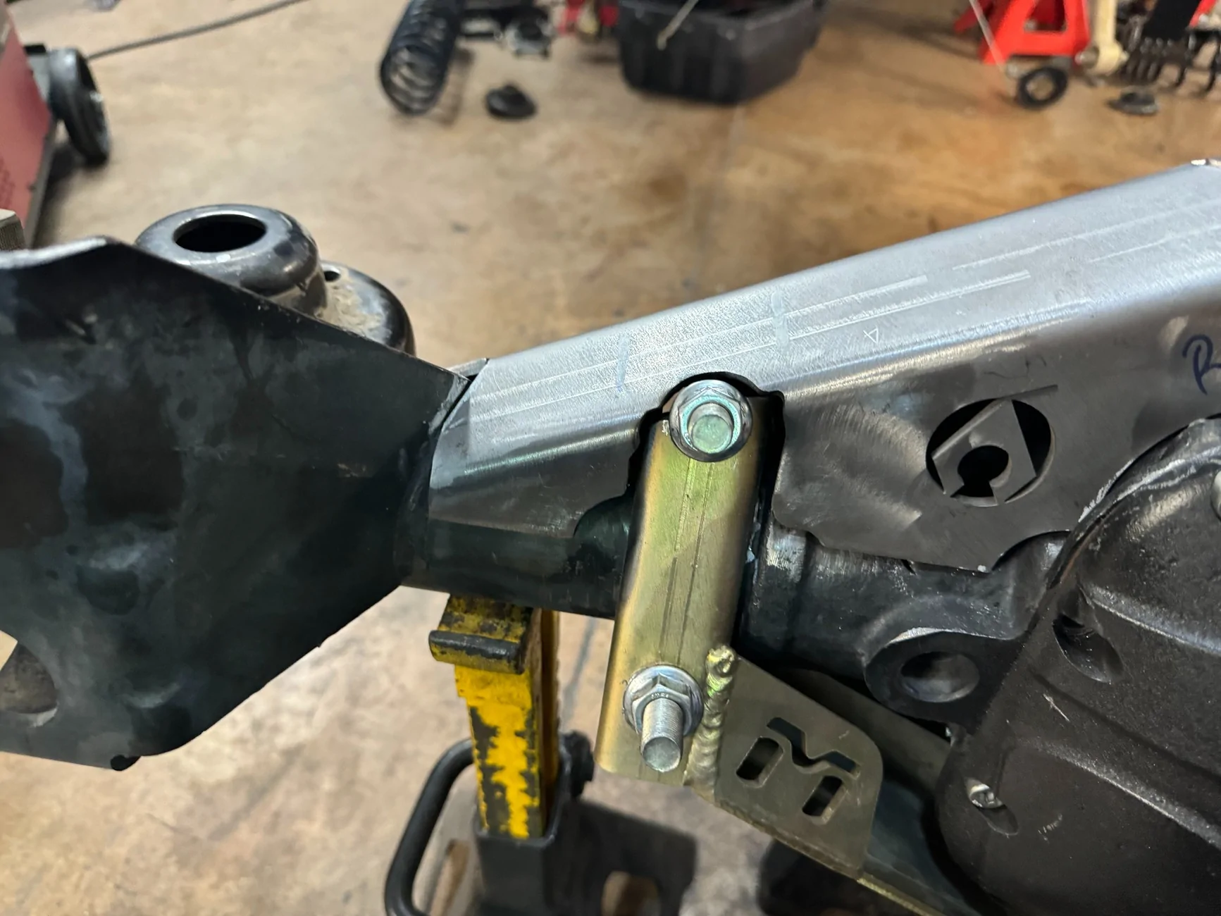

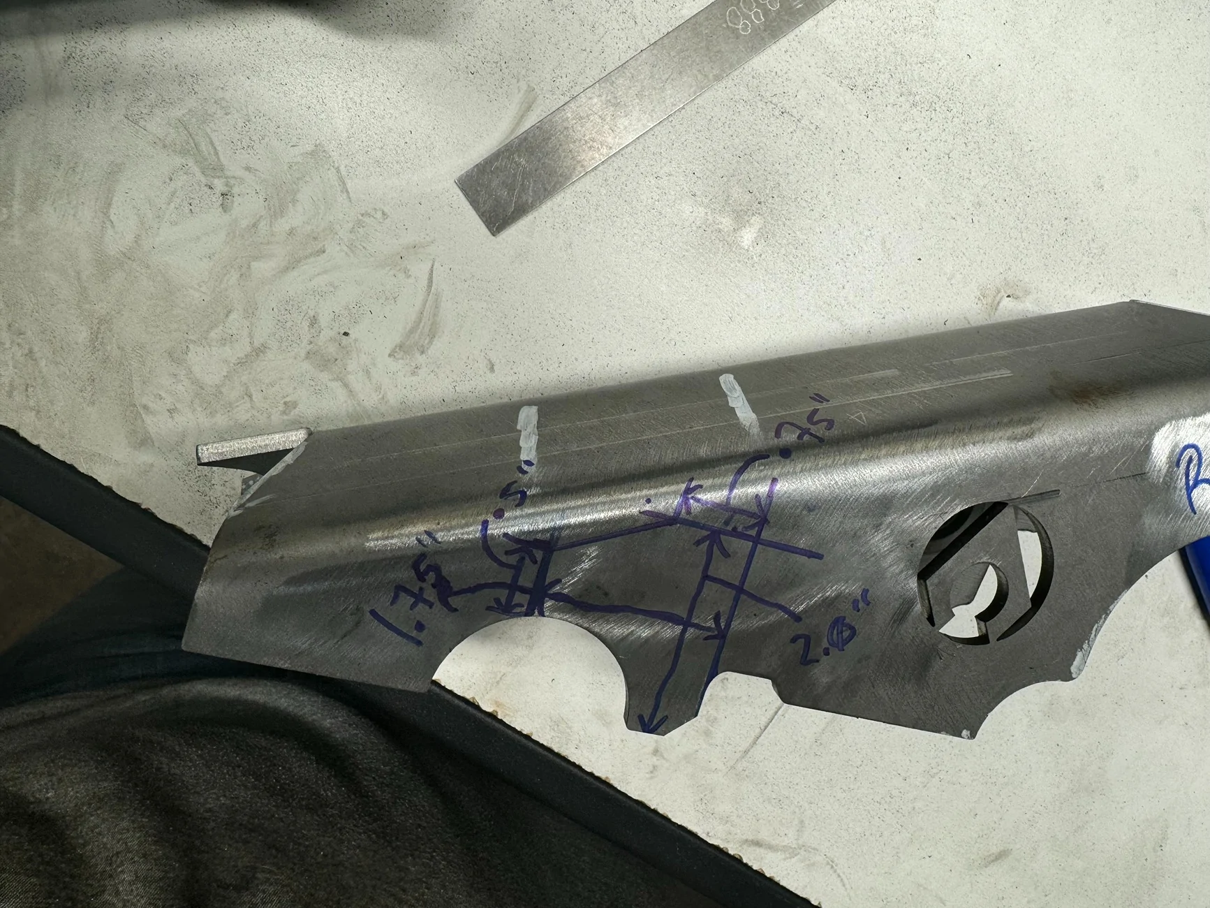

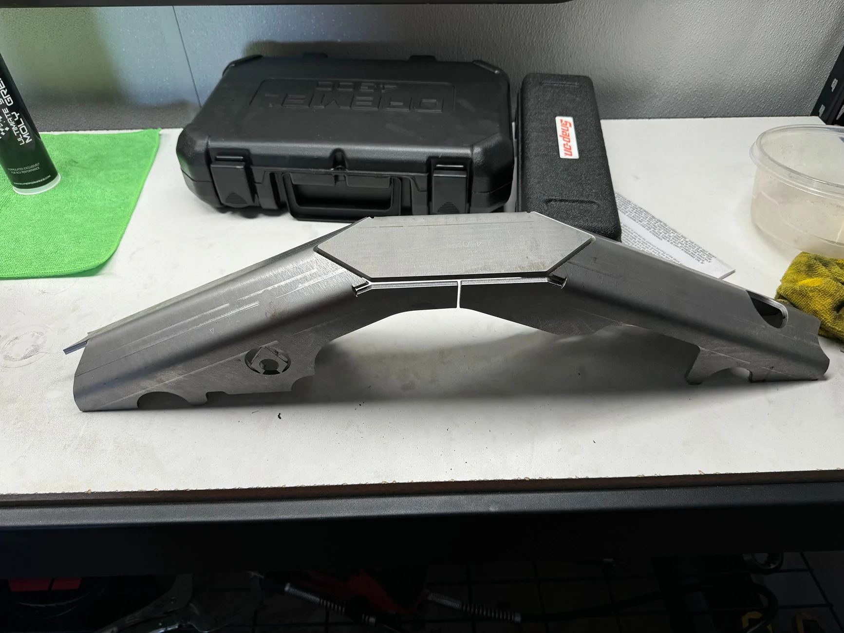

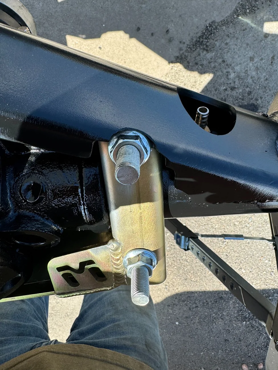

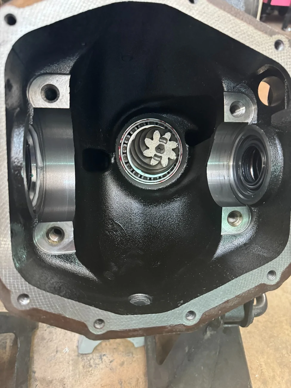

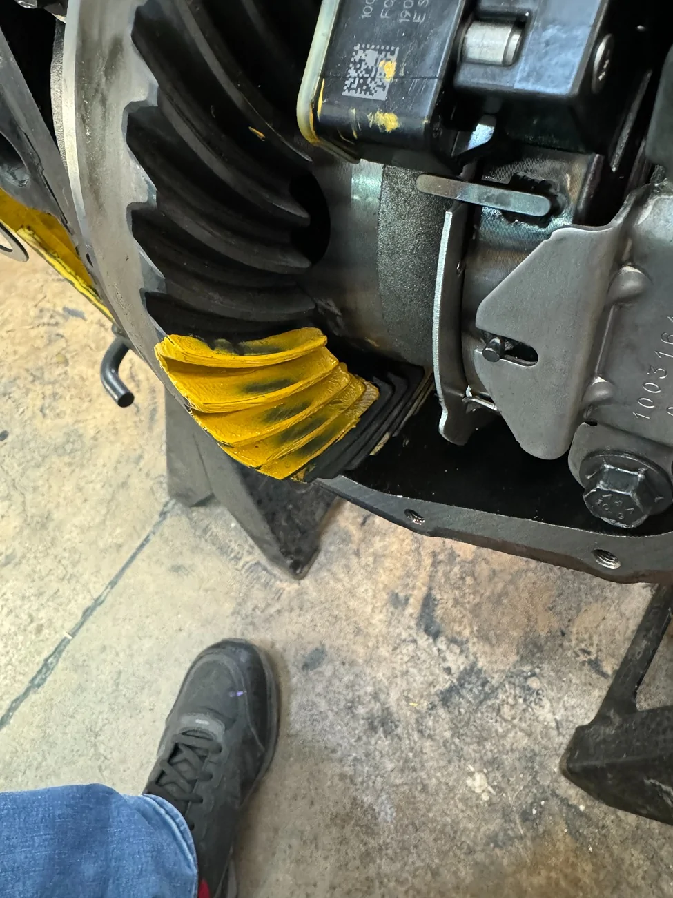

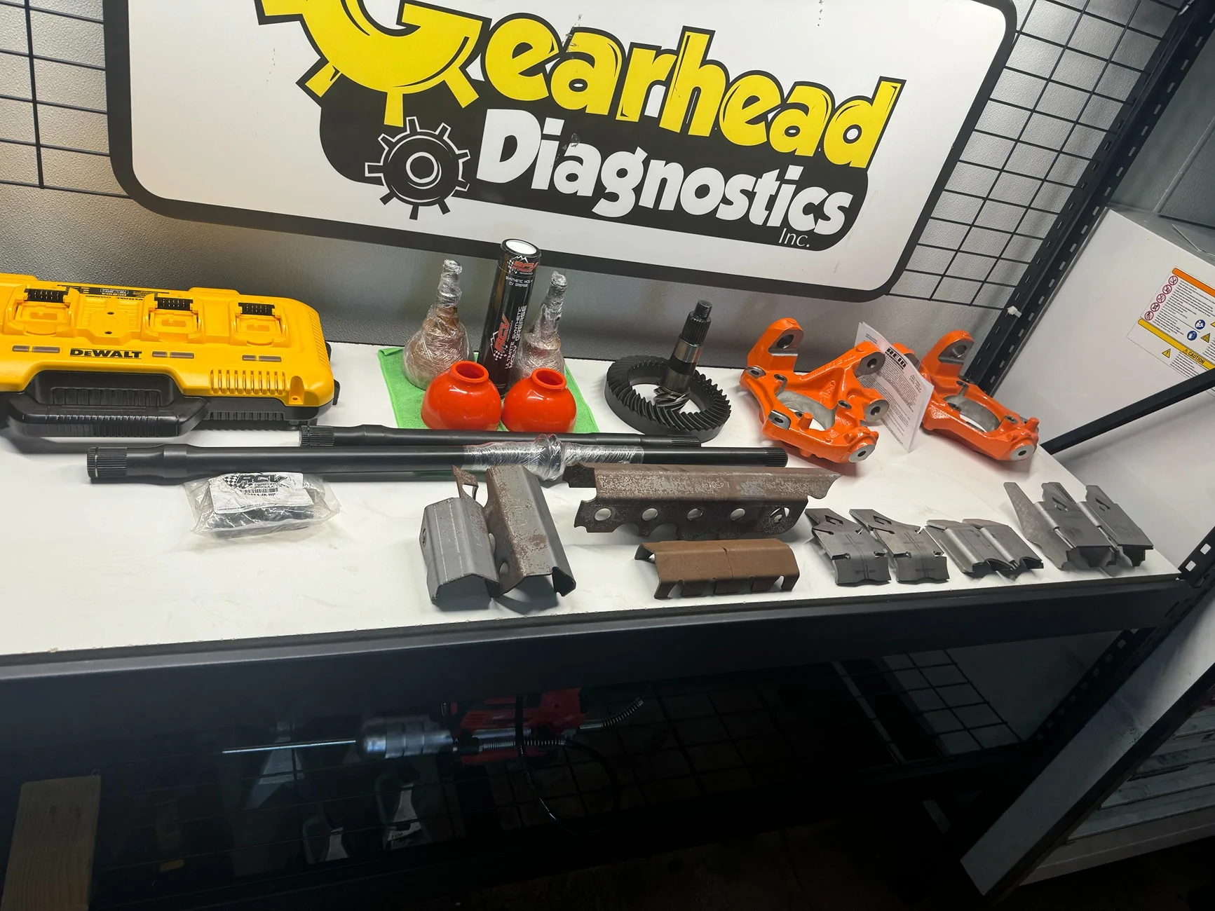

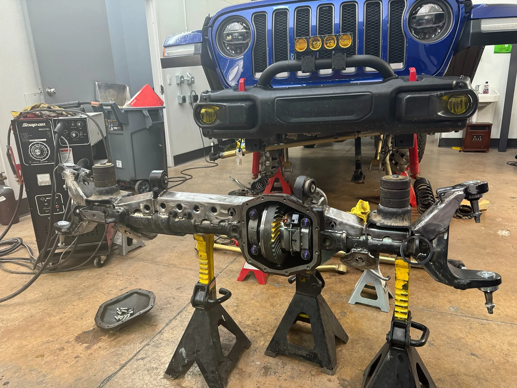

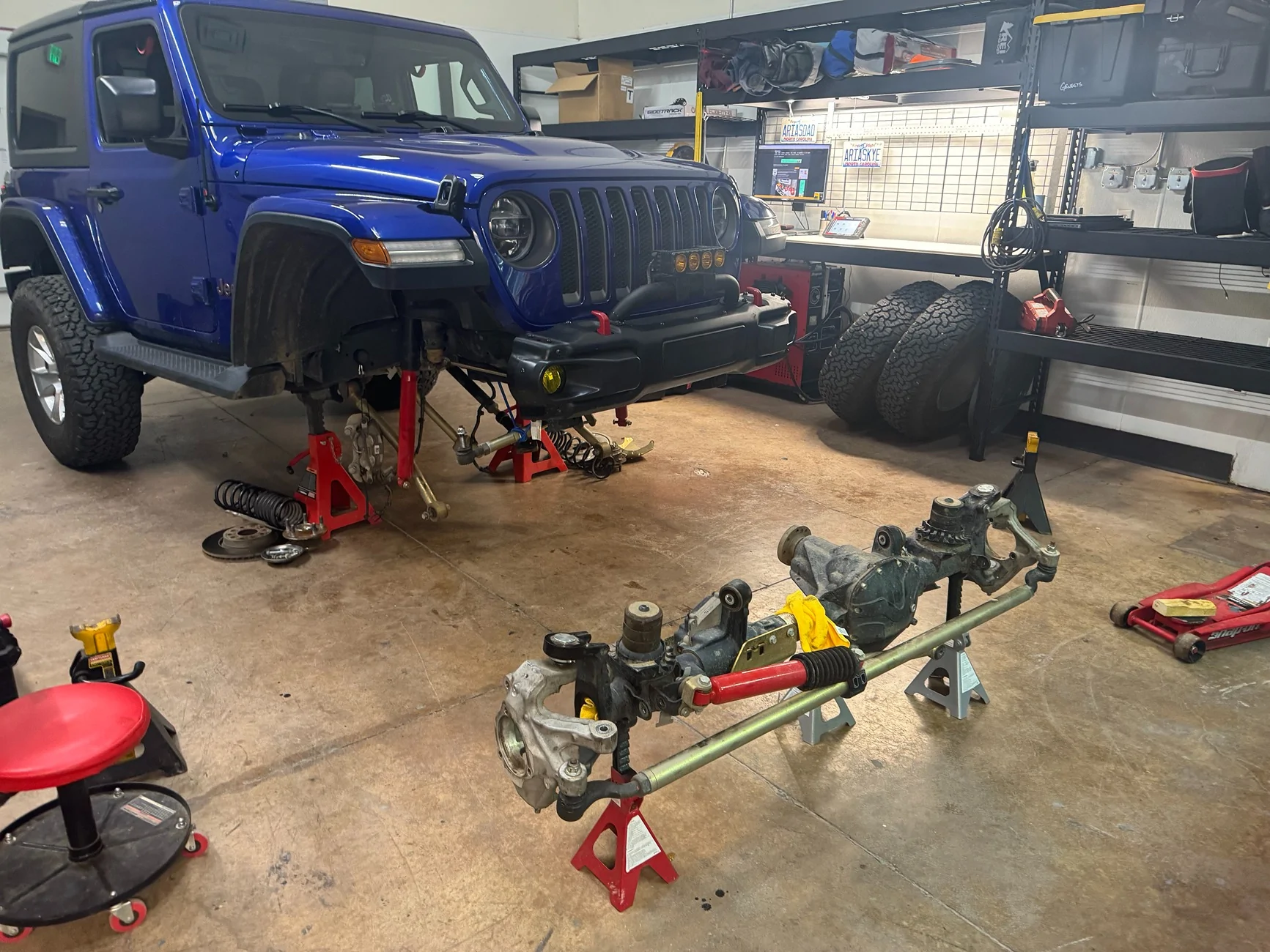

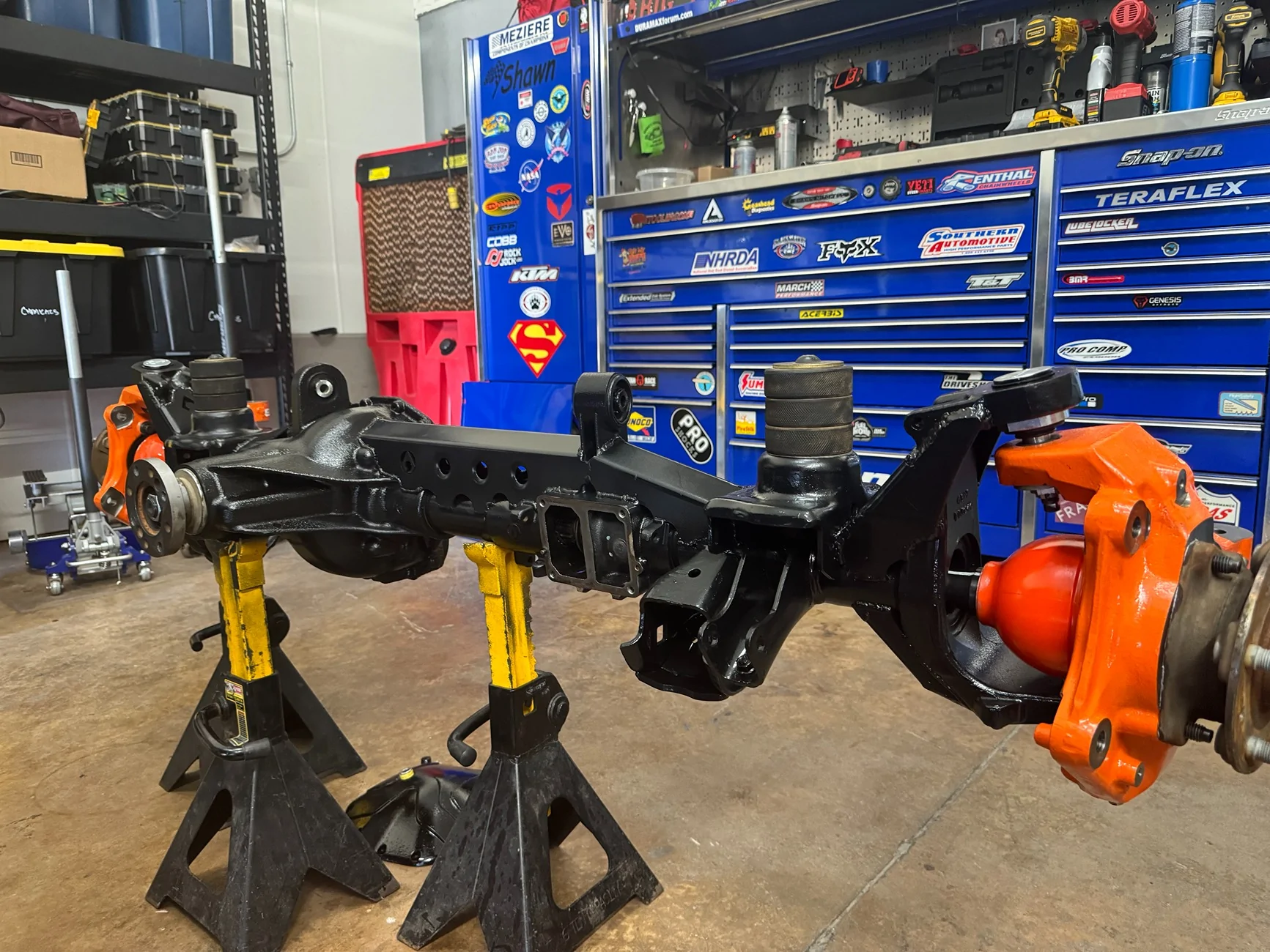

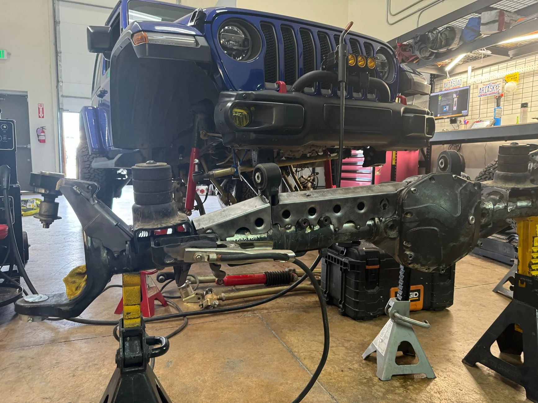

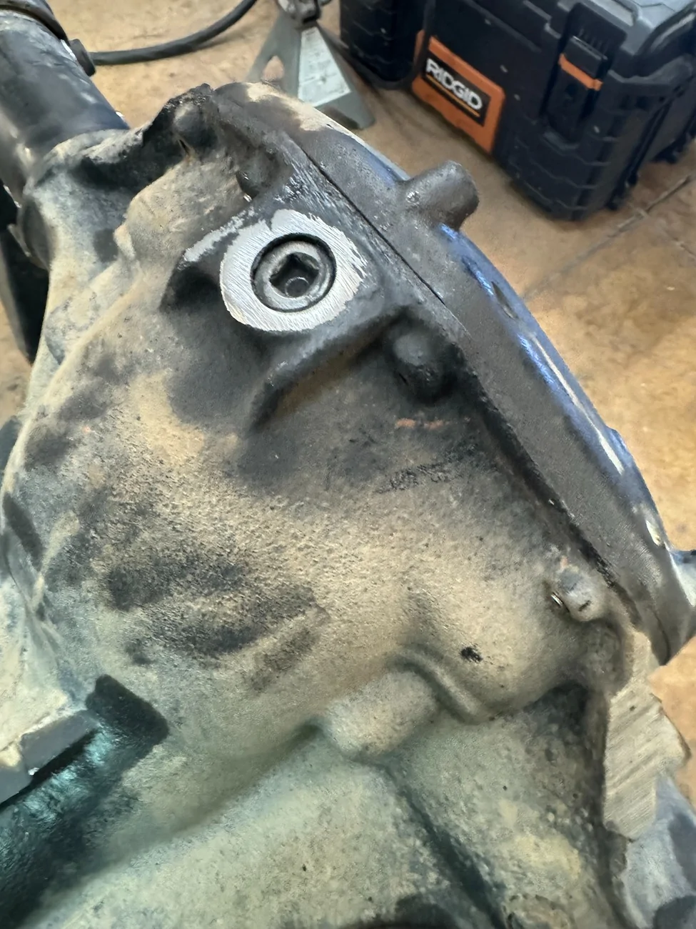

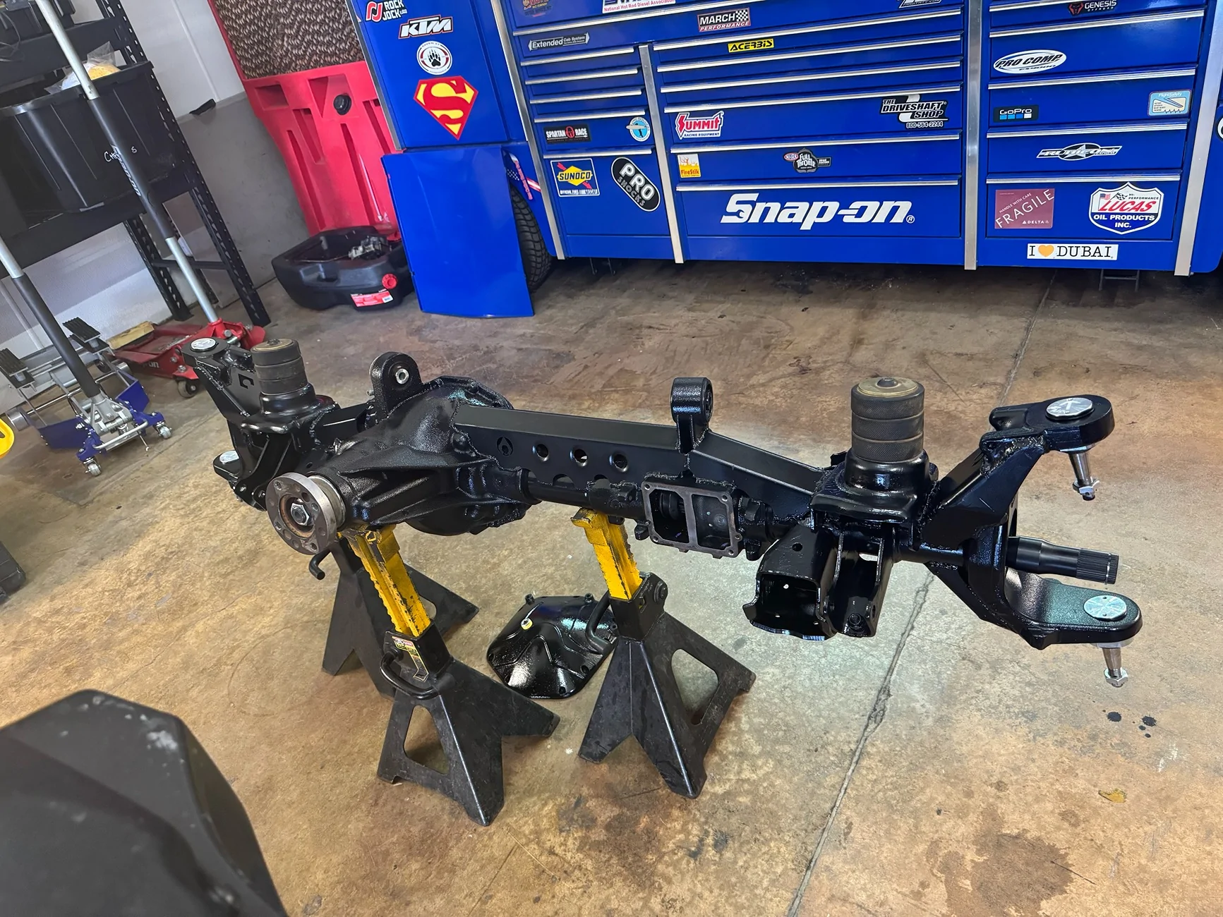

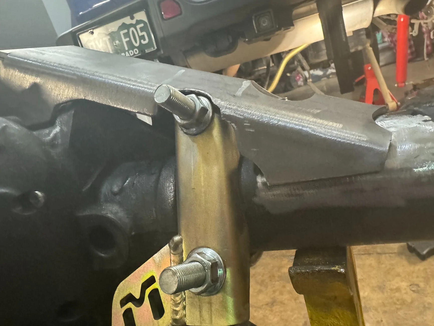

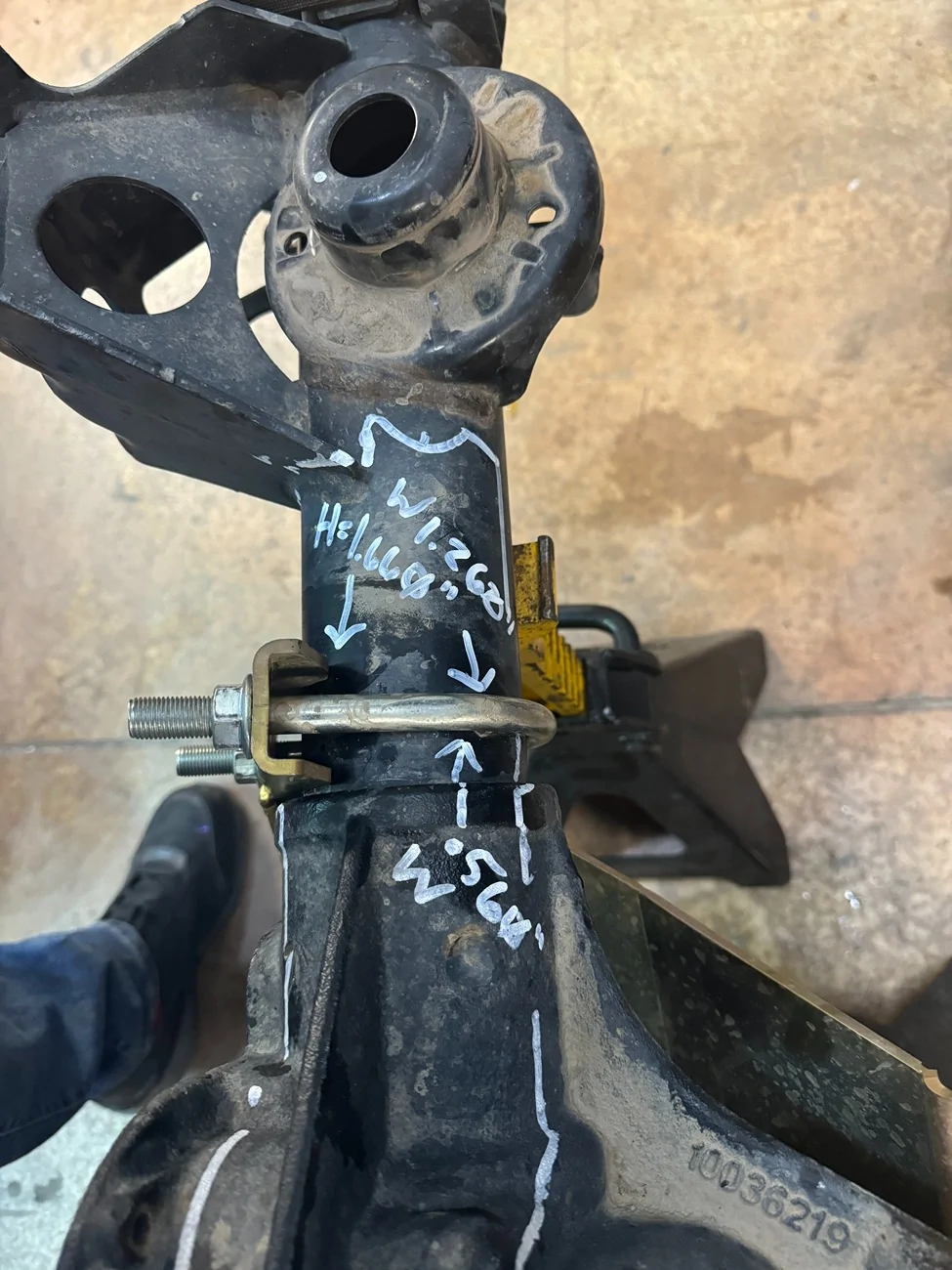

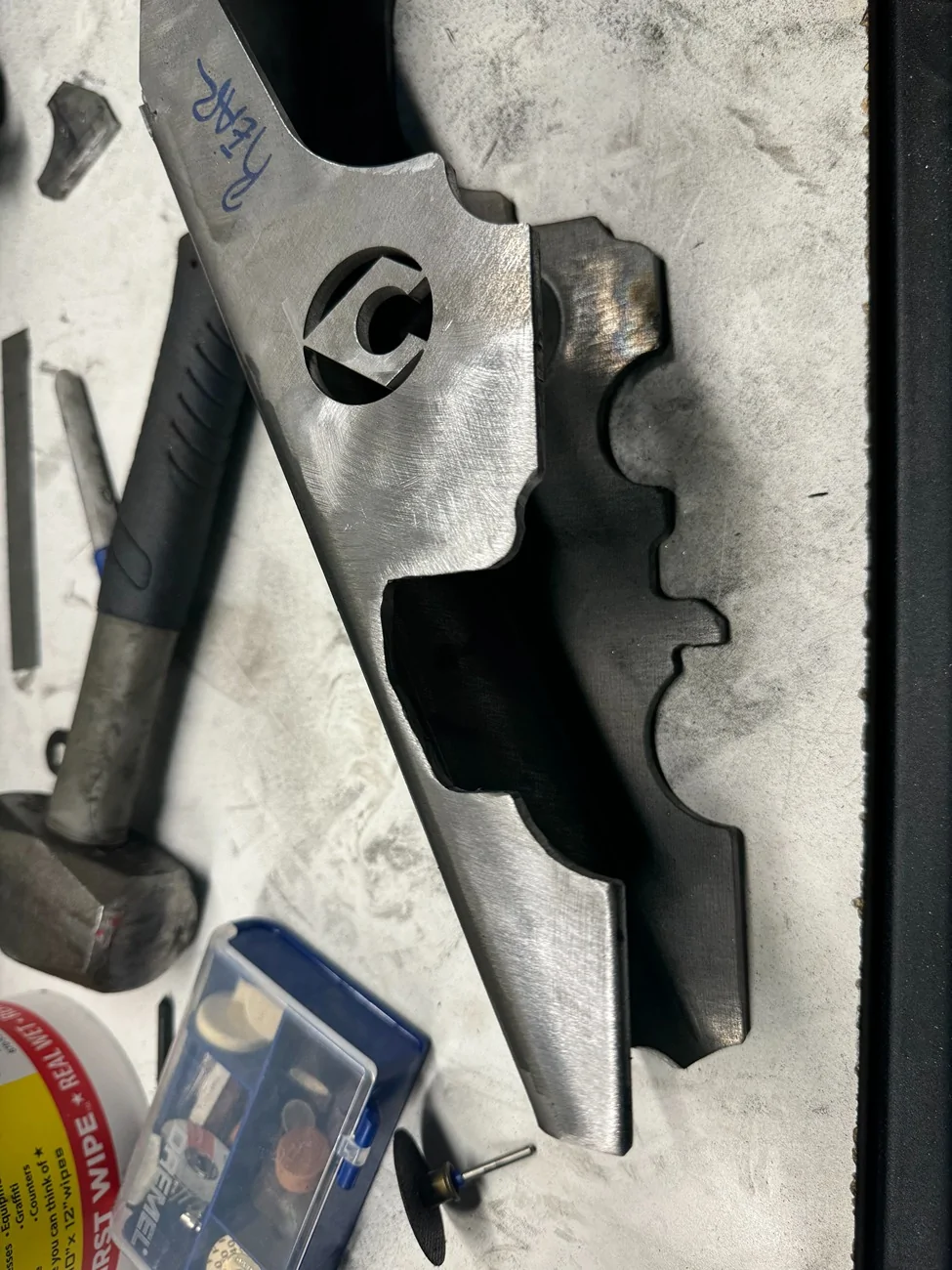

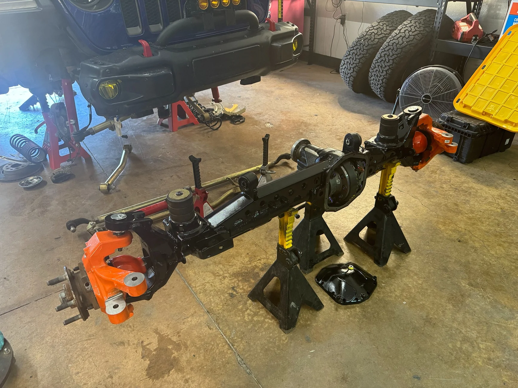

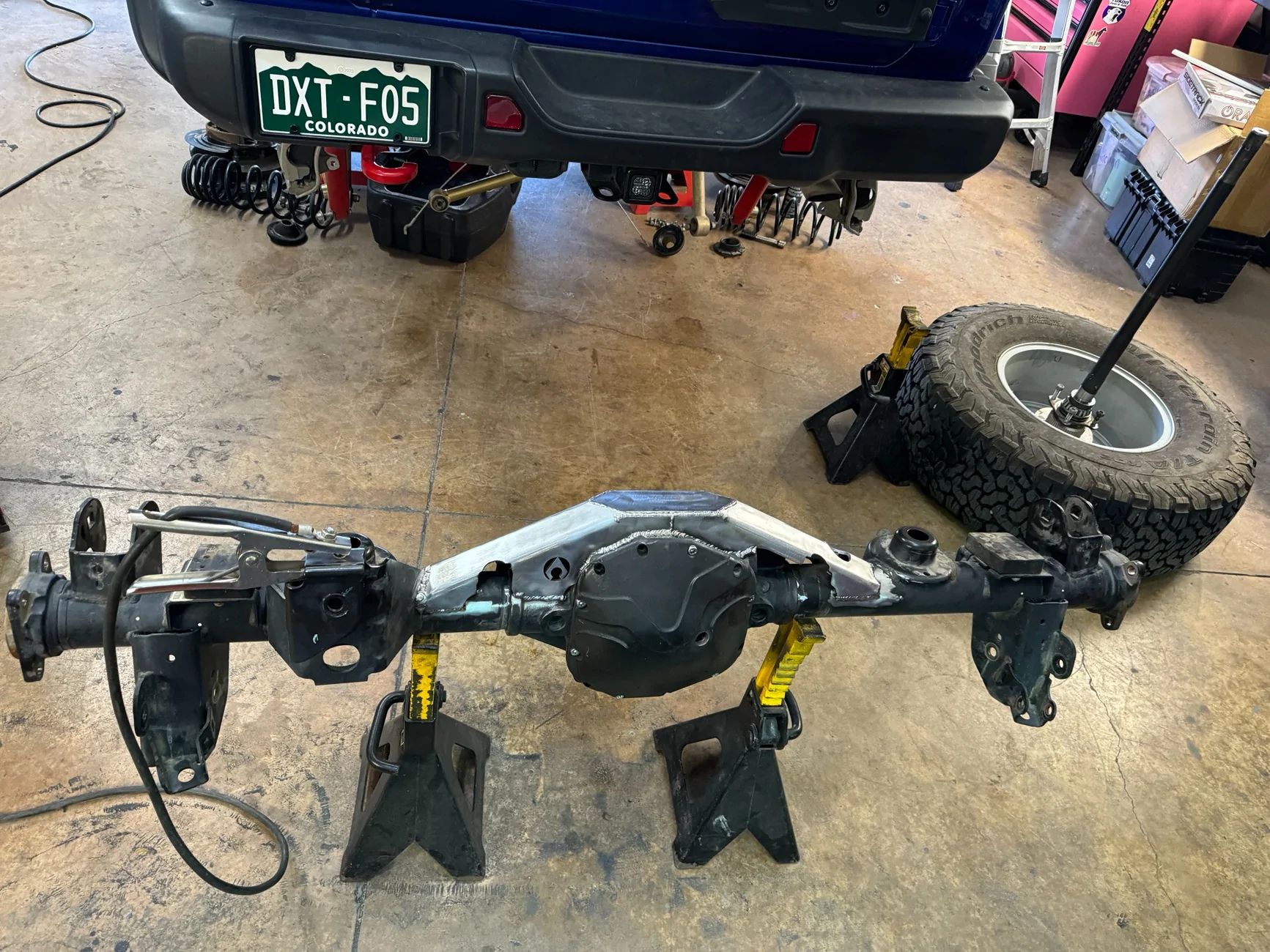

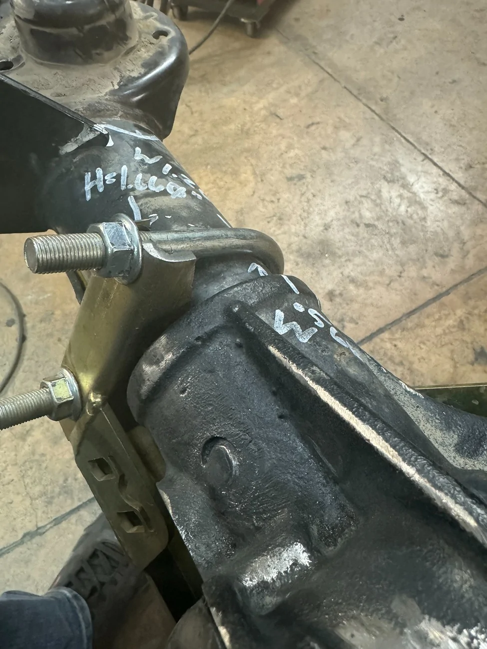

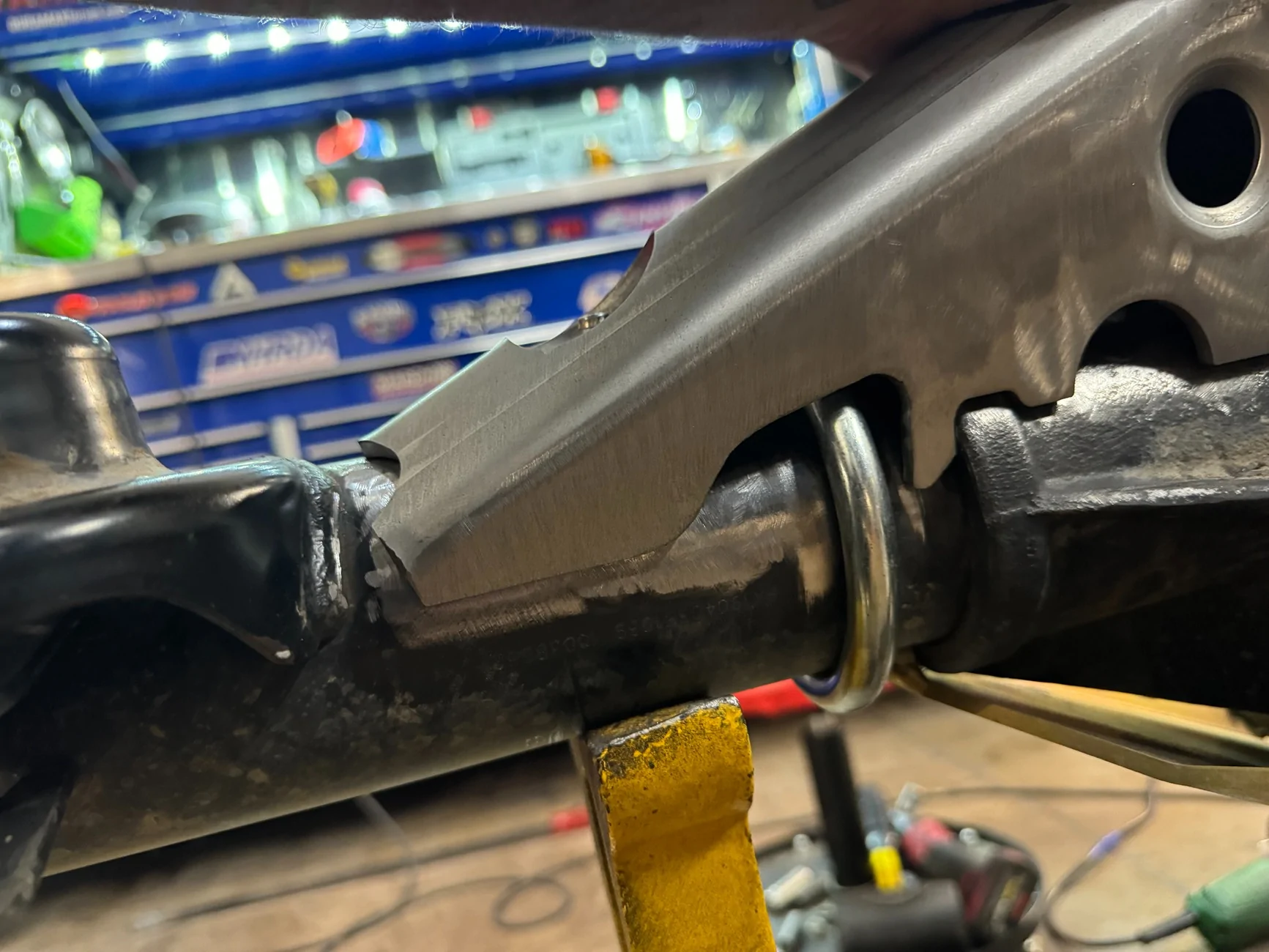

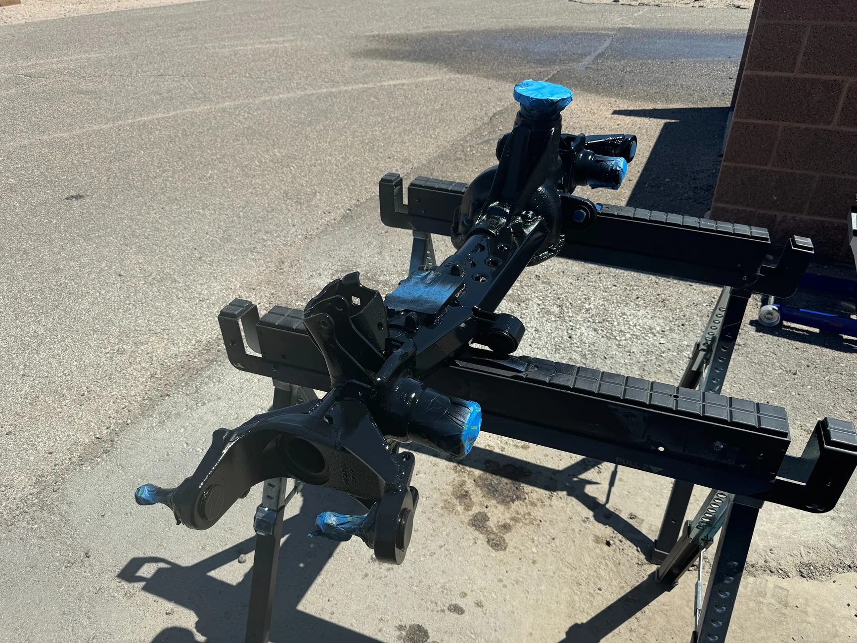

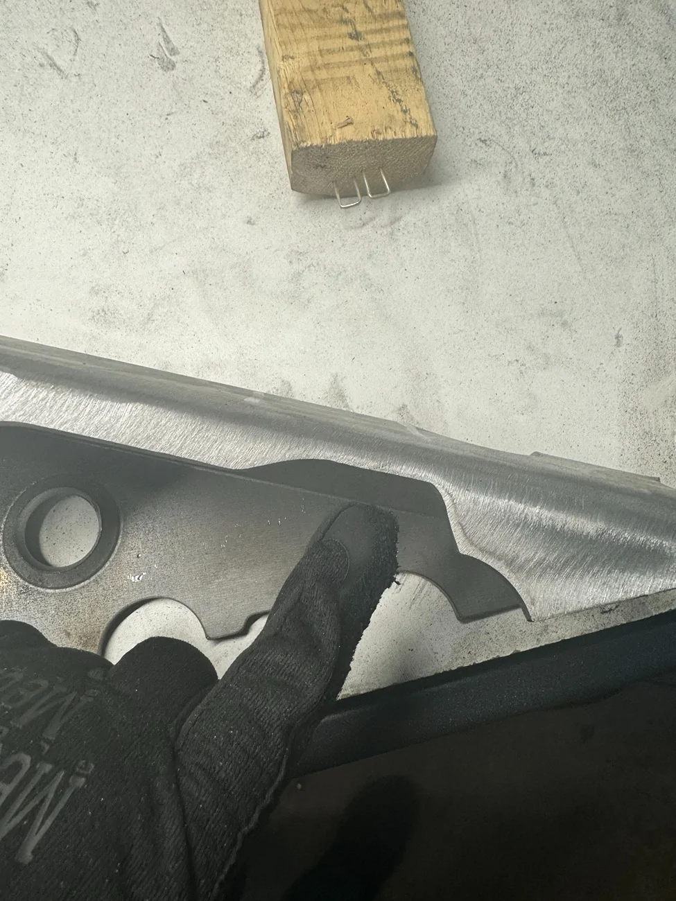

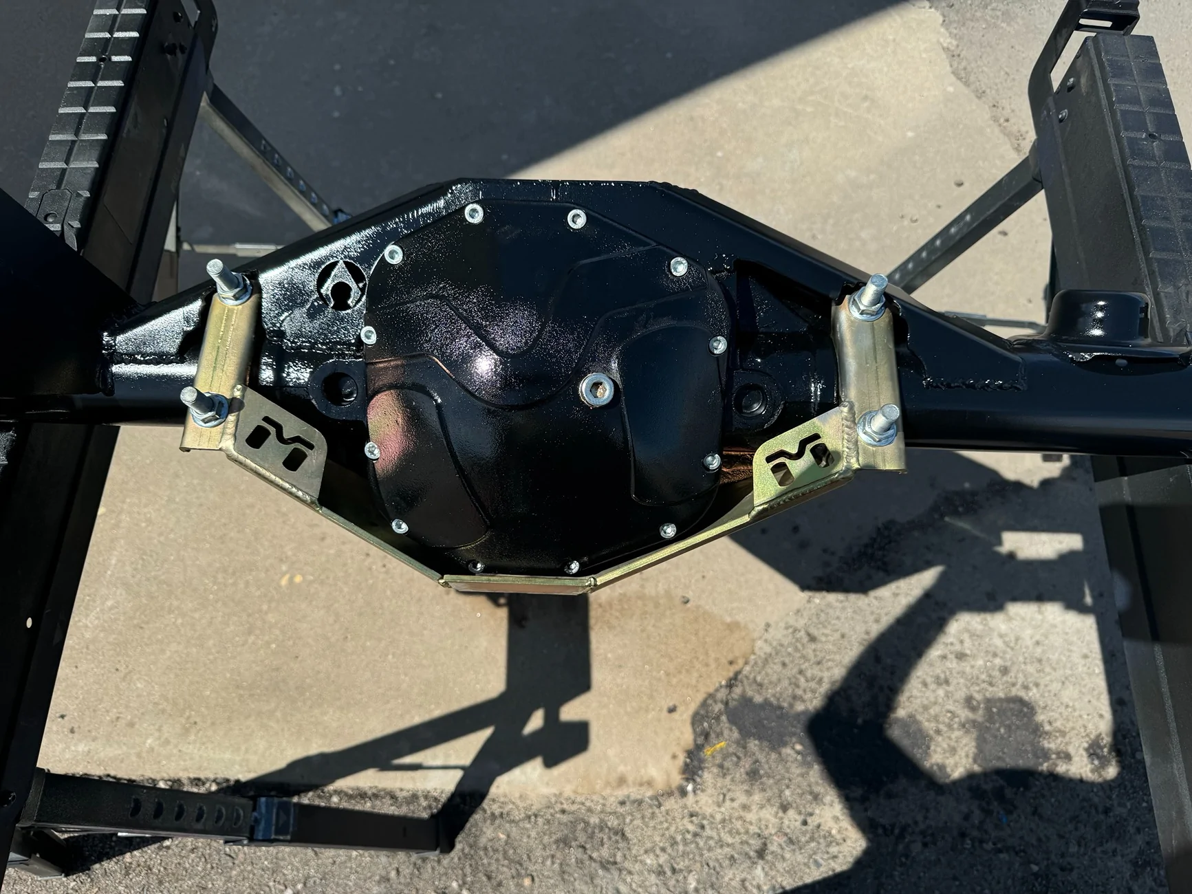

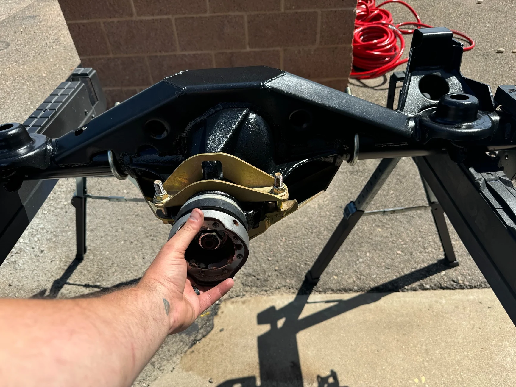

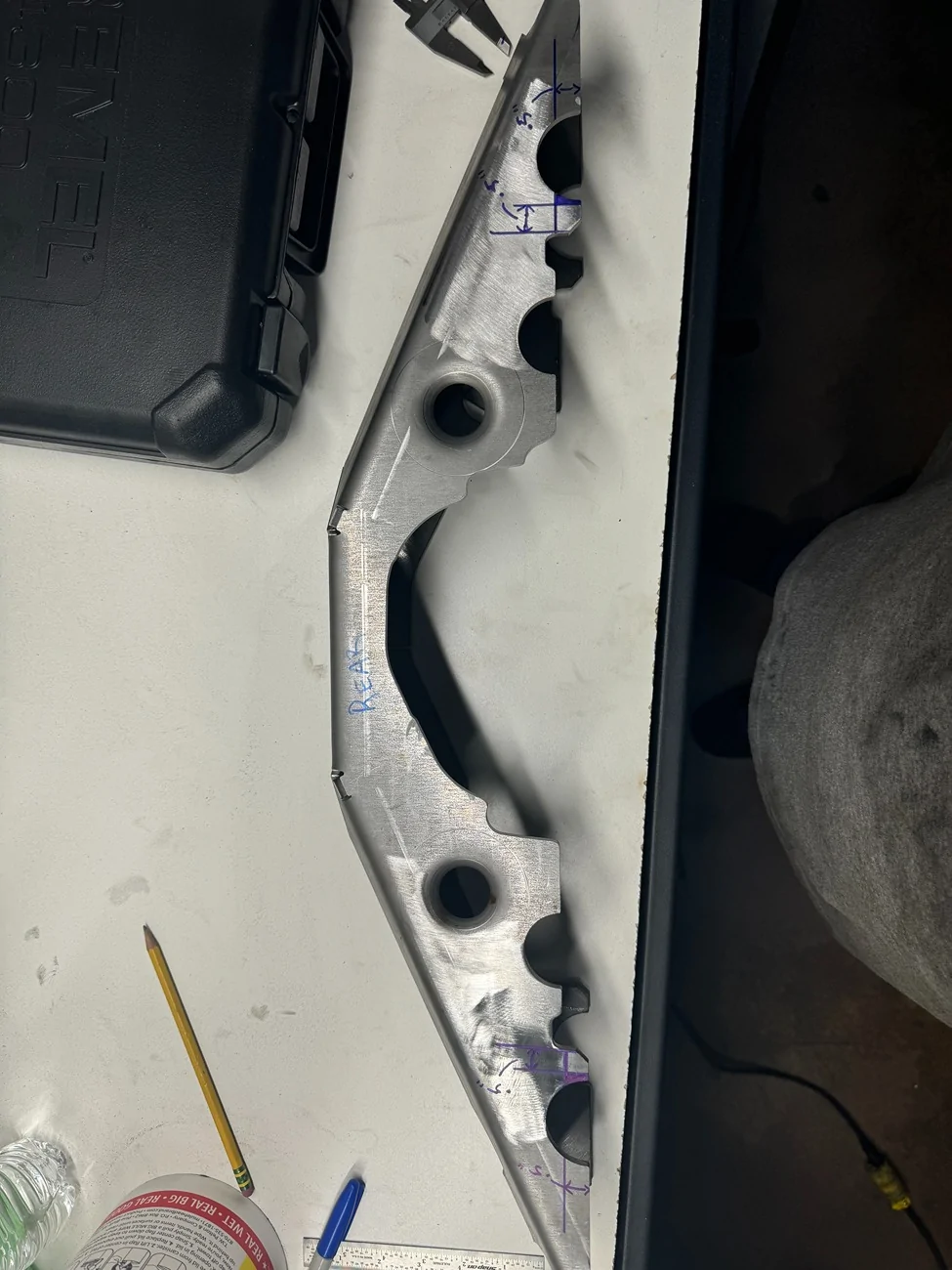

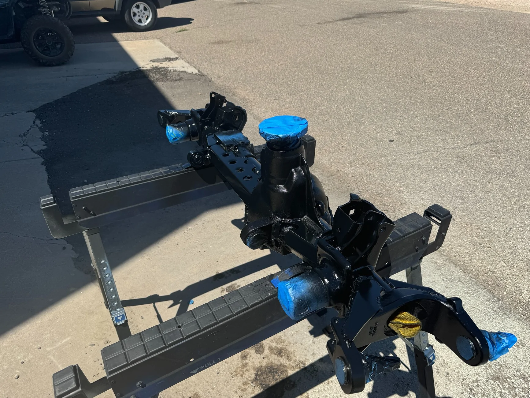

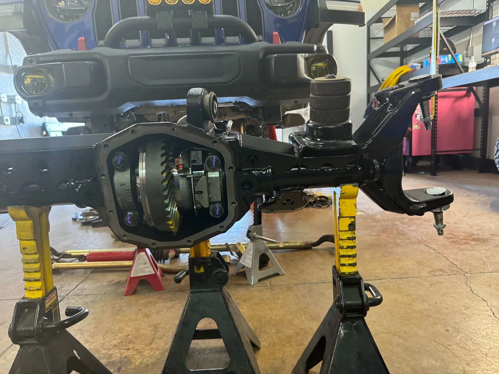

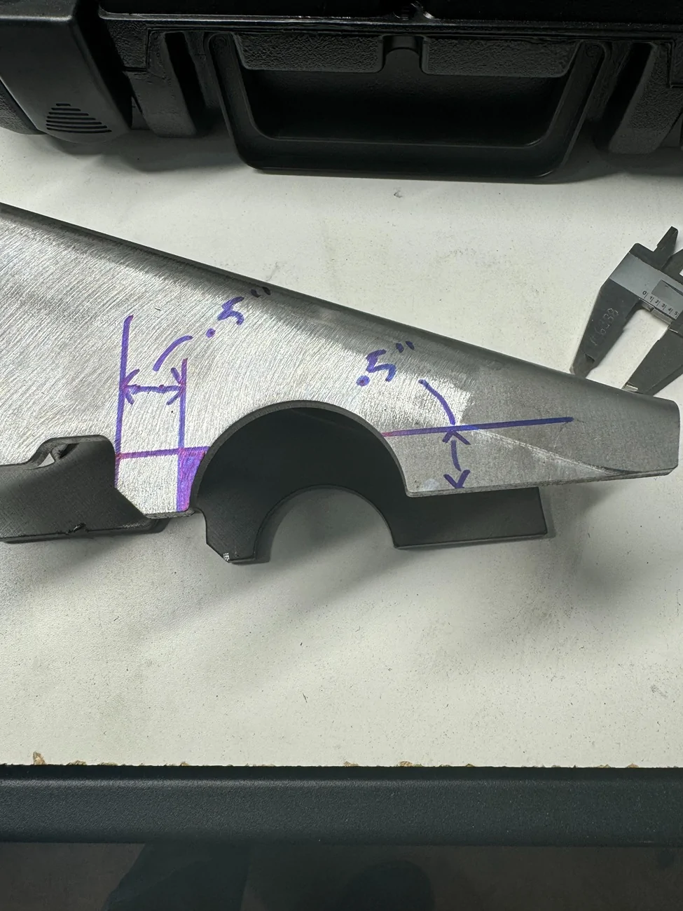

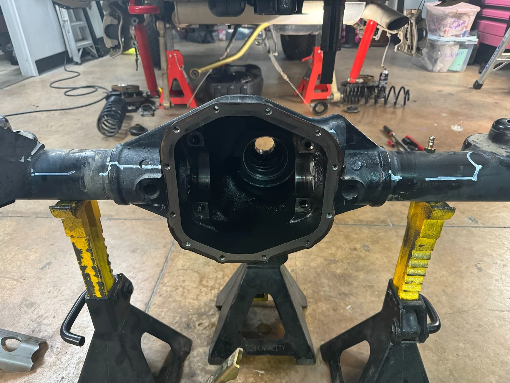

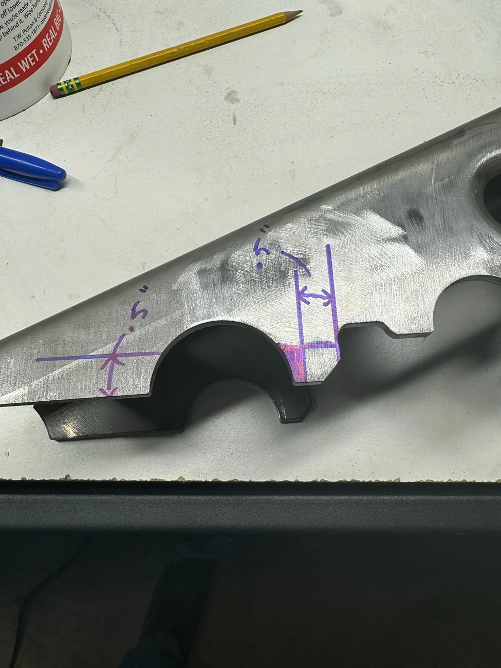

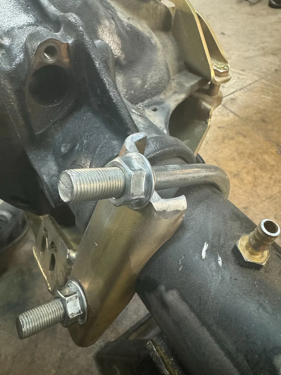

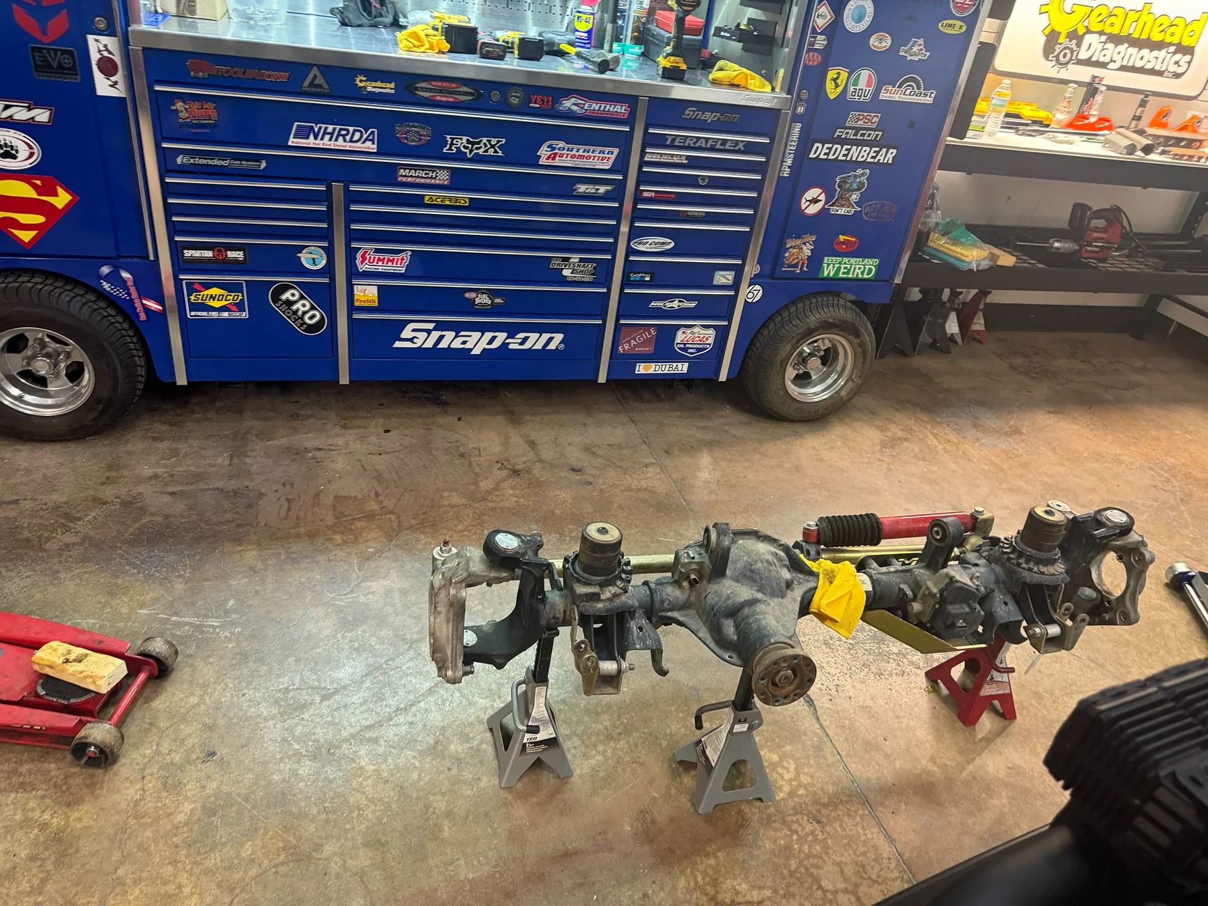

This was a 2 door that got front and rear trusses. The rear truss was custom cut to fit the golden diaper skid, as well, so he could run both without interference. Got regeared, too, so I threw some pics in for that just 'cause.
Looks like they're loading all out of order. Lol. You'll get the idea though.
