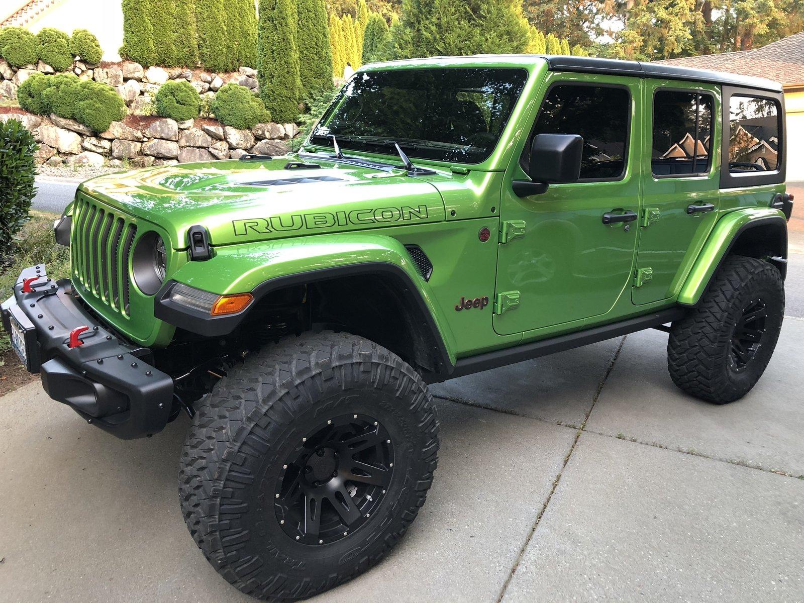

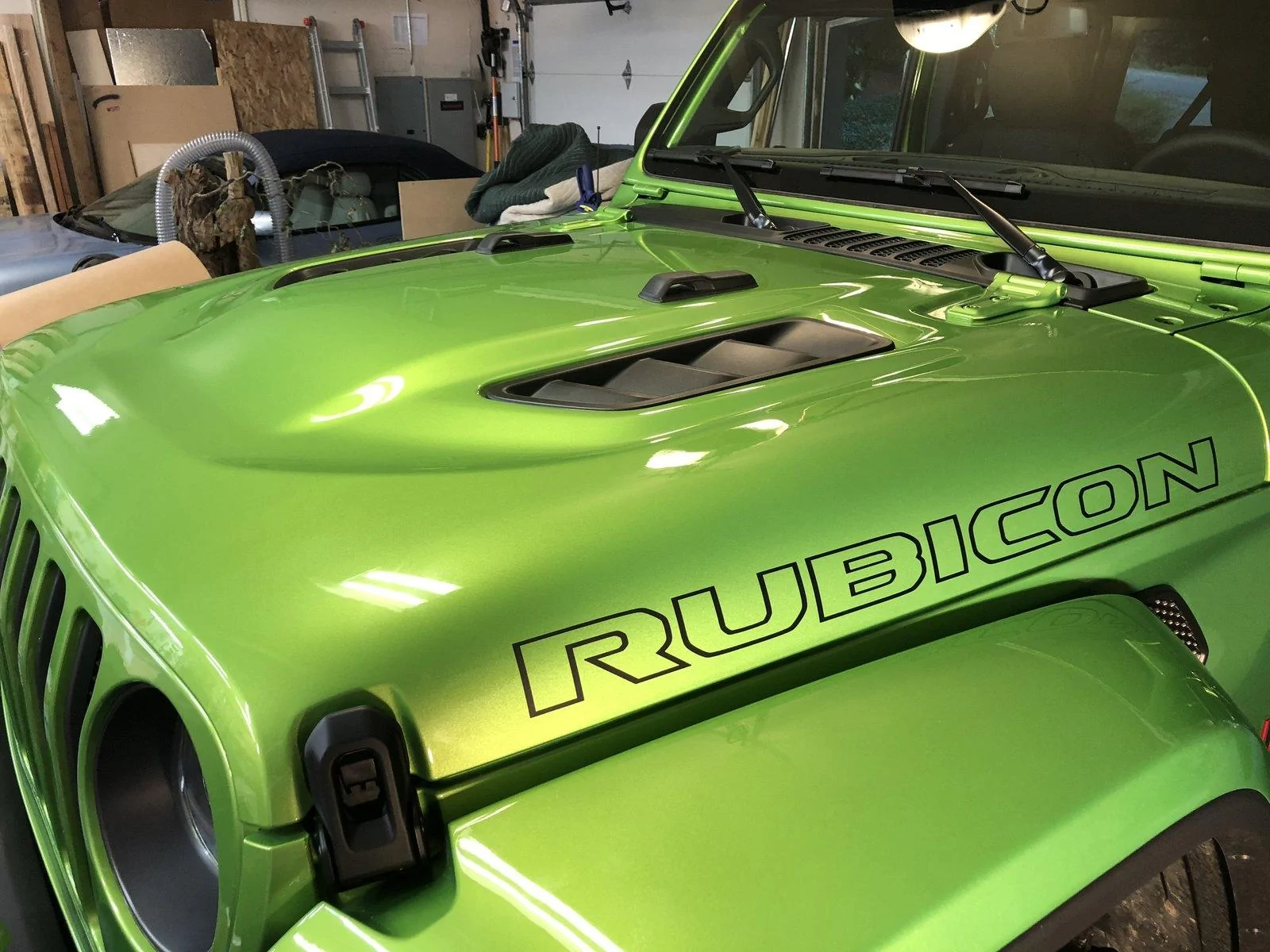

Decided that Red-n-Green is only for Christmas! So toning it down to more black accents... updated Rubicon decal from www.pixeldecals.com
This is bitchin! Very clean! :clap:

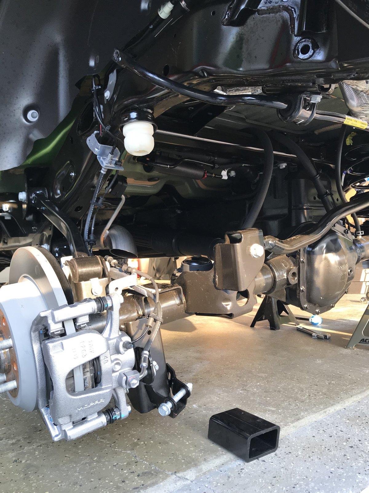

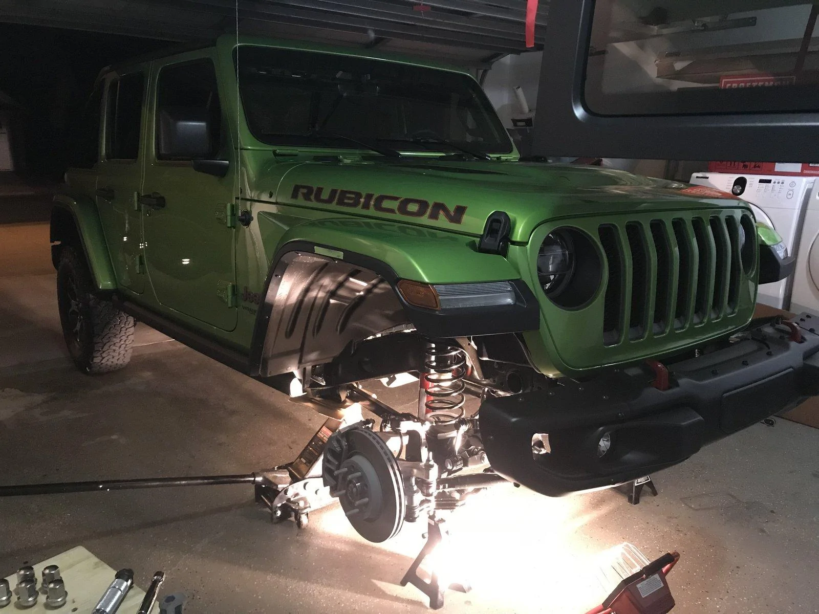

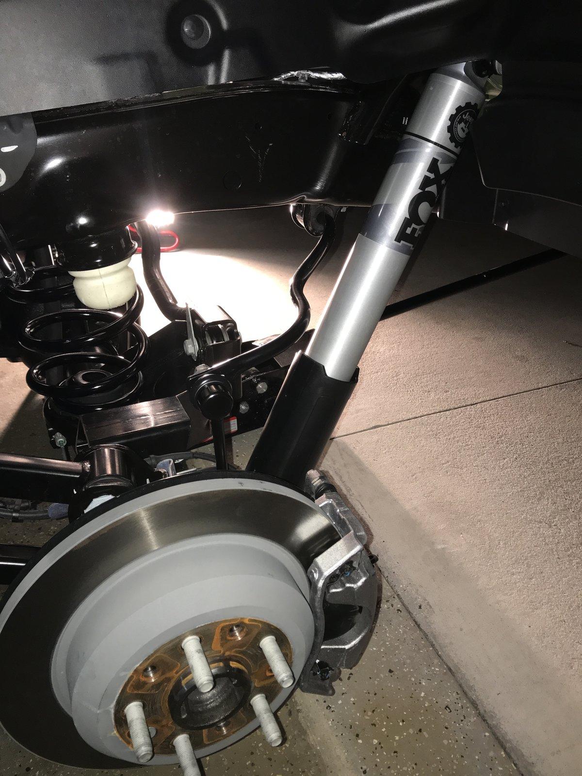

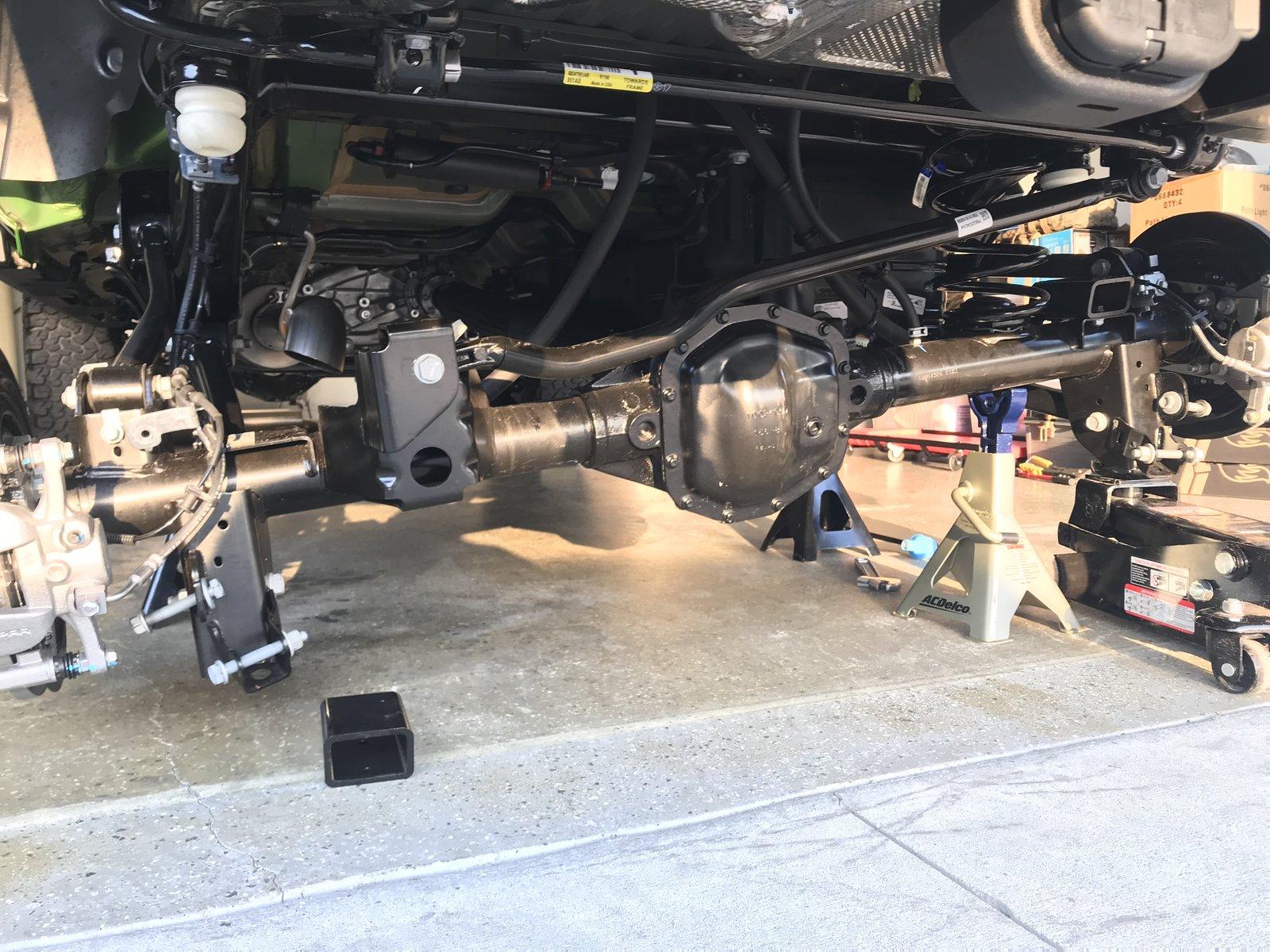

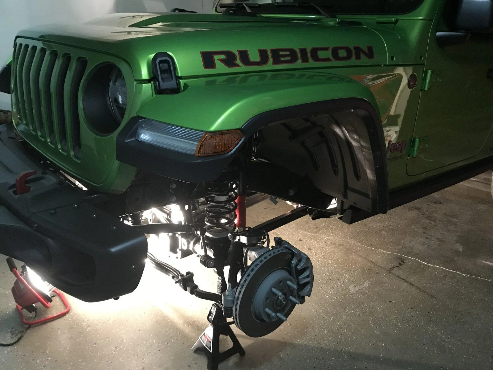

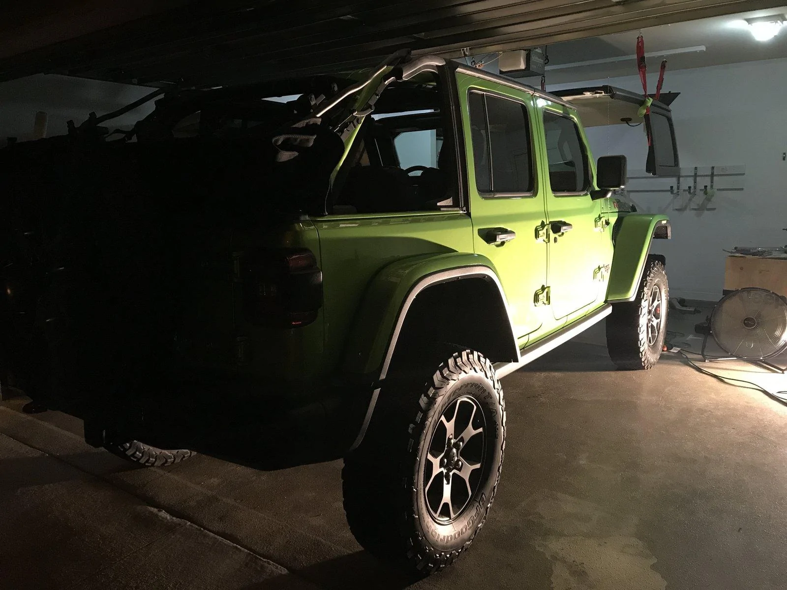

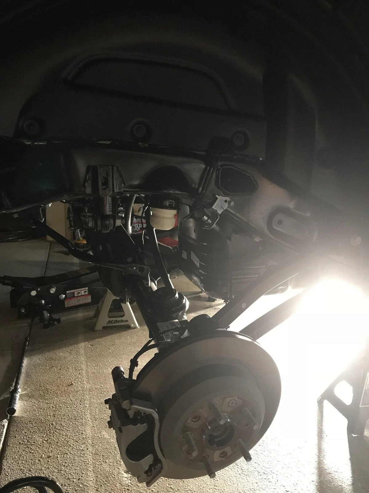

Stage 1: Complete
Did the lift in the garage with a floor jack, four jack stands and some hand tools. I will echo other forum posts/threads that it can be done taking your time and some elbow grease. It was very rewarding and I got a chance to peak up her skirt and familiarize myself. I highly recommend the Mopar kit for what it’s worth. Had it on my prior JKU sport as well. Net lift after everything was torqued and on level ground was 3.25”!! Also dropped the tires from factory 44 psi :idea: down to 37 and it’s not as squirrely down the pavement.
Yes, I know the stocker wheel/tires look like Mojiticon skipped many legs days. Waiting on some KMC XD229’s to show up to mount those 37” Coopers. Will follow up on that later this week and get some better pics.
Happy Jeepin y’all!:like:

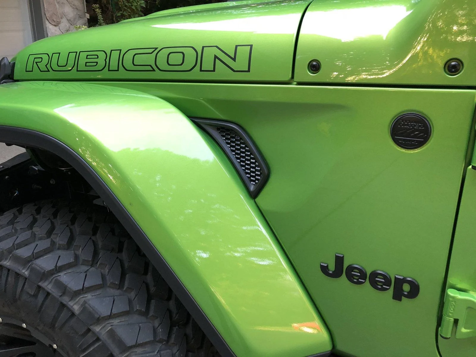

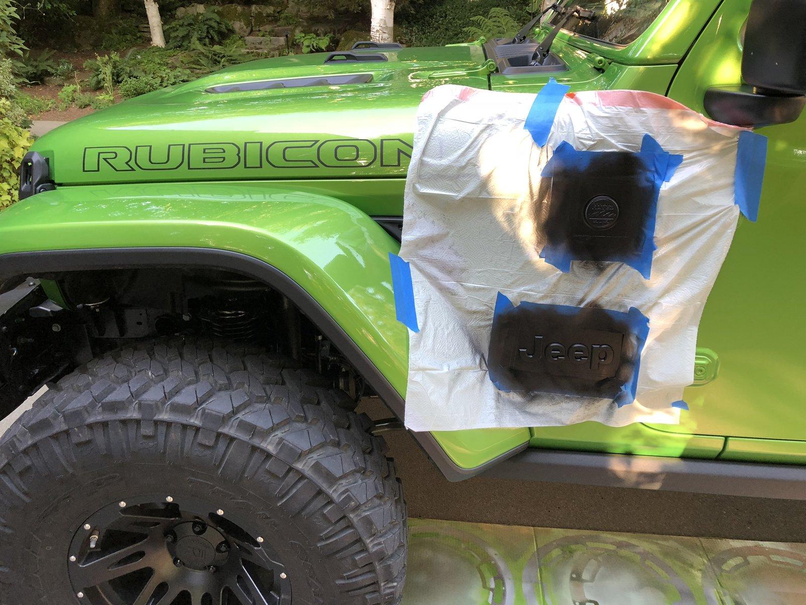

Continued my blackout journey! Plasti Dip on the Jeep logo and badge
Yee I'mma straight try to do this! Have "Jeep" be in black and maybe paint the metal on the Trail Rated badge Mojito! green, keeping the black as it is.
Where did you get the Jeep stencil? Did you make it yourself? If so, out of what material?
