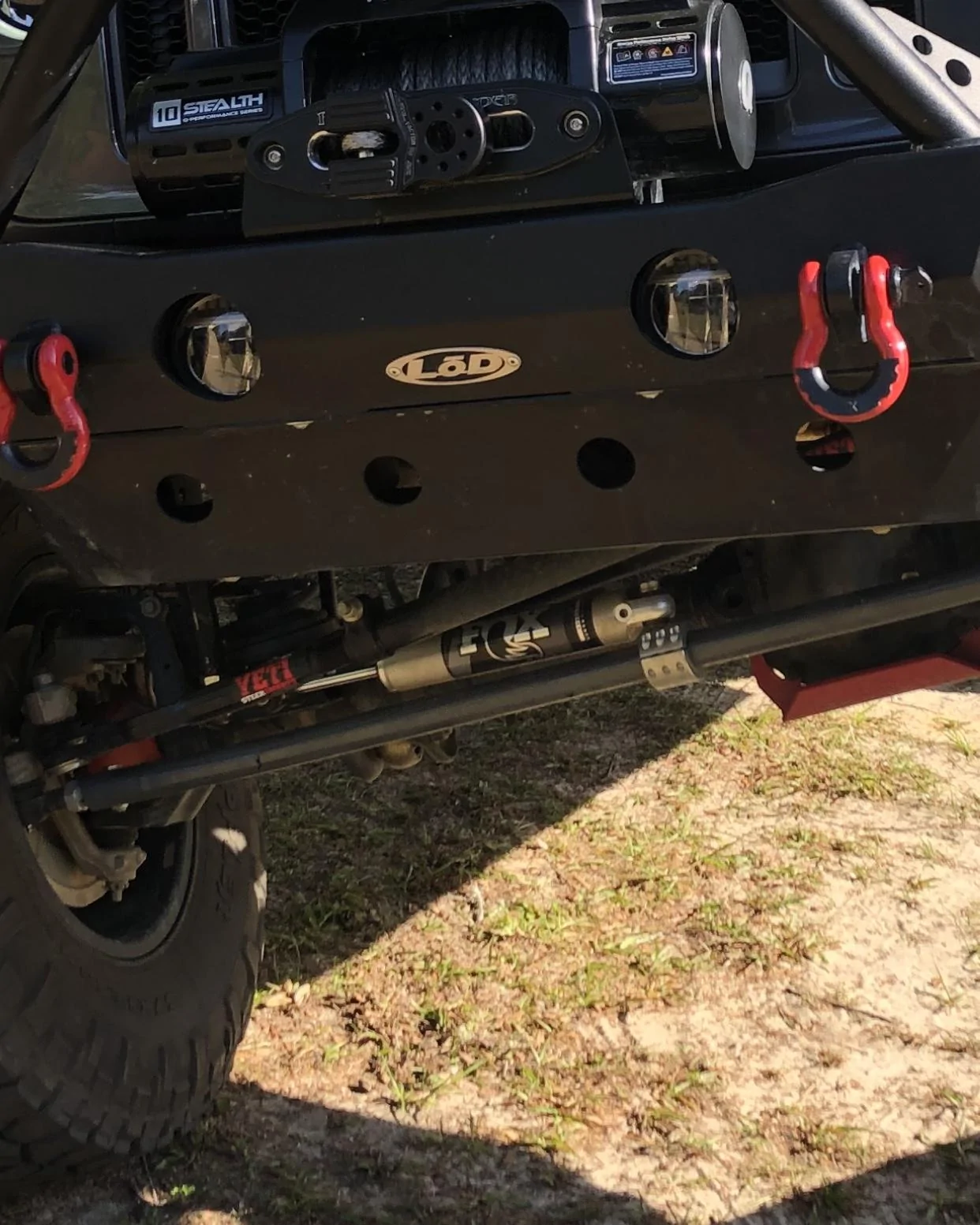

Can anyone think of a reason I couldn’t run a synergy tie rod with steer smart drag link? I can’t see any issues but wanna make sure I’m not missing anything.
I can get a deal from my 4x4 shop on these parts. My ocd is going to have a field day with this one...:facepalm:

I have the full Yeti steering and track bar kit on my Rubi. The adjustment clamps are loose and can all be clocked to where they clear their surroundings. My drag link clamp bolts face forward and those on the tie rod face down. At least for me, that combo seems to work. The clamps on my Synergy rear track bar and control arms are welded in the bottom position, so I would assume it's the same on their tie rod. If it is, you should be good to go with that combo.

Roky, did you have any issues making this fit? I may have already asked you. I'm trying really hard not to care whether everything matches. But clearance wise, does it all work together? Do you have your stabilizer mounted on the tie rod? I think that has me most concerned.
Yes.... everything plays nicely together, no issues at all. .... here’s pic.
You think you'll swap the tie rod at any point in the future or no? You like the handling?

I’m gonna leave it like this, it’s kinda cool not having the cookie cutter set up.......lol. My ocd is keeping it’s mouth shut because of the near 500.00 savings.....:lipssealed:
And to be honest, my rig handles like a sports car, and I’m afraid to change anything. If something wears out or breaks I might change something, but I doubt it.
IMO, the tie rod is my favorite synergy part. Their control arms are ok, but I prefer the high clearance RK arms. And I’m not afraid of jam nuts, never once had one come loose or fail the way I do it. Their track bar , not a fan yet, maybe when they dial in the design a little better. I’m a synergy fan , don’t get me wrong, I’m loving the track bar/sector shaft brace once I got it dialed in. But I just prefer other brands on some things.......Again , this is what works the best for me, after 2 years of monkeying with everything.......:)
