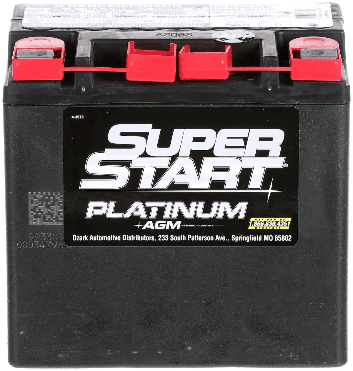

O'reilly's own brand; it is called Super Last. The big battery was $199; the aux battery was $107.
This is the aux battery. Apparently O'reilly is one of the few places that keeps them in stock.

This is the auxiliary battery I got. O'reilly keeps it is stock.
