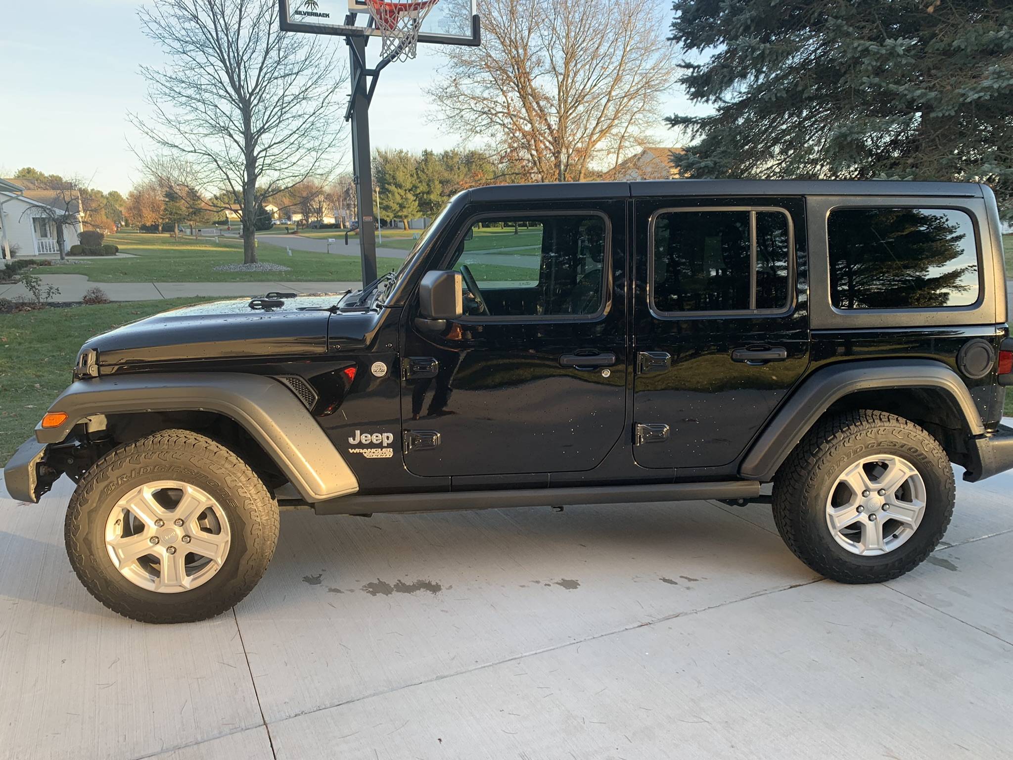

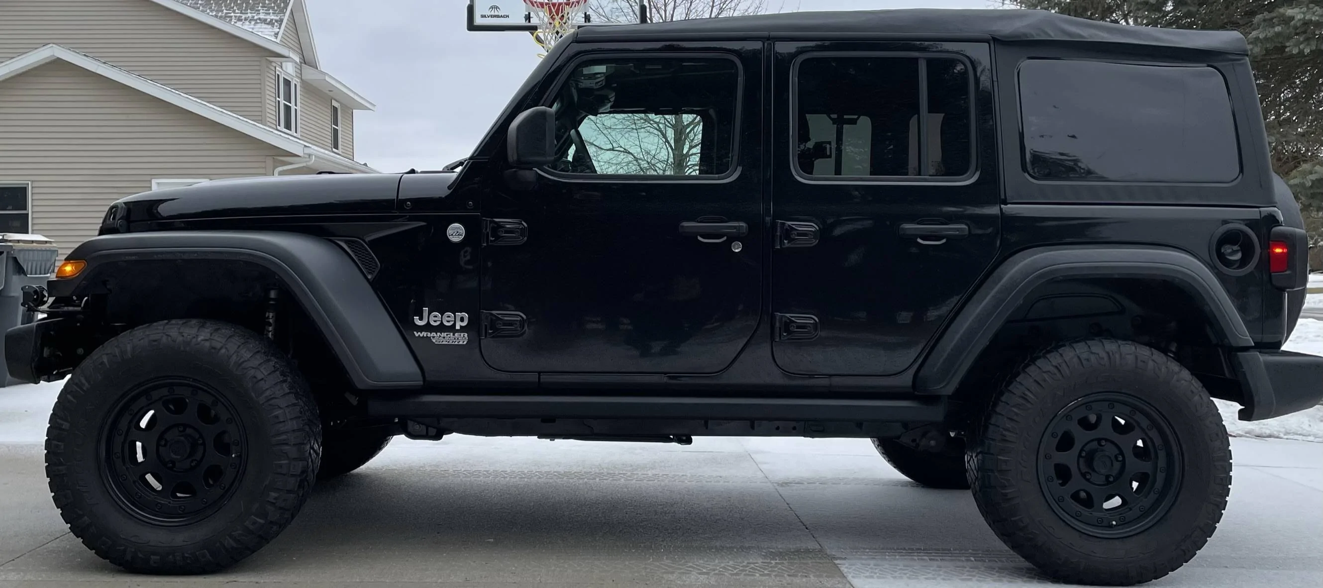

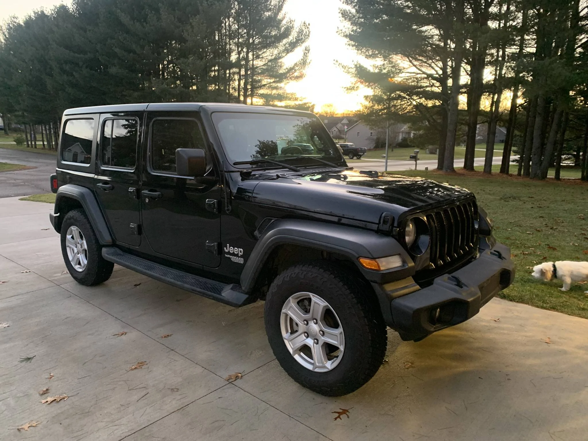

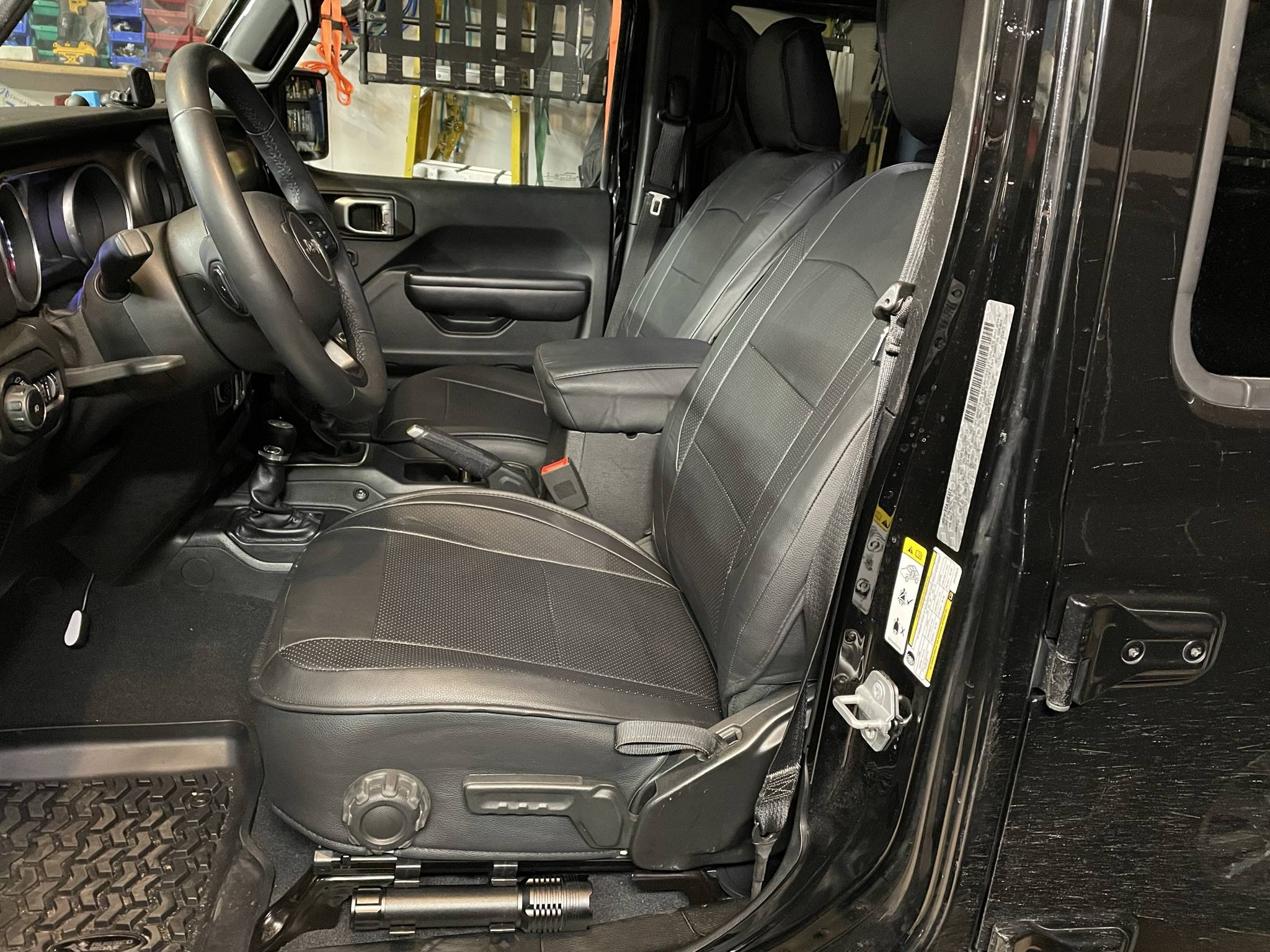

2018 JLU Sport - Purchased with 45,000 miles. Lived its first 45k in Tennessee.
6 Speed Manual Transmission
3.6l 6 cylinder engine
It is not a Sport S, but did come with power windows and locks.
Jeep Wrangler JL Michigan 2018 Sport Unlimited JL - Moderate Budget - Maximizing Wheeling IMG_1218.JPEG

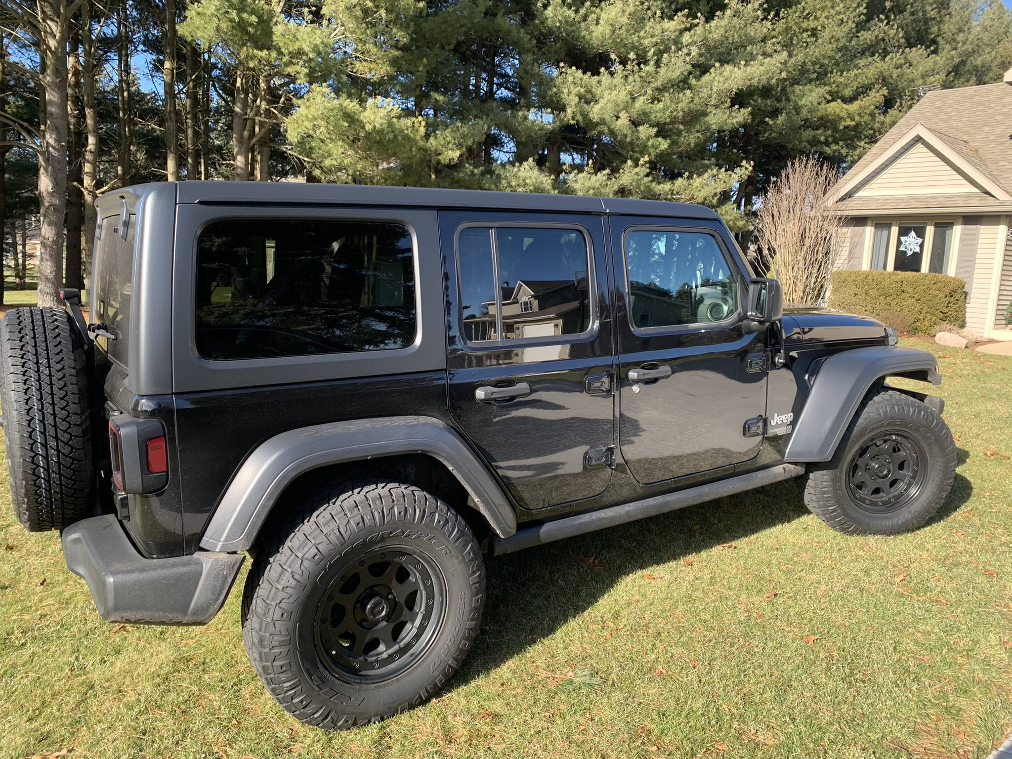

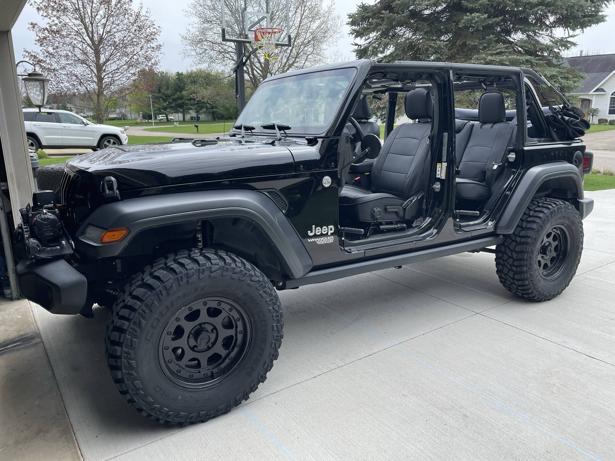

Removed sport wheel well inserts and added used Rubicon Rock Sliders
Jeep Wrangler JL Michigan 2018 Sport Unlimited JL - Moderate Budget - Maximizing Wheeling IMG_1223.JPEG

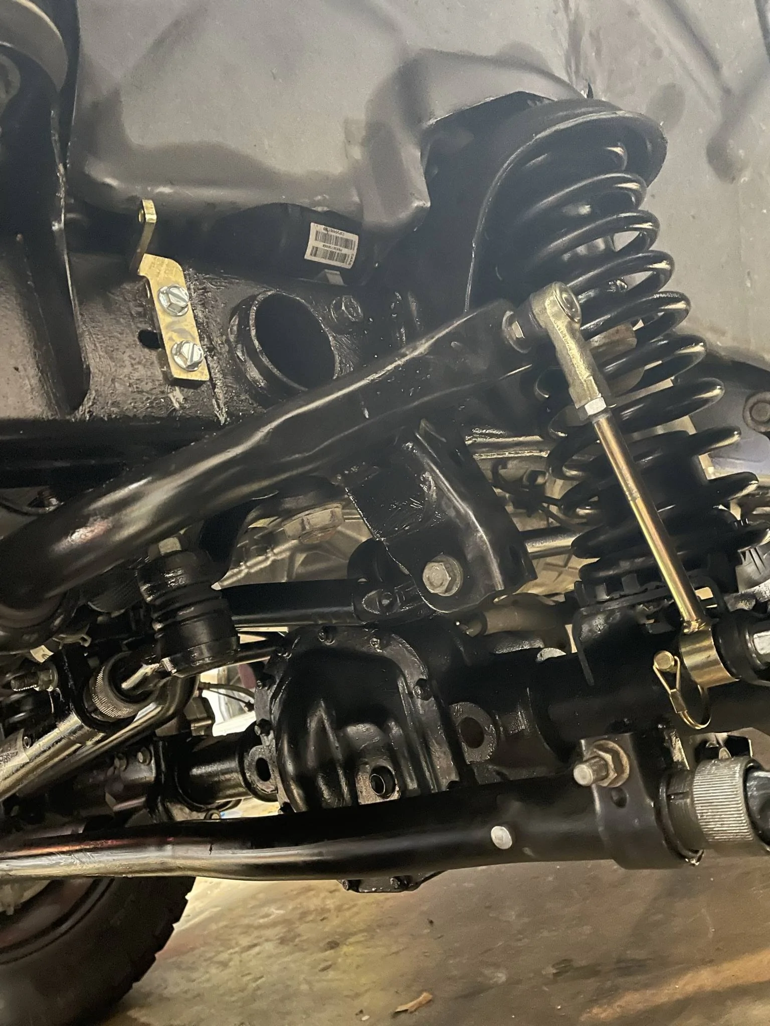

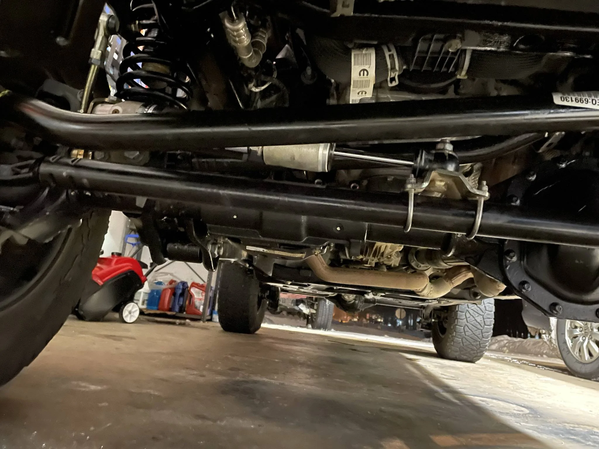

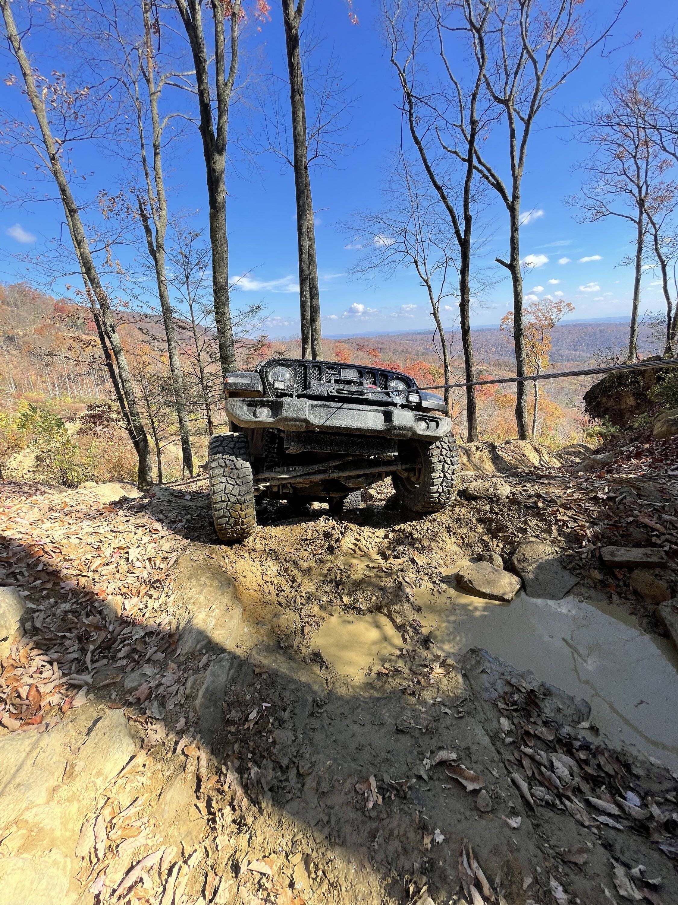

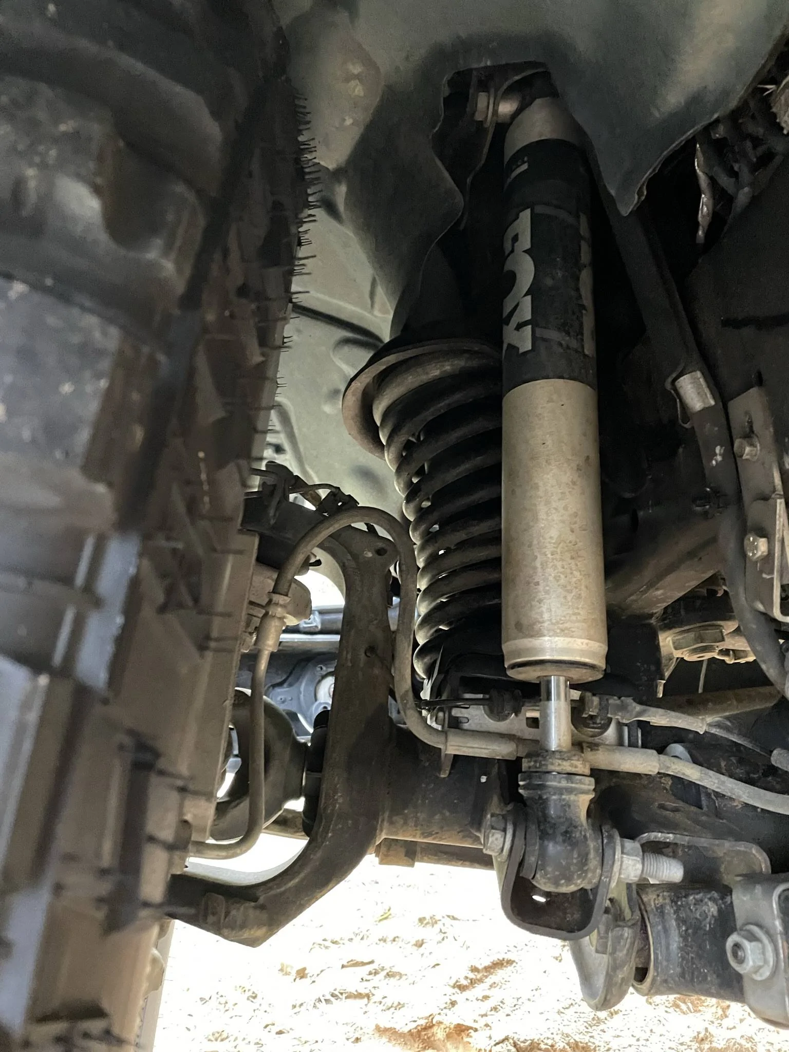

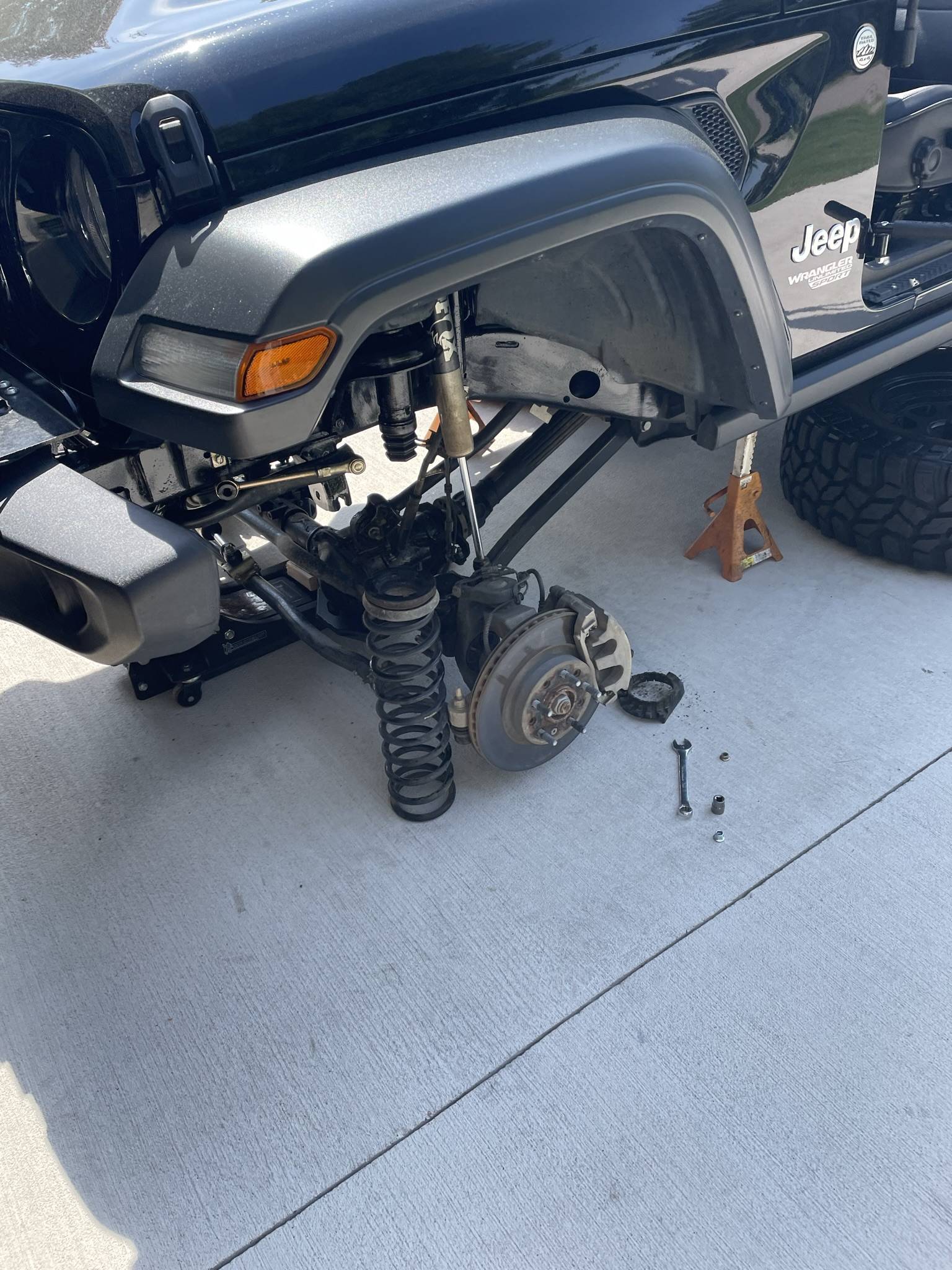

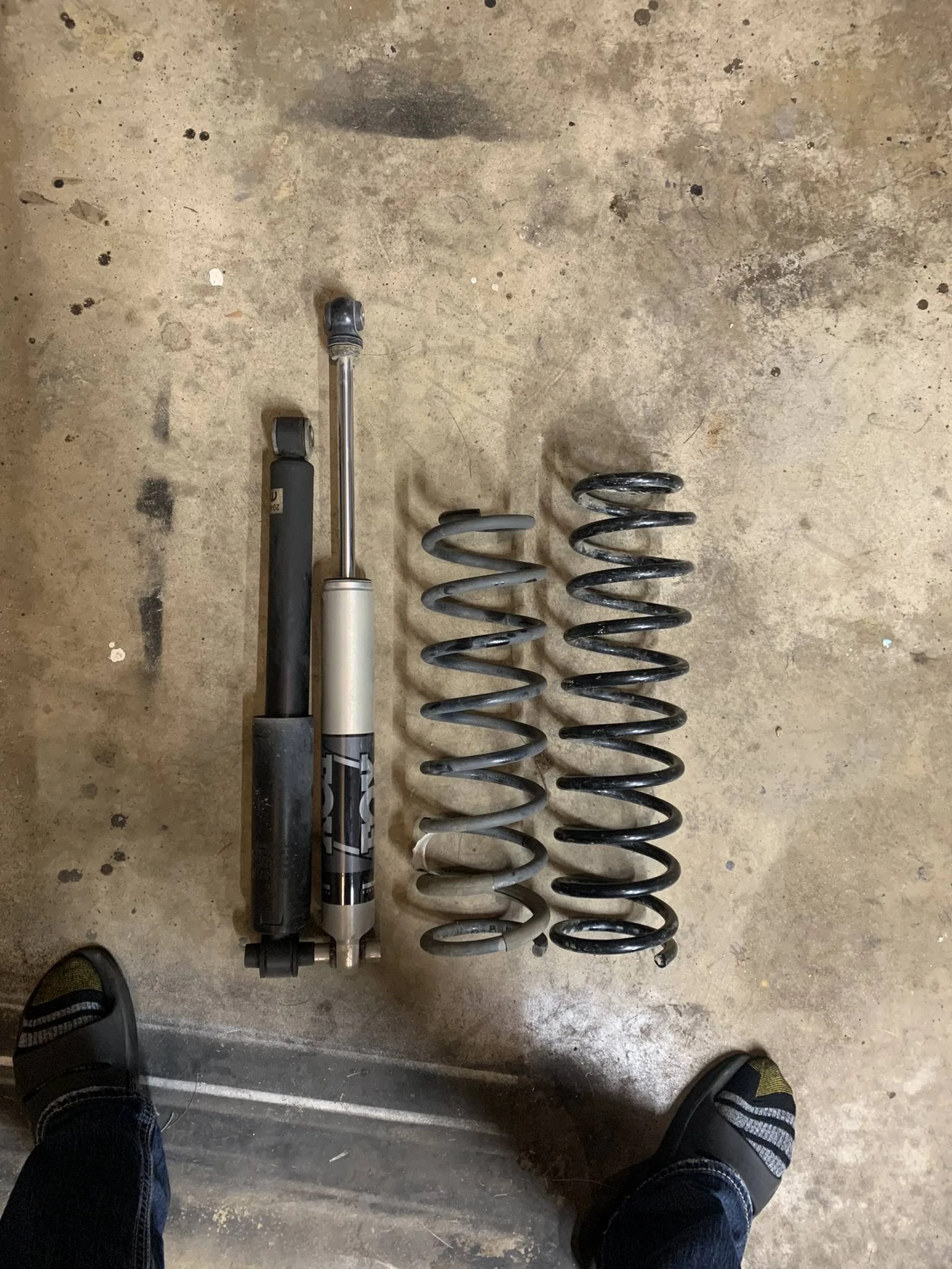

Dynatrack Endurosport 2" Lift with Fox Shocks
M220 RC Rear Diff Skid
M186 RC Front Diff Skid
RC Lower Control Arm Skid
Metal Cloak Front Sway Bar Disconnect
Metal Cloak Sumo Spring Bump Stops
Metal Cloak Steering Stabilizer Relocation Bracket
Fox Steering Stabilizer
3/4" Spacer Lift in front to compensate for winch weight
RockHard Winch Plate
Purchased used, Sailcloth Mopar Softtop
Jeep Wrangler JL Michigan 2018 Sport Unlimited JL - Moderate Budget - Maximizing Wheeling IMG_1712.JPEG

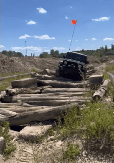

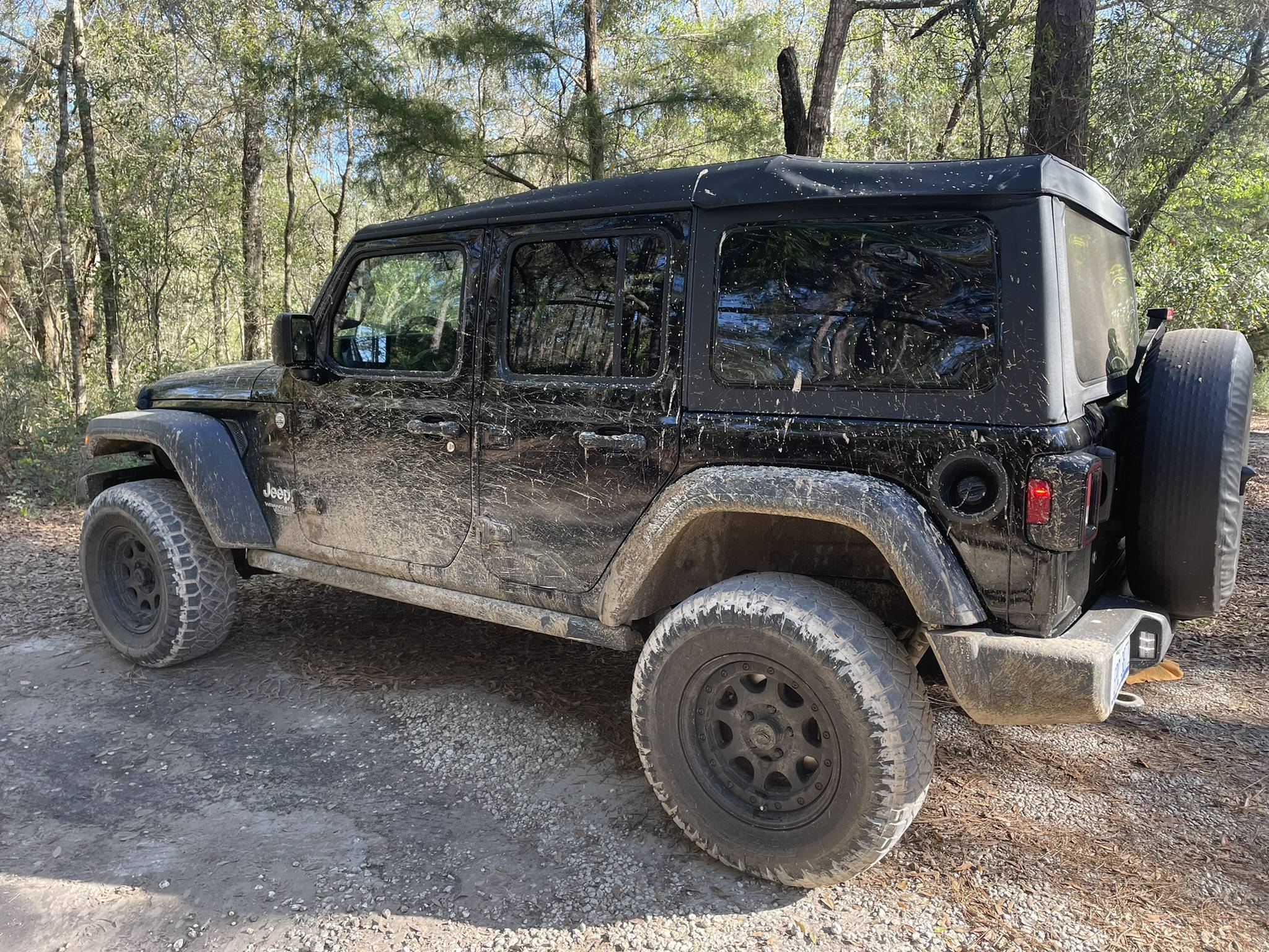

Tested build at Holly Oaks....
This is where the reality of my 35's on stock gearing really started to be obvious. First of all, I had zero pep in the jeep in 4 high. Just zero power. It wasn't fun to try to drive fast if that makes sense.
I also had a horrible experience on this log obstacle. The logs were difficult to get thru. 4 Low was way to fast to crawl thru. I ended up riding the clutch to slow things down. I burnt the clutch and at one point got a warning on the dash that I needed to let the clutch cool down. You can see in the video, smoke bursting from my clutch at one point.

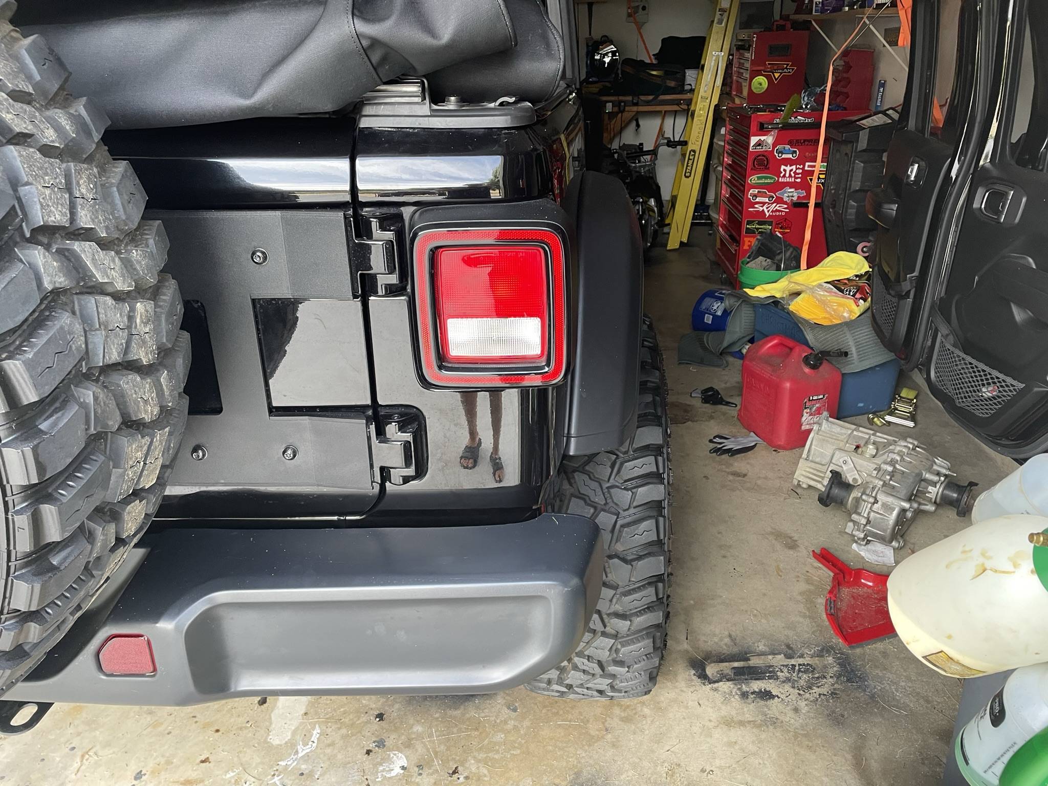

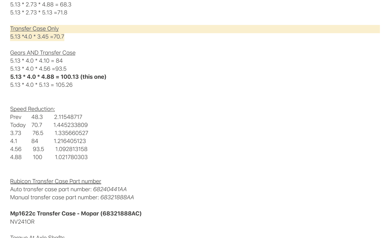

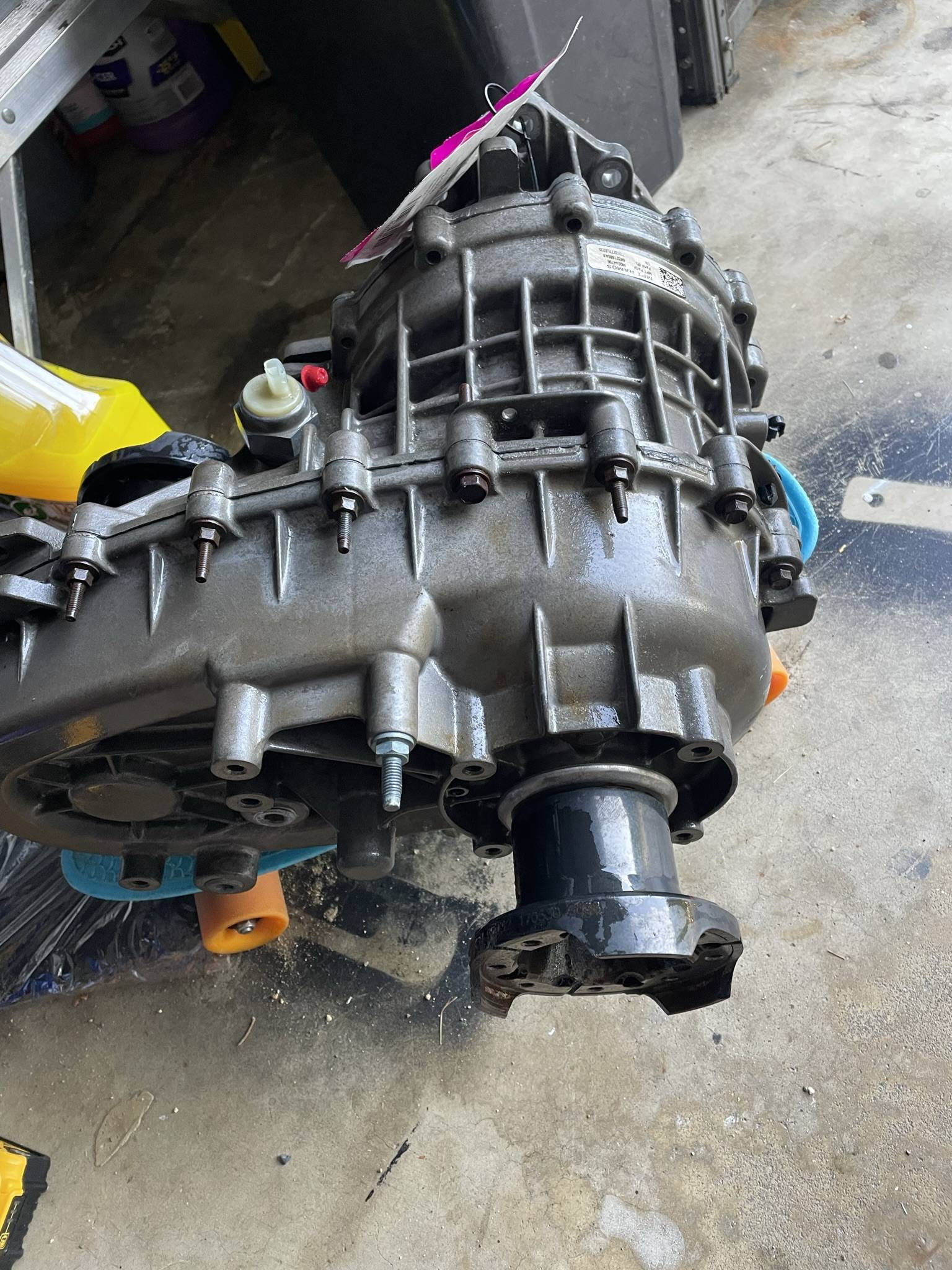

Next project... Rubicon Transfer Case...
Looking at crawl ratios...
Transmission first gear: 5.13 to 1
Transfer case Low range 2.72 to 1
Differential: 3.45 to 1
5.13 x 2.72 x 3.45 = 48.14
This is my current Ratio: 48.14
If I just replace the T-Case the 2.72 turns into a 4.0:
5.13 *4.0 * 3.45 =70.7
Rubicon Transfer Case Part numbers:
Auto transfer case part number: 68240441AA
Manual transfer case part number: 68321888AA
The difference was amazing! 48 to 71 was really useful.

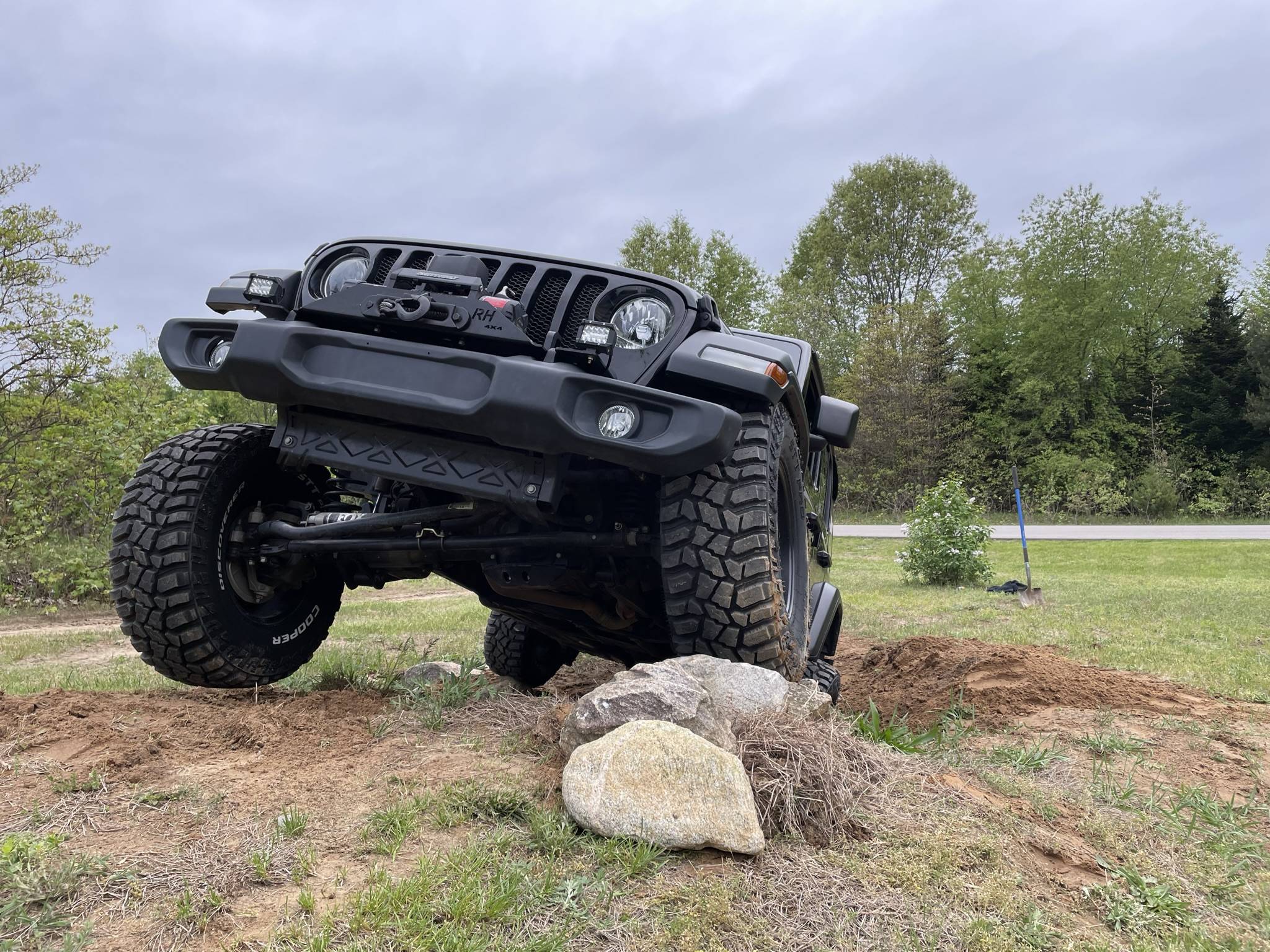

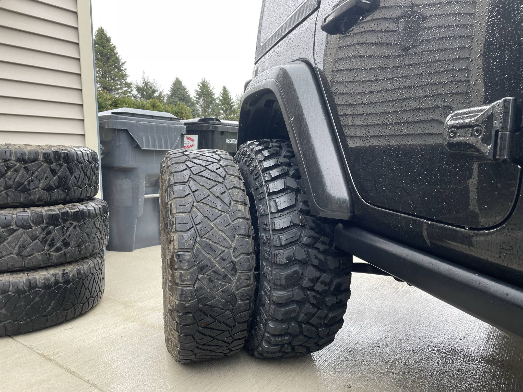

Next up. Drummond Island.
Learned a few things.
4 Low is Great. I should spend most of my drive time in 2 hi or 4 low. 4-high is just weak. Check out the video. Great week. Jeep did amazing. With the manual, you have to pick your line and go. Letting off of the drivetrain by releasing the clutch is not the right move.
I do wish I had a lower crawl ratio.
Drummond Island Video
Jeep Wrangler JL Michigan 2018 Sport Unlimited JL - Moderate Budget - Maximizing Wheeling IMG_5104 (1)

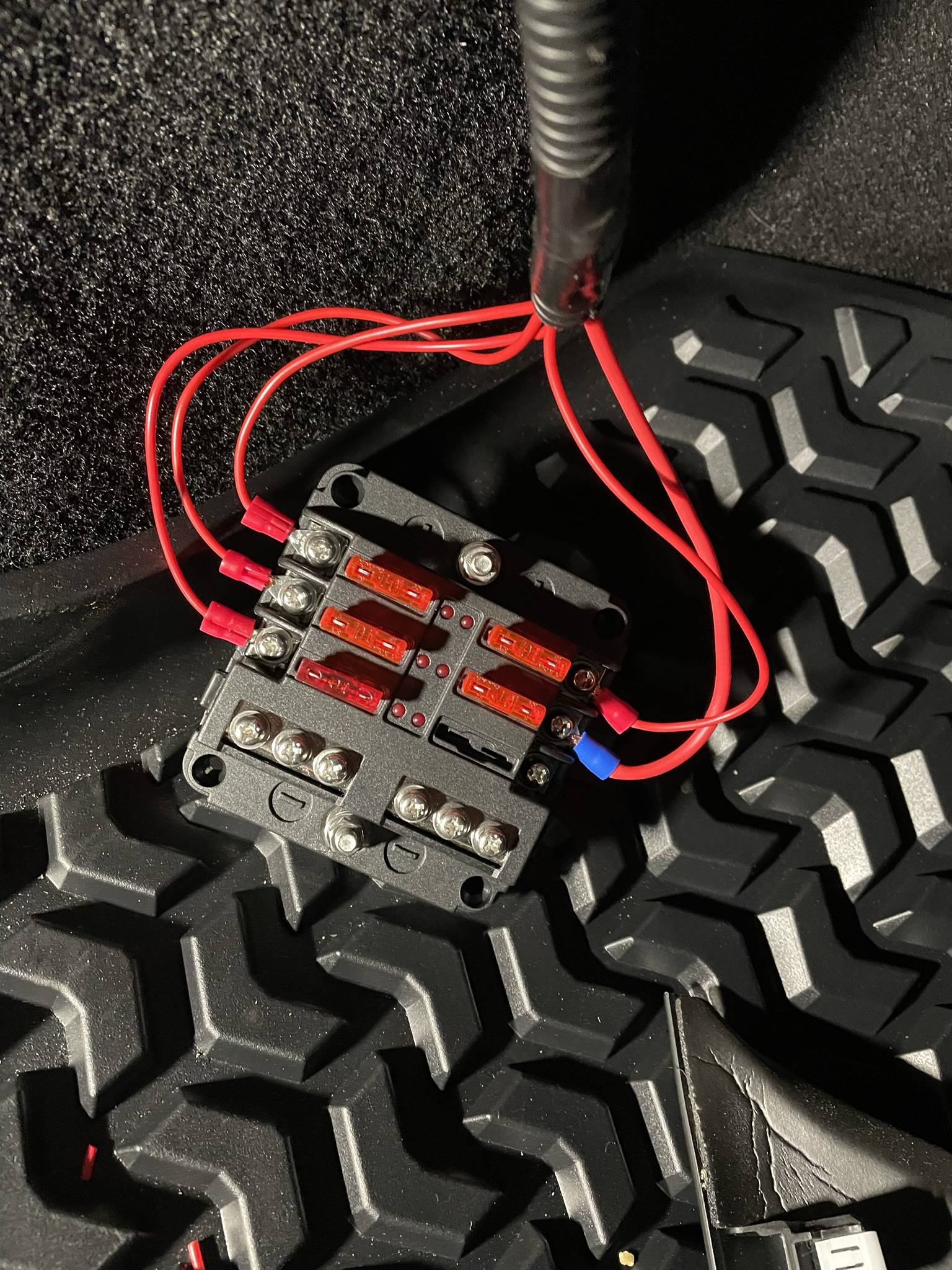

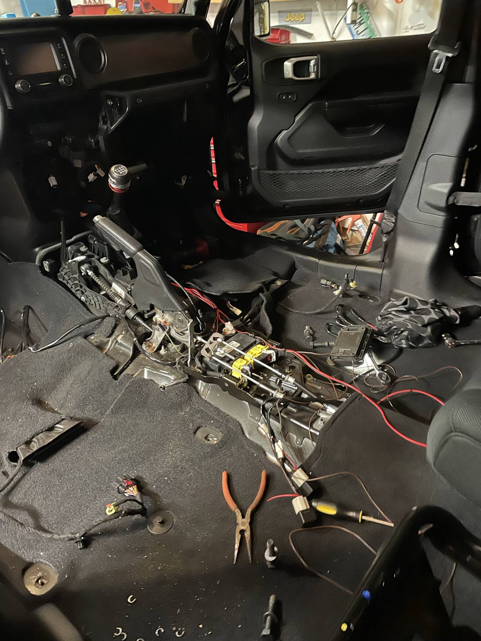

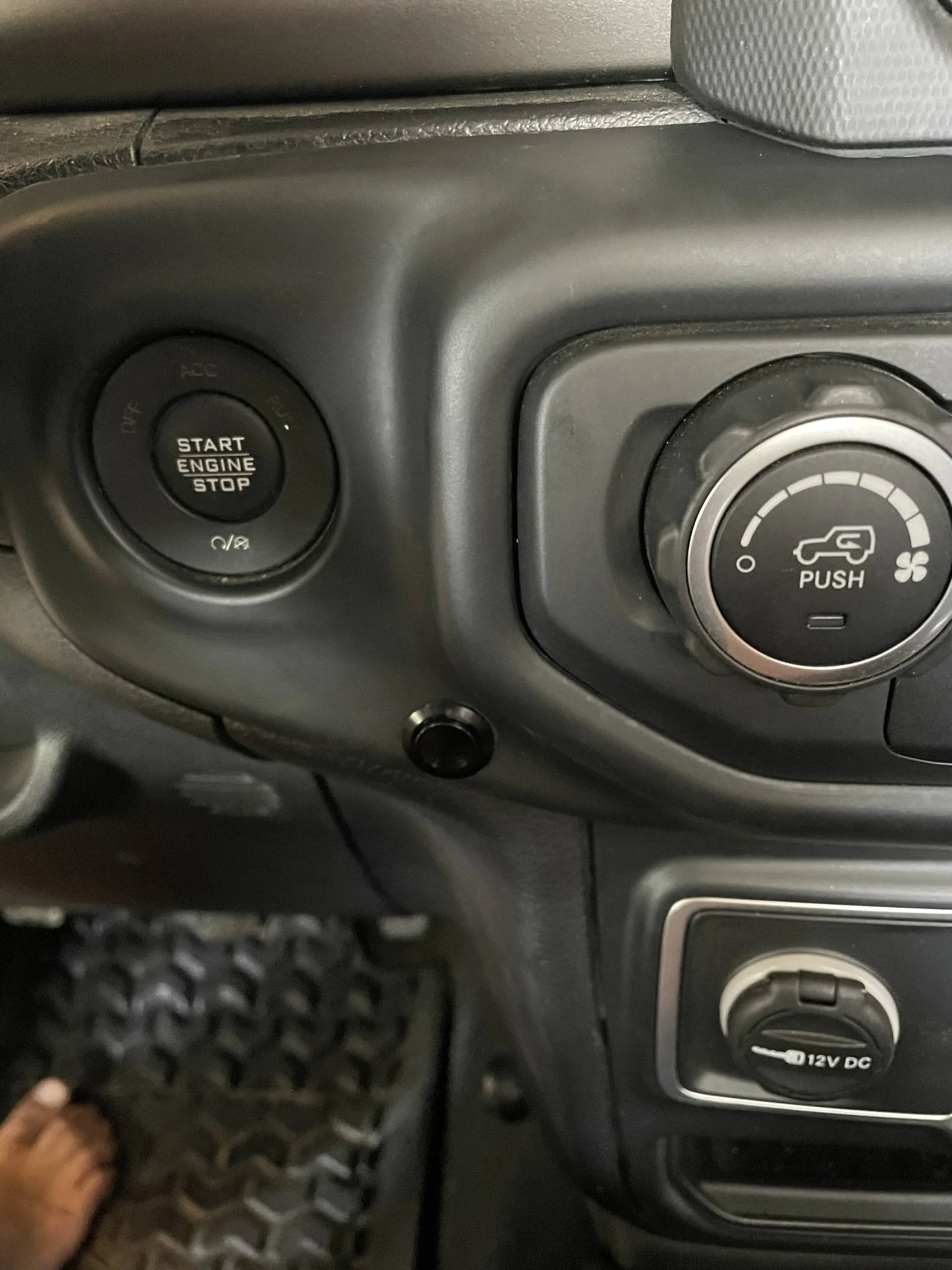

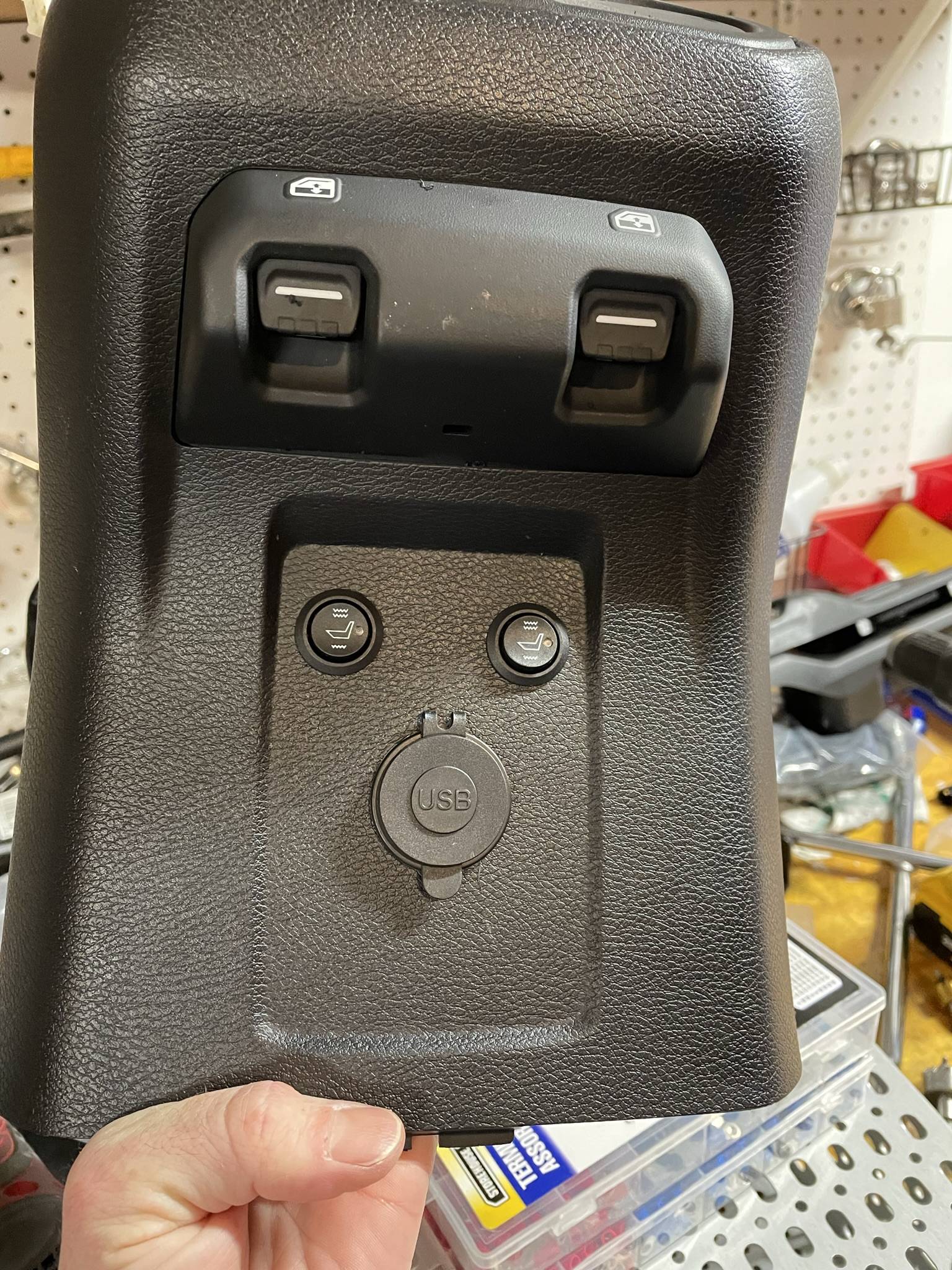

Also, I wired in a clutch bypass switch. This works in 4low only. If I push this button, it will start the jeep in gear. The idea being in a location I want the jeep to move forward with out the clutch.
Clutch Bypass Video
Jeep Wrangler JL Michigan 2018 Sport Unlimited JL - Moderate Budget - Maximizing Wheeling IMG_3597.JPEG
