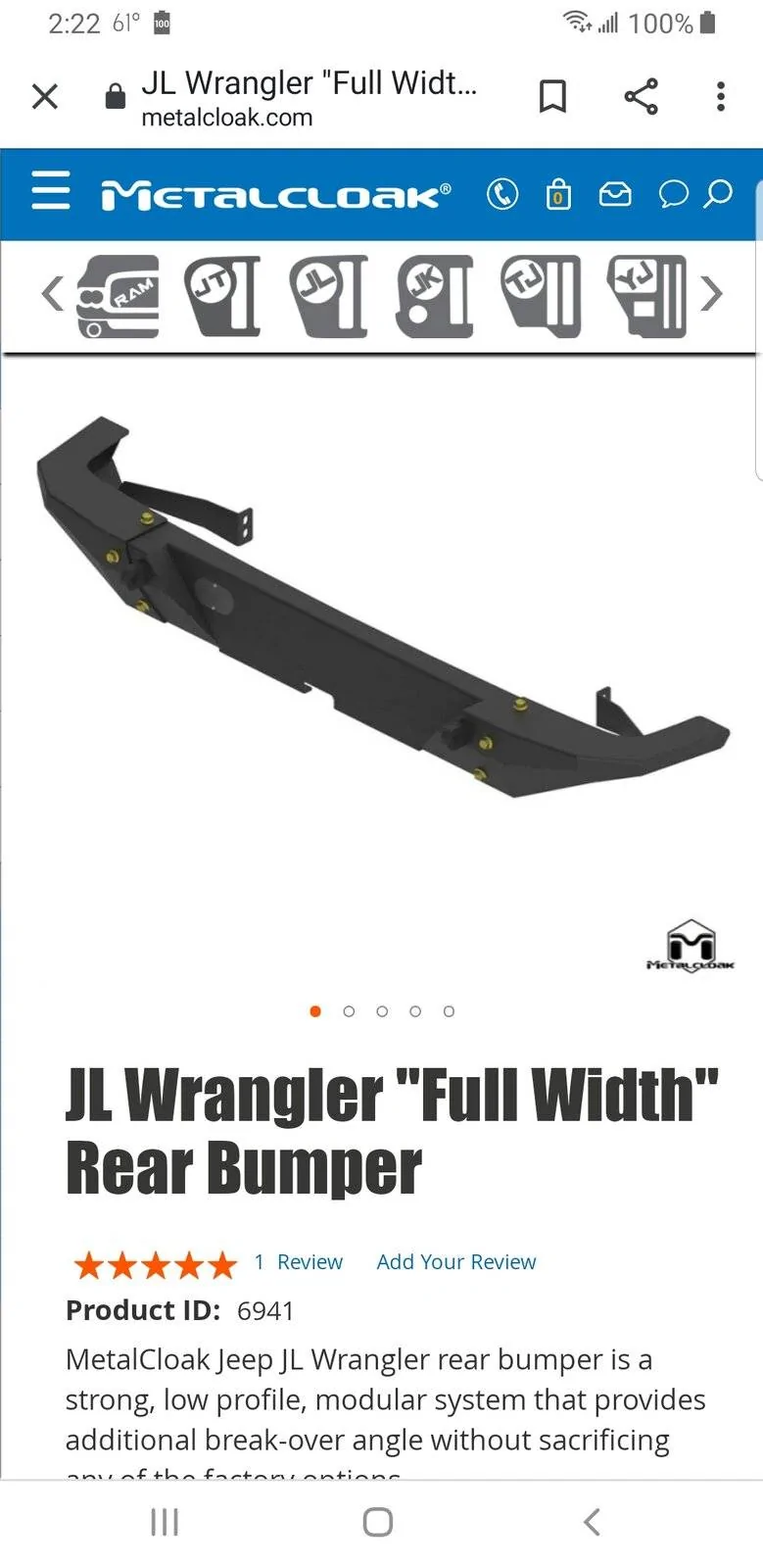

I just placed the order for the jl full size rear bumper. I don't see any way to attach the backup lights or the license plate. I already have the mopar 3rd brake light relocate so I am wondering what more I need to know the plate legal in California and have operational backup lights. Thanks.
Jeep Wrangler JL MC rear bumper licence Screenshot_20210704-142255_Chrom

The most important things in Ca are to have the license plate light and the plate not be mounted over a certain height from the ground. Not having the light will get you a ticket faster then the plate being slightly mounted to high.

So my question is does the MC bumper have lights for the plate or do I have to opt for the relocation kit in the spare.

As show above in the posted photo it does not have the license plate light.

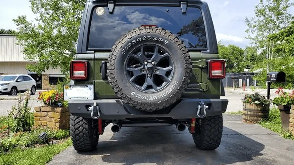

I had the same problem with my Rugged Ridge rear bumper. I went with 11238.15 which included a pair of LED license plate bolts. They were junk, and Rugged Ridge wanted me to jump through more hoops than it was worth to me to get a replacement for the one that broke, so I ended up going with this. I wired the light to the existing tag light harness that I extracted from the original bumper. The bracket is quite sturdy. Installation requires drilling two holes in the bumper. I got mine as close to the tailgate as possible, while still allowing enough clearance to swing it open.
Jeep Wrangler JL MC rear bumper licence 1625441280524
