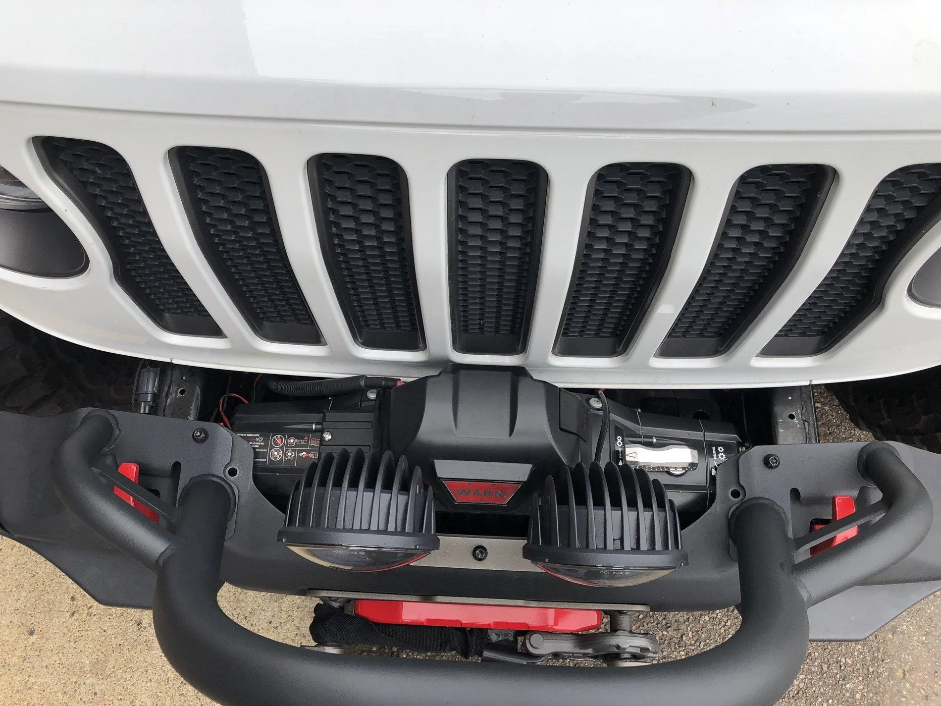

How close does the winch sit to the grille with maximus 3 winch plate? Do you have any pics from above?Just wanted to say I recently purchased the Maximus-3 Winch plate, D-Ring loops and license plate Stealth mount and absolutely love them!
Very strong easy to install (even with the modifications needed for the D-Ring installs). Plan on ordering the filler kit (I missed those in my original order) and maybe the loop still undecided on that.
Thanks @Maximus-3 for the great products!
It depends on the winch. For example: the Warn Zeon sits very close, because it's a very large winch. The smaller winches, like an X20 or VR, have a bit more room.How close does the winch sit to the grille with maximus 3 winch plate? Do you have any pics from above?
Do you happen to have a pic with a x20?It depends on the winch. For example: the Warn Zeon sits very close, because it's a very large winch. The smaller winches, like an X20 or VR, have a bit more room.
We are just working with the limited space FCA provided. If we spaced it any further forward then the winch would start making contact with the bumper. We choose the sweet spot to mount winches.
