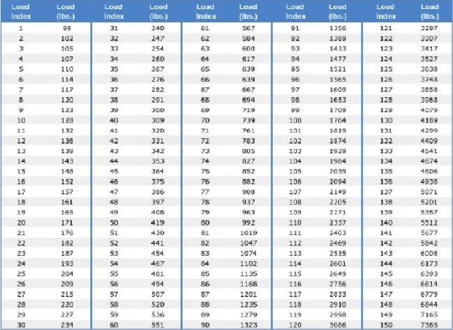

Now what about Load Index? Like mentioned previously, Load Index is an assigned number that corresponds to the load carrying capacity. More specifically, at the maximum pressure. The assigned number or Load Index can be seen on the chart below.
*Please note that this chart only goes up to 150 as most LT truck tires today do not exceed 128
So lets take the Load Index 123 for example. This Load Index tells us that the corresponding load carrying capacity is 3417lbs at maximum pressure. Now it doesn't show what the maximum pressure is so we now have to go look at the Load Range on the tire we are looking at.
Taking the example of LT-Metric Sizing listed earlier (LT265/75R16/E 123R). We know the tire is 10 ply rated and is narrower than 295mm in section width which tells us that the maximum inflation pressure is 80 PSI. By using the Load Index chart we know the 123 Load Index carries 3417lbs at maximum pressure. So from what we have discussed, we now know that the LT265/75R16/E 123R tire carries a maximum load of 3417lbs. @ 80 PSI.

A common OE (original equipment) LT tire size is LT245/70R17/E 119S. By using what we have learned above we know that this LT tire size carries 2998lbs @ 80 PSI. Now lets look at an LT315/70R17/D 121T which is a common plus size LT tire. Again, from what we have learned above we know this tire carries 3197lbs @ 50 PSI. So even though the OE tire we used for an example is E rated with a maximum pressure of 80 PSI, the plus size D rated tire carries more weight at a lower pressure. In other words, LOAD RANGE E doesn't always mean the tire can carry more weight at maximum pressure when compared to LOAD RANGE D at maximum pressure.
