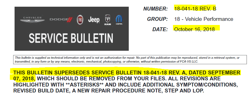

Hey everyone,
This thread has died down over the last few weeks, however, we wanted to make you aware of a Technical Service Bulletin that was released on Oct. 16, TSB 18-041-18. One of the symptoms that this TSB will address is "excessive blower fan noise when the A/C is on MAX output." We recommend speaking to your dealer about this TSB. As always, feel free to send us a private message if you have questions or concerns! :)

@JeepCares ... The TSB number you referenced doesn’t mention a cooling fan problem. Also, it was released on September 7th, not October 16th. Be kind enough to double check the TSB# for us please.
It doesn’t mention the cooling fan, however, the instructions say to flash the engine software (which is what activates the cooling fan operation). I bet this is the correct TSB, but it hasn’t been updated to include the fan run time yet.

Hi 47Jeepster,
I have kindly double-checked the TSB below for you:
Jeep Wrangler JL Loud cooling fan? upload_2018-10-24_10-5-27
Jeep Wrangler JL Loud cooling fan? upload_2018-10-24_10-6-19
