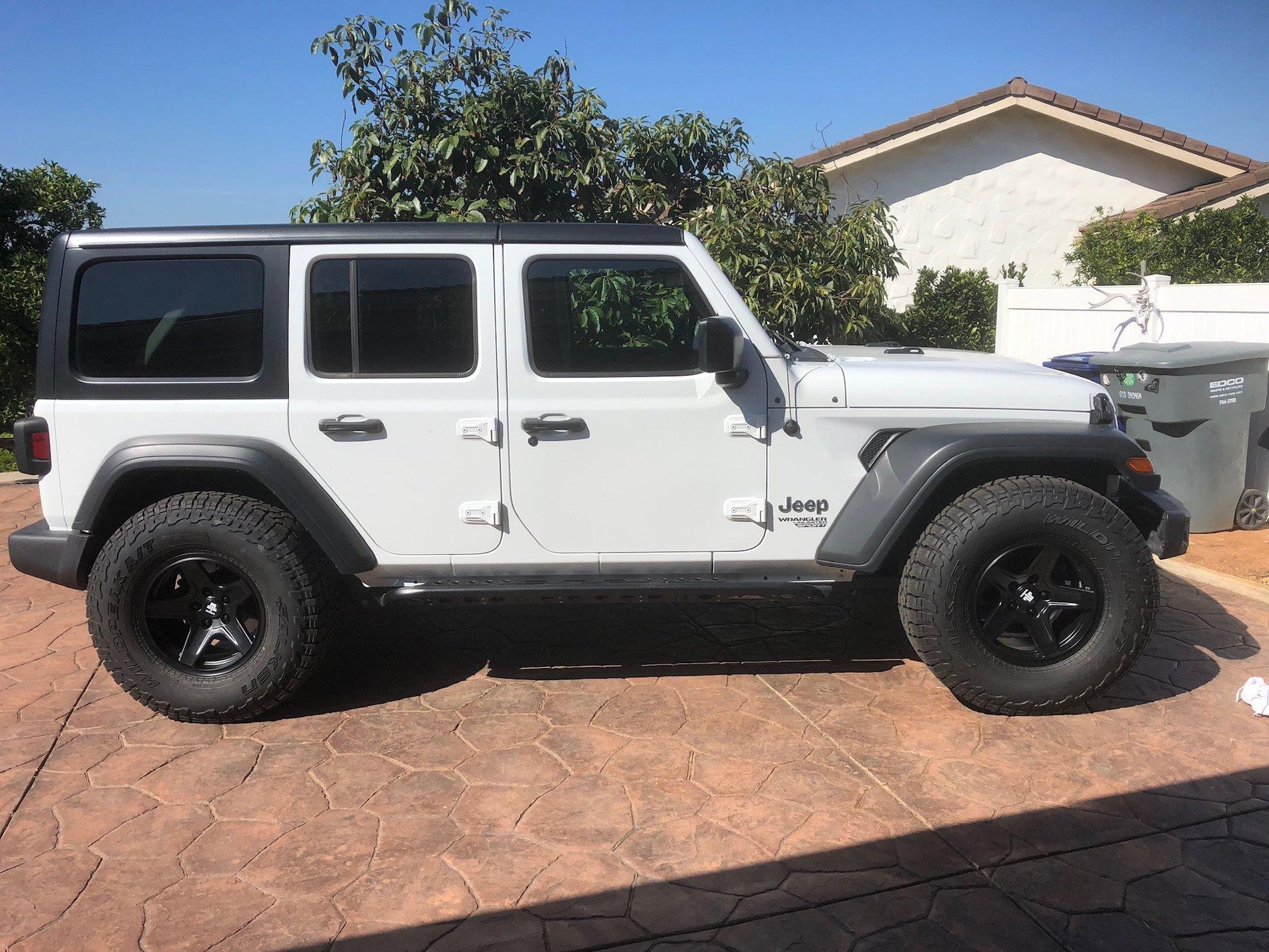

I just installed the Fox 2.0 damper and noticed an immediate improvement. Guess the easy way to explain it is it deadens the steering wheel a bit, so you don’t make those little inputs/ steers in every time you hit a bump.
It wasn’t as noticeable when I had the stock 31s on, but when I went up to 35s it really got magnified.
Next month, a Teraflex 2.5.
