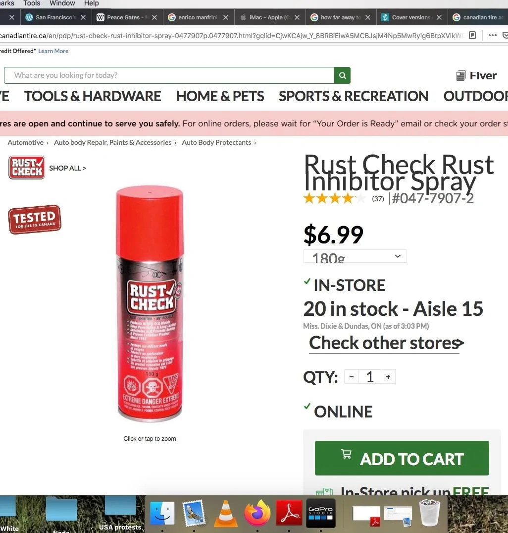

Coming from a TJ and all the crap that gathered in the frame (wish I had filled with spray foam day one), has anyone looked at similar on the JL? Just wondering what simple things I can do to save myself issues if I keep this thing a long time like I think I will.
I just spray antirust oil inside the frame. It is important to do so during summer months so the oil gets nicely sealed by road dust . I do this every summer with any vehicle I ever owned . When I see the gigantic mountains of road salt dispersed on our Ontario roadways I wonder if there is any salt left for you people in the rest of the country.
