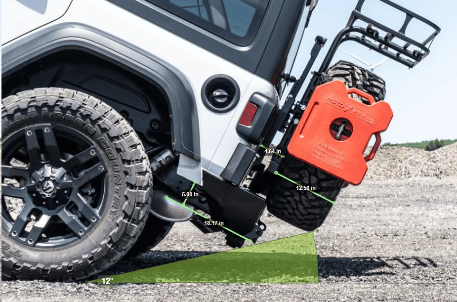

See the attached image, I hope this helps answer some of your questions, the dimensions are approximate. We designed the trailer plug attachment as if it were an option. You can remove it if your not running a trailer. You can see in the image that the trailer plug, integrated hitch, and spare tire are on the same departure line. So if your running 37's there is a good chance that your spare might hit before the trailer plug. Of course if you drop off a ledge I bet that plug housing will take a pretty good hit...being formed 10ga steel!

Wow. Thanks for the transparency and the detail. This bumper looks like it will work really well for overlanding. Some, however, may prefer less of an impact on their departure angle.

Maybe its misleading, the departure angle of our JL with this bumper/carrier is approx 42°, no impact from stock on departure angle! Granted we are on a 2.5" lift and 35" tires. In the picture above, the Jeep is actually sitting on a 30 degree incline.

Good to know. I love this bumper, and am saving my pennies.

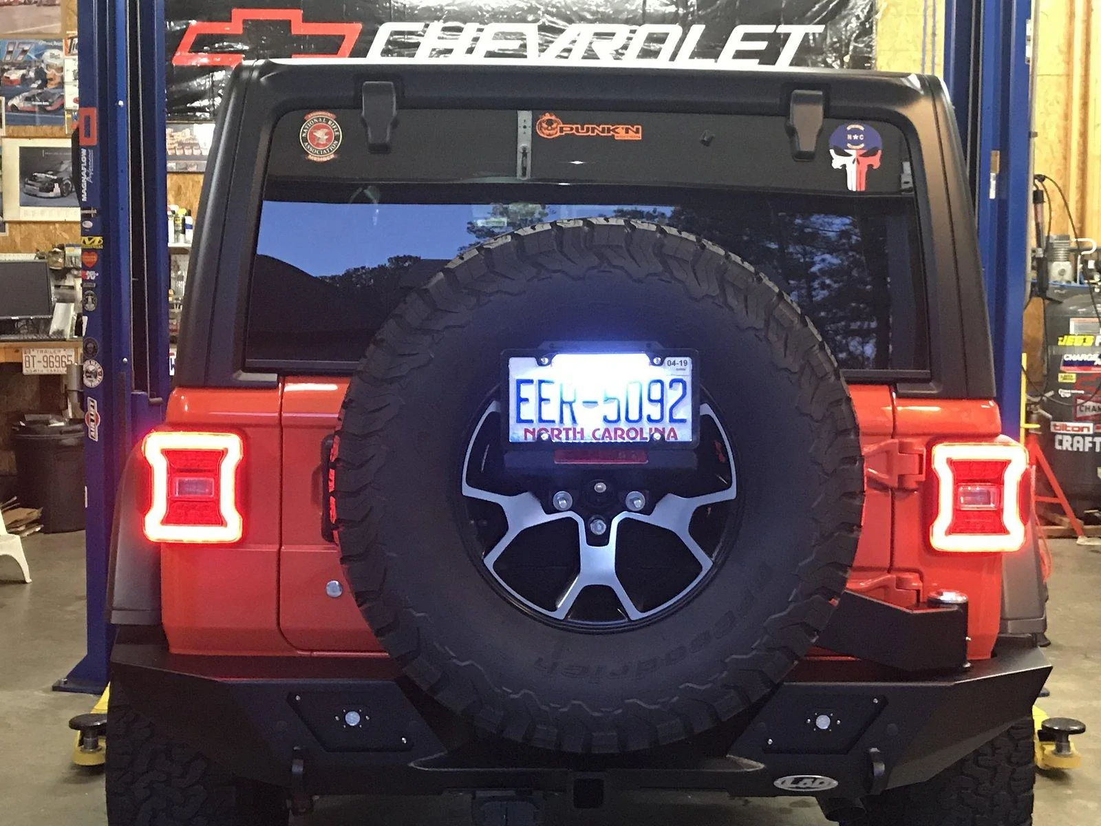

Got finished and all wiring completed for the B/U lights , 3rd brake light and the tag light. Camera kit worked like a charm.
Did the harness included with the lights work fine or did you buy the separate reverse harness?
Made my own reverse light wiring. I just tapped into the trailer wiring harness behind the passenger tail light. Power draw on the B/U lights is low and work great.
