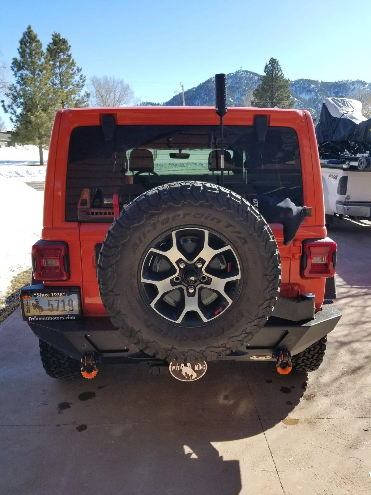

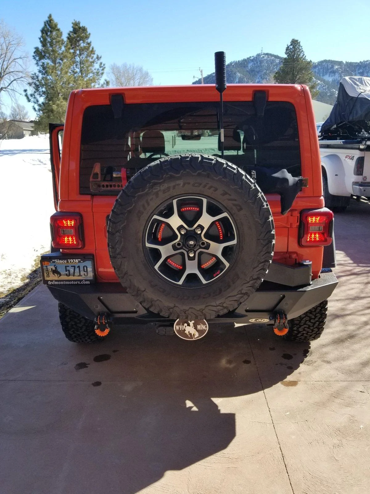

I can report on the full width Destroyer bumper, it is very well packed, you will spend some time and effort getting everything unpacked and laid out. I installed this myself, no rear sensors, but with the backup camera relocation and am waiting on my rear lites in the bumper. All bolts were blue thread locked and torqued to specs. This is a bullet proof bumper, the swinging spare tire carrier is well built and thought out, it attaches to the rear door very well and swings with the rear door beautifully. I am very impressed with the design and build of this bumper and the options to be able to add in the future as needed. Money well spent in my mind..

I also see you opted to go without the third brake light. I assume the rules in WY are the same as here in CO - a third brake light is optional. I plan on doing the same.

Just be ready to take your time working on the backup camera relocation of the optic cable, patience is the key, removing the right side rear panel. I have the Alpine sub back there and i took a lot of time removing all the plastic, then it is a test when you slide the protective harness cover over the optic cable extension, and i made it even more challenging by installing 2 wires for my 3rd brake lite inside the harness. I installed my 3rd brake lite in the center of my spare tire, and it does a great job. I took about 8 hrs, i was working by myself and i also installed my cell booster at the same time, that is the antenna sticking up to the right of center of the spare. And i need to send out a thank you to @northridge for their help when purchasing my bumper
