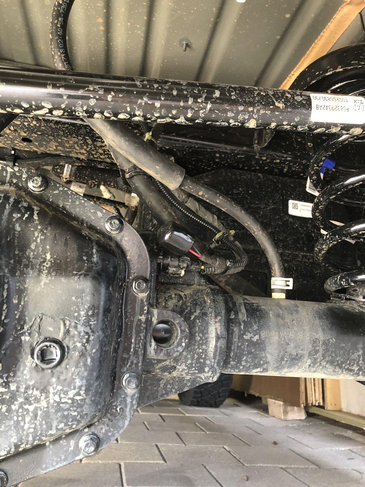

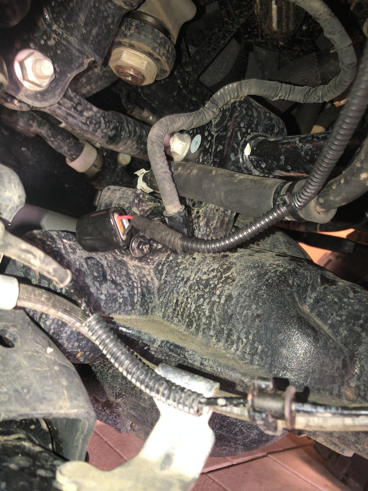

y'all having trouble understanding what he did. hes got the "factory wiring harness that his rubicon came with all he did is run two "extra" two wire harnesses to the locker and capped them. so when he removes the factory harness that keeps you from using your lockers in 2H 4H he can plug in with the "Extra harness" and cap the factory harness allowing it to just be active when he pleases. this bypasses all safeties in the computer. this is a great solution you found @Roky i was curious on how i was going to wire up take off rubi axles but this solves that problem perfectly! ill be ordering that harness in a few weeks after i get my 8 switch pod installed! and tested out.

Thanks to jl_john telling me about the Mopar locker wiring harness, I now have the ability to engage lockers in 2wd, 4 high, and 4 low. For those that asked “why would you” it’s great for going through sugar sand and mud in 4 high to get wheel spin and basically trail running with just rear locked in, you can get up over 20 mph without blowing up the engine. It’s a lot smoother when front and rear are locked as you don’t feel that brake dragging as the bld engaging and disengaging, and don’t have to worry about over heating the brakes. There is one small glitch, it throughs a dash code. For me, it’s not a big deal, at start up you get “service axle locker” then goes away, and a little chassis icon with exclamation point stays on over the fuel gauge. Hopefully the tazer will clear it. But for now I just leave factory wiring on and the other one capped off for daily driving.
I wish I had the same but I just wonder if the electrical plug is waterproof ?
The wiring harnesses are water proof, they are identical to the factory plugs, they have the same O ring on them.
