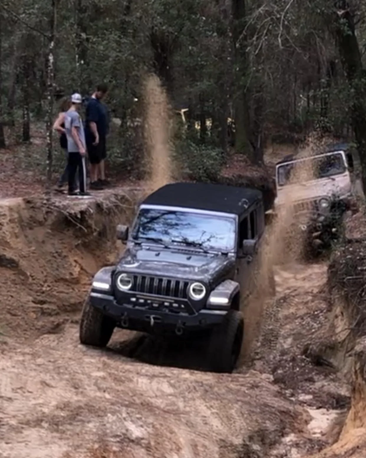

For me it’s to prevent the wheels from slipping, bld works but if you need to give it the gas in certain situations you won’t give the bld a chance to work..... like in picture never gave it a chance to work, to much throttle....driver/front, passenger/ rear giving it the business, other two , nothing.When do you need front lockers absent of front wheels slipping?
Got it. You knew or strongly anticipated wheel slippage. Thanks!For me it’s to prevent the wheels from slipping, bld works but if you need to give it the gas in certain situations you won’t give the bld a chance to work..... like in picture never gave it a chance to work, to much throttle....driver/front, passenger/ rear giving it the business, other two , nothing.
