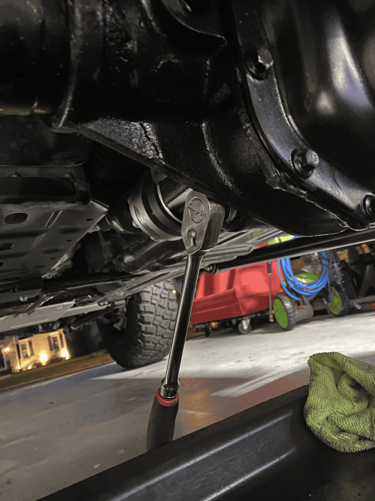

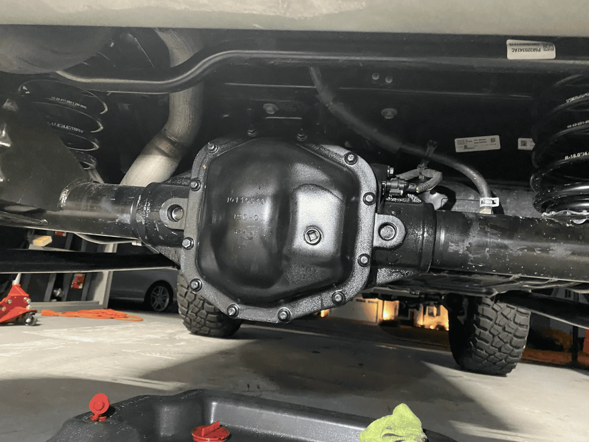

  • Using a 3/8" Drive ratchet, drain the diff fluid into your drain pan. Wait for the diff to finish draining. Clean the drain plug and apply teflon tape to the threads. Reinstall at this time.
  • Using a 10mm socket, remove the diff cover bolts.
  • Using a flathead (or finger tips), remove diff cover.

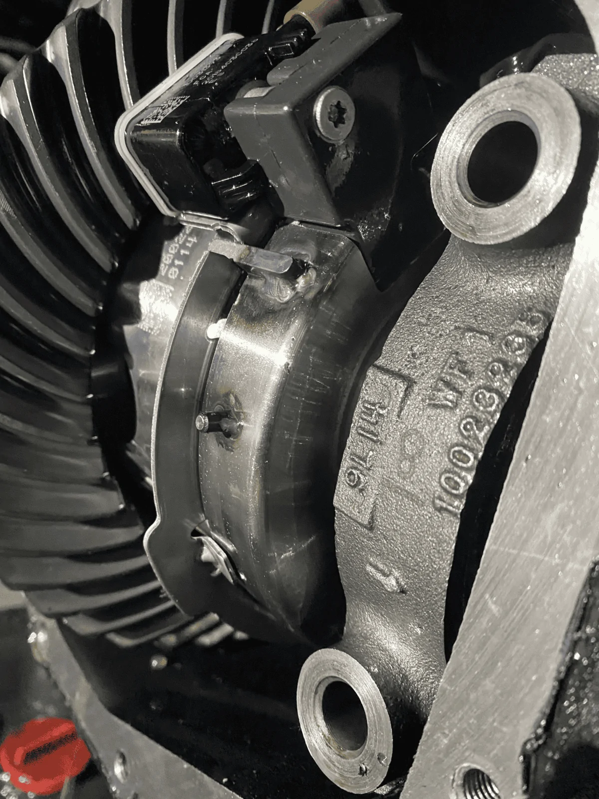

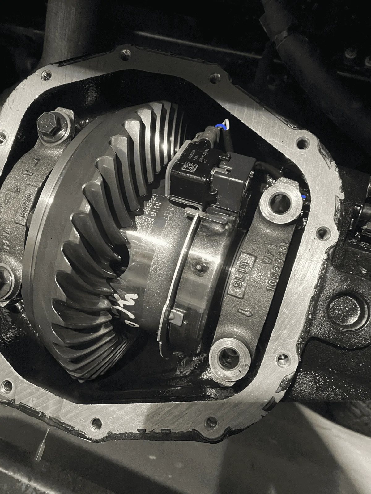

  • Using a 15mm socket, remove the R/H side Cap Bolts.
  • Remove Cap Bolts with alignment plate. Keep the bolts with the plate so they go back in the same spots they came out of.

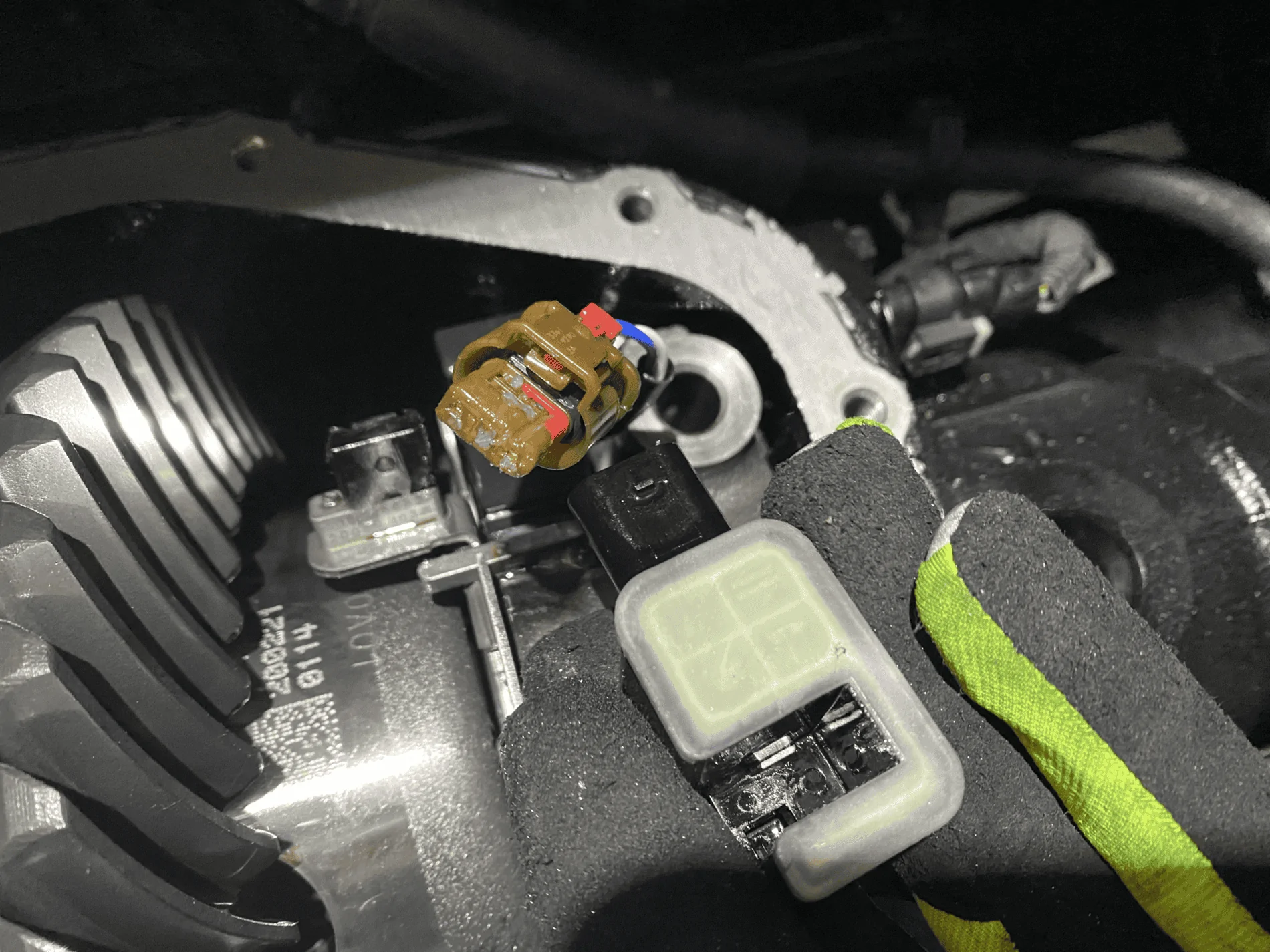

  • Using a T20 bit, remove the screw holding the Locker Sensor in place.
  • Using a flathead (or fingers), disengage connector safety clip.
  • Remove Connector and Sensor.
  • Wipe sensor off using a shop towel or microfiber cloth.

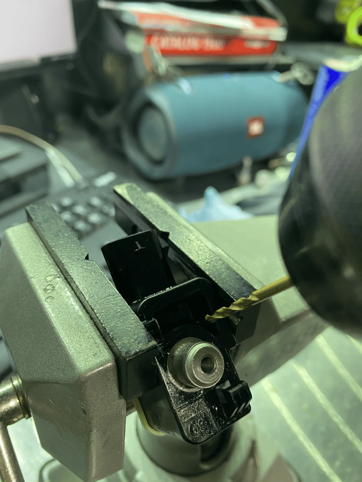

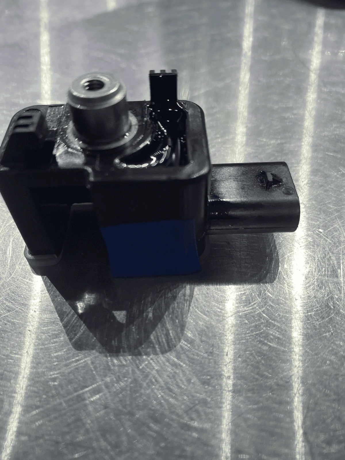

  • Mark sensor as shown in the picture with a sharpe.

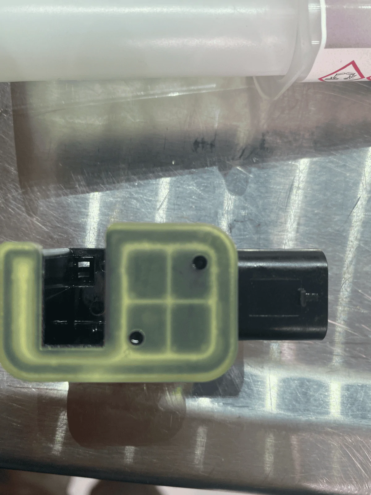

  • Using a 3/32" drill bit, drill 3 holes as shown in the pictures. Be VERY careful with this step as the PCB (Circuit Board) is located very close to the clear cap on the sensor. Drill at a very low speed, with light pressure. We need 3 holes for this work properly. One is used to inject potting compound into the top side of the PCB, one for the bottom side of the PCB, and one to let air escape as we are injecting potting compound. Without an air escape, there will be air pockets and this whole thing will be for nothing.
  • At this point, if your sensor has oil in it, would be a good time to clean it out. Spray some connector/electronics cleaner through each hole to rinse the sensor out. Be sure to let it dry completely before continuing to the next step. You don't want to dilute the potting compound too much. A little bit is ok.

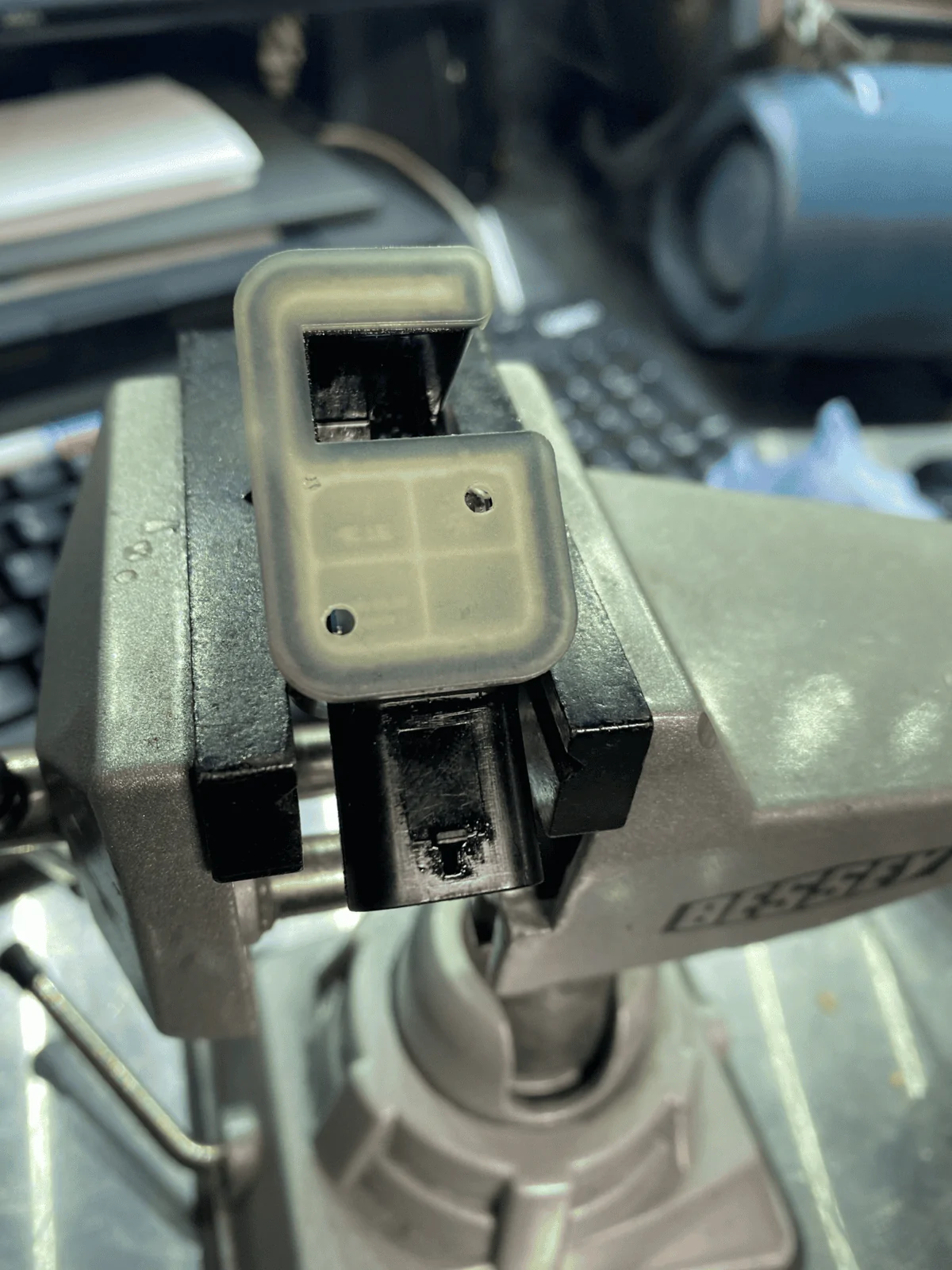

  • Inject potting compound as shown in the video. Once you inject the compound in the bottom hole, you will notice the air being pushed out first and then a rush of compound will come out when it's full.
  • Once the sensor is full, wipe the top side off with a shop towel.
  • Apply electrical tape over the two holes and set the sensor down on its top.

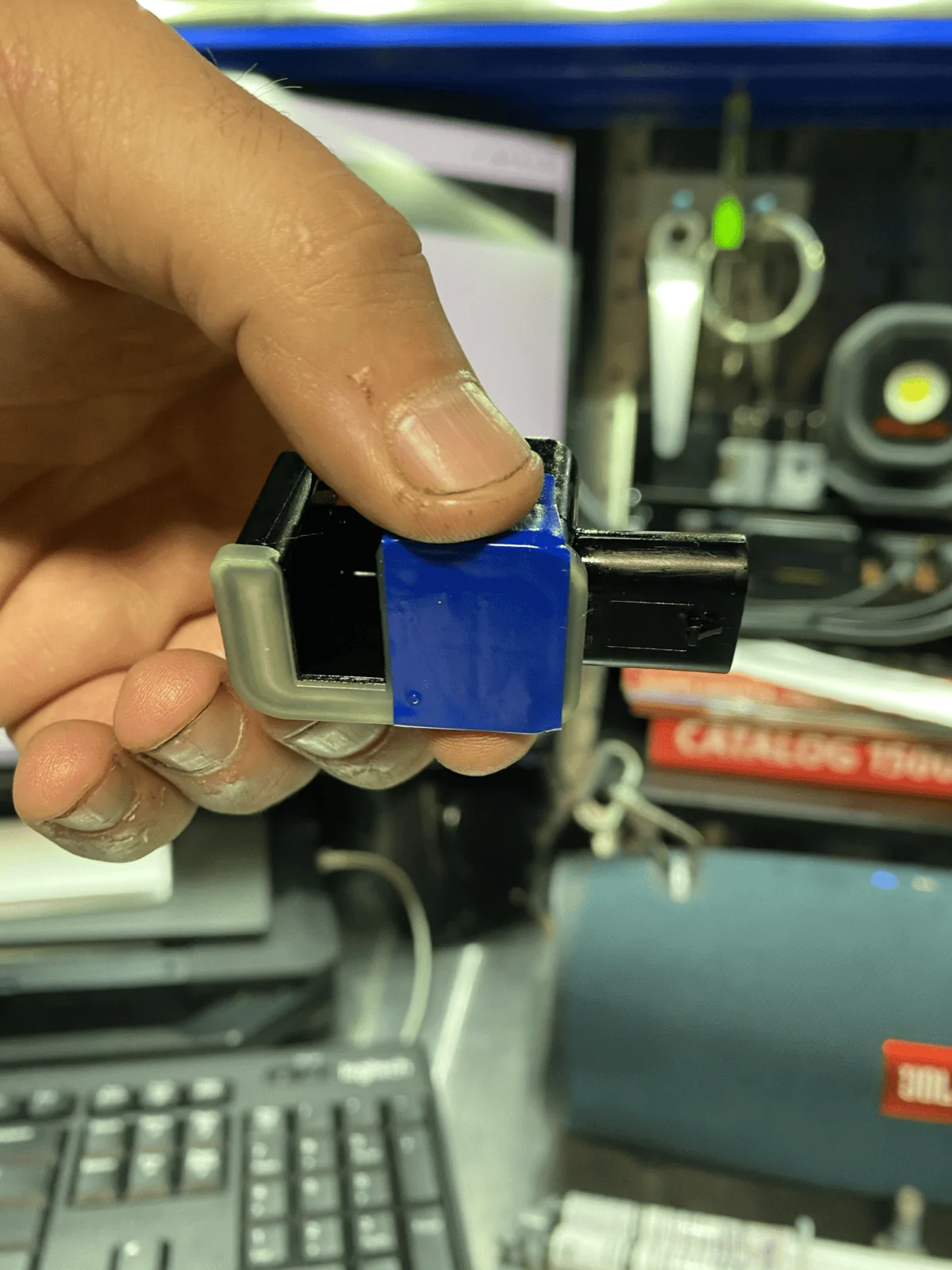

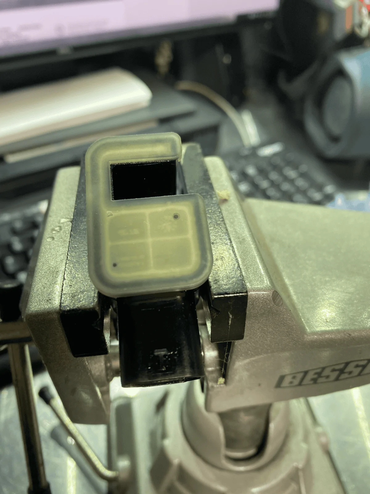

  • Wipe off any excess potting compound and fill the void in the back of the sensor with more compound. Let sit for 3-5 hours. Once tacky, clean the sensor using Acetone so there isn't any left over potting material on the outside of the sensor once fully cured.
  • Once cleaned, let sit for 24 hours. (At least 12 hours before reinstallation.)
  • Once cured, install sensor in reverse order. (Use Dielectric Grease on the connector and Loctite on the T20 screw.)
