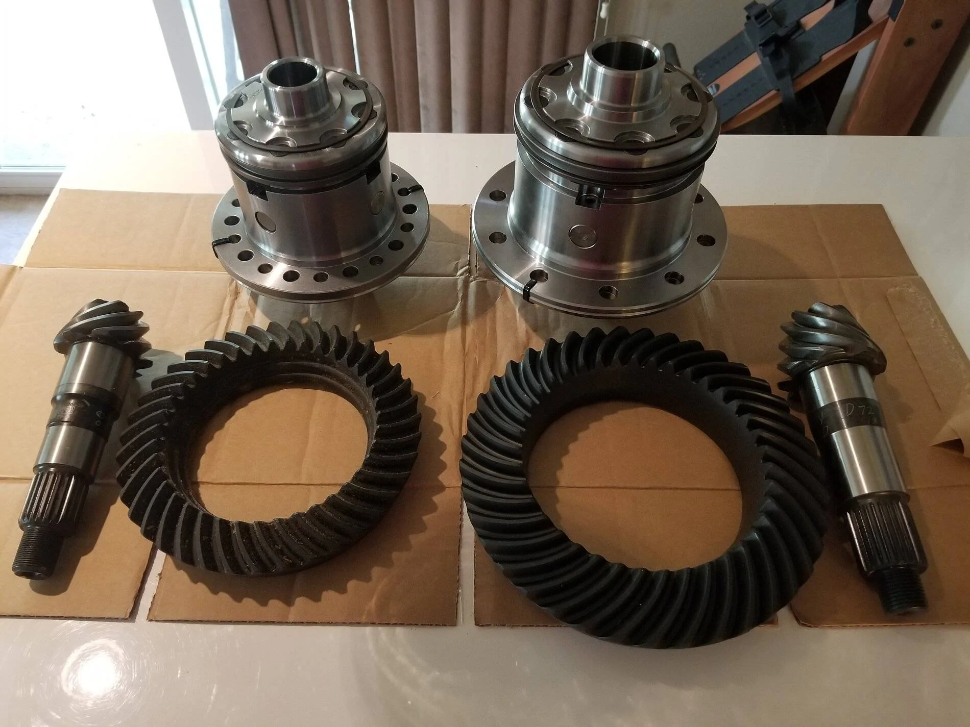

Starting to prep for my locker installs.
In case anyone is wondering size difference between the m186 front and the m220 (narrow) rear; here it is!
These Ox lockers feel and look beautifully machined!
Before anyone asks; I'm going to lock the m186 because I really don't plan on going bigger than 32/33 inch tires. I initially had plans to buy a Dynatrac 44 for the front, but I tend to go overkill. Would have been a $6,500 axle all said and done. Locker, gears, and install kit I'm around $1,600 for the m186. Don't want Rubi takeoffs because I don't want to swap in another FAD axle, and I wanted ARB or OX lockers. (Just a personal choice- nothing against E lockers.) Would the 44 be stronger than the m186? Yep!! If 32/33 inch tires end up being too big for the m186 and it breaks, I'll still go that route. Or if I just feel like it in a few years I'll go that route! I'm going to put this thing to the test first though!

Lockers will get you further than big tires, most of the time
Keep us updated! Looks good
My ARB rear is coming shortly

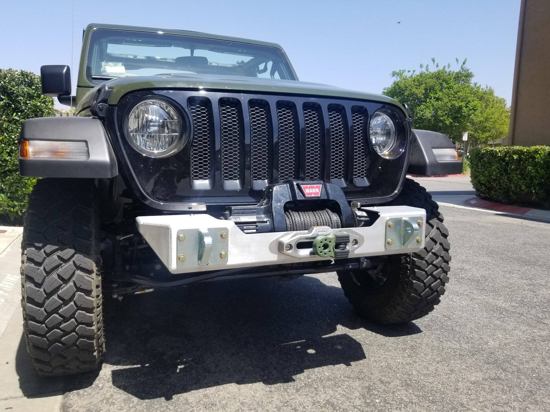

And a winch will get you even further...

Done! Im also one of those weirdos with a 2 door JL, so I'm not as concerned with throwing 37s at it. The stock 32s will get me most places I'm looking to go!

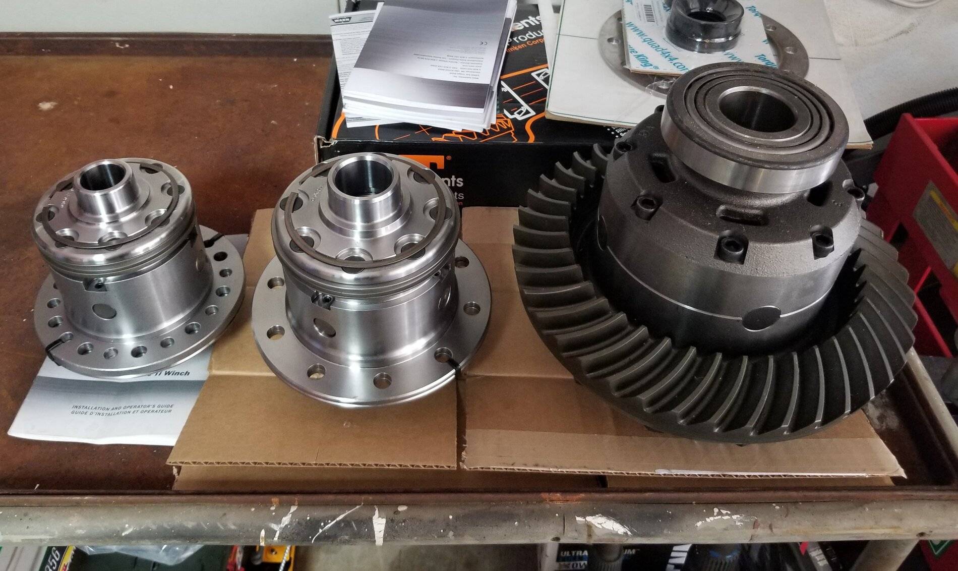

Just because I thought this was a good comparison too: m186, m220, AAM 11.5 full Detroit locker that's going in my Ram. The Jeep has such cute little carriers....
