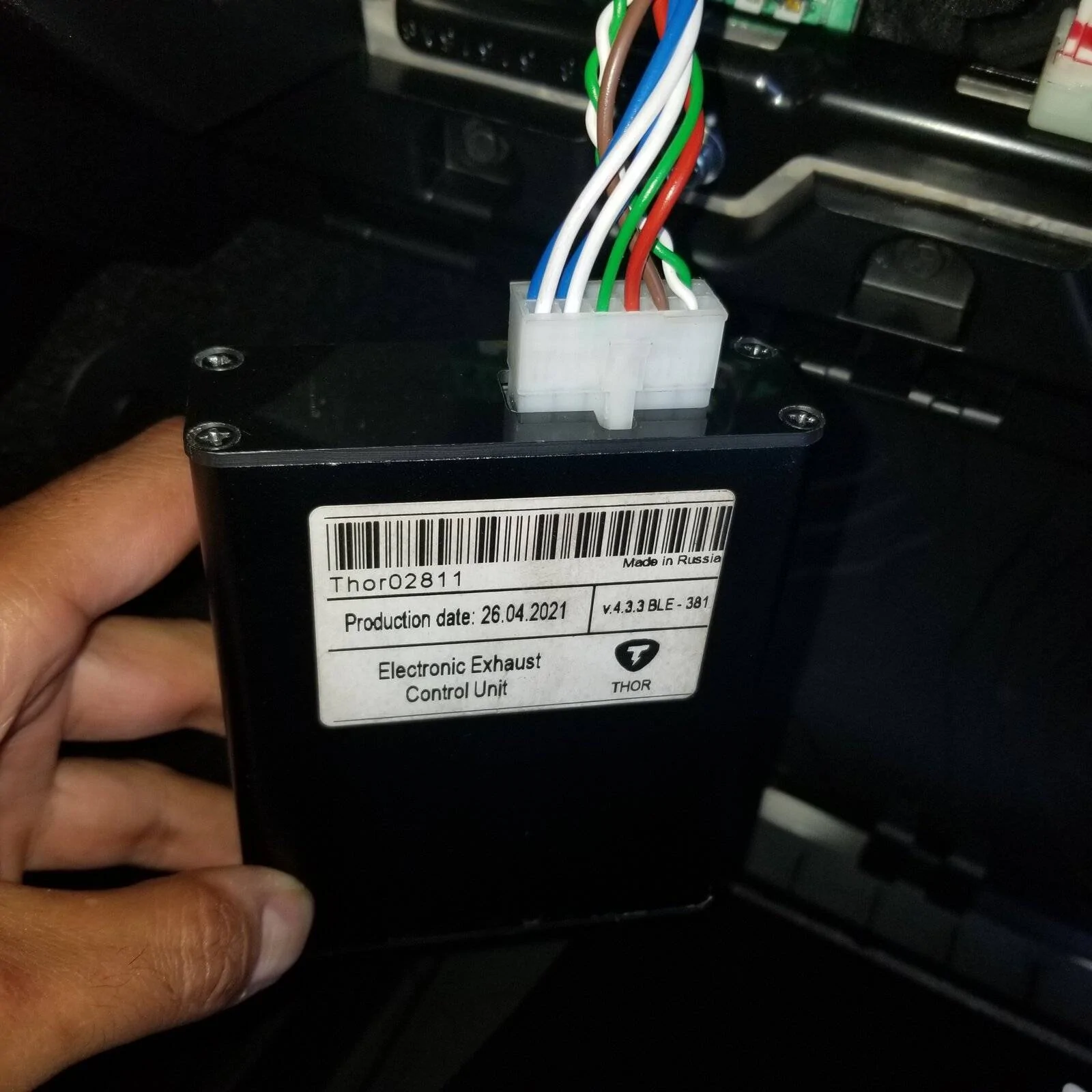

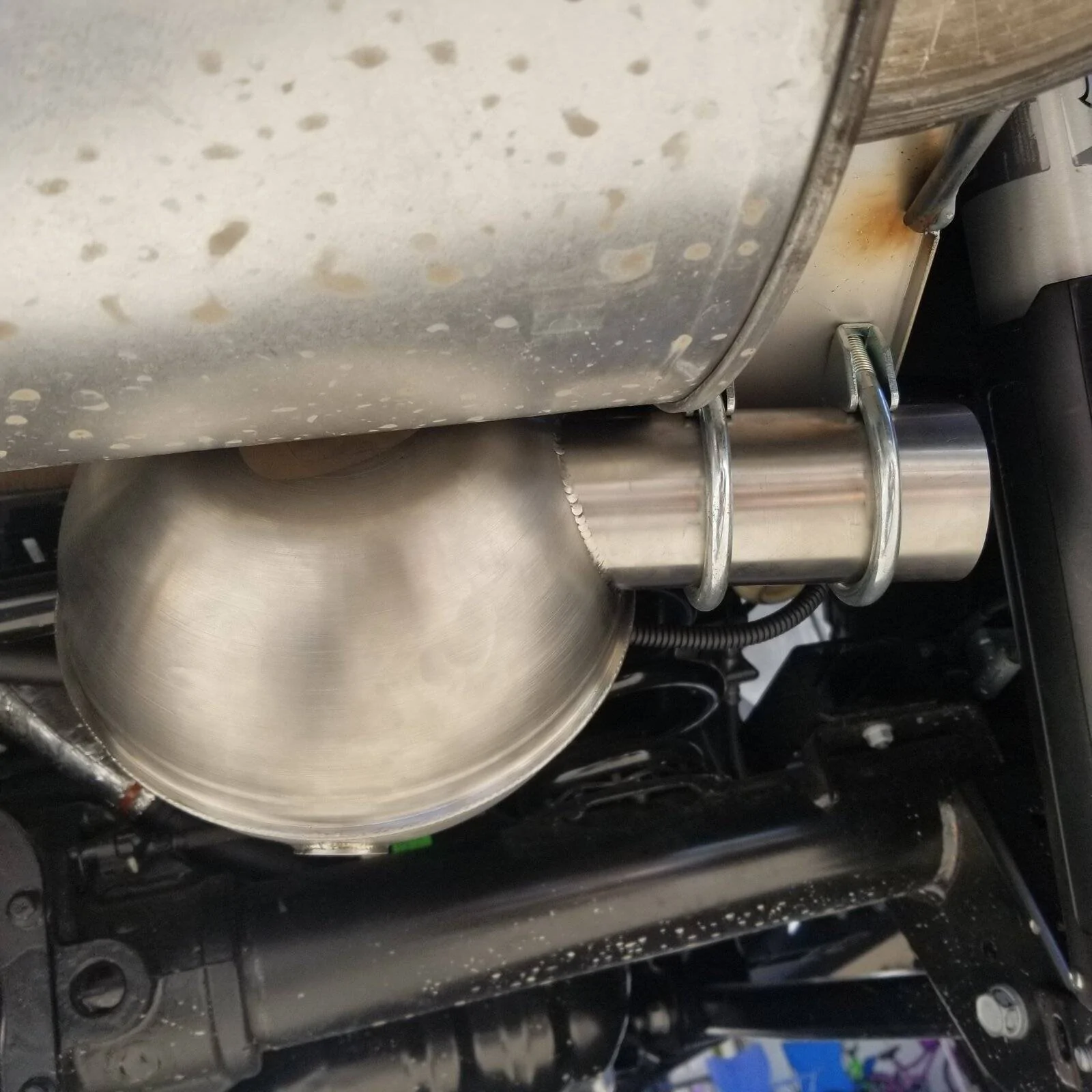

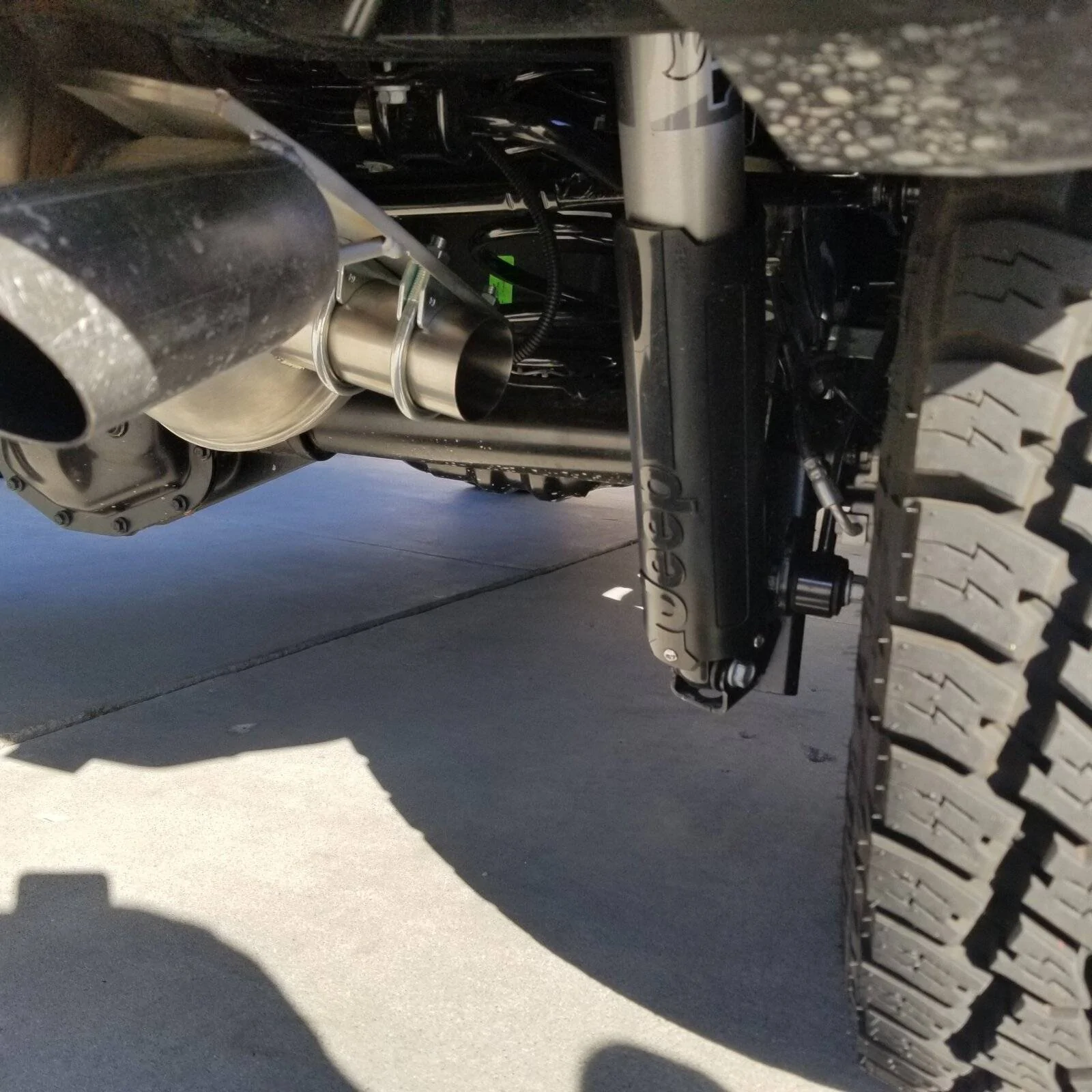

After committing to buying the system ($1000 for one, or $1500 for two), I then had to find anyone who would install this. As you can imagine, everyone I talked to was like, WTF are you talking about. Never mind the fact that we’re talking about a 4xe that hardly anyone has worked on, but now we’re talking about a sound system that is so niche (EV) that no 4x4 store was comfortable with. And of the ones that were willing to try to take a stab at it, were charging 10+ hours for install since it was brand new to them, even though the manufacturer says its no more than 3-4 hours. So I had to expand my search outside of where I live and found a couple places about an hour from me. Ultimately settled on MT Auto in downtown LA, because they are a shop that actually installed a Milltek one on a BMW/Tesla a few years ago, so they had an idea of what I was talking about.
There was a bit of drama during install as Thor made it seem like all we had to do was install it without help, but in reality, they needed to connect to the software DURING install to get the right settings. Mainly because I’m the first Jeep 4xe to use this so they needed the logs to review so they could code it. So while I had to go through this, others with the 4xe won’t because now Thor has the event logs. Considering Thor is based in Russia, coordinating with the 10 hour time difference was a pain. Nonetheless we got all that sorted out. Shout out to the great team at MT Auto for their flexibility and accommodating for me.
Install took about 3 hours and no major modifications needed. They did have to weld a piece to the muffler to hold the device but that was really it. Mainly because there is no space under the 4xe due to all the components. In a regular car, there would be more space so it’s more attaching a big U bolt through and sits next to another part without affecting it. After that, you connect wiring to the CAN-BUS to tie the sound to the RPM. When you hit start (even in electric) it will make a real engine start up sound, and then as the RPMs go up, the sound gets louder. The design/shape of the device allows for authentic exhaust sound. You can select sport cars, muscle cars, among others. And all controlled/adjusted via an app. You can adjust settings like sound, City/Sport, Idle sound, number of chambers, etc. So you can really customize it to your preferred sound.

Here are some pics of the Thor ECU unit, and Sound Device
