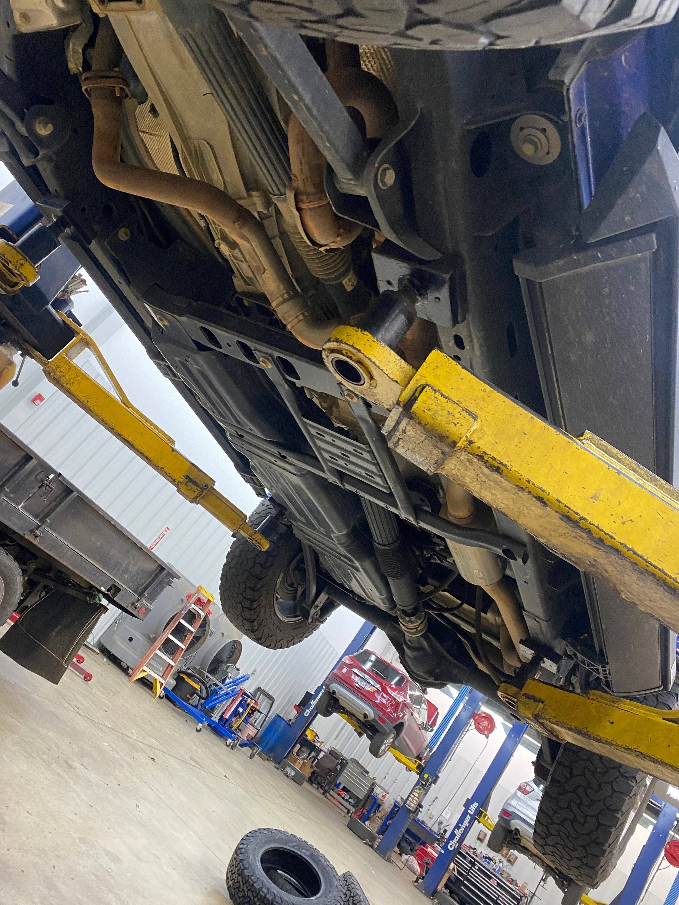

Hello fellow Jeepers,
This may be a stupid question, can you guys point me to the right direction for jacking up a Jeep using a personal home lift?
I always do all of my own maintenance in all of my vehicles if possible, when I can’t do someone I pay a personal mechanic to come help out. In the pictures the driver side is clear cut, but on the passenger side, the gas tank metal cover is in the way.
What should I do ? What are you guys using ? Being on only halfway is not stable for me to do any work underneath

I think you need a different style adapter. My buddy's lift uses ones that look kind of like this one. It's the same width as the visible frame rail next to the gas tank, so it fits just right. I don't have any idea where you would go to buy such a thing, but that's what I've seen work.

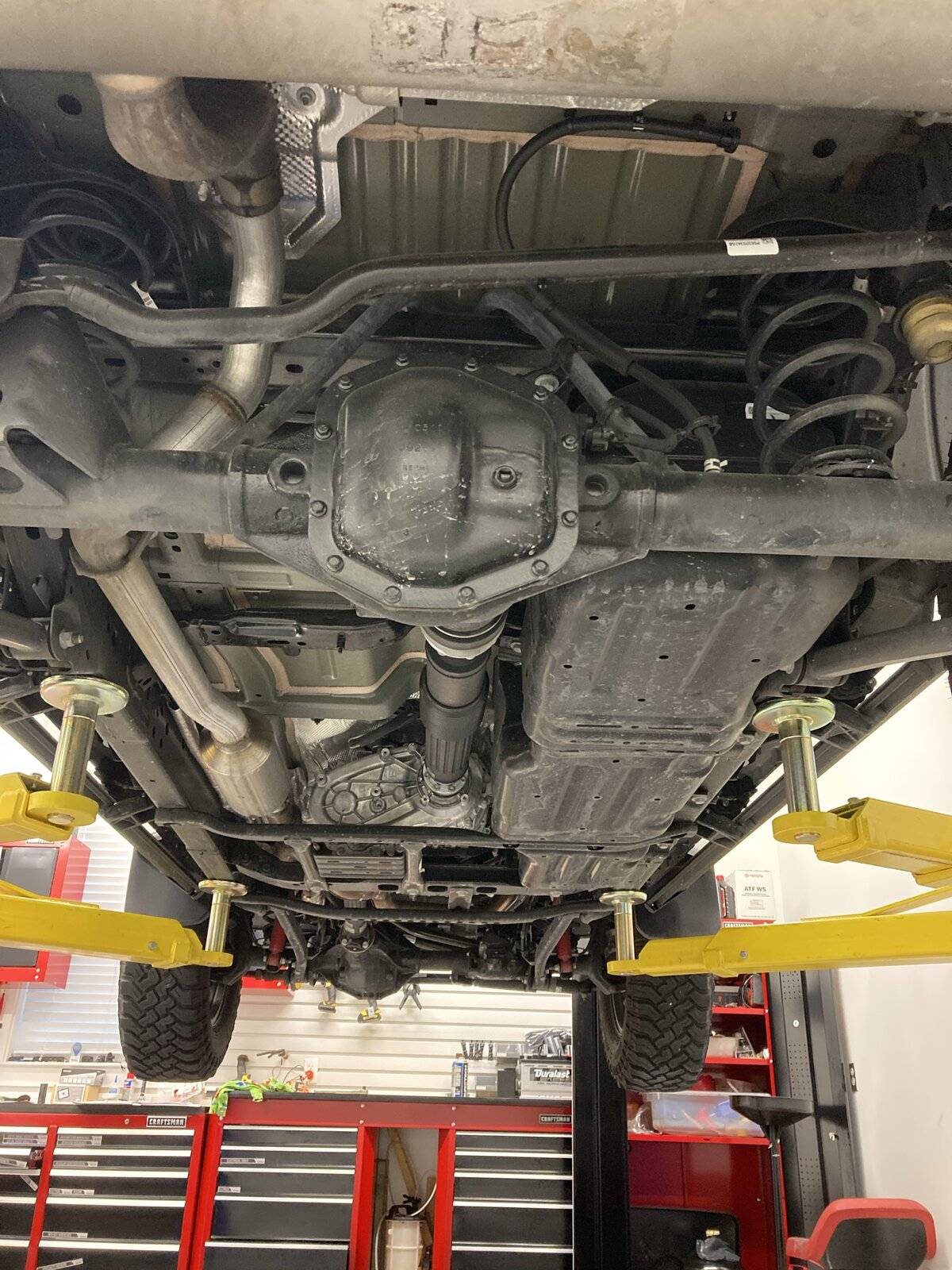

My son had ours on the lift at work today for some new tires and a once over and he used the adapters shown above to clear the gas tank cover:
