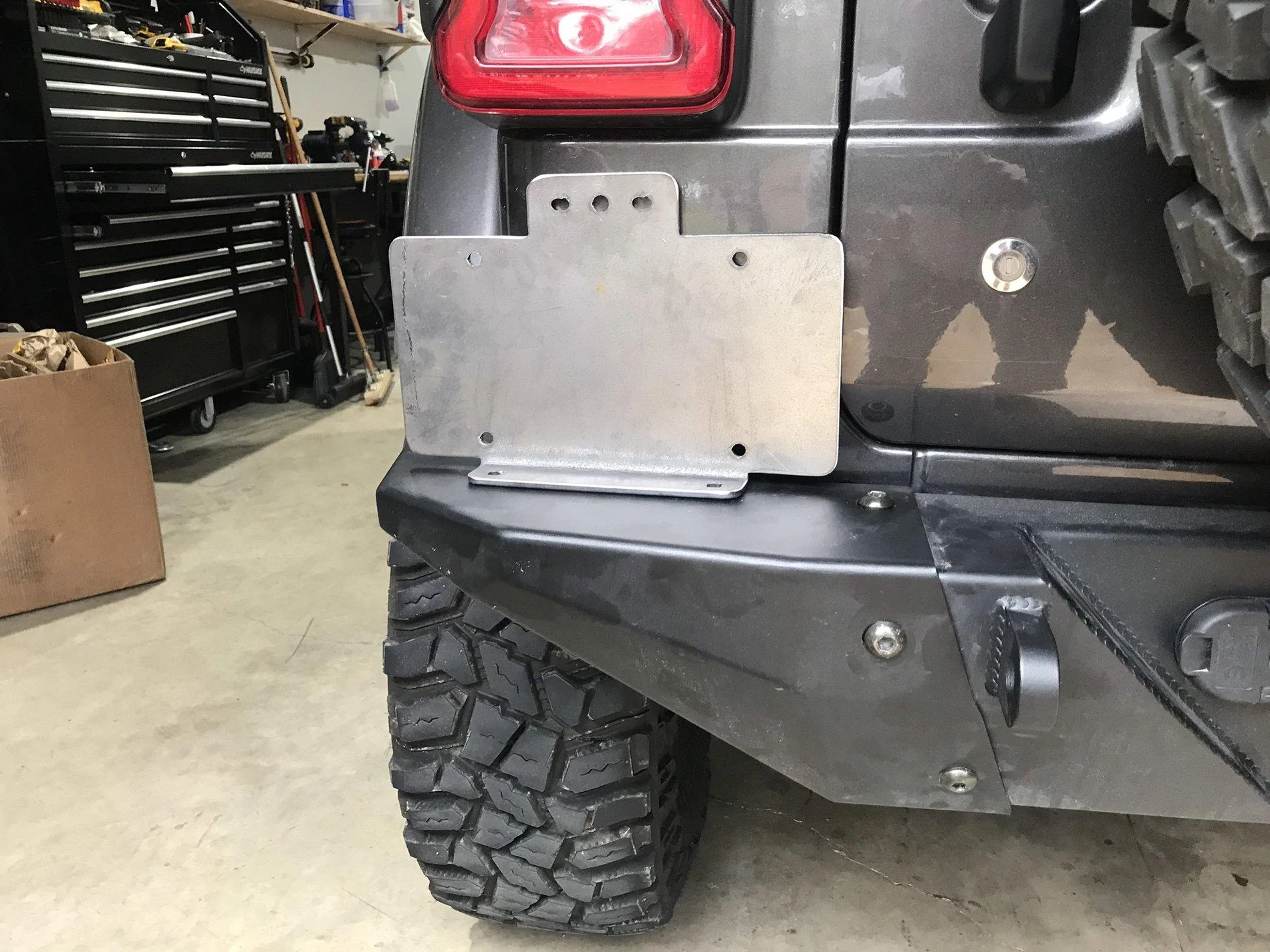

there are a few place that make universal kits for mounting the license plate, some are on the driver side but are in a spot that can get hung up on trees but lots are designed to work with their bumper so may need to do some tweaking between brands
also there are lots in the spare tire mount that are universal and just bolt up the spare studs but you just have to make sure that you can unplug the plate wiring easily when you need to actually use the spare
and other option if you dont care about looks is self tapper screws, just saying
as for lighting many come with a packaged solution and usually its over priced for what it actually is but there are many options of light bolts like these that replace plate screws

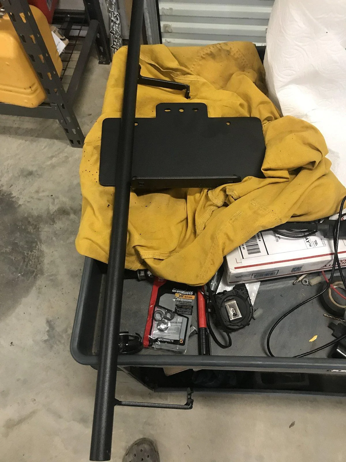

We are building these. Just got mine back from powder coating. Will use an led license plate light wired into the factory plate light. Will use carriage bolts to secure it. Way over kill and obnoxiously over built out of 3/16th plate
Excuse the poor pics, they are all I have on my iPad today.

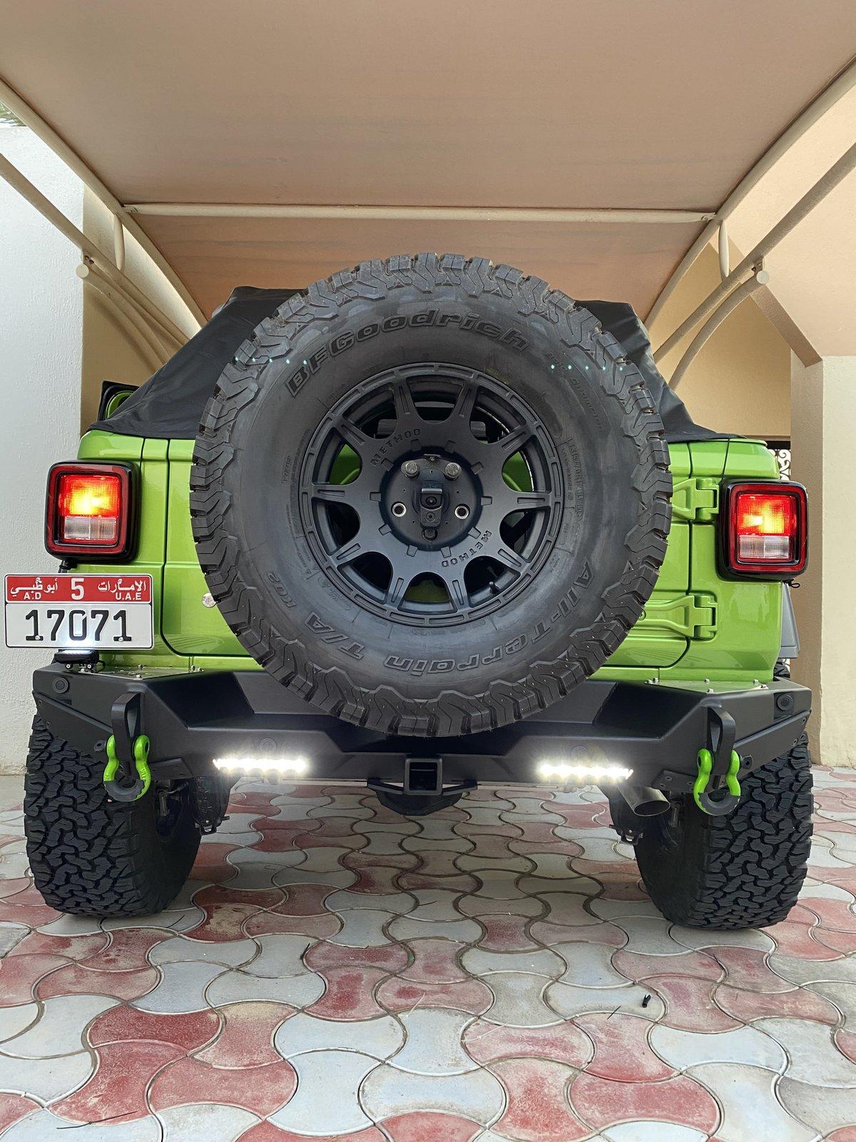

Hated the plate in the center of the tire... used the bracket and attached it to the bumper.. also easier to connect the plate light..
