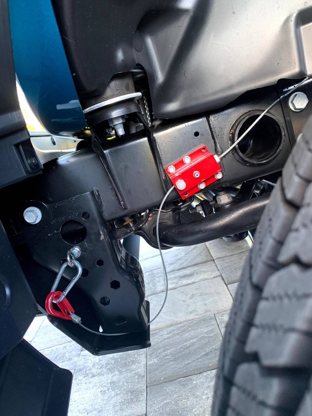

In the first picture I see you have the brake cable go through the Rockjock. Did you drill a hole? It looks like you put some kind of space that is angled. Do you have any pictures where you installed the emergency breakaway switch?
Thank you
Here’s my breakaway switch.

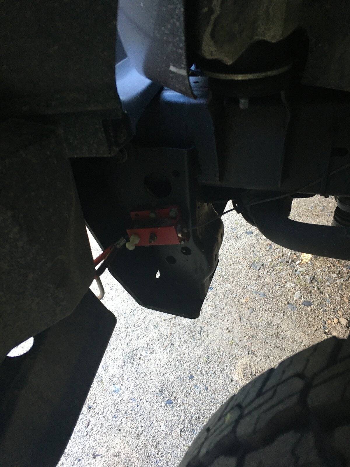

here is a photo of mine too. The main body of the brake is attached to the frame rail with self tapping screws, while I added an eye bolt to the bumper bracket to hold the end of the cable with a carabiner. I only had a couple hundred miles on the Jeep when this photo was snapped so everything was still clean.
