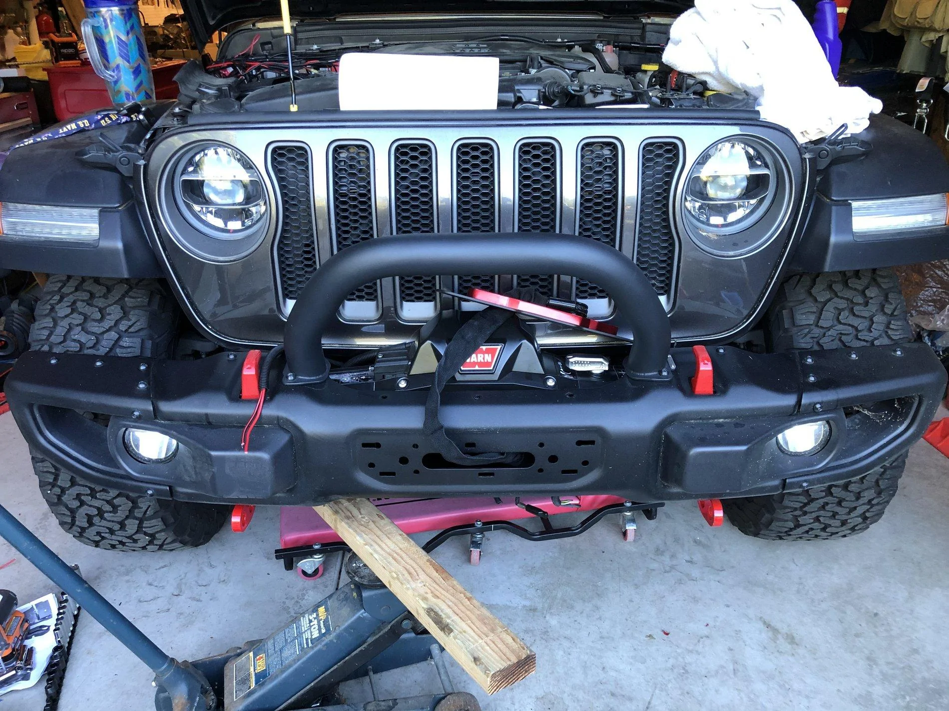

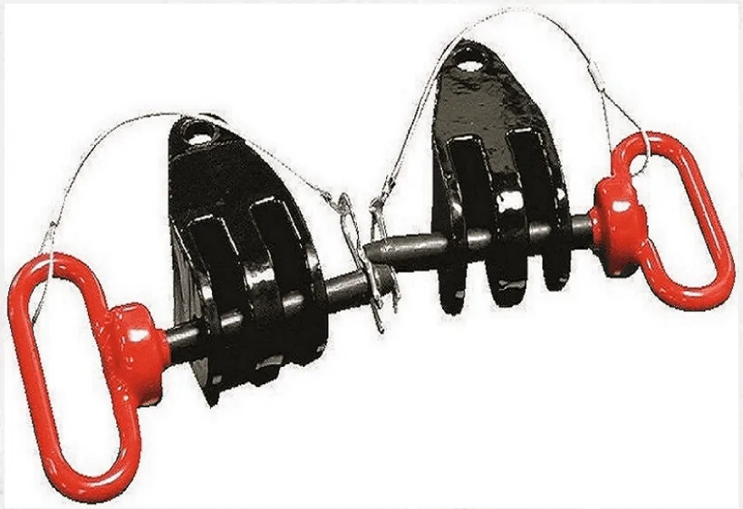

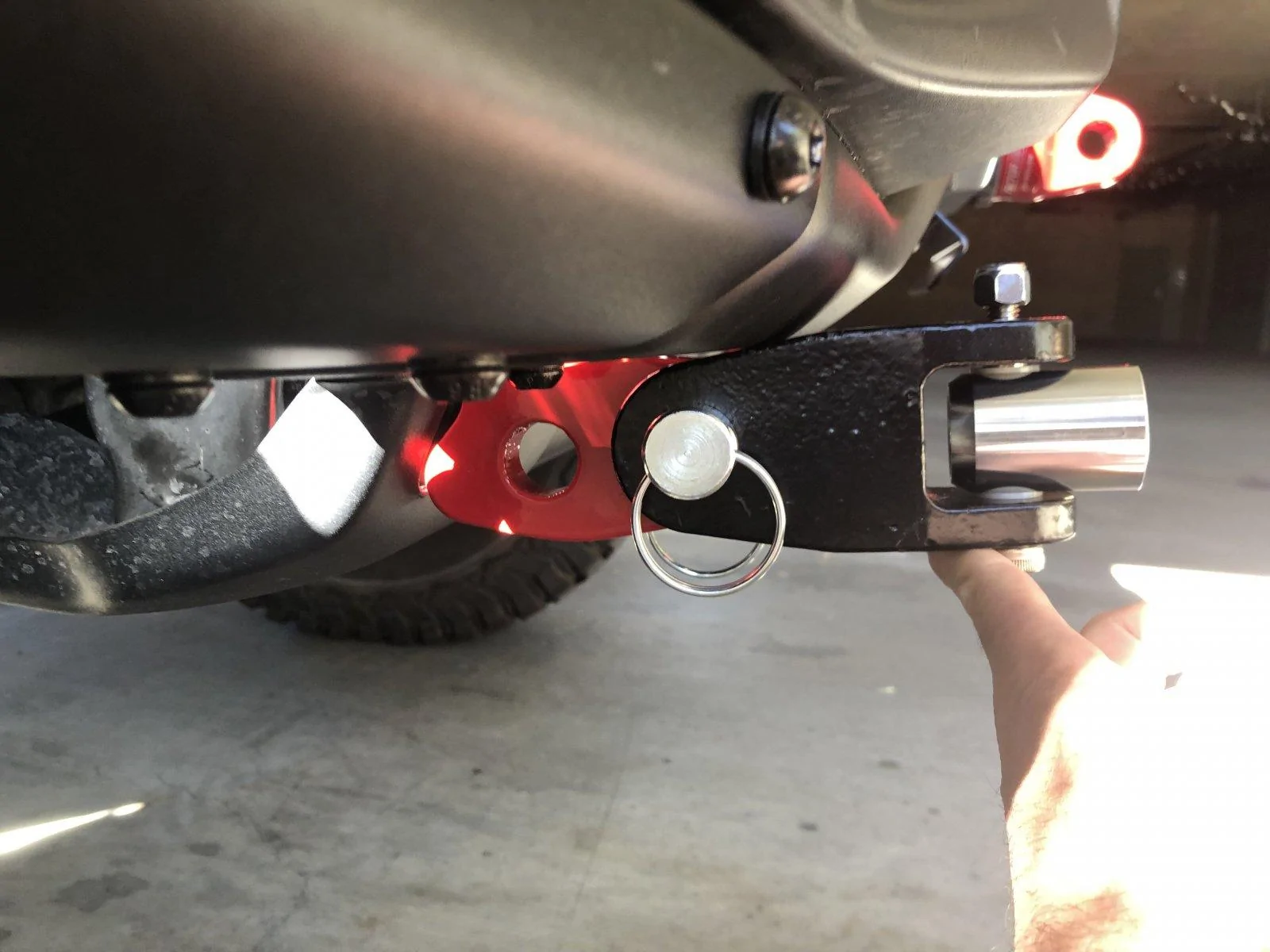

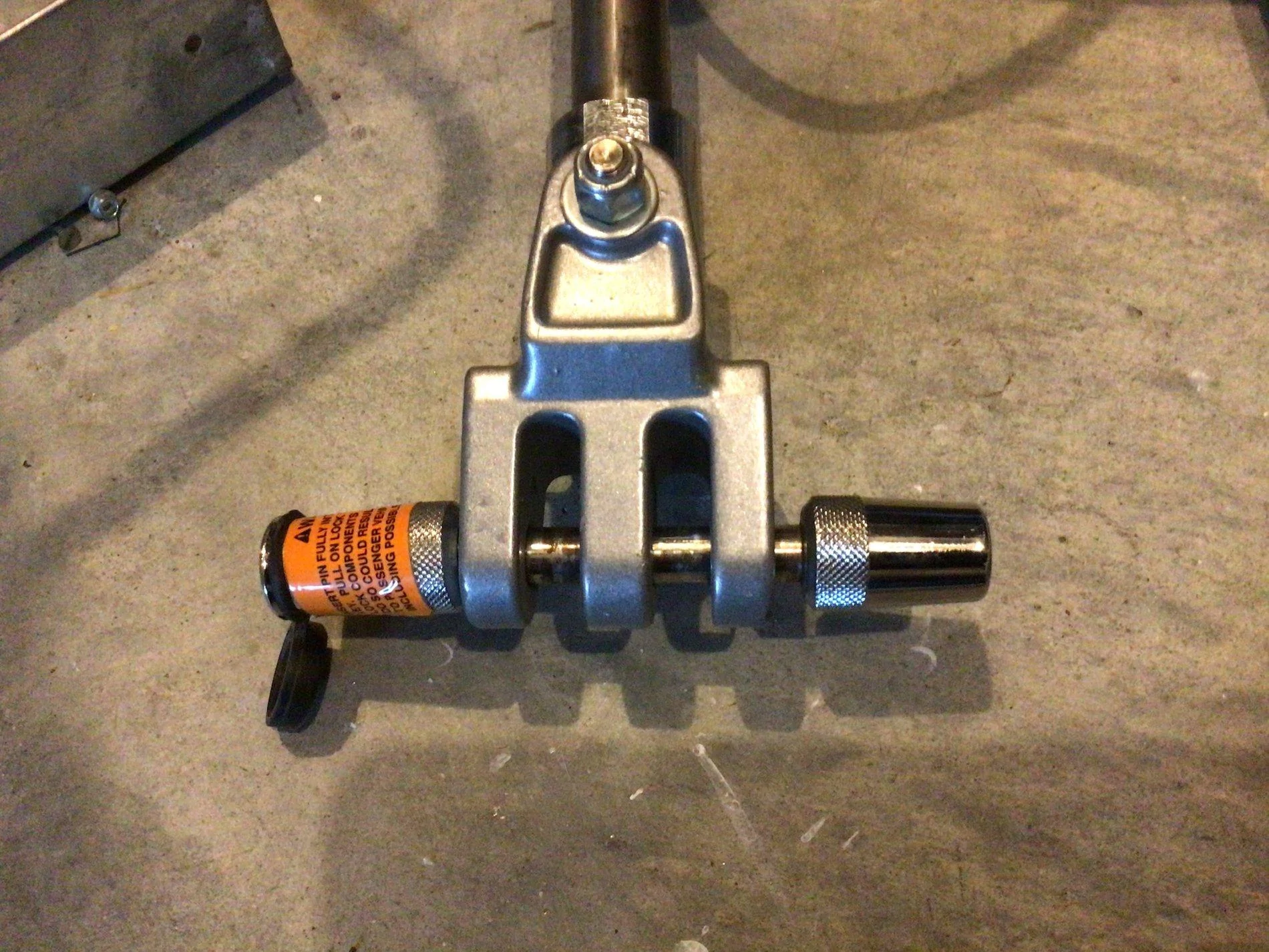

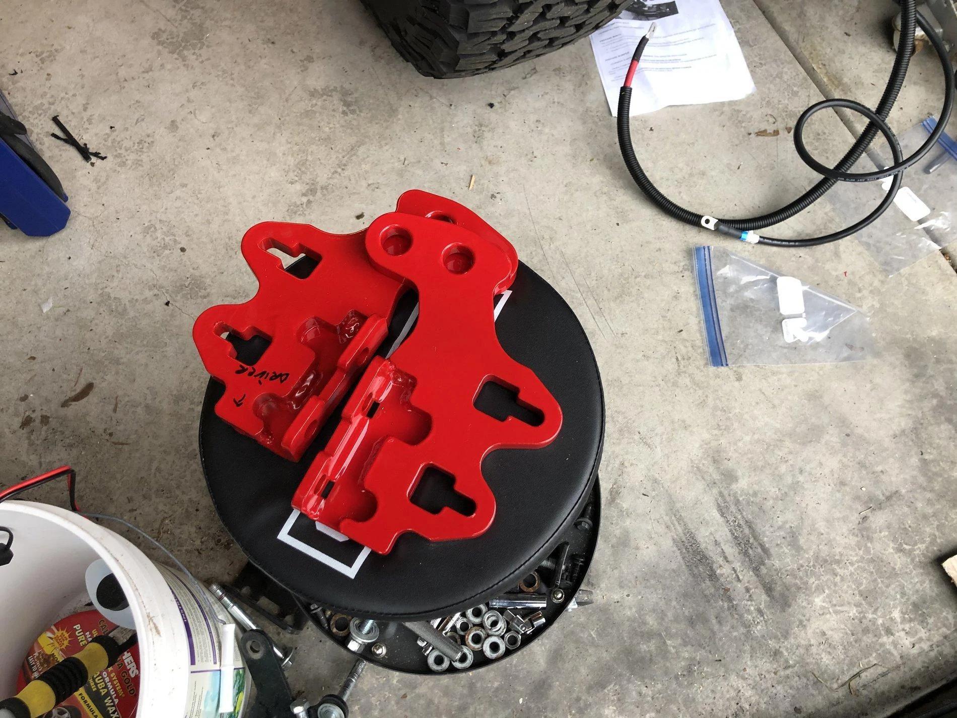

I traded in the JK and bought a new 2020 JL. I kept the Readybrute Elite II towbar because it's got a built in surge brake system. Rockjock makes a towplate for the JL so I ordered one of them. Hopkins does not make a plug and play wiring harness for the JL, but Curt does so I ordered that. I needed a new brake cable kit for the towbar and ordered that. The brake cable attaches to the brake pedal arm and is threaded through a conduit to the front of the vehicle where a clevis or carabiner attaches to the surge brake line on the towbar. I also ordered the emergency break away kit that will apply the JL's brakes should the towbar fail or disconnect. This is another cable run in parallel with the operating brake cable. I got the two brake kits from NSA, they make the Readybrute tow bar. While I was at it I ordered the brake circuit disconnect kit with the relay. This is where things got interesting.
