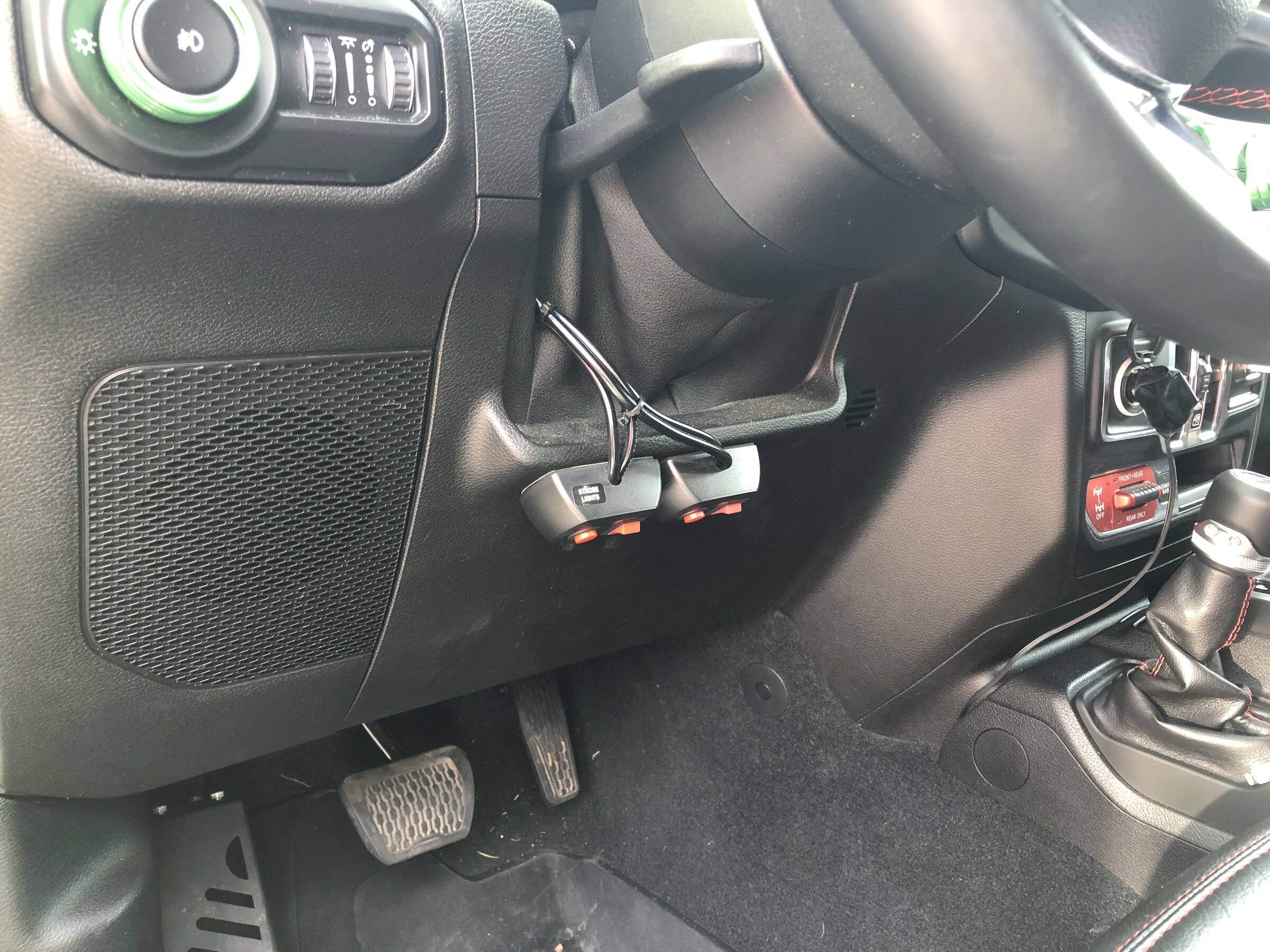

Strobes are wired to 2 switches from SuperBrightLeds.com, make sure to use the Positive Trigger Switch, the Negative Trigger will not work even though the instructions say to use a Negative Trigger switch.

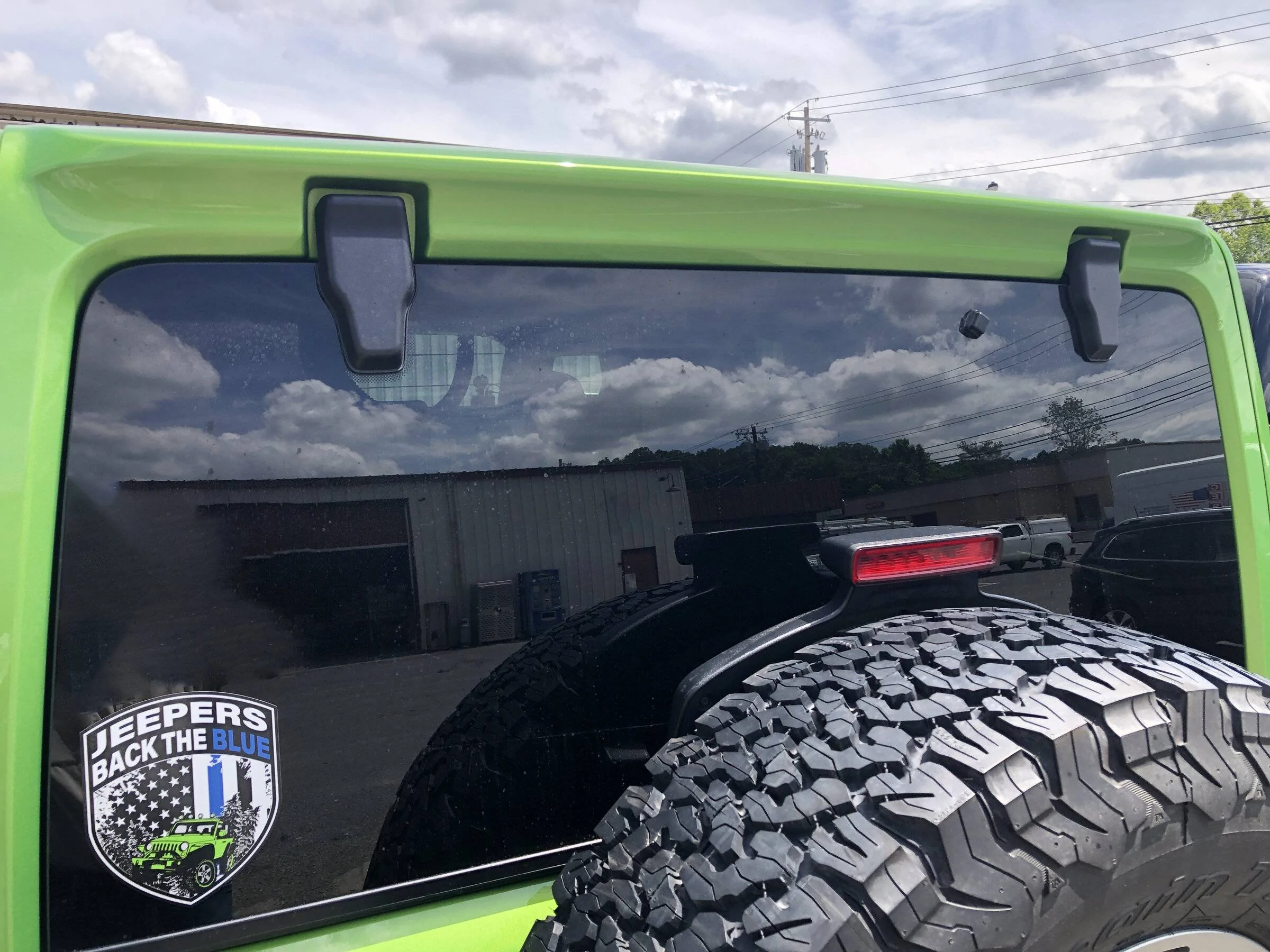

Rear Facing 5-bank of 2-row LED's are wired separately and are mounted to a custom made mount that comes off with the hard top including a quick release connector.

Switches are mounted below the steering wheel on the hard plastic part of the dash.

Switch Mount:

Rear-Facing LED's can't be seen through glass when turned off, and detach with hardtop when it is taken off:
