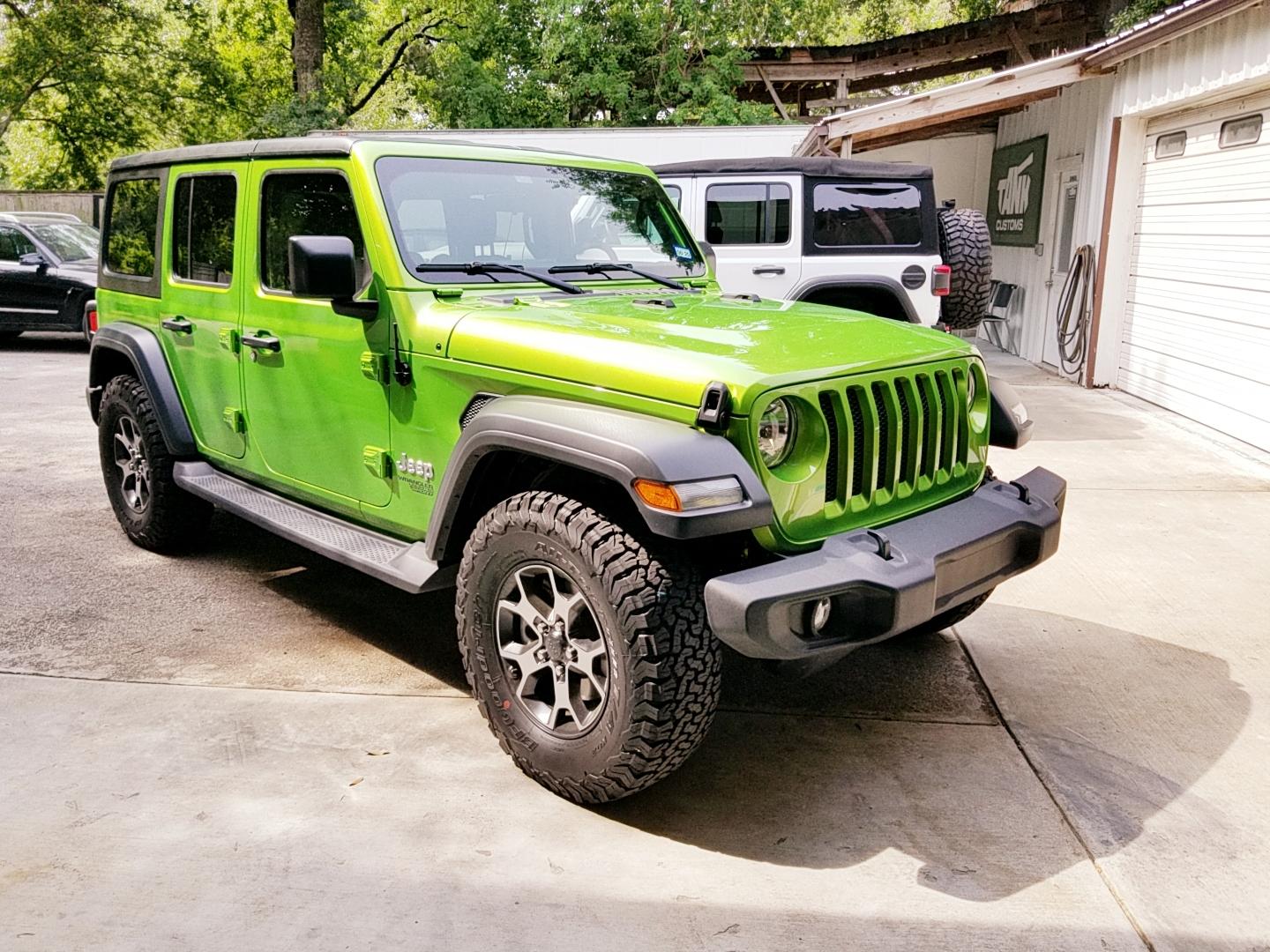

Sorry I missed the Sport part.
I'd look for some KO2 Rubicon take offs.
They fit fine on this customers Sport for daily driving, but i'm not sure how they would handle full articulation with the stock fenders.

Yes, it’s a stock Sport s. Are those 285/70’s in the pic? I thought that was the rubi takeoff size. Thanks for the pic. If that is the size, I like the look.

Yes those are factory Rubicon take offs on a Stock Sport S(285/70r17 K02's)
He brought it in to install take off Rubicon suspension, but that picture was taken prior to installing the suspension.
