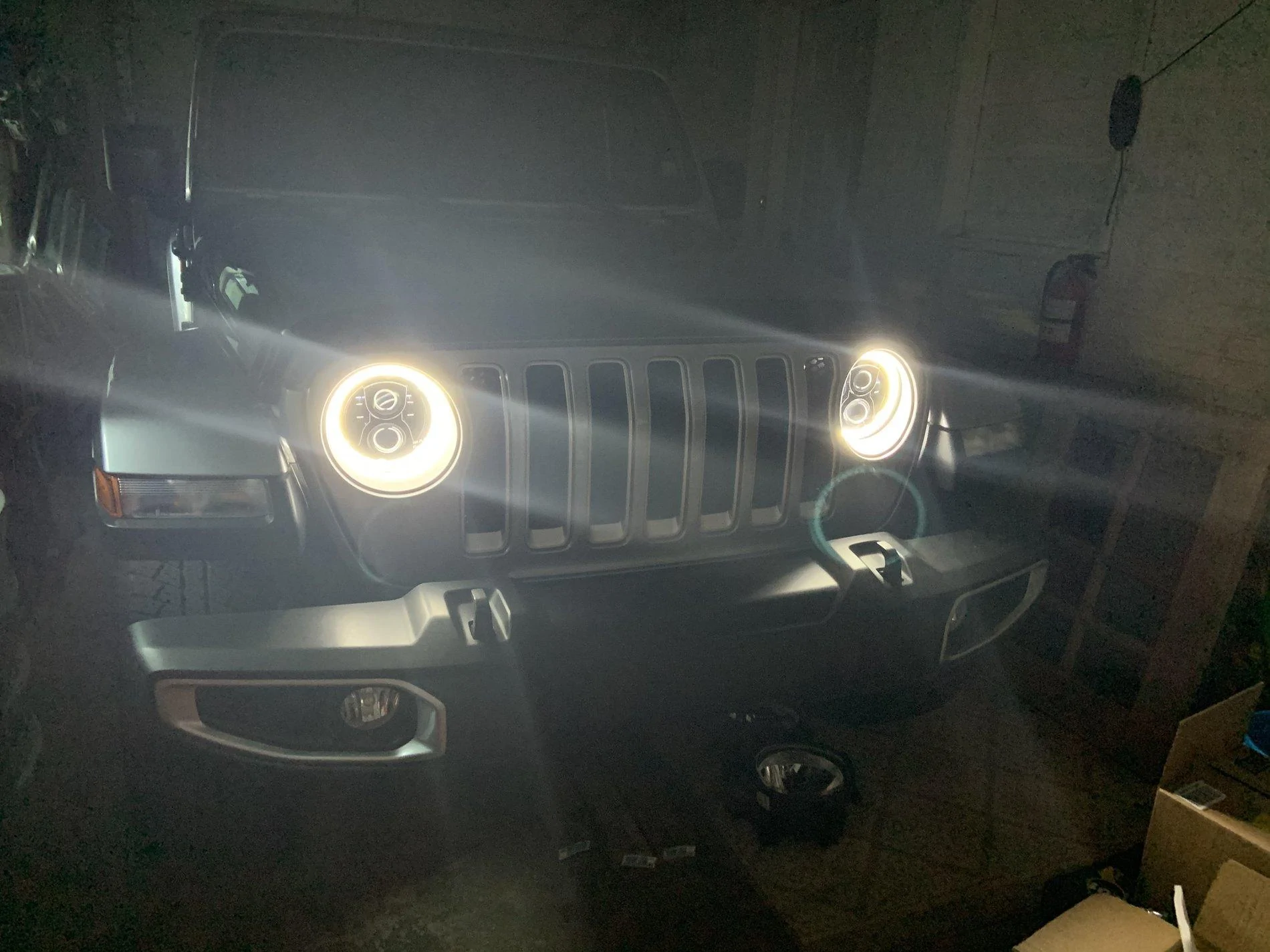

Are the DRLs supposed to be always "on" as shown in this pic from the seller? In other words, are the DRLs an integral part of both the low beam and the high beam? Thanks.
If you wire the DRLs to the fuse box, they will always be on when the vehicle is running. They are not tied to the low or high beams.

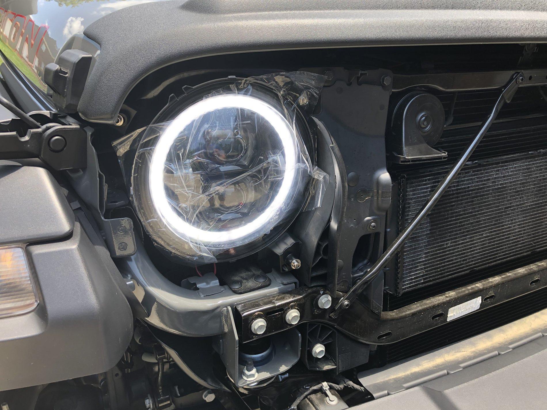

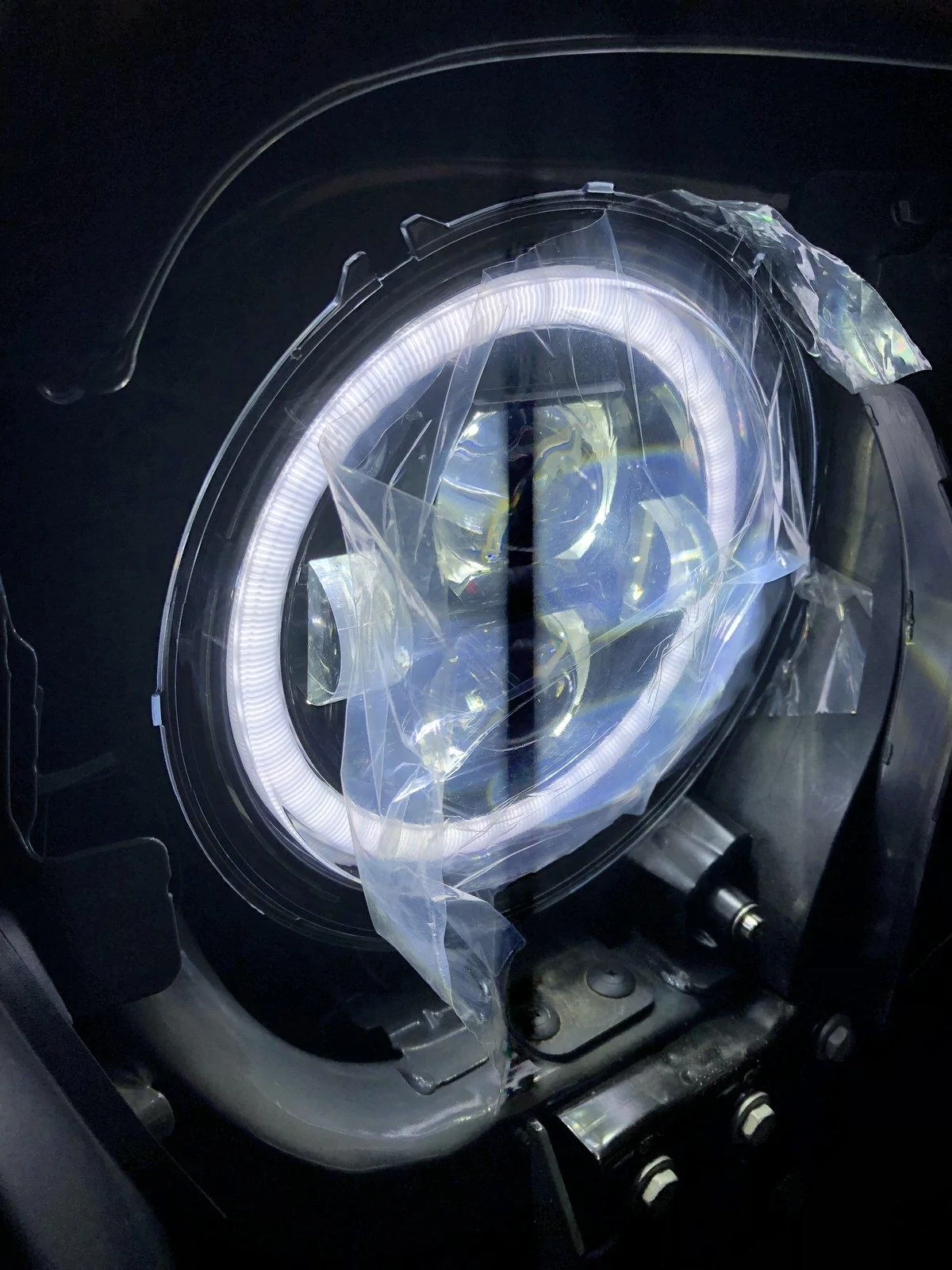

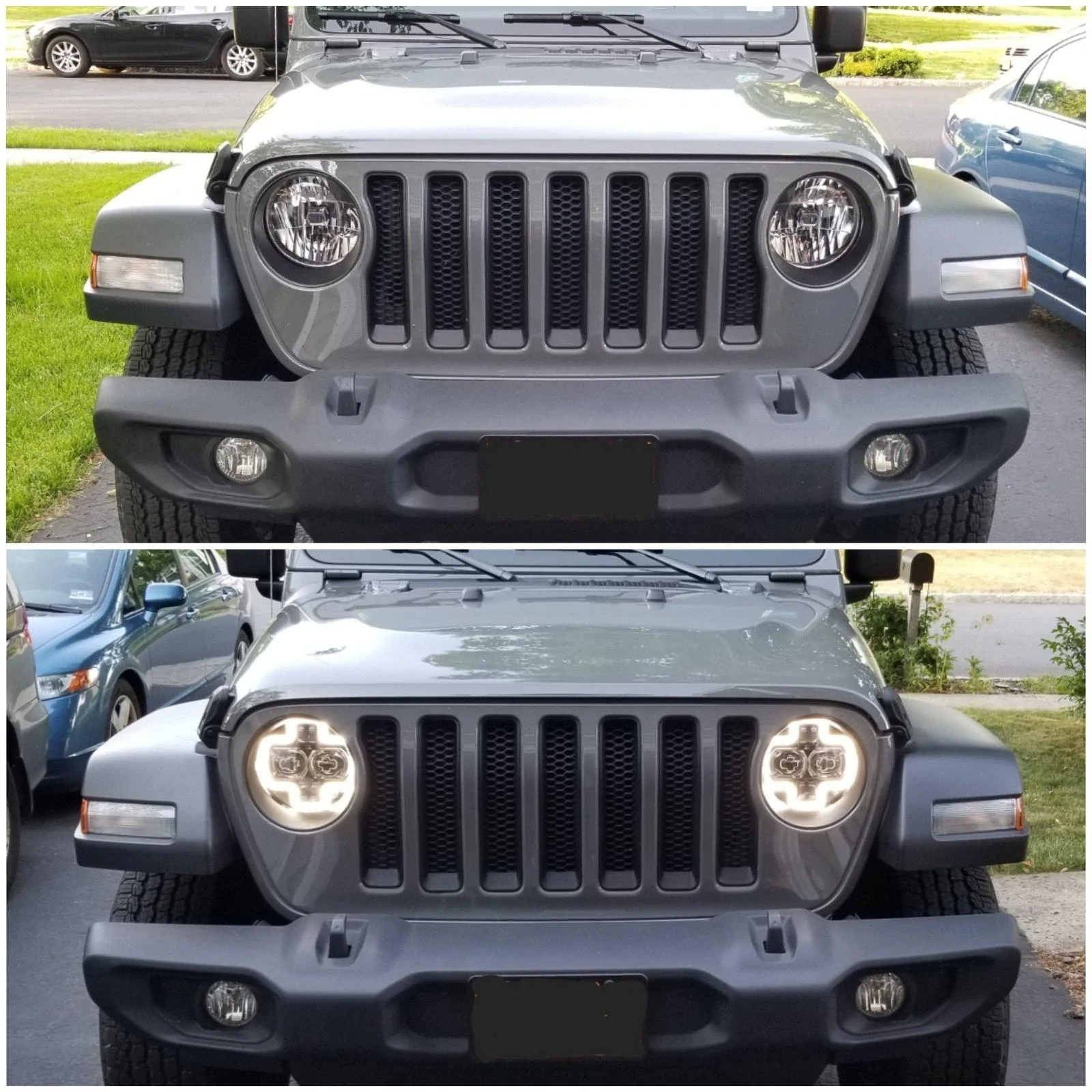

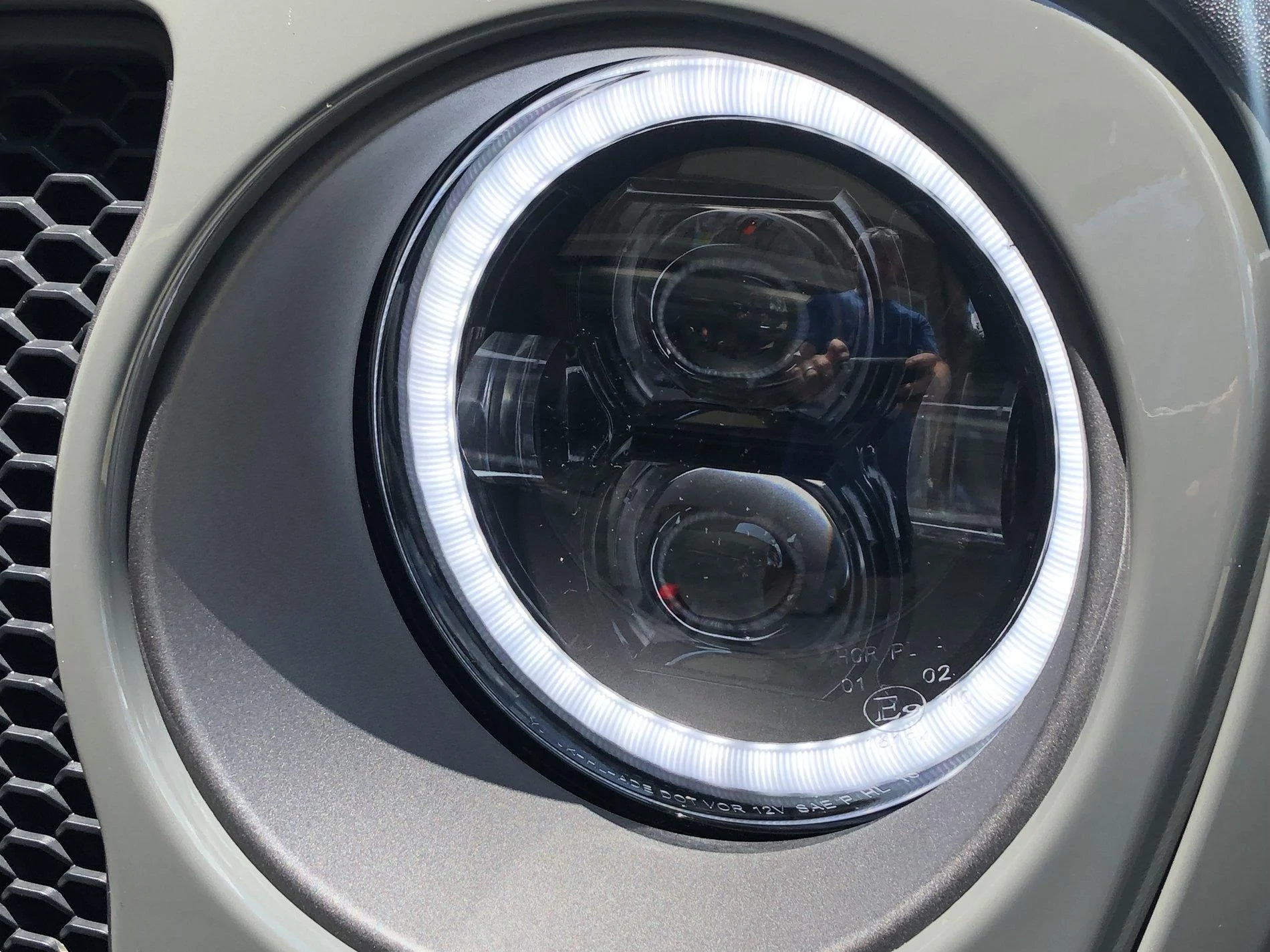

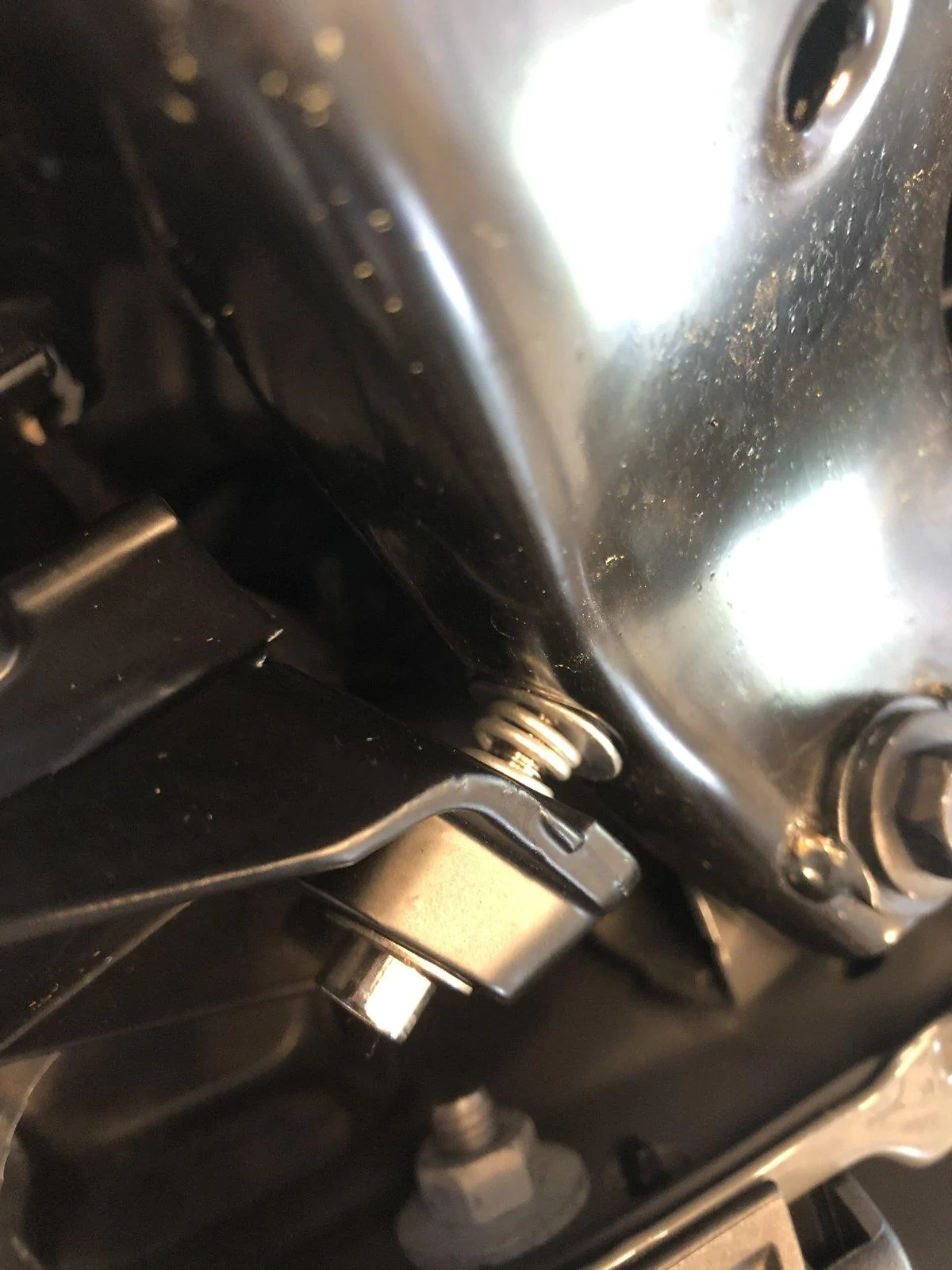

Just got my Kiwi 9" today via Amazon. Installed and tied both the left and the right into one wire then ran it to the fuse box and tapped into fuse 58. Everything went smoothly and the Halo's do look great. I also have to say that the adjustable screws they put do help a lot to adjust. I"ll have to wait till evening to do this but I can see that you can move the light fairly easily by adjusting the spring loaded screw. Excuse a couple pics with the plastic still on the headlight.

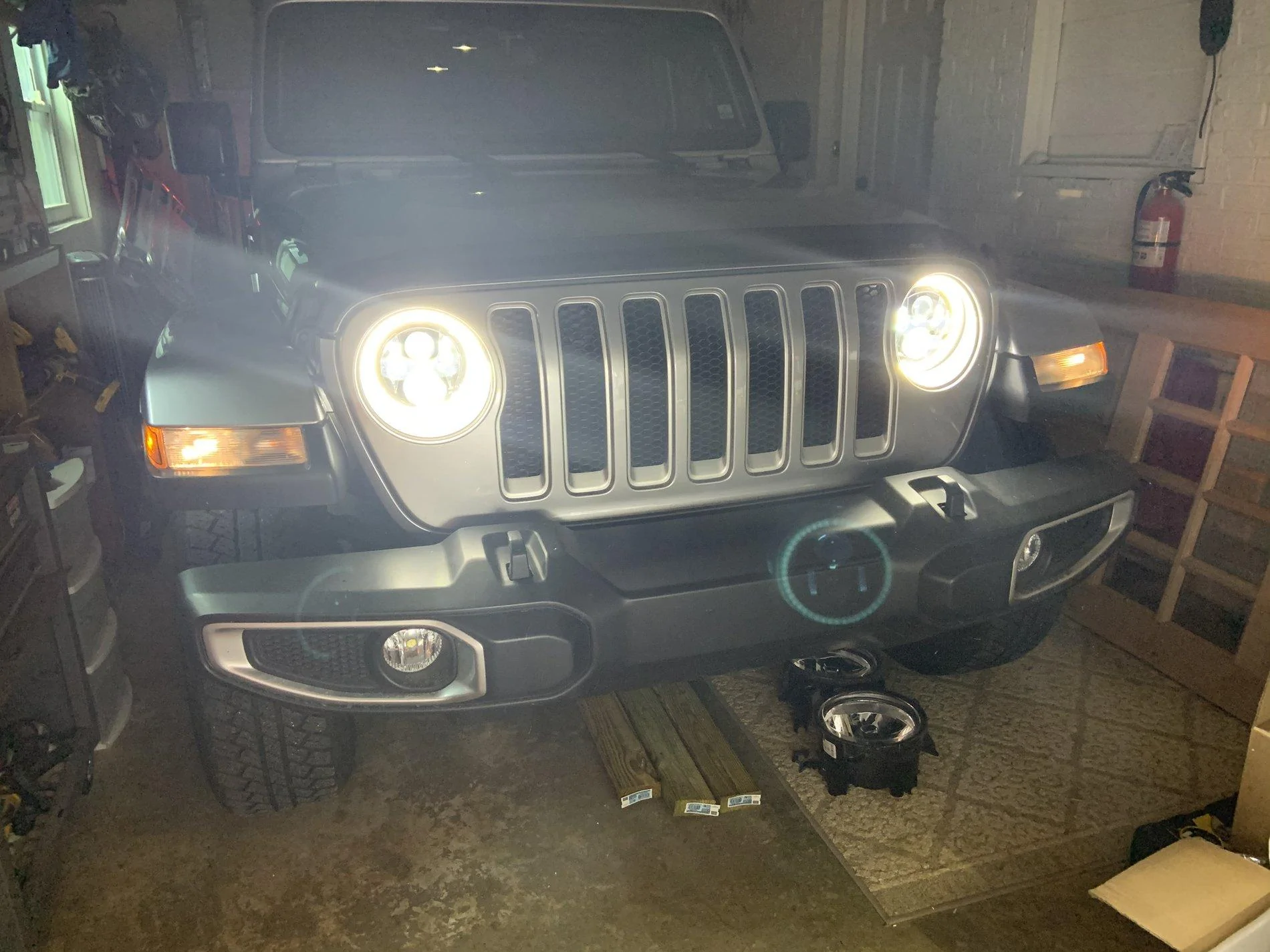

The model 3 just became available again on Amazon and I decided to give them a shot. Overall, I’m pretty happy with the result, especially given the price point.
sorry for the crappy pictures, I’m stuck in the garage right now. Will be testing them outside and aiming them this weekend.

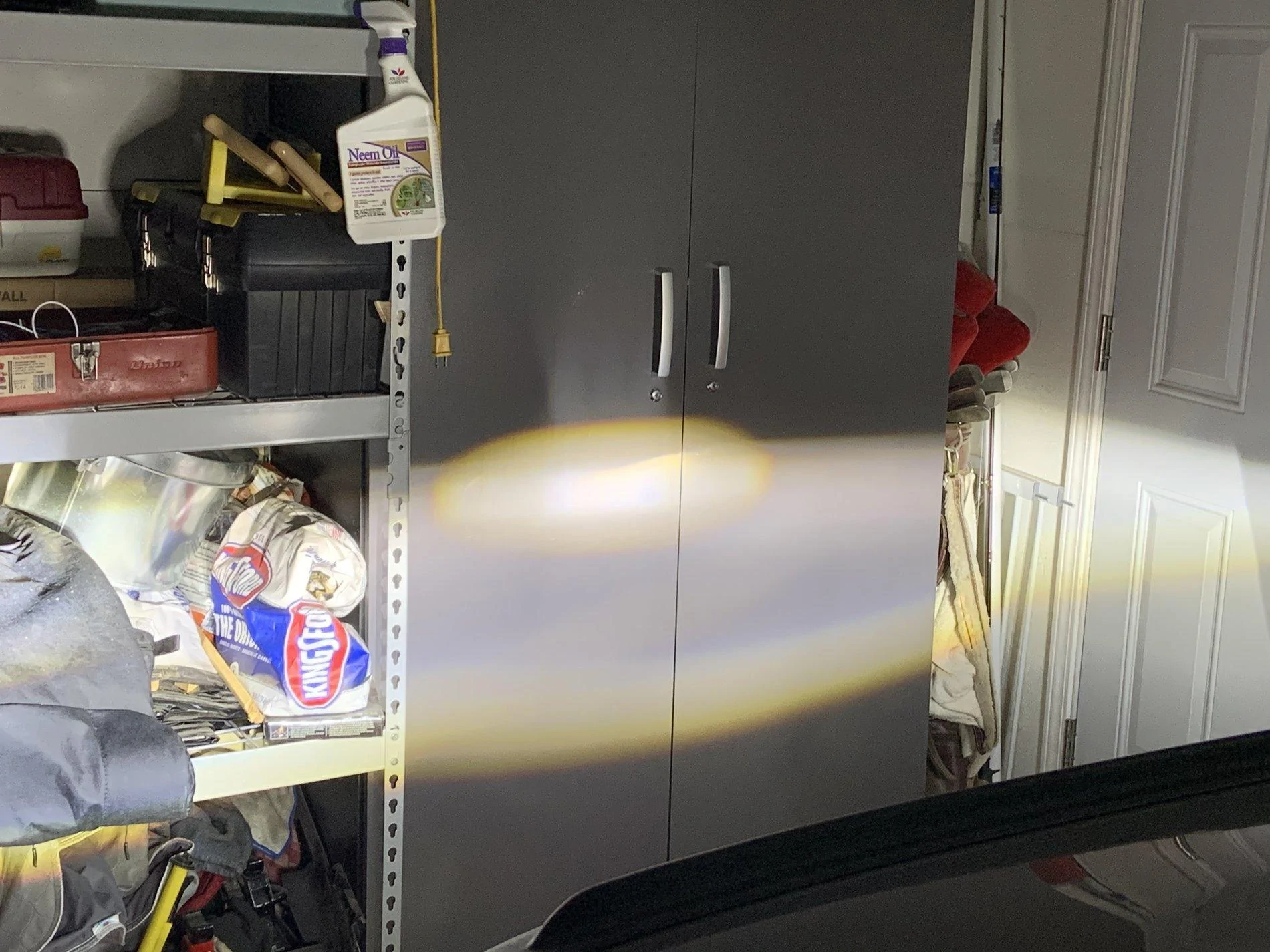

DRL
Low beam
high beam
Low beam cut off - passenger side (again, crappy pics, messy garage)
high beam cut off passenger side

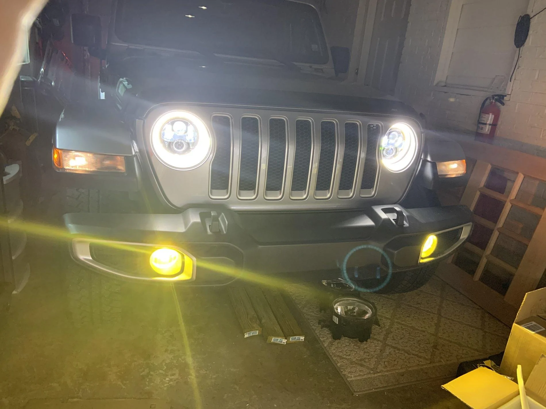

Wanted to give an update...I noticed a bit of (faint) flickering from these. I ended up purchasing a JSCAN license, security bypass cable and OBDII tool, and switched everything to LED. They’re perfect now, no flicker.
