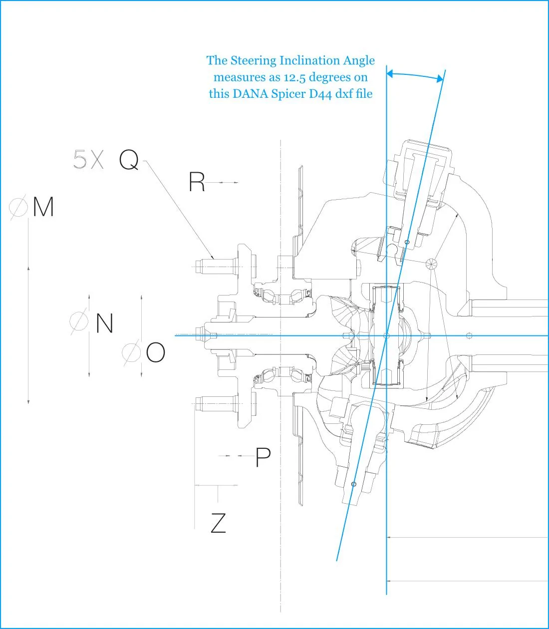

Anyone know what the KPI is for a Rubicon (or any JLU?)
I'm having one of my engineers build a model so I can play with tire size, wheel width, offset, and backspacing so I can look at the effect on scrub radius.
I'm guessing it is 2-5 degrees but you know how anal engineers can be. :D

I just stuck an angle finder on a Dynatrac JL housing we have on the rack and it is right around 10-11°.
Which is about right, I know the old school D60s are in that same range.
