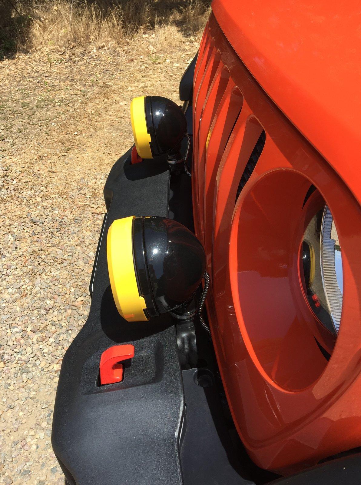

I installed KC Daylighters (halogen) on Mopar bumper mounts (they actually mount to the frame behind the bumper) on my halogen headlight/led tailight Sport S.
I used one of the 40A aux switch circuits, but reduced the fuse amperage in the power distribution box to better match the amperage draw of the Daylighters. I also installed a weather resistant Inline fuse holder. As I recall, the KC harness is a lighter gauge than the 40A aux circuit, so take that into consideration when you plan your wiring/fusing. Also, I ran a ground wire back to a grounding lug under the hood, rather than use the supplied individual grounds (e.g. to the light mounts), and wrapped everything in split loom for a clean look.
Very happy with the KC Daylighters!
