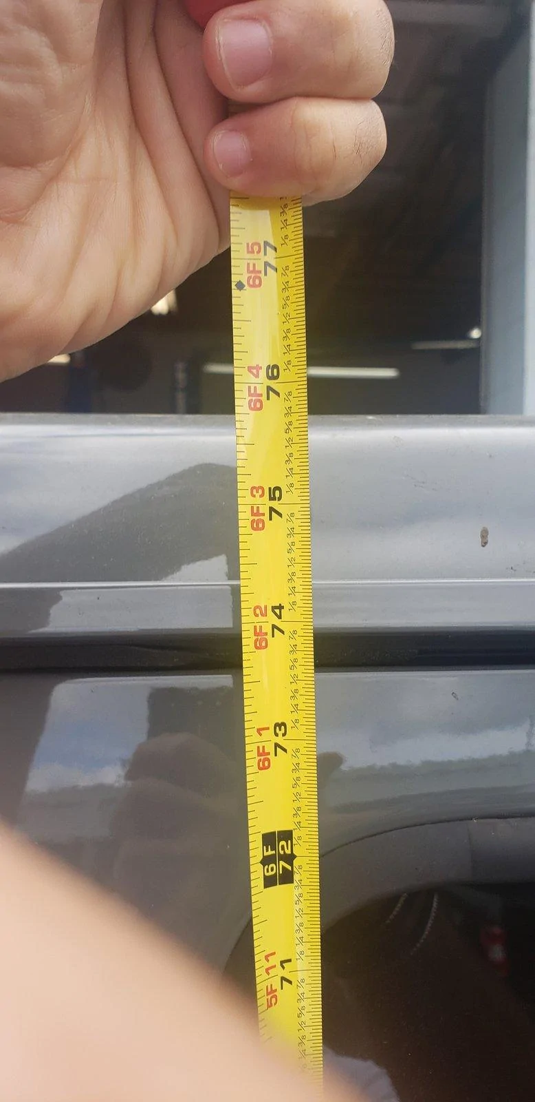

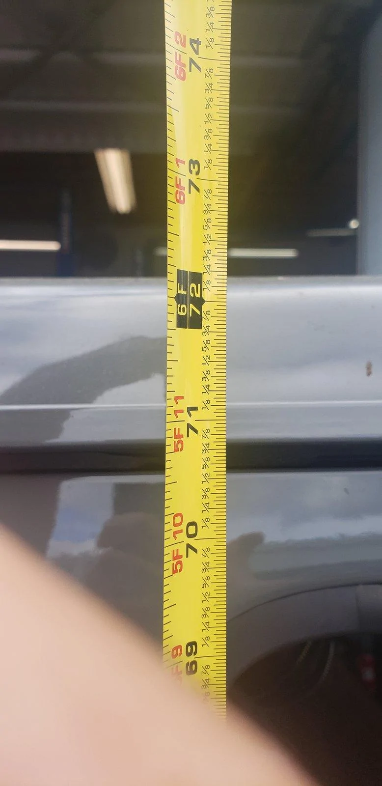

Dude this Mopar 2" kit is completely bullshit. Did a measure before the lift at 6' even and just got it installed and its measuring 6'4". This sucks because I live in LA and we have low garages so I dont think I can upgrade to 35's and definitely not 37's.
Other than that rides smooooothe as hell and looks like a fucking beast. Now I can call it a Jeep.
Math aside, I gotta believe you are kidding, right?

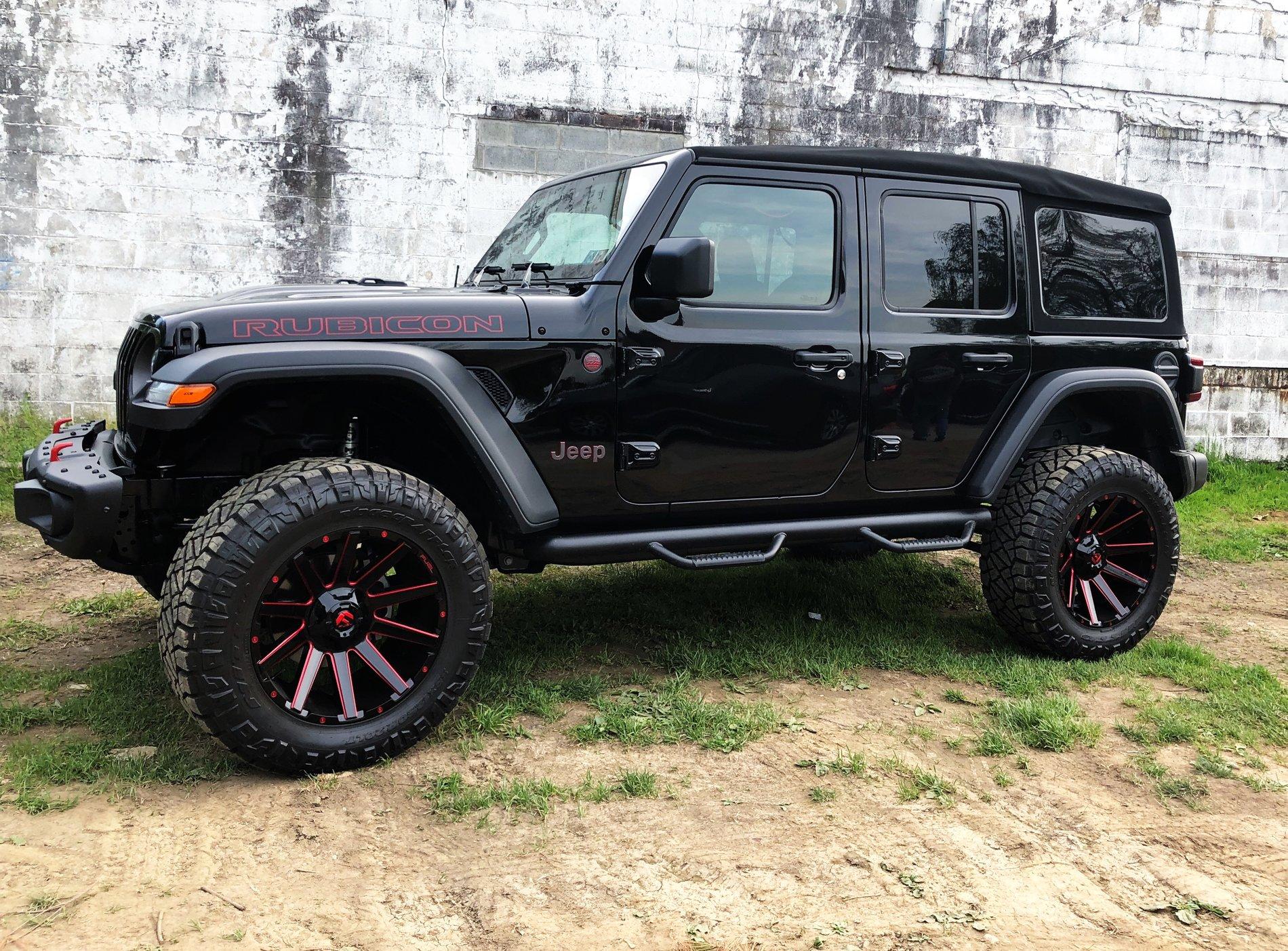

Got these guys on there the other day. Iron Man 35 X 12.5 X 17
They're reallllllly loud and made the ride a lot more harsh. My firat option was the nitto ridge grapplers. How are those noise wise?
I might actually go back to stock. It was such a smooth ride.
