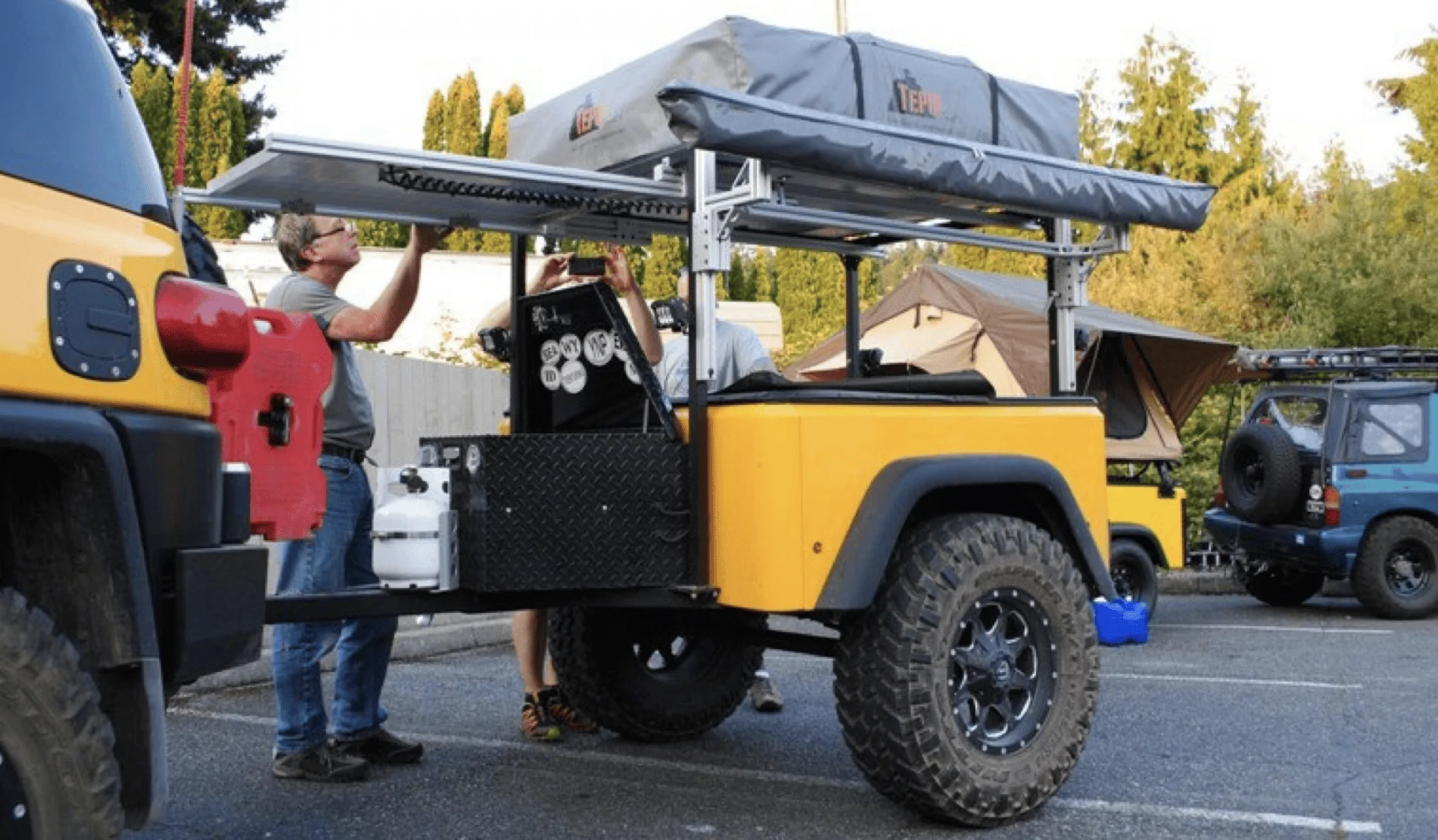

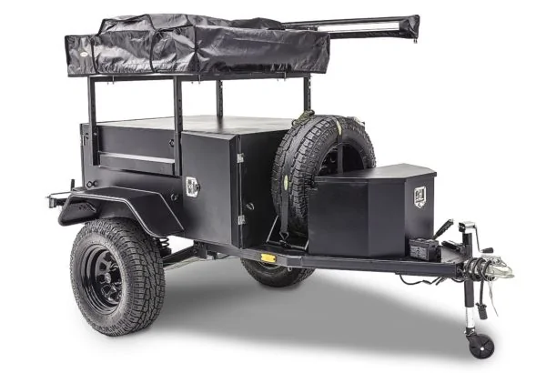

I believe I have solved my off road utility trailer challenges. Here is the design/solution I've cooked up (which is a work in process). I'm planning on ordering parts this spring so I can begin the build after my lift kit, wheels/tires are done on the 19Moab. Documenting here so I don't lose it, and to share my research with the community.
  1. Dinoot J Series Extended Tub Bundle bed kit - (extended version) - $1479 OR...
  2. or possibly DIY M416 style framed in steel and boxed with aluminum diamond plate. May be slightly cheaper but much more work
  3. Timbren 2000 LB HD AXLE-LESS TRAILER SUSPENSION W/ 4” LIFT & LONG SPINDLES - (link) $772 (may bump up to the 3500 LB axle but would have to convert bolt pattern)
  4. Tambren 3500 LB. ELECTRIC BRAKE HUBS - 5X5 BOLT PATTERN (link) - $243
  5. Autowbrake Electric Brake Controller - Trailer Mount - 1 to 3 Axles - Proportional (link) - $342
  6. Trailer Wiring Junction Box w 7 way cord and plug (link) - $57
  7. Hopkins Engager Push-To-Test Trailer Breakaway Kit with Built-In Battery Charger - Top Load (link) - $45
  8. Redarc In-Vehicle BCDC Battery Charger - Single Input - DC to DC - 12V/24V - 12 Amp (link) - $250
  9. Redarc Smart Start Battery Isolator - Dual Sensing - 12 Volt - 200 Amp (link) - $266
  10. Valterra RV Battery Box Vent with Cover - 1-3/4" Hose Opening - Black Cover (link) - $9
  11. 12 Way Fuse Block with Neg Bus Bar (link) - $56
  12. 2" receiver tube x2 - (link) - $65
  13. 19Moab 17" K02 takeoffs w spare mounted on the trailer
  14. Tractor Supply Trailer Tongue Box (link) - $240
  15. Heavy Duty Spare Tire Carrier (link) - $60
  16. Stabilizing Leveling Jacks (link) - $38
  17. Weld-on swivel jack (link) - $65 x2
  18. Tail Gate Hinge (link) - $9
  19. Tail Gate Cable Bracket Kit (link) - $80
  20. several hundred pounds of steel tube sourced locally - $500-750
  21. LED light kit (link) - $75
  22. at least 4 LED light bars/spots for using the trailer at night (link)
  23. AGM 12v battery
  24. Nomadic 270 LT Awning - Passenger Side (link) - $650
  25. 6k Max Coupler (link) - $250
These are some design parts that I like. I am definately going to have a rack. I don't intend on using a tent so it will be fixed not telescoping.
