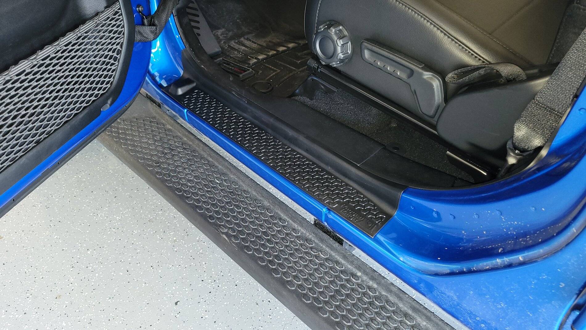

Put on the Rugged Ridge door steps today, along with removing the Wrangler sticker. Sticker peeled right off, easy peasy.
I know there's issues with the seal on the RR, but I don't plan to ford water anytime soon, so will just keep an eye on them otherwise. They ARE very heavy-duty, ~2-3mm thick, which I actually like. Plus the great protection.

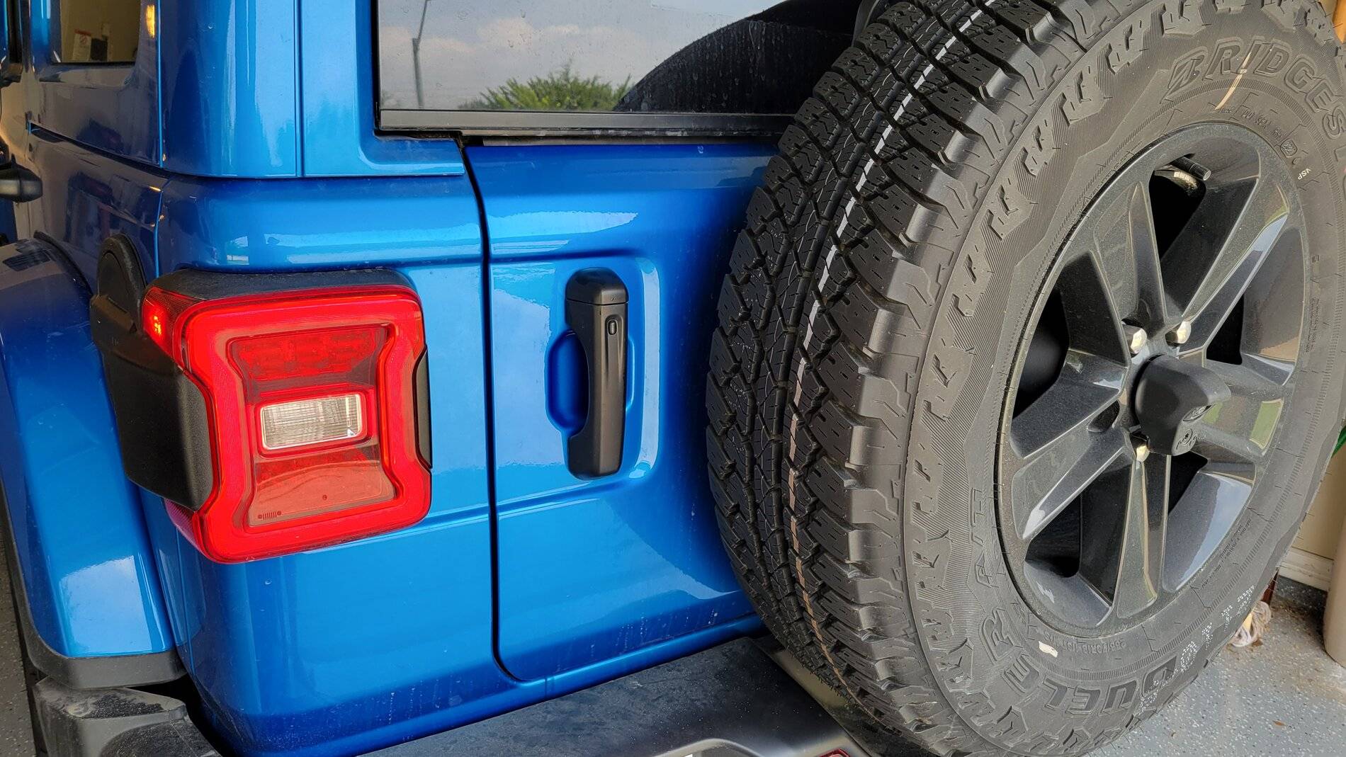

I had posted about these earlier - black plastic door handle inserts. They look great, and as you can see in the pic below, the one for the tailgate fits really well. Unfortunately, the ones for the doors don't fit as well - they're slightly concave, and the cheap tape (not 3M, but similar) isn't strong enough to hold both the top and the bottom flat against the door panel.
My plan is to buy a roll of legit 3M tape and replace all the cheap stuff, then try again.
UPDATE: I decided to just return these. They were $25 for the set, and I'd have to spend another~$25 on 3M tape + adhesion promoter. I'd rather spend the $50 from my budget on other things vs fighting with these.

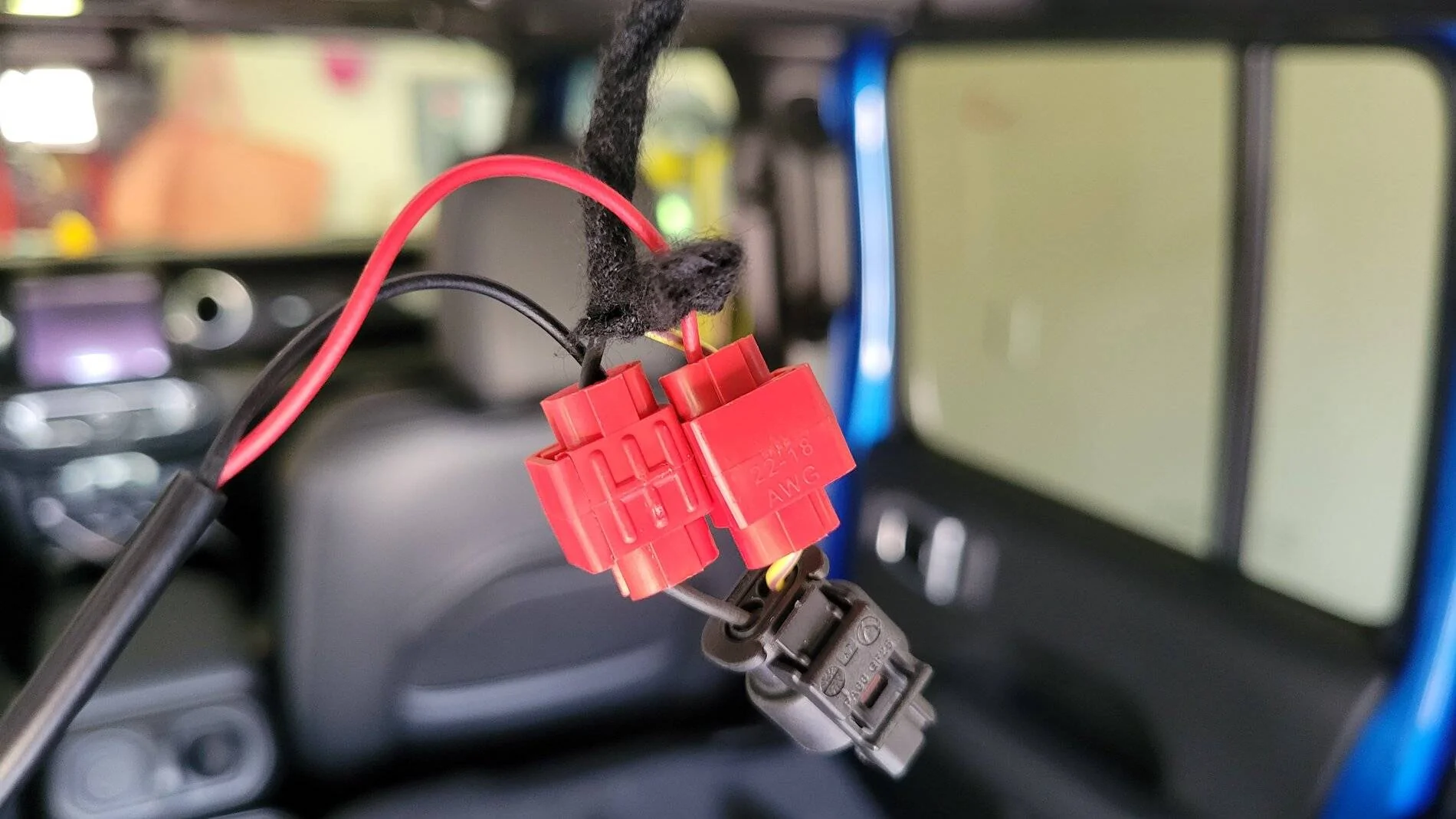

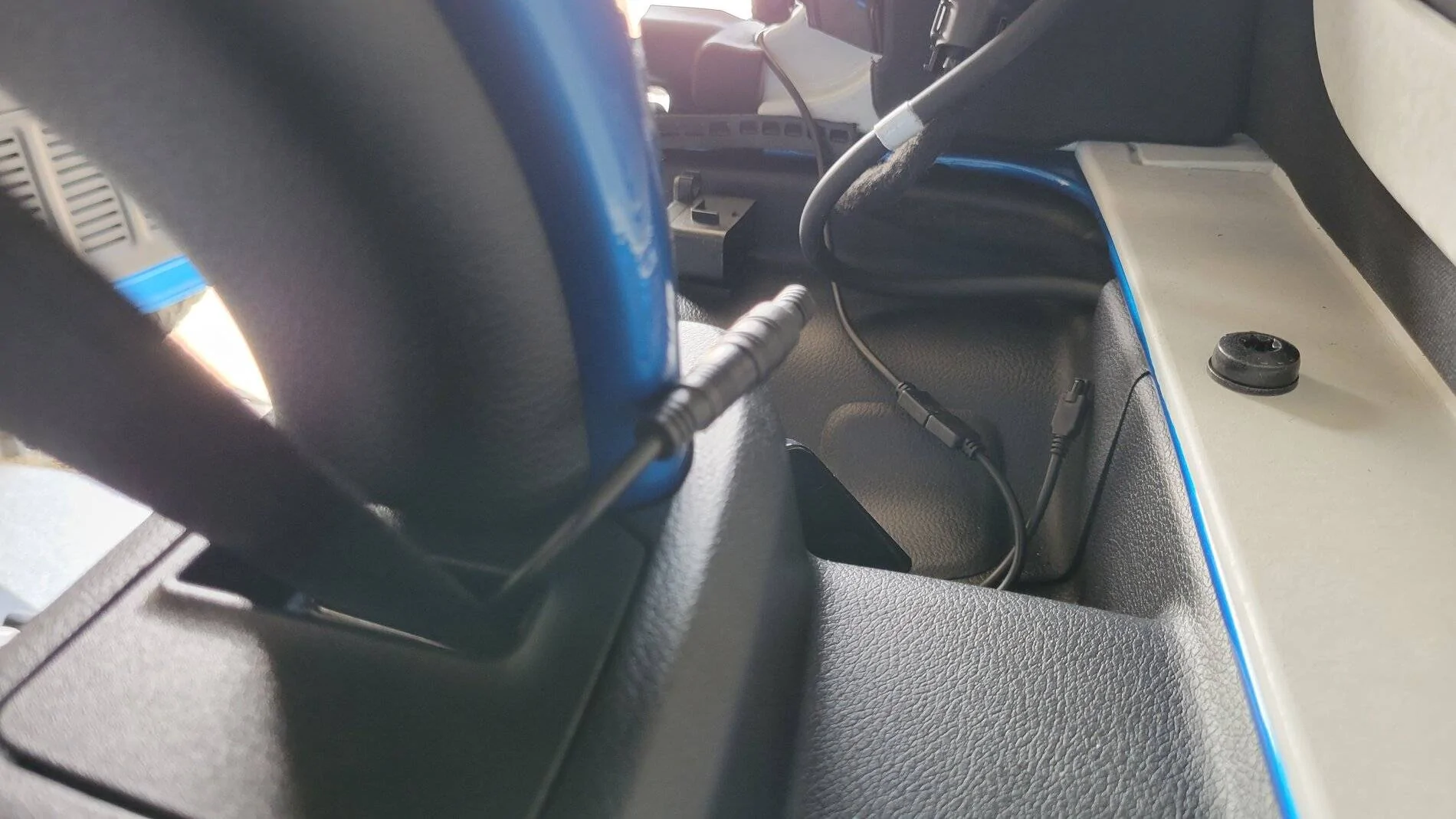

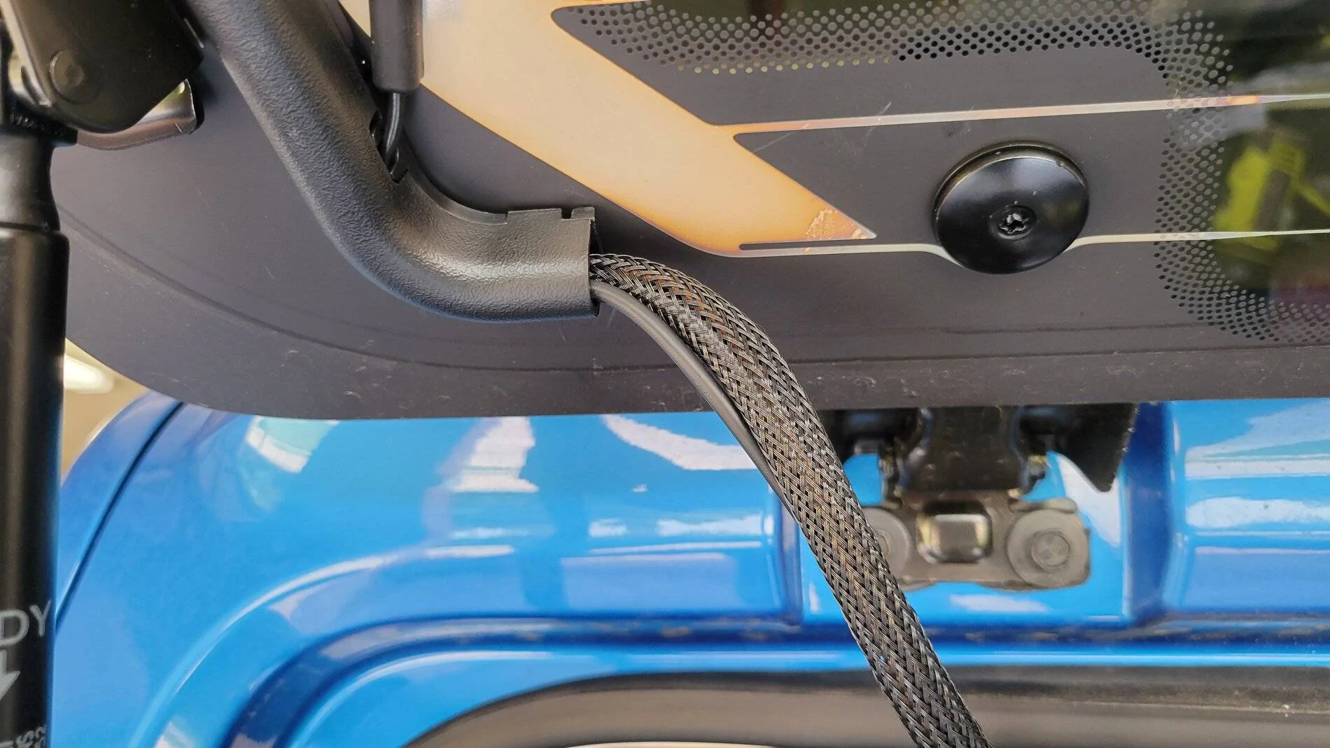

One of my top mods was the Brawlee LED bar for the hard top back window. I was even excited to discover that they had launched an RGB version for only $5 more. No brainer, IMO.
The Brawlee arrived with two methods to power it, which I was quite pleased with. You can wire it directly into the dome lights, or you can wire it up to be plugged into the 12v outlet in the cargo area, and as a bonus, you can actually easily switch between the two, which is pretty cool.
There are two options for running the wire:

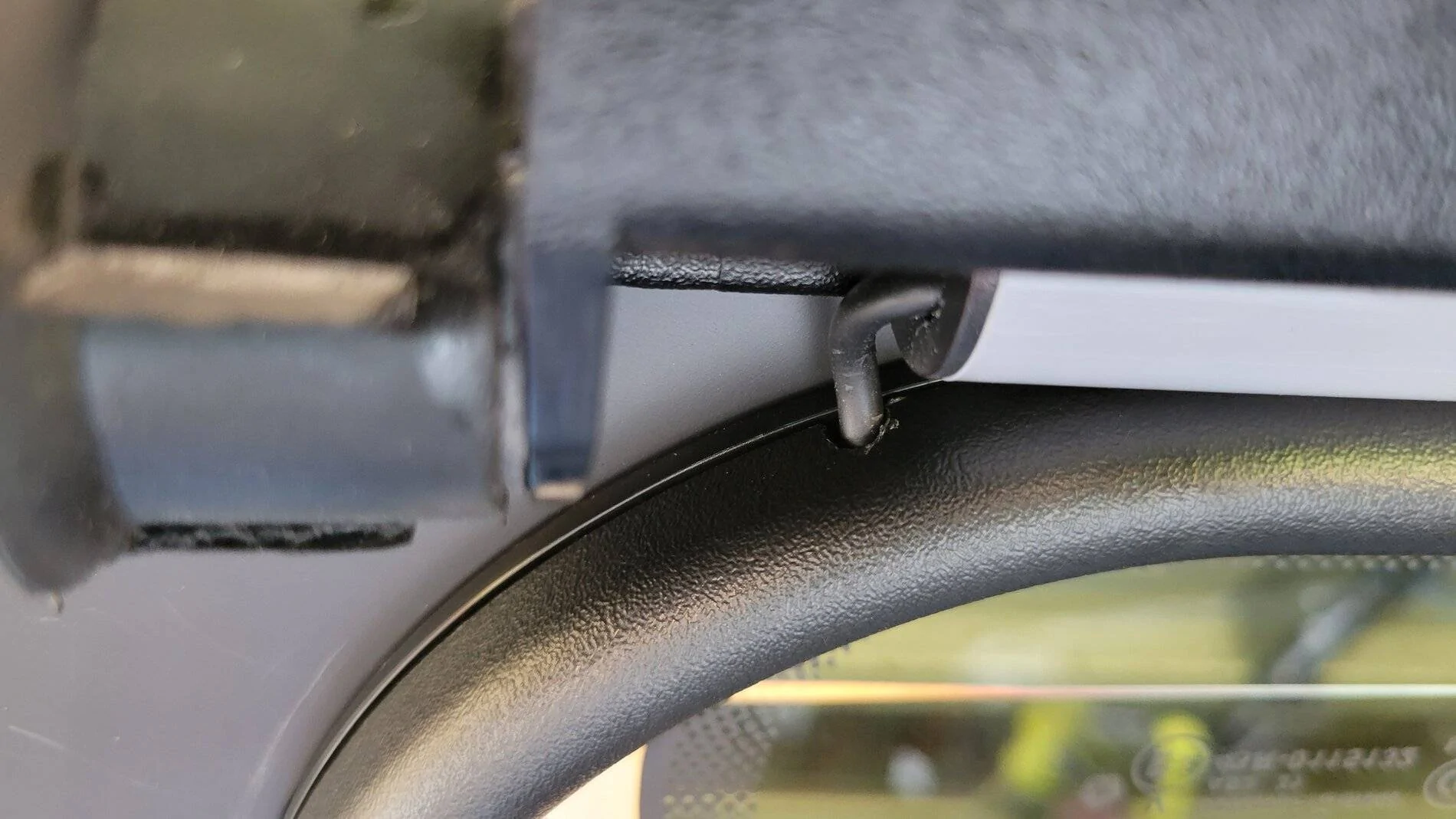

  1. Using supplied 3M clips. The install instructions show this pretty clearly, and the included clips are even color-matched to the section of the hard top they should be attached to, which I thought was a nice touch.
  2. Routing through the existing trim. The install instructions mention this and walk you through which pieces to remove, but I found them slightly incomplete and went to YouTube instead. You'll definitely want a Trim Removal Kit for this - I grabbed one at Harbor Freight.
UPDATE 8/14: When I swapped hard tops, I had to re-install the light and wiring in the hard top, so I took a bit more time and did it even more cleanly to use the existing ports, without having to go underneath the weatherstripping. To do this, you need to first disconnect your hard top wiper fluid/wiring on the bottom right. Then pop the housing for this hole out (it's just a few clips). Now at the center-top of the hard top, pop that hole housing out (again, just clips). WITHOUT the Bluetooth/IrDA bit attached, run the 4-pronged end of the wiring through the center-top hole housing. You'll need to pop the wiring harness/plug out for a sec, but once you get the 4-prong end through, you can clip it back and the wire fits nicely.

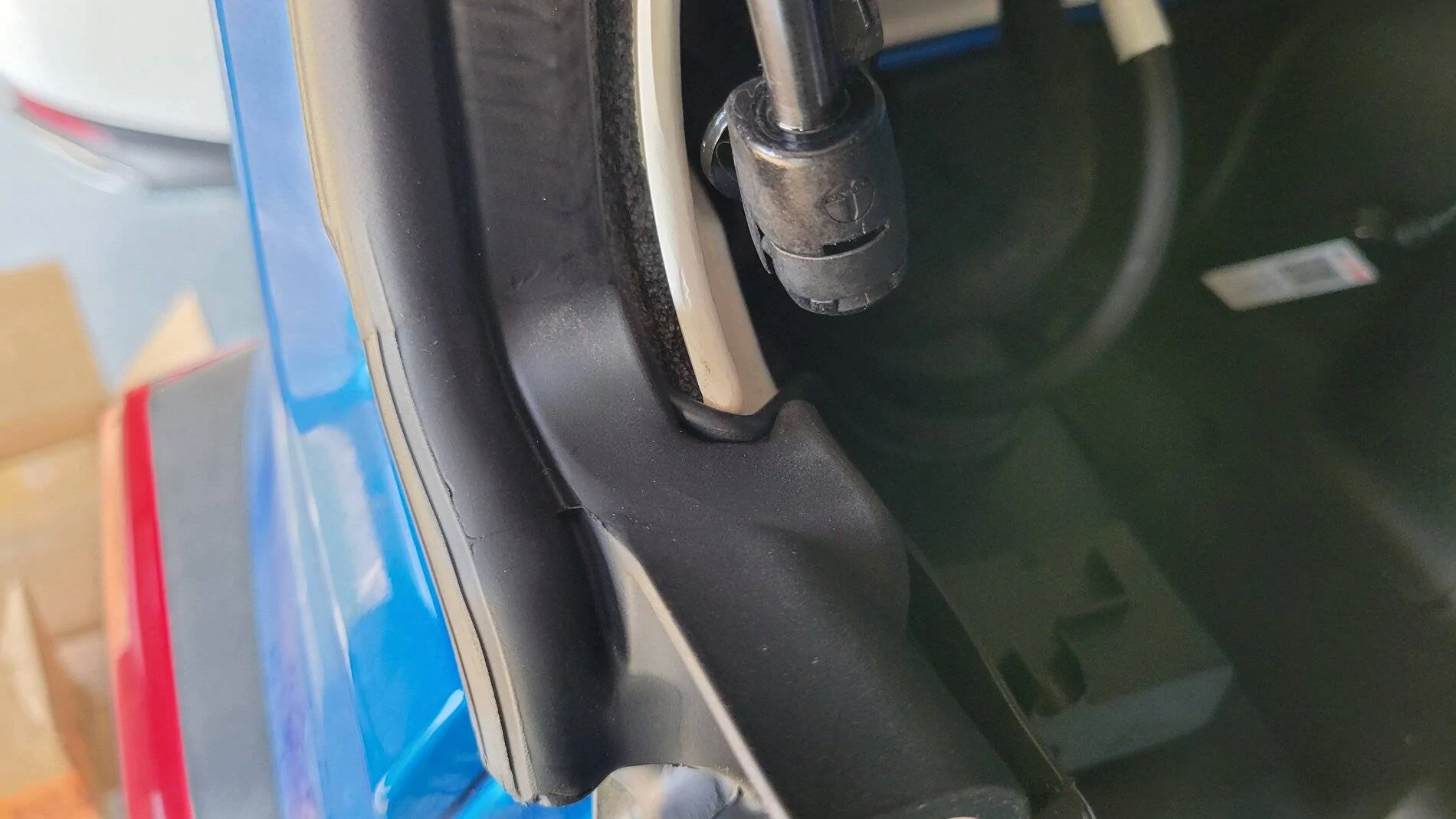

Now, feed the wire through the hard top to the right and down, and reach in through the wiper connections hole to catch the end. Pull it through enough so that the slack is similar to the slack for the wiper connections at the center-top, and then put this hole-housing back on and reconnect everything.
Otherwise, proceed with the directions below. The result is a much cleaner installation and it keeps all of your connections in that same port in the back of the hard top.
So without further ado....the photos.

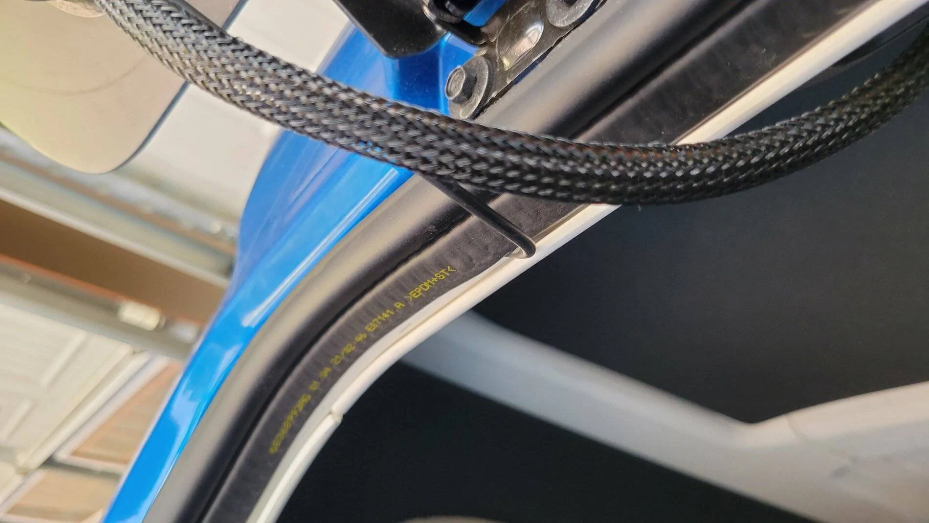

The bar sticks with 3M tape along the bottom of the window, on a little shelf. There is a plastic half-tube along the edge - pop that off at the visible clips to route the wire in. I cut a small notch on one piece with my dremel to allow the wire to easily fit through.
Then leave a length of wire spanning the hinge, similar length to the wiring that's already there for the windshield wiper:
From here, you kind of have two options. You could do a hybrid model and use the white clips on the inside of your hardtop, or you can pull the weatherstripping off and cram the wire into that, and then push it back on. This is what I did, and it *looks* fine, but it's also noticeably different from the other side. You can see the wire slipping into the stripping here:
It then just follows the outline and comes out pretty cleanly at the bottom.
From there you'll attach the Bluetooth/IR dongle, which also has a lead for the power connection. I routed this part of the cord through the plastic casing on the sport bar, as per the instructions. You can see here that the plug comes out of the "back" of the seatbelt bit:
Then you just splice into the dome light wires. I did it pretty tight, and zip-tied the spare cord up here to keep things tidy:
The part that wasn't clear in the instructions is that you're not running the wire THROUGH the sport bar (i.e. inside the metal). Rather, you're routing the wire inside of the PLASTIC CASING of the sport bar (it comes off in a few pieces, some of which you merely loosen vs totally remove).
The result is super clean, and with the plug positioned where it is, you could easily unplug the dome light and instead switch to the 12v, if you wanted it to stay on indefinitely, for instance.
It also comes with a little basic IR remote with a few color presets/options, and a QR code to scan for an app to use your phone via BT. I haven't done this yet.
I'll try to shoot a short video to show the different modes. All in all, though, this kit was fantastic. Once I figured out *where* to put the wire, it was pretty easy. No modifications needed to your rig (unless you choose to like I did).

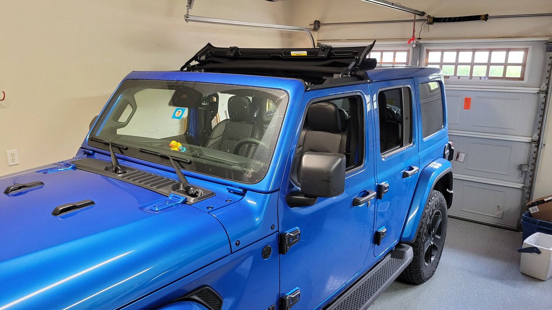

FINALLY got the mod I've been waiting for since I ordered the Jeep - my Sunrider.
A bit of backstory - I drove my first Jeep in 2019, on a weekend trip to Breckenridge, it was our rental. Cruising around, I thought "You know, this is actually kind of nice"
Fast forward through COVID to March 2021, AA ran a 1-day sale on flights to Hawaii - we paid $200 EACH for 4 of us to fly non-stop on American to Hawaii from Dallas. Duh. Rented a Jeep on purpose, because what else do you drive in Hawaii?
LOVED it, but HATED the Freedom Panels. They're so incredibly poorly designed - they only really fit in the cargo area ONE way, and that way takes up nearly the whole damn cargo area. Hassle. So I started researching and came across the Bestop Sunrider. $900, but would allow me to just leave the Freedom Panels at home. Duh.
So here we go. The box arrived at like, 11a, and I had to work till 4p, plus take my youngest to tennis lessons, but I managed to get it installed *just* before we had to leave.
Install was pretty easy - I laid a Harbor Freight moving blanket across the top of the hardtop, just behind the "opening", and set the big assembly on it. Rather than follow the printed instructions, I installed the bars onto the Jeep first, and THEN attached the assembly to that (the way they do it in the ExtremeTerrain video). Took a bit of figuring out, but it all nestled snugly.
Definitely my favorite mod to date, from a functionality standpoint. It's *so* easy to open/close, and seems to have about the same wind noise on the freeway as the freedom panels had. Good riddance to those things.

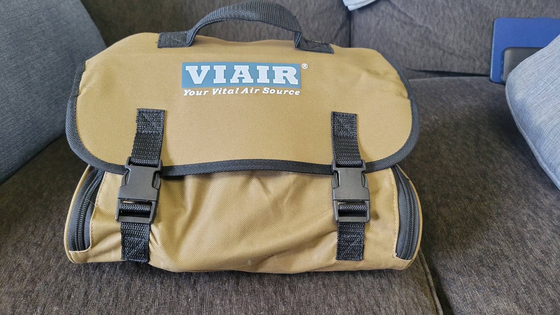

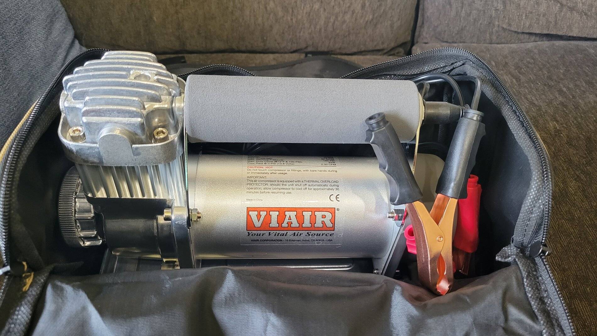

Last of the August mods just arrived - VIAIR 400P. Headed to the off-road park for the first time this weekend and wanted to be prepared.
Next up will be bumpers/suspension, but not till Sept (wifey asked me to pace myself lol).
