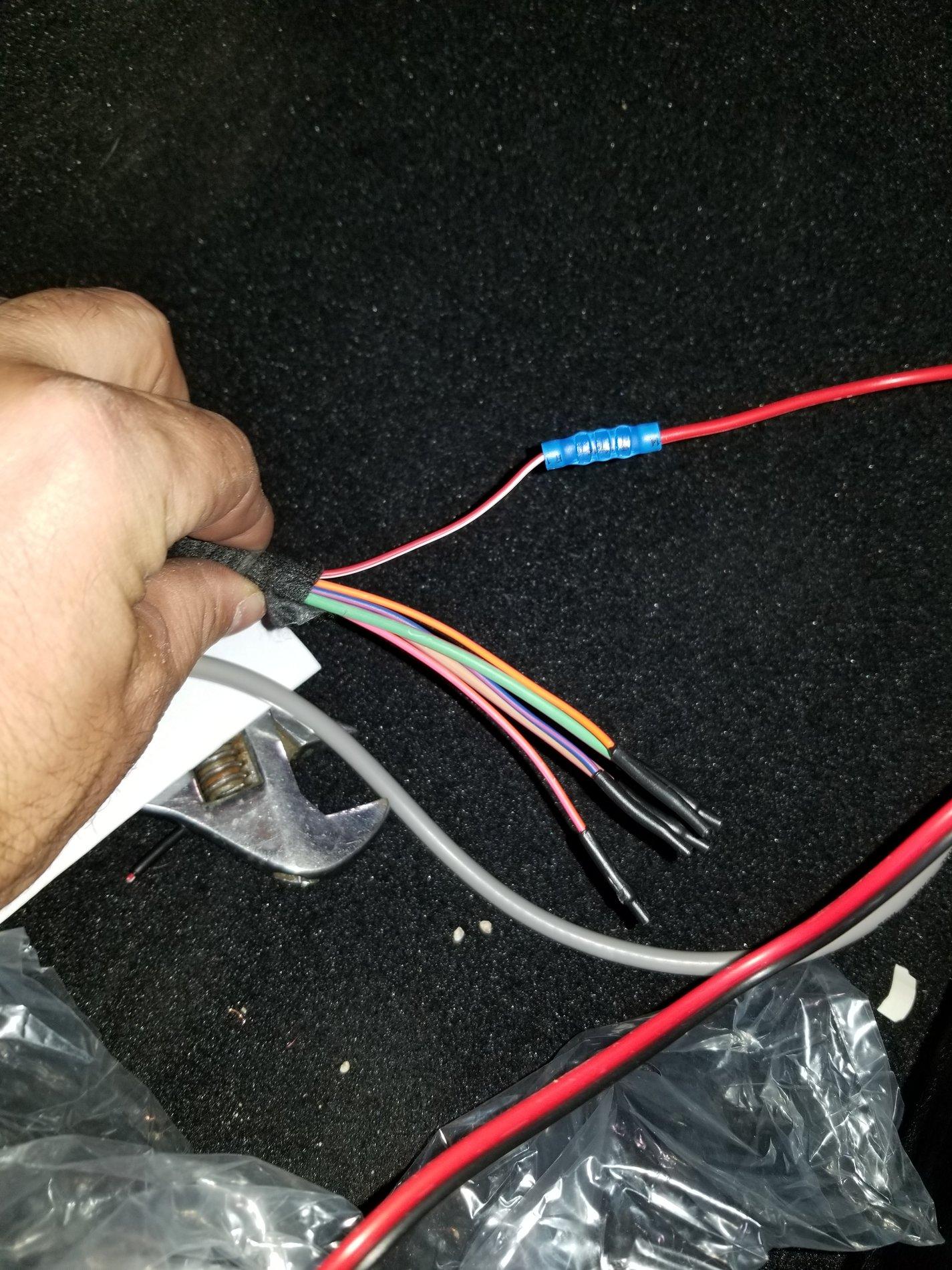

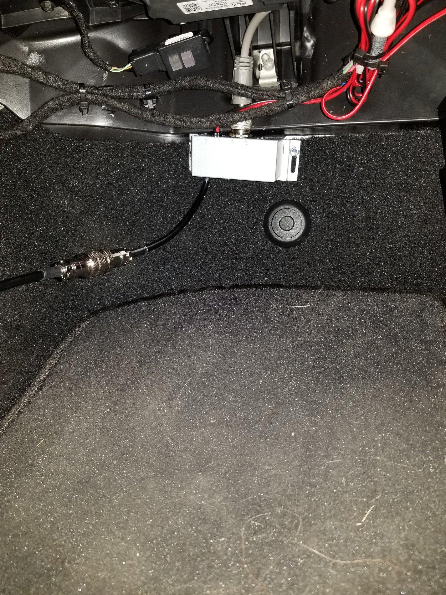

Tied into battery power aux. Under passenger foitwell.. didn't have to waste aux. Port

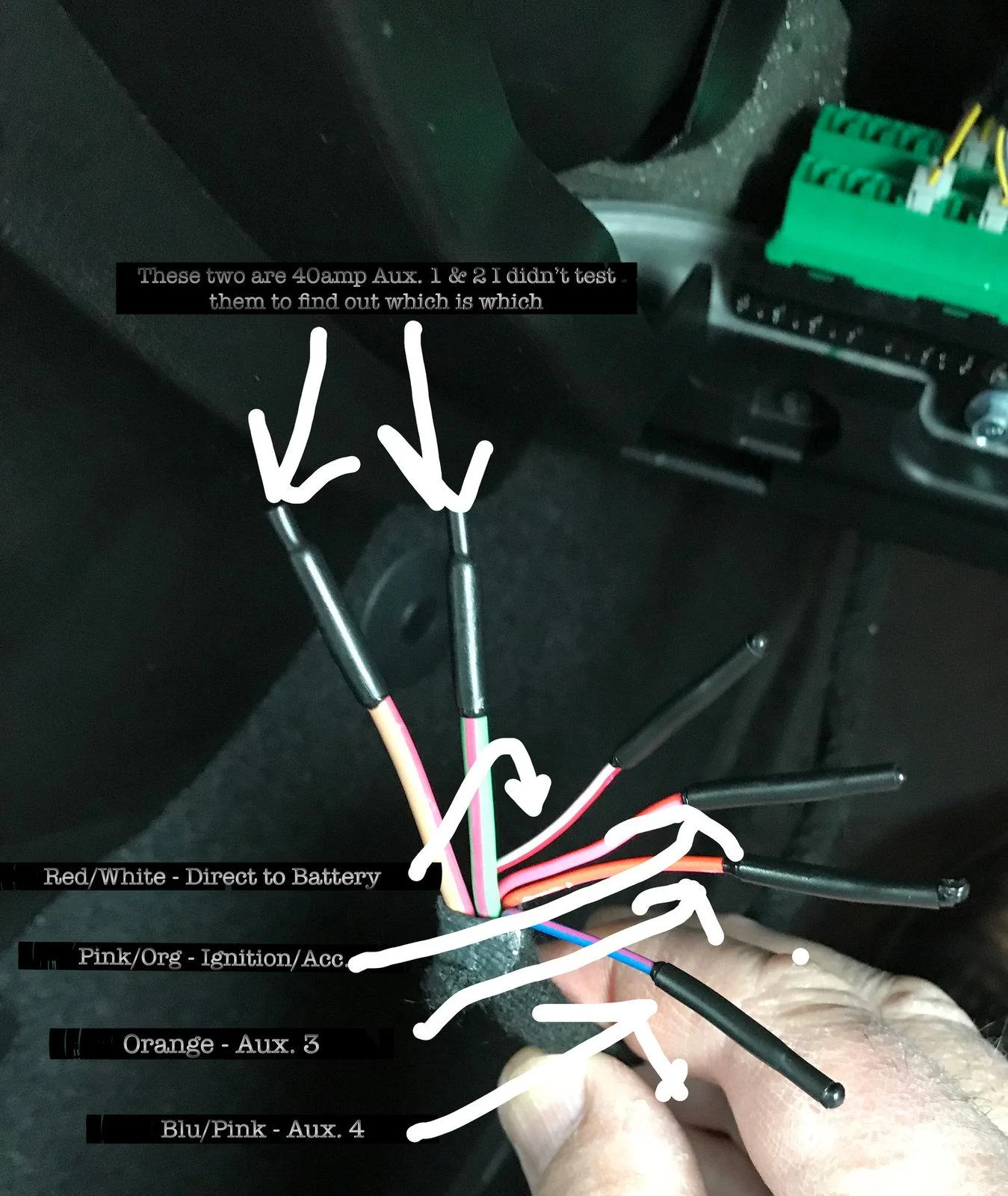

Nice Job! One question: Does that battery power aux tie in have power with key off?
There are 2 aux wires that don't run through the aux switches. One is switched (pink/orange) and one is direct to battery constant on (red/white). You can choose either. See the pic below.

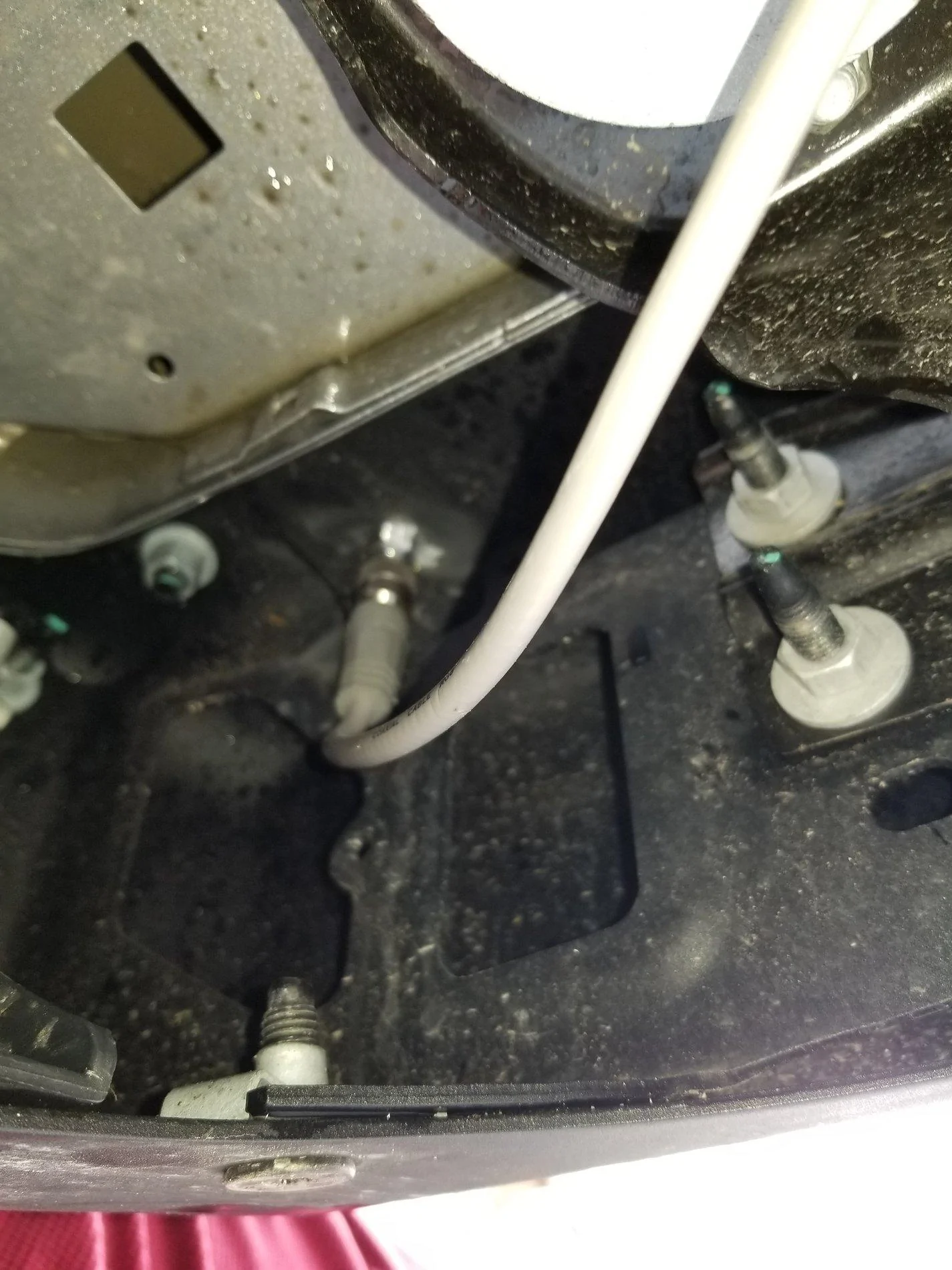

Just installed my cobra 75WXST cb.. went well. Ran through tire jack location and under rear tie down bracket and under carpet and plastic trim. No wires visible..just a note...drill hole in bumper ax1/2" closer to body then I did or antenna will be at slight rear back angle due to bumper bracing.
