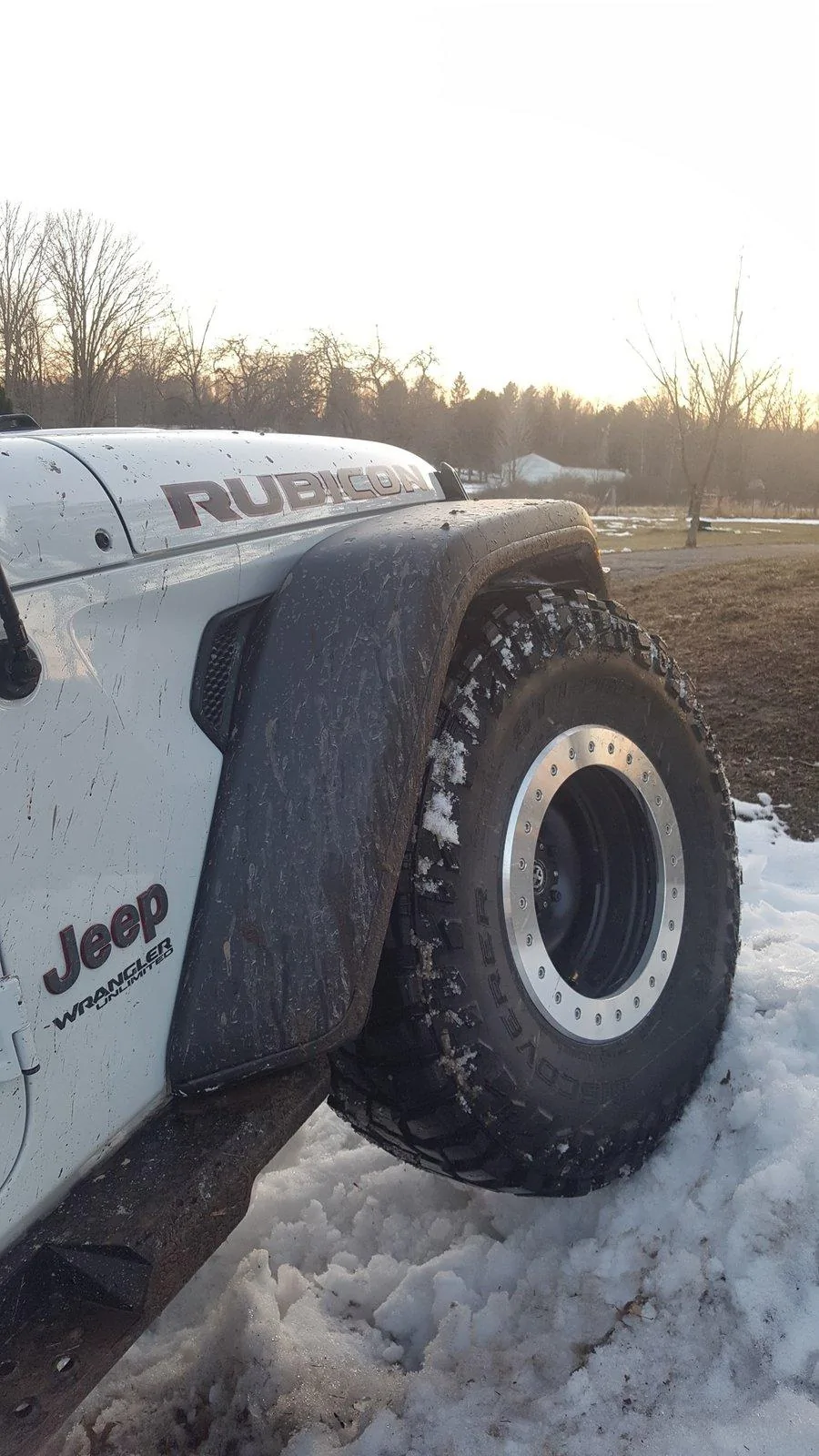

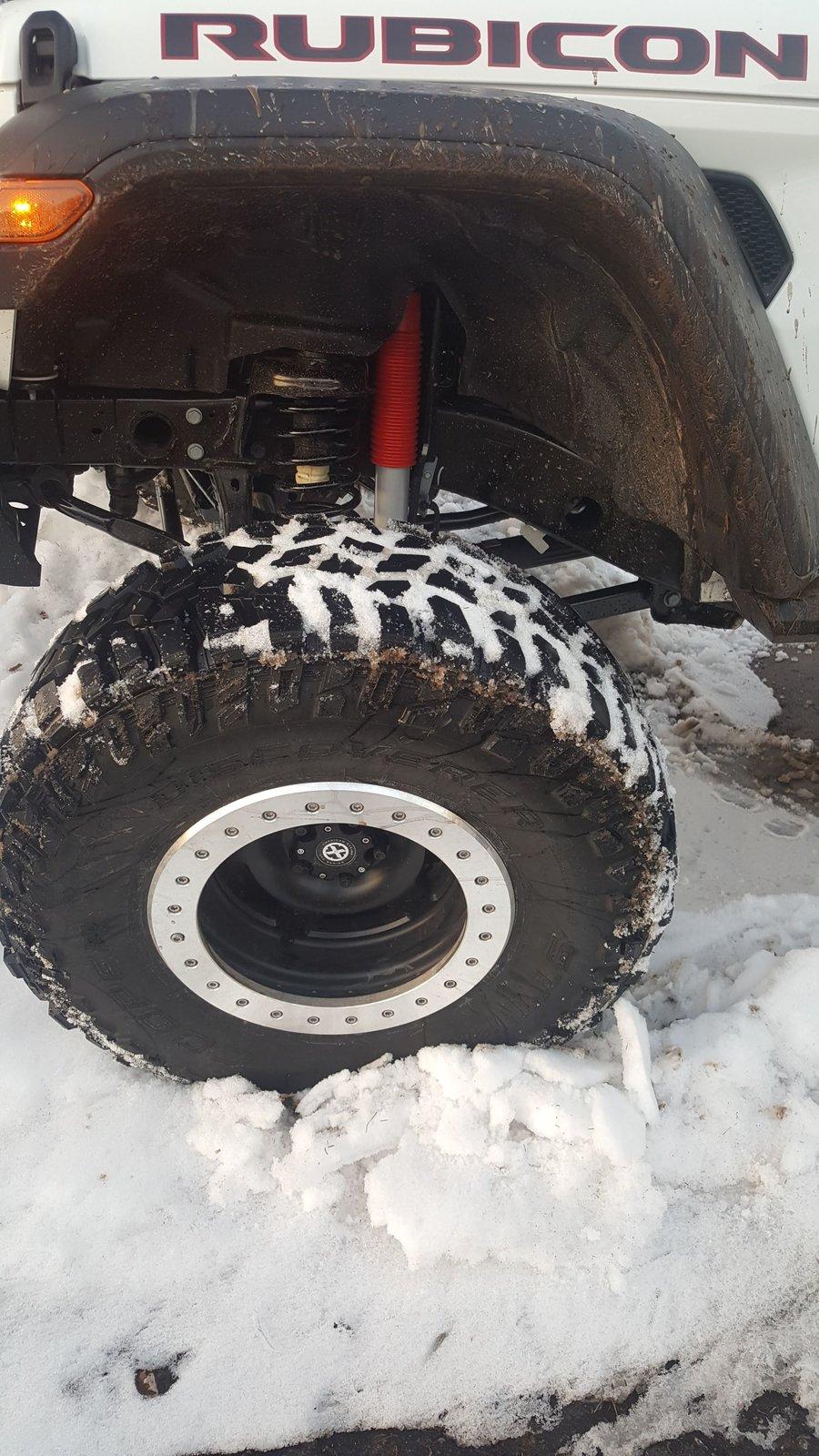

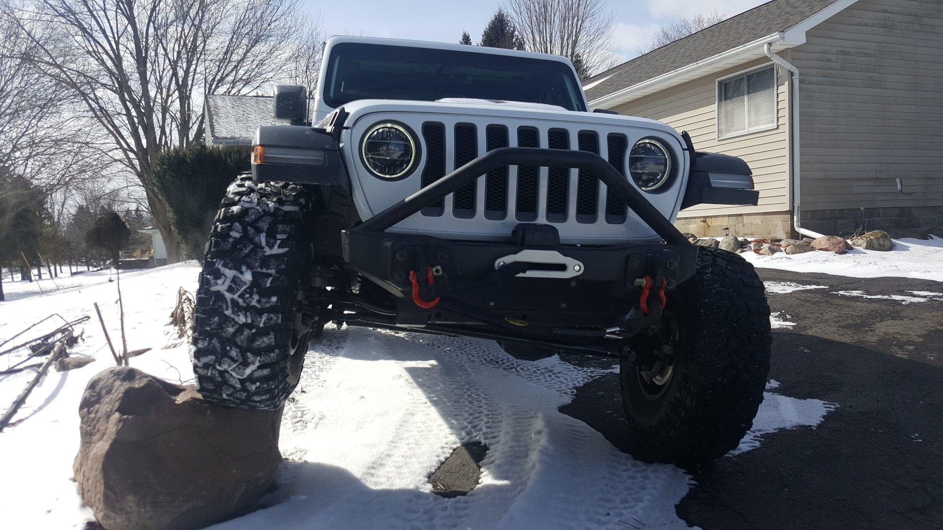

I put the Rancho 2 in sport lift with adjustable shocks on my JLUR. The lift with the shocks is 739 dollars. I run 37X12-17 STT PRO tires. The JLUR flexes great and rides smooth. The tires do not rub. So maybe take a look at Rancho. The lift is even less right now with the rebates.
Some
pics of my JLUR flexing.

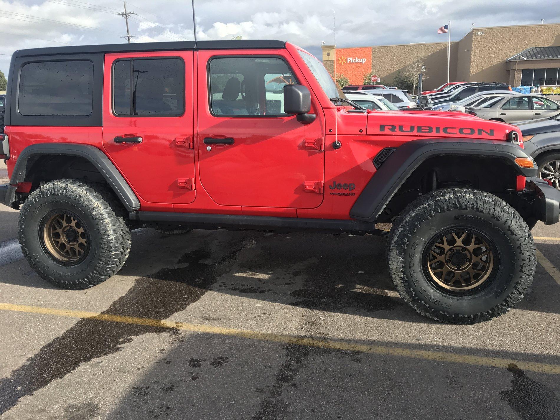

Did you get your lift on? How do you like it?
Here she is with the lift, I haven’t had time to take pics of the driveshaft yet but I can tell that it would need to be replaced over time driving off road from what I could see upon initial inspection. Daily driving would probably be fine on the driveshaft though.
