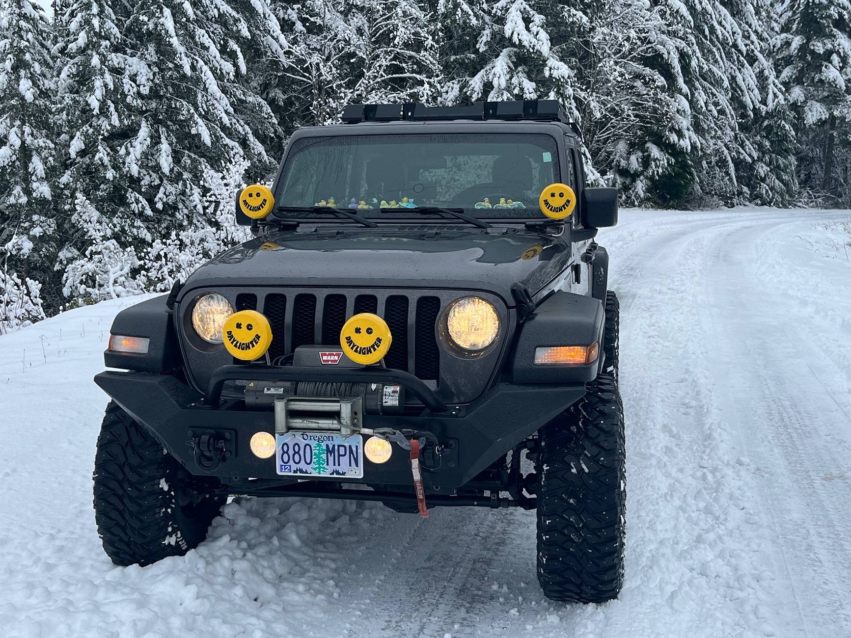

I have basically the opposite problem, I have low beams, but when I hit the high beams, they flash bright then appear to be just the low beams. The high beam indicator shows the high beams are on, but it sure doesn’t look any different than the low beams.
The dealer has (Supposedly) looked at them, always during daylight hours, and says there is nothing wrong with them.
Jeep Wrangler JL JLU-S NO LOW BEAM IMG_1904
The KC’s on the front bumper, are the LED version of the 6” Daylighter Driving Lights, and technically “Street Legal”, and used as High Beams, and dimmed when there is oncoming traffic. The Cowl/A Pillar lights are the LED version of the Classic KC Daylighter Spot Beam Off Road lights.

I had the exact same "problem." Through careful analysis I determined that the halogen high beams were working, they just suck so bad that they aren't better than the low beams. The flash is just the moment while both bulbs are on. My 2004 WJ had solid high beams, so to make a 2022 vehicle with far worse lights is crazy.
I replaced my fog lights (no fog in the desert) with Baja Designs LED spot/flood combos and that works well on totally deserted roads.
