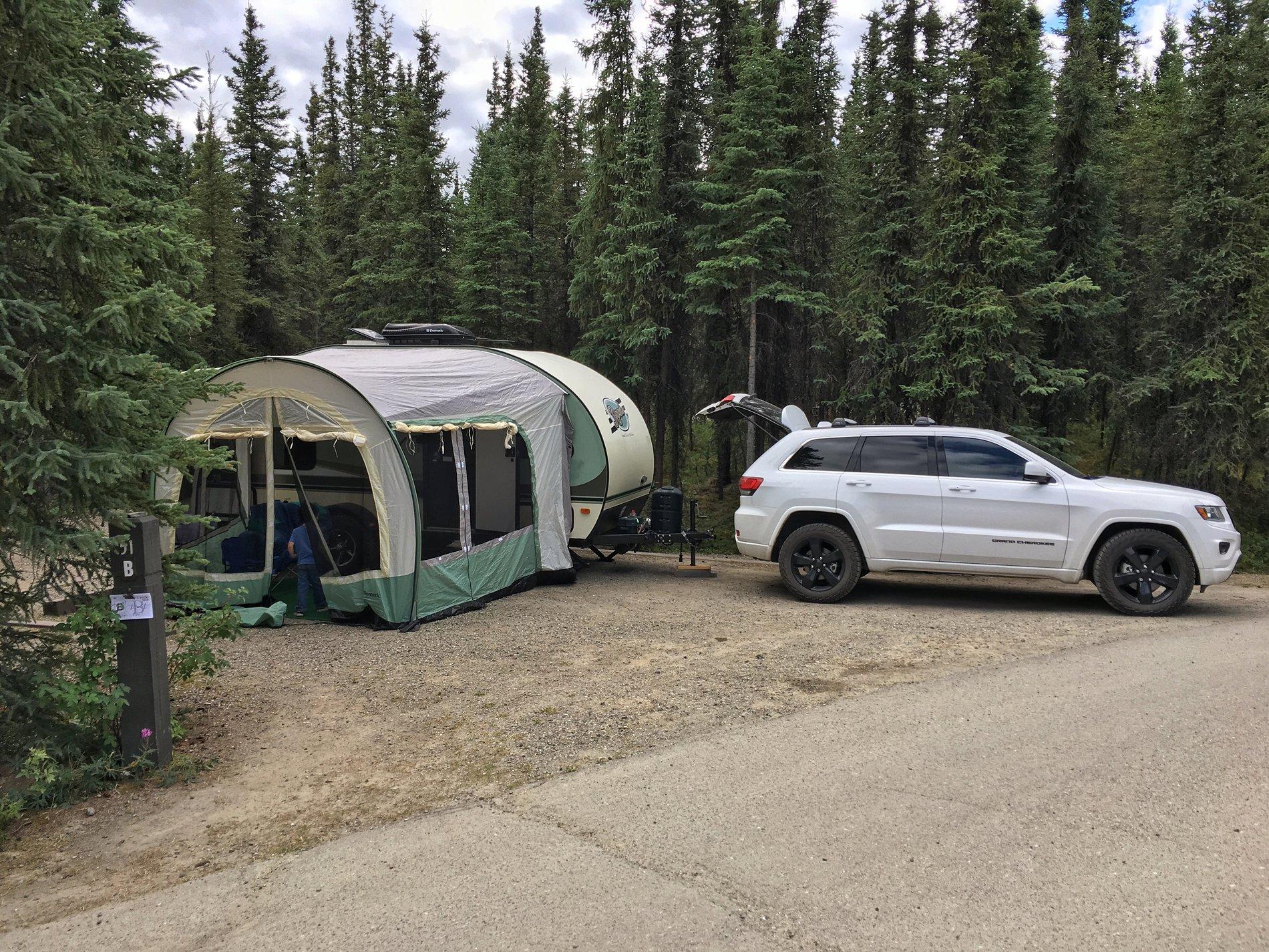

I can sort of second this. We have an Rpod 182G, and I was able to tow it a short distance just fine without a WDH or brake controller using the factory tow package on our JLUR. I didn’t go far and wasn’t on any major roads, but I’d be willing to give it a real go with the hitch and controller. For reference, we have a ‘15 GC with the 3.6 and 8sp AT that towed this trailer 3,600 miles with no issues. The tow rating for that Jeep is 6,200 lbs though. Mileage was similar to what the OP got.

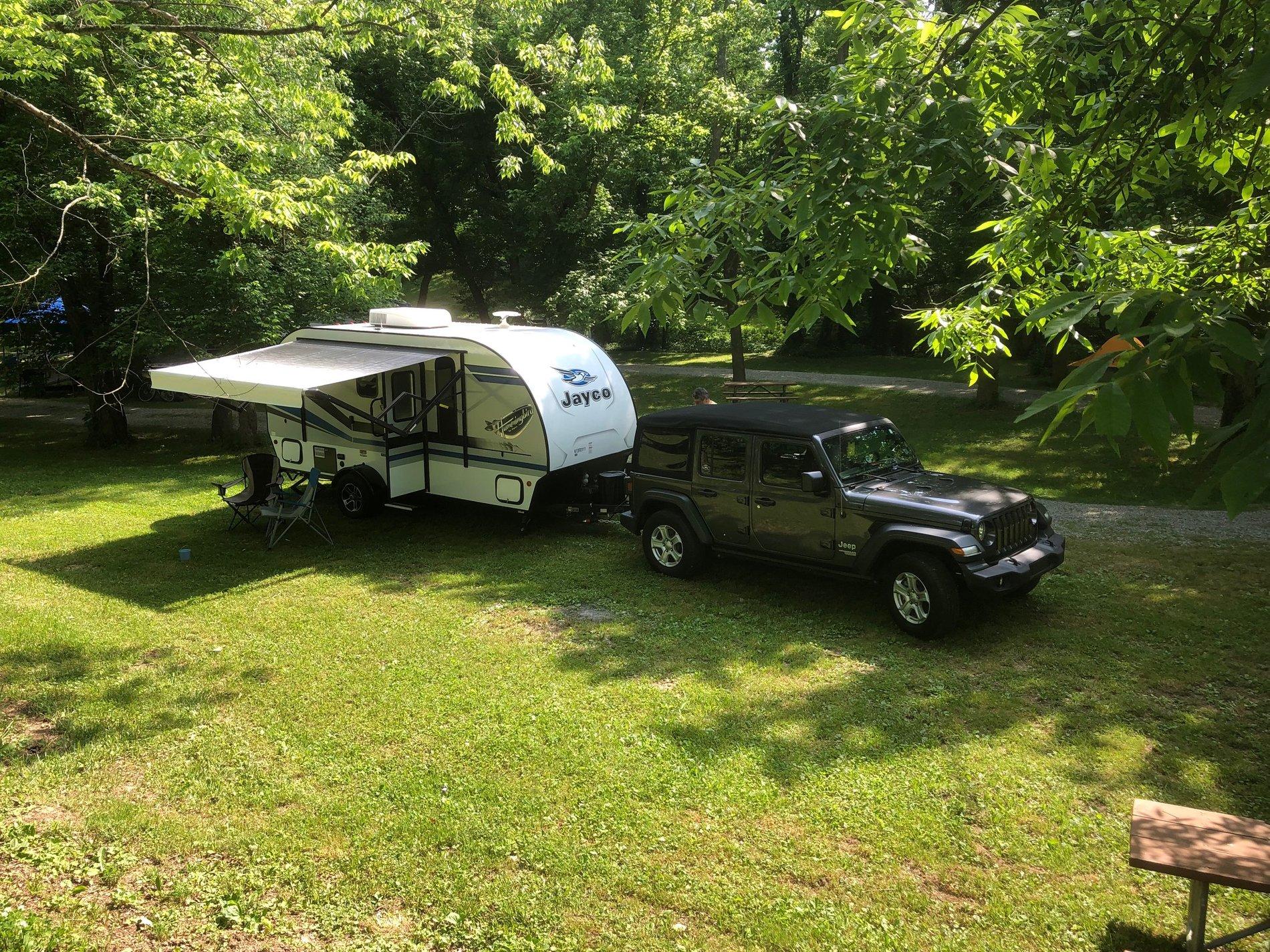

My original plan was to flat-tow the JL behind a Class C. So, I purchased the JL first and while looking at Class C's found that they make Travel Trailers light enough to be towed by the JL. This was a much better fit for how the wife and I camp. I did not want a slide, but I did want a couch, no dinette as the only seating. The wife wanted a big bathroom. The Hummingbird 16MRB checked all of our boxes. The murphy-bed saves sooo much space and it is very, very easy to setup and comfortable. Biggest chore was installing the Mopar trailer wiring harness (didn't need this when the plan was to tow behind the Class C) so I had to add it and the Mopar hitch $$. It wasn't too bad, but this was my first crack at removing interior trim panels. I also installed rear air bags, Andersen weight distributing hitch and the kewlest Curt Echo Mobile brake controller. Just got back from our maiden voyage, a 7-night 700 mile round trip from Eastern Kentucky to Nashville, TN with stops at Boonesboro State Park and Dale Hollow State Park. JL handled the Hummingbird very well. CAT Certified weights: Frt Axle-2160#, Rr Axle-2600#, Hummingbird Axle-2720#. Weights are with full propane, full fresh water, empty grey and black water, and a full gas tank. Then we loaded chairs, grill, groceries and all the other camping gear...probably another 250#. Engine temp and trans temp stayed right where they normally were, transmission shifts were spot on, some of the longer uphills the JL shifted to 4th and about 4k on the tach kept us at 65mph but this was rare. We averaged 14.4 mph which I thought was outstanding. Only semi-white-knuckle was in some 30mph crosswinds, but the Andersen WDH kept the Hummingbird on track. I also am one of those fortunate JL owners that had experienced the steering-wobble (death-wobble is just too dramatic) but after the third steering stabilizer the problem hasn't resurfaced. We stayed four days at the KOA close to the Gaylord in Nashville in their premier spots next to $500k and $600k 50' motorhomes and I didn't once feel intimidated. Looking forward to next trip...this month to New England.
14.4mpg average is super impressive!

The 14.4 mpg was the computer's number for just that 700 mile trip...I don't know how accurate it is. I did not measure the fuel I used and divided by the miles, so this was not a scientific test just the computer read out. I did, however, use Premium gas for the trip just to avoid any potential detonation/spark knock on long uphills, this may have given me a small mpg boost.
