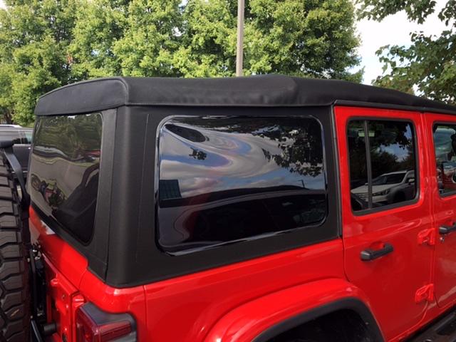

Took mine to the dealership hoping they would get new ones ordered under warranty but they weren’t much help. Sent an email to Jeep cares to try to get them replaced. They look awful.
I got my rear window replaced under warranty by the dealer. The replacement window is actually worse than the original. I complained and a ticket was opened to Jeep by the dealer for the the entire soft top to be replaced under warranty.

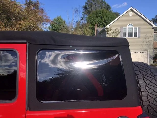

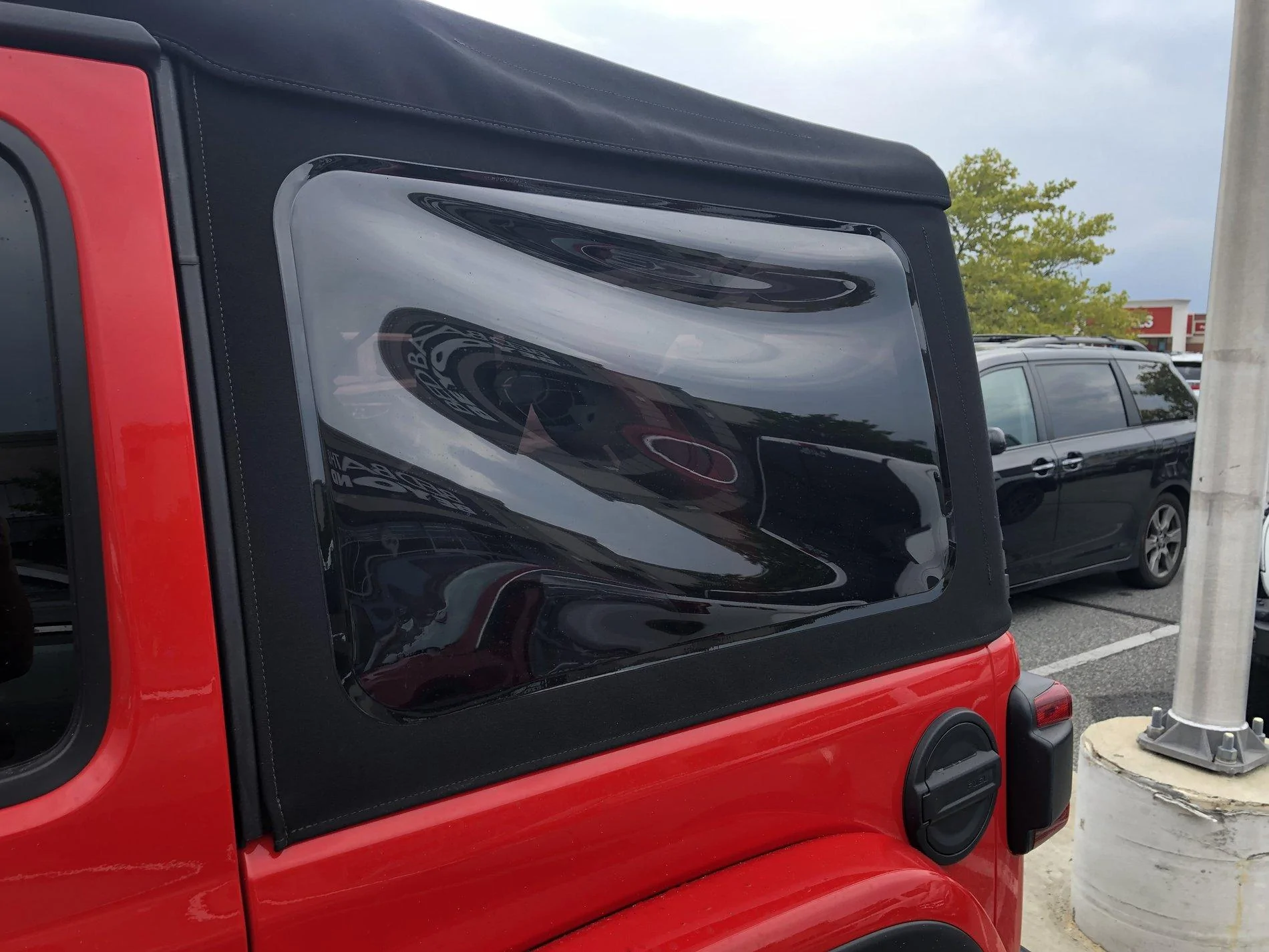

Since the dealership was worthless in dealing with the sagging Jeep soft top windows, I contacted Jeep Wave to get it resolved. It took me two weeks of emailing pictures and a couple phone calls but they are replacing all 3 windows. They said that the window part numbers changed from when the top was built. My guess is that they made the windows slightly smaller so they stay tight in the opening and don’t sag. Not sure how soon the windows will arrive, but soft top season is quickly ending in Pennsylvania, so hopefully they arrive soon so I can try them out.

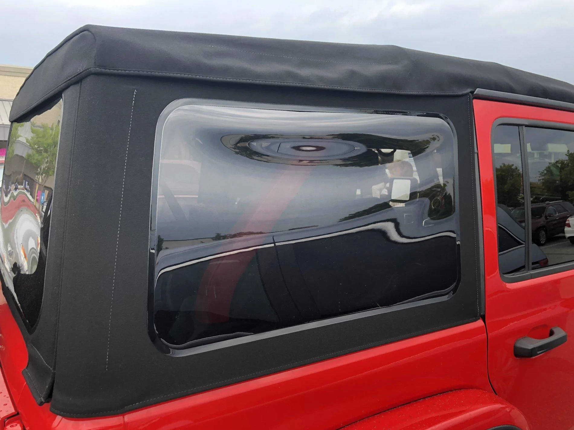

I did receive the replacement windows and had them on the Jeep for two weeks before switching to the hard top. They are an improvement but I am already starting so see some sagging in the side windows, just much less. Didn’t notice any sag in the back window yet and it doesn’t unhook from the Jeep like from driving like the old one did. I am starting to think that there is a design flaw with the soft top frame not fully supporting the side windows and keeping them stretched tight along the entire length of the window. The windows hook to the fabric of the soft top which isn’t supported and I think the sagging soft top leads to sagging windows. Look at how the top corner of the soft top dips right above the rear window.

Quality post bro. Thanks for the info plus the pics of the new windows. While not perfect, the new ones do look better than the sagging bulge at the top of the windows that I have going on now.
