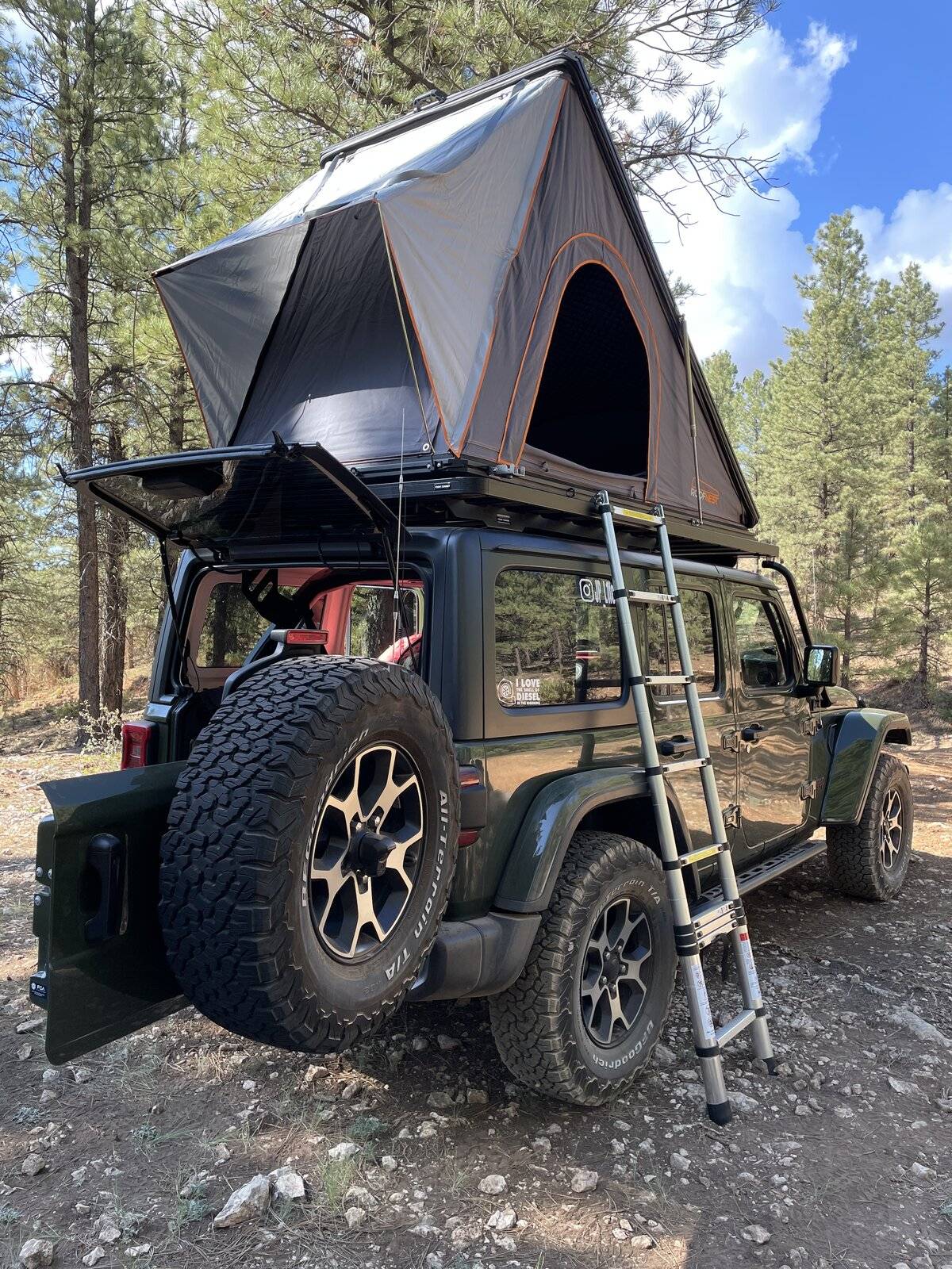

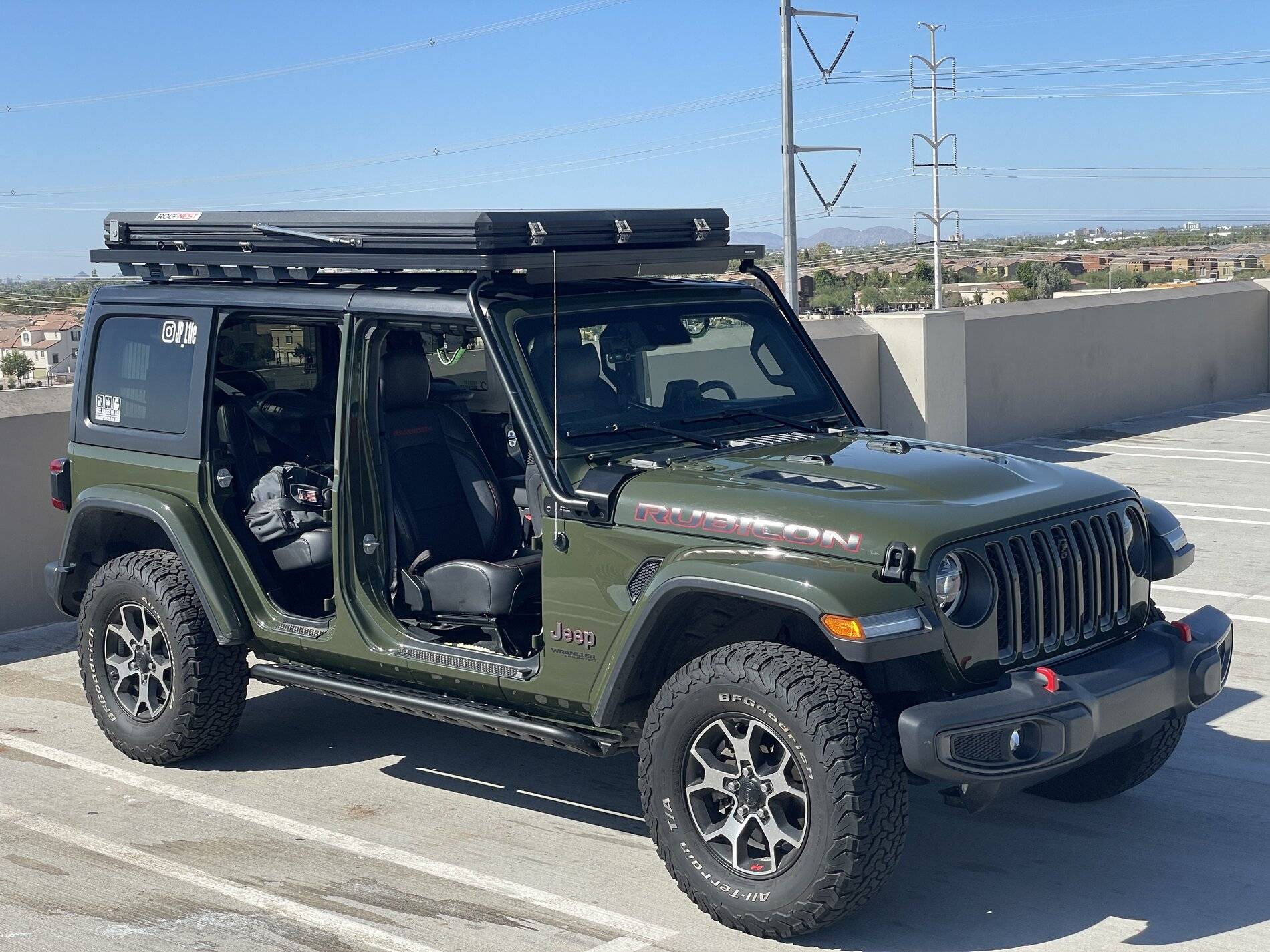

In my opinion, a full length RTT is not a joke! The strongest most stable roof rack is a must in my opinion, specially if the Jeep is going to flex! My RTT is 180 pounds, I paid twice as much for it for it to be this light, and paid twice for a roof rack to be able to hold it, that should tell you how serious I am about securing this! And I still don’t think I could flex the Jeep without it possibly coming off, moving, shifting or similar!
if you want the best rack, get the front runner full rack.. they picked up the jeep by a helicopter hooking it to this rack and it held! That’s good enough for me!
the reason I don’t think it could hold up to serious flex is, they shipped me the tent with 4 brackets to hold it.. and I feel like 8 brackets would have been perfect! And those brackets are out of stock now :/
