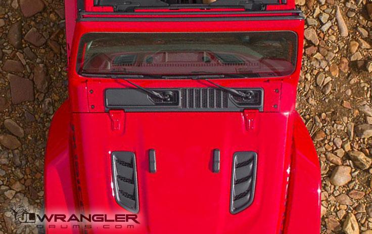

Anyone notice the 'easter egg' in that overhead pic ? The vents at the bottom of the windshield look like a Jeep grill. Awesome stuff.

Good eye man. Love little details like this!!

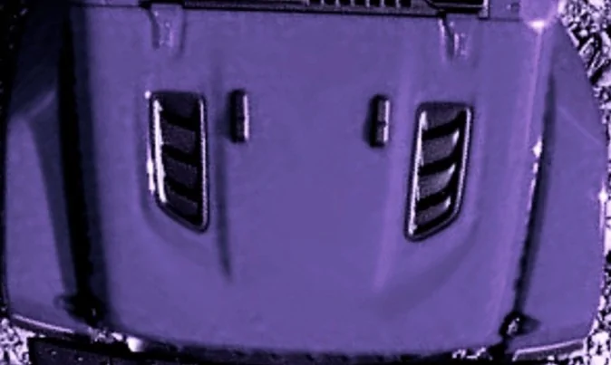

Are the hood vents there just to save some weight? Are they functional, and how do they keep rainwater from entering?

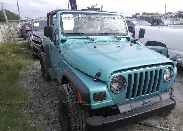

I think the 1997 was the only Wrangler without the 7 slot air intake.

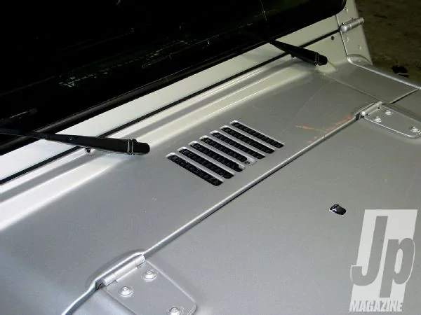

1998- later TJ:
How's it keep rain out? It doesn't. Rather it works like a trap and allows the water to drain out lower in the box than where the HVAC takes in air. From there, the air is filtered anyway.

As for the bigger ‘hood vents’ they are functional, but like the JK they will likely be channeled to manage air & water flow, and therefore can and likely will be opened up further with mods to improve venting when the vehicle is stationary or slow moving. Both designs are assisted by faster moving low pressure air drawing dead air out of the engine bay.
The current hood vent holes channels water to a void and a plastic covered dead spot, this vent seems similarly designed, and is surprising as the early examples were more like a metal grate/mesh on early test mules.

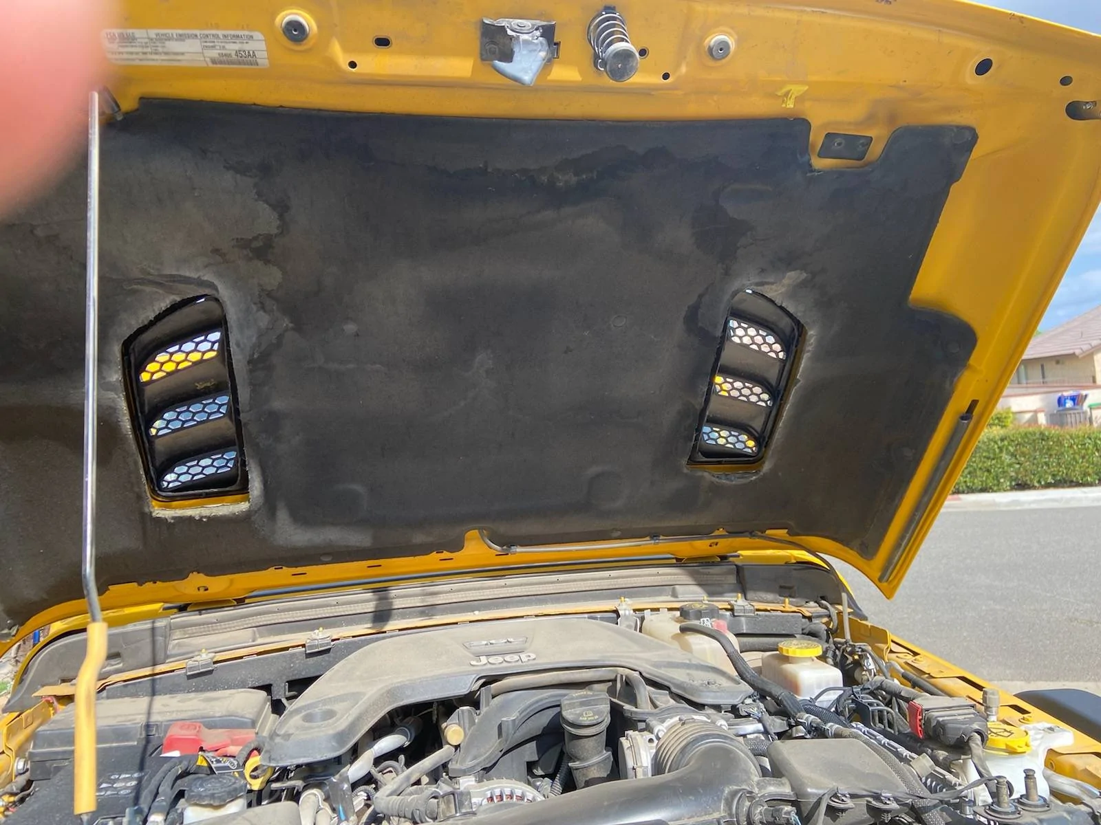

The JL hood vents could be like those on the 10/X/HR/etc/etc/etc hood. When you truly need the extra ventilation, the plastic pieces just quickly pop out, leaving the full opening open.
Yea, I know. People have no problems removing the hard top, removing the doors, dropping the windshield, but the thought of all the hard work required to pop out the plastic pieces is just too unreasonable. :whew:
