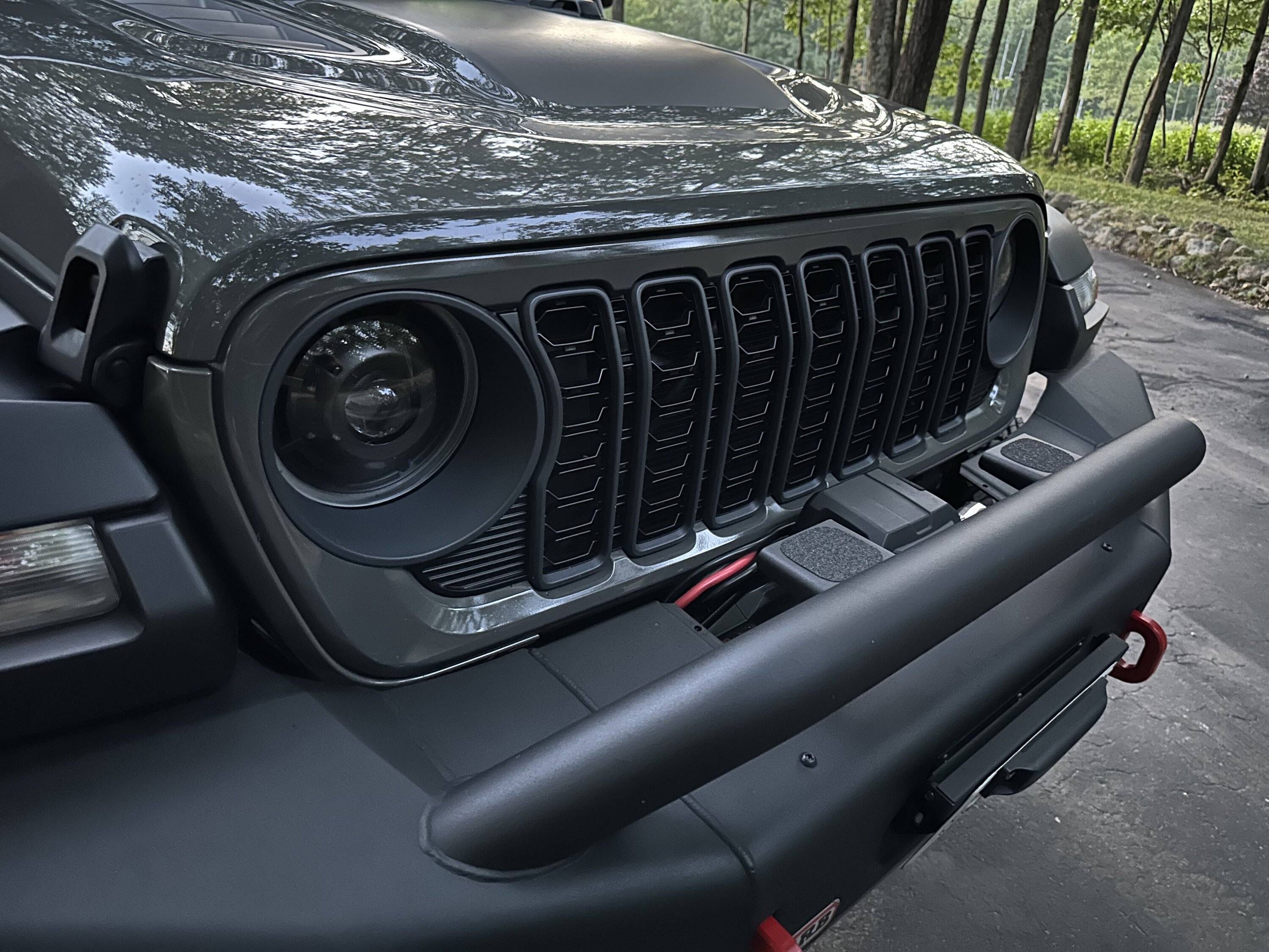

Hello,
I could not find info on the instructions and I am no expert so here are my thoughts.
The 24 grille is way better in my opinion if you like more air flow and I have a diesel.
you must make some cuts to remove the two bars you can see on the body color insert, just make sure you use a rotary type tool.
you can reuse all hardware from the old grille on the new one.
I love they way the 24 grille looks- I see the old one in the garage and I think it's dated now.

Although I first thought the 24 grill was hideous, I admit that it is still growing on me. The all black grill like yours looks much better than the the body color surround one, and the fact that you have a high mounted bumper with winch guard and a winch, hides what makes this bumper so controversial, which is the ‘’dead spot ‘’ at the bottom of it that sandwishes the vents up higher, making it look like the renegade grill.
I think the better airflow argument is total bullshit.
The airflow argument is real trust me, I have had both next to each other and way more air can move though the 24 grille

Nice, it is a good looking grille on some colors, and added customization options are always a plus. I would take one in chrome, if they ever offer it.

I love the looks of the new grill.

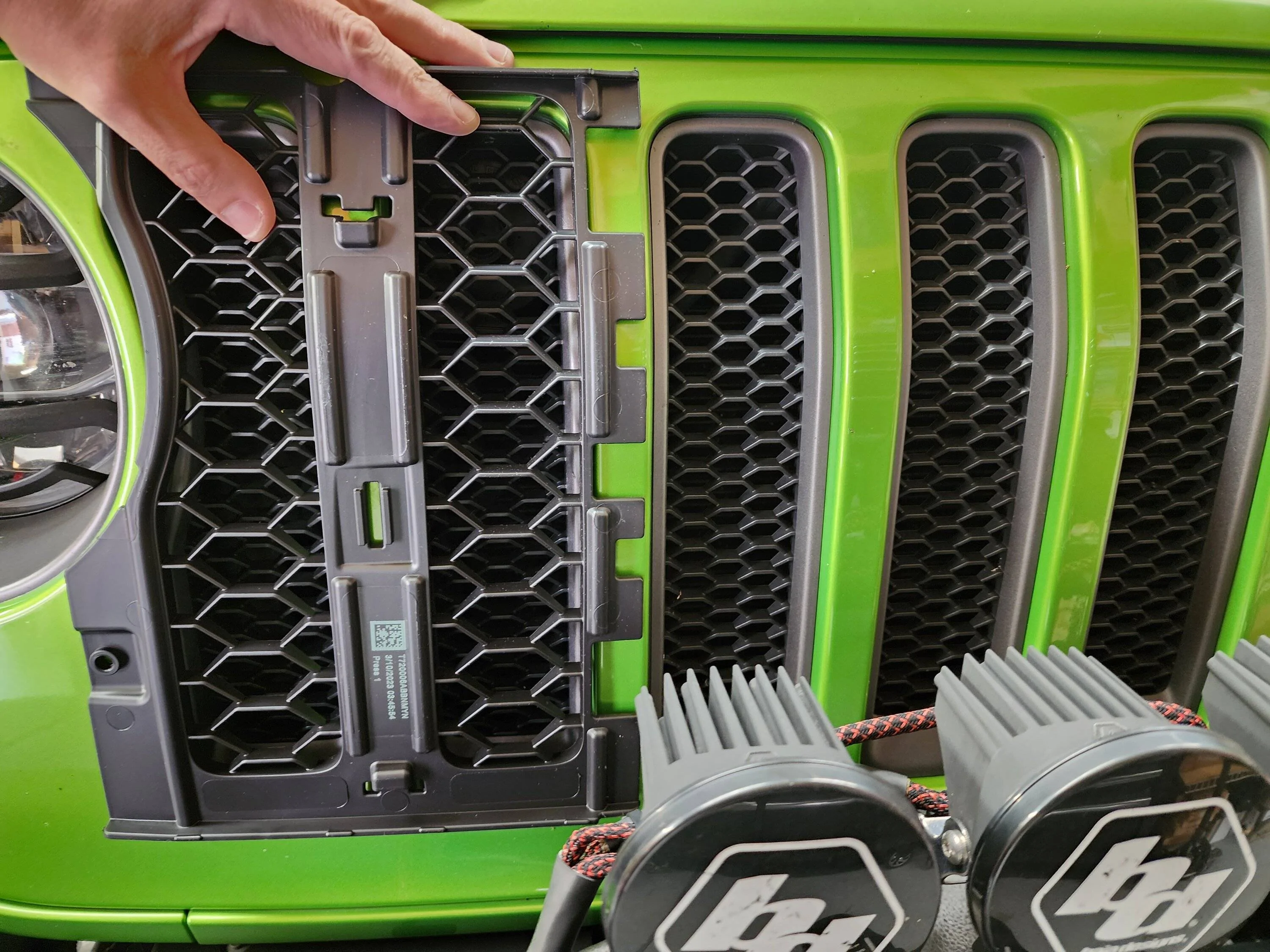

How does the flow compare to the old grill with Gladiator inserts? It would seem they would be close if not the same given the Gladiator inserts are at least twice as open as the Wrangler (the new grill is not growing on me):

I would probably do the gladiator inserts and keep the same look. While I like the styling of the new grill (grew on me over last few months).. I dont like the reduced height (squished look).

I did the JT grill swap last year and unfortunately haven't seen any noticeable decrease in engine temps. At least it was a cheap, easy and reversible mod, but based on that experience, I doubt the '24 grille will result in lower engine temps.
Thinking back to my old CJ and TJ, I'm actually considering doing away with the inserts altogether, especially since we don't have insect issues like I experienced when living in the southeastern US. Even then, the JT inserts really wouldn't protect against the swarms of love bugs anyway because they're so wide.
