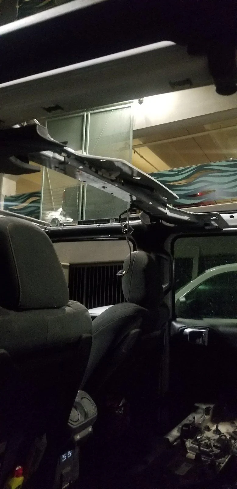

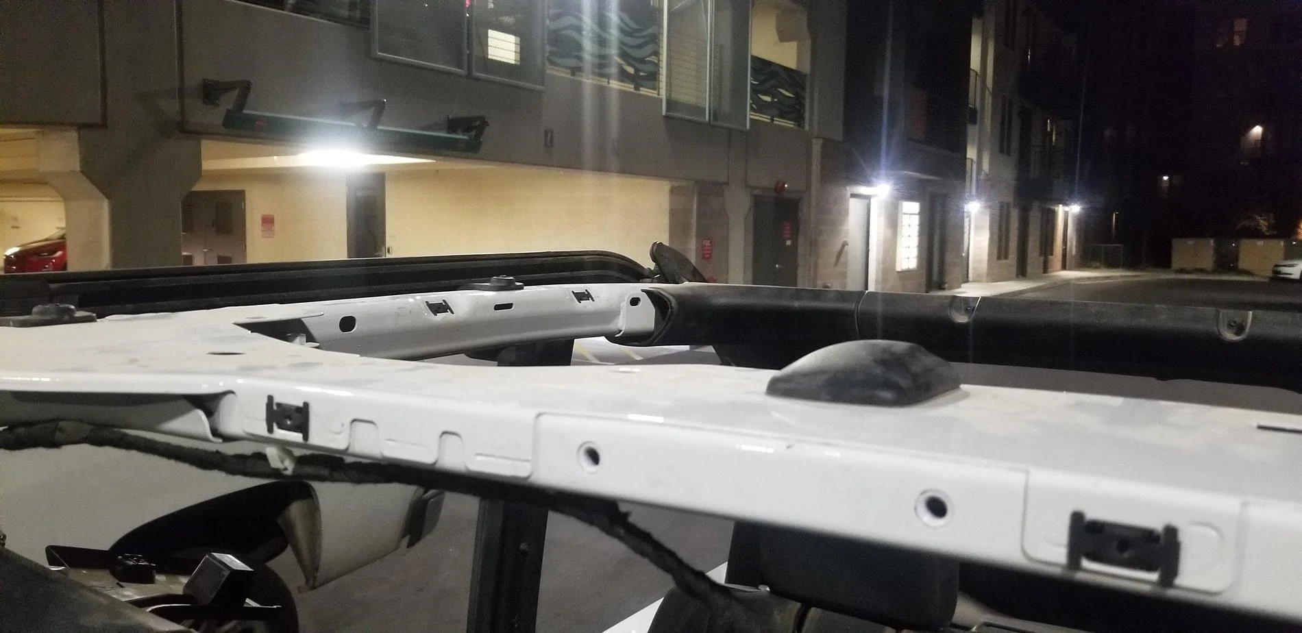

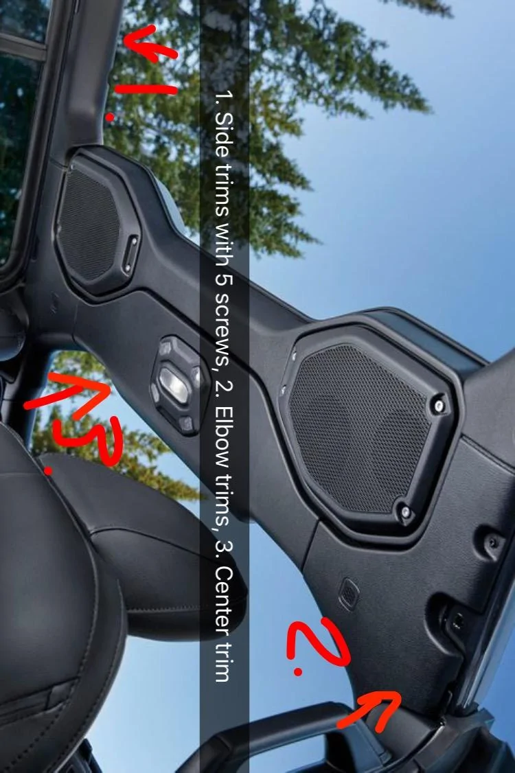

Thank you very much, Nick. It will be a project for me this weekend.Hey, just removed my sound bar on my JLU with base sound system, slightly involved, you have to remove the side trims in the back seats roll bar, 5 t25 screws hold it on 2 up top 3 below. then the elbow piece that is on the drivers and passenger side, 1 t 25 screw on the bottom of each, with some metal retaining clips holding them in, then lower your dome light under the soundbar, pops out. Remove the center trim below soundbar by removing 3 t 25 screws at the top area of trim. Several metal retaining clips hold it in. Then you are left with 6 10mm bolts holding the soundbar, 4 on the outer edges, and 2 in the middle, once those are removed the sound bar will lower and can be removed. I applied felt tape in the areas where i felt it would come into contact with the metal roll bar, reinstalled and the rattle is gone. It took about an hour, i was trying to figure it out as i went and i had power tools to help. Hope this helps

That's as much as you can remove? In the JK it was just a slim piece of rectangular tube.I just removed mine , here is some after pics if u were still curious
I'm not sure that's all I removedThat's as much as you can remove? In the JK it was just a slim piece of rectangular tube.
