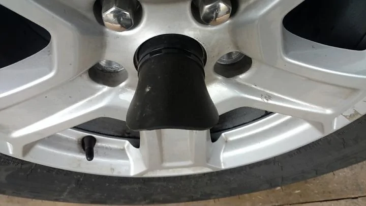

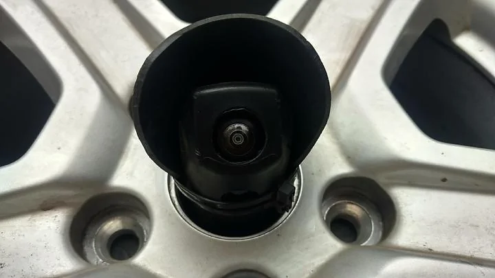

I thought I would create my first post to help anyone else that may doing the same mod after intalling an afer market swing-out rear bumper. I am sure that I will not be the only one faced with this problem on their JL.
I didn't find much on doing this mod when researching. After using google and replaceing my bumper, I found that you will need additional cabling and a mounting bracket to support the camera and 3rd brake light to support the additional space required for the swing-out.
This is what I bought to support (sorry I used Canadian amazon links but if you are in the USA you will have a much easier time than I did getting each part delivered to support the install:
https://www.amazon.ca/EAG-2018-2019-Wrangler-Extension-Harness/dp/B07JJ1N8DZ
https://www.amazon.ca/gp/product/B07CWFBQ48/ref=ppx_yo_dt_b_asin_title_o00_s00?ie=UTF8&psc=1
The installation was very simple once you have the parts.
Here is another link that I found to support a camera extension if needed.
https://www.pasternack.com/fakra-plug-fakra-jack-rg174au-cable-assembly-pe38753h-12-p.aspx
I hope this helps.
