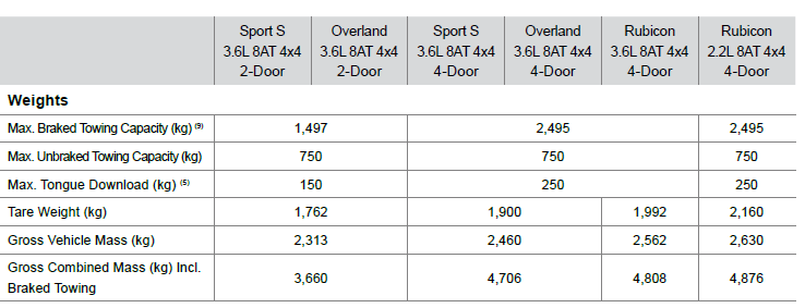

The vehicle manual states that a certification label is applied to the driver's side door or pillar, but as you point out, there is nothing on mine either.
According to the technical information on the spec brochure;
Jeep Wrangler JL JL 2.2 TD JLUR Payload upload_2020-3-10_22-38-36
The difference between the Tare Weight (Standard Vehicle) and the Gross Vehicle Mass (Total Weight of vehicle and contents) is the allowable weight of occupants, luggage and vehicle add ons like winch, bull bars etc. Anything you add to the vehicle must be included in this calculation including the ball weight of any trailer you may be towing.
For the four door diesel Rubicon this is 470kgs.
