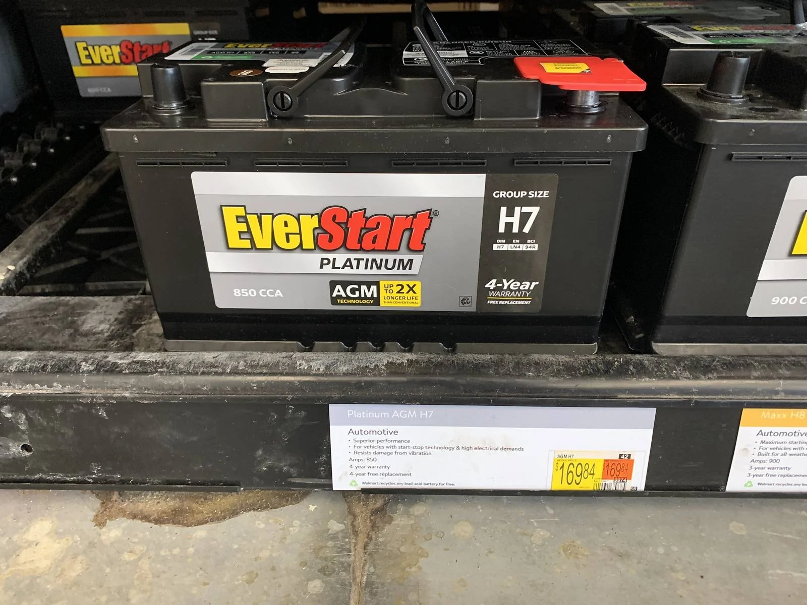

Just switched my stock battery’s 2 days ago.. 4 years and 65k miles. I used diehard platinum for both.
  • DieHard Platinum AGM Lead Acid Battery, Group H7 850 CCA
  • DieHard Platinum AGM Battery, BCI Group Size 400, 200 CCA
    Part # AUX14-1

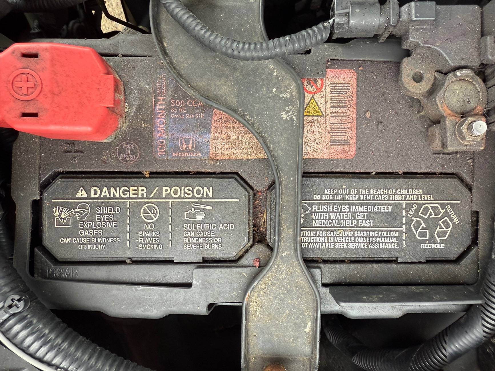

Battery life is a function of many things. Parasitic drain has a lot to do with it. I still have the OEM in my 21. I made the mistake of letting it sit in my garage while I was out of town for 3 weeks a few months back without putting it on the NOCO to maintain it. The battery was mostly dead when I got home, and I've been getting the AUX Switch warning on startup ever since. (Putting in a new battery later this week.)
In contrast, the Jeep is the first vehicle I've ever owned in over 40 years that I didn't get at least 5 years out of a battery. In fact, I just changed the battery in my wife's 2014 CR-V. It was the ORIGINAL battery! 130,000 miles without ever being on a battery tender, even when it sat for weeks at a time! No parasitic drain there.
