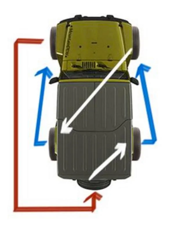

Do it yourself. Super easy (easiest of any vehicle I have ever owned) and you’ll know it’s done right. (Or if you mess up, at least you have only yourself to blame. It happens: https://www.jlwranglerforums.com/forum/threads/oil-filter-o-ring-placement-matters.34840/ )
Besides the inconvenience of going to the dealer, too many of them are putting in 6qts of oil (because that’s what the 3.6L V6 took in the previous generation).
A 5 tire rotation is very easy as it only requires that one wheel be jacked at a time.

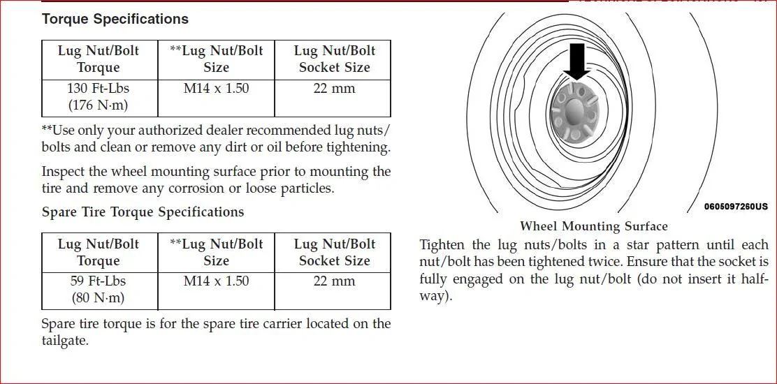

Here’s the note I keep on my iPhone to keep things easy:
Oil:
5q 0w20
Oil Filter:
MOPAR MO-349 68191349AB/AC
Mobil 1: M1C-456A
Air Filter:
MOPAR 68257030AA
8mm socket
Cabin Filter:
MOPAR 68301863AA
Tools:
22mm lugs
13mm drain plug
24mm oil filter cap (torqued to 18lbs)
Pull F11 & F97 to reset UConnect
(Edit: this is not a maintenance item, just a “note to self”)

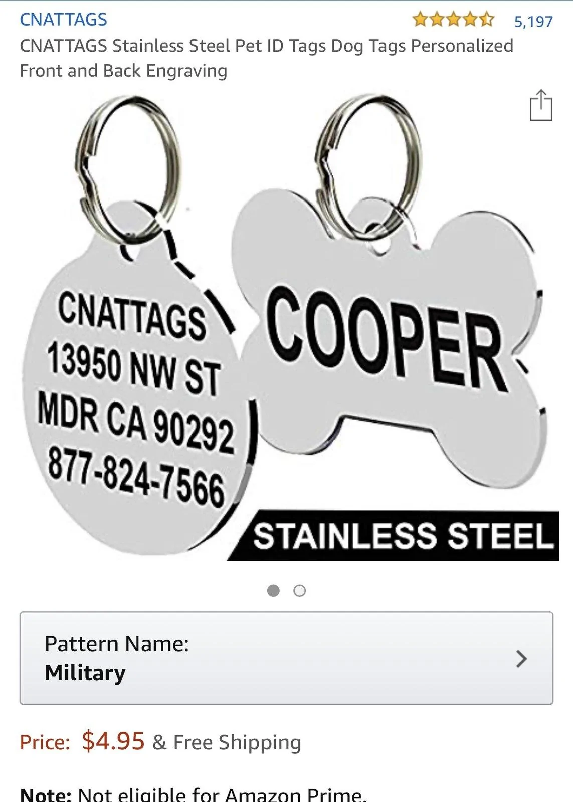

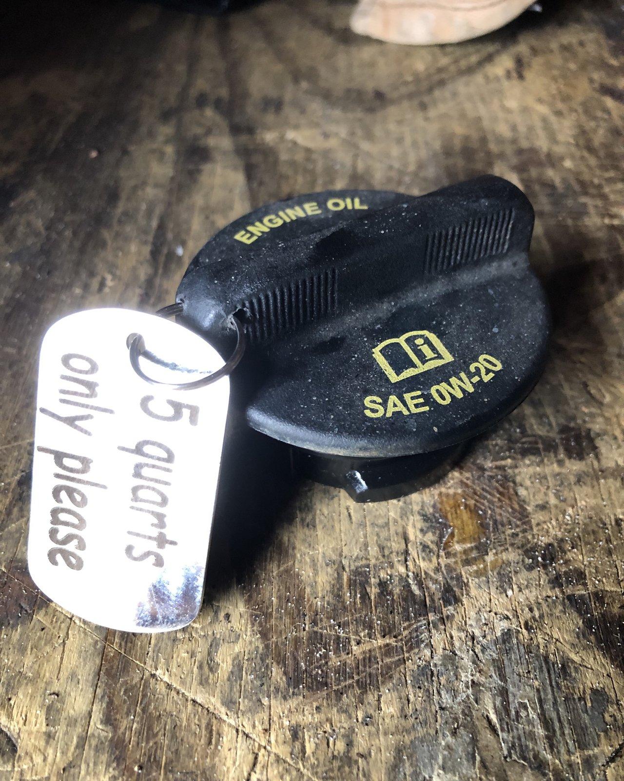

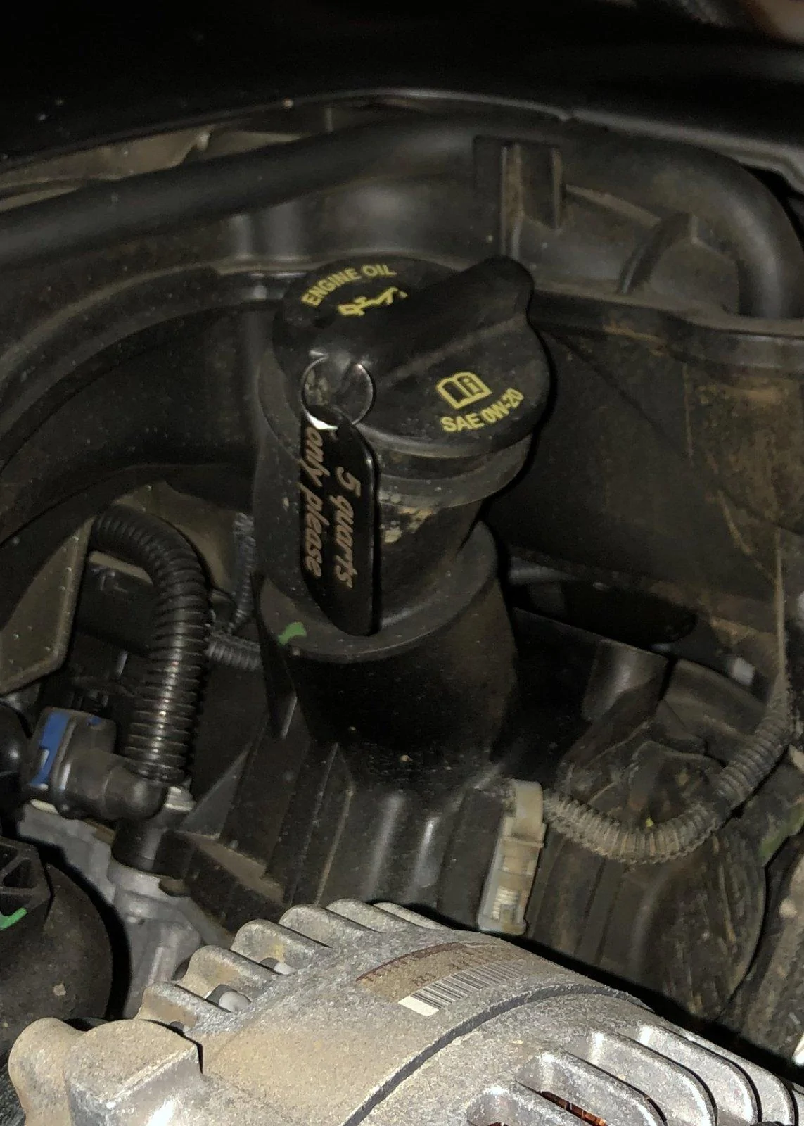

I change my own oil now, but for my freebies I did this......
worked great.... $ 5.00 on Amazon, by far my cheapest and easiest, but most effective mod so far. Also it’s for me, since I change my oil in my ram work truck, same engine but takes 6 quarts... :facepalm:.....:).
link please?

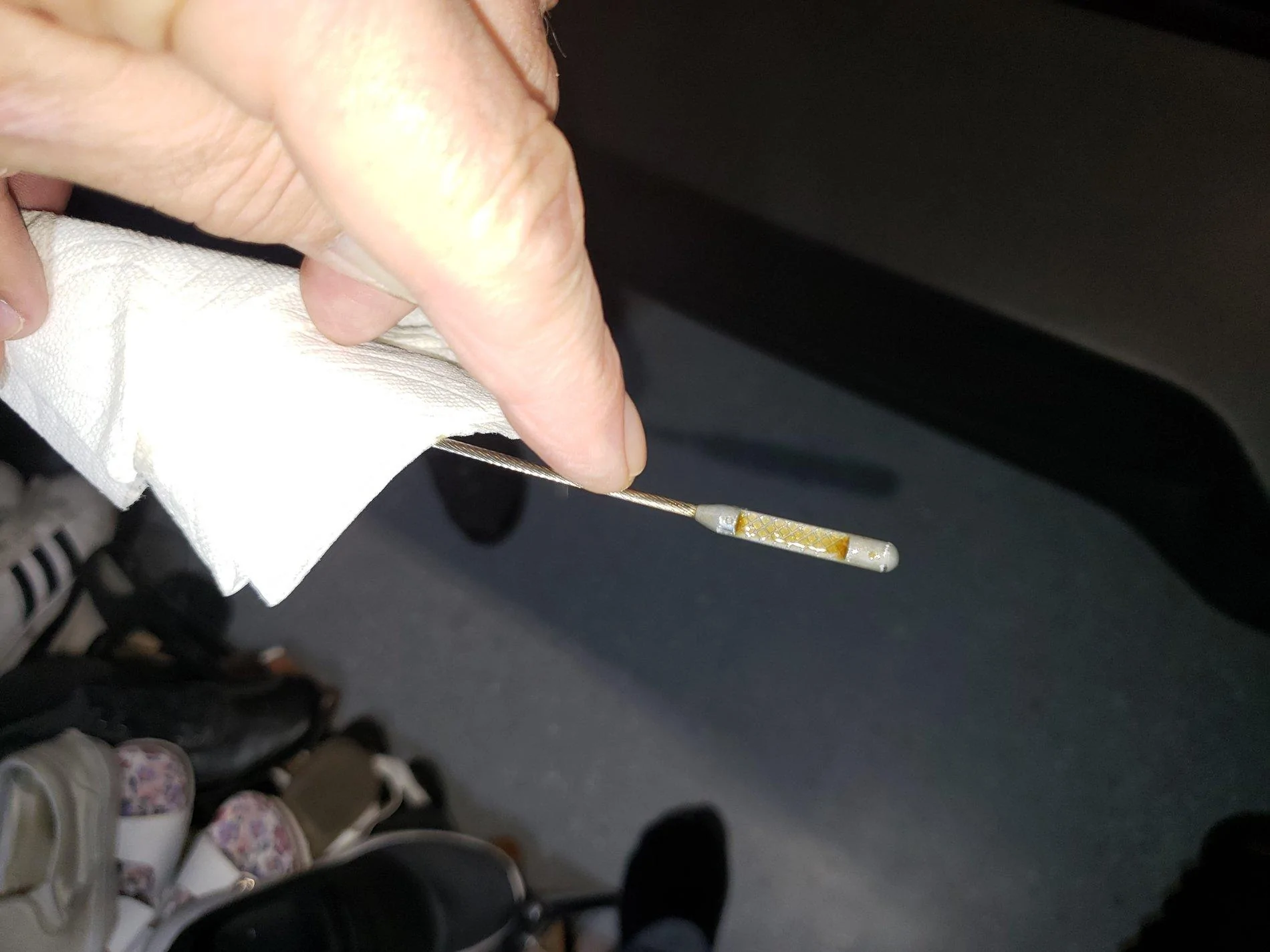

It's over the limit. I'm going to have to drain it.
I finally got some calls returned. They're saying the paperwork is incorrect and that they really put 5 quarts. I checked the dipstick and according to the picture, they're just lying to me at this point.
I did remove oil that night and it's at the top level of the dipstick. I'll take advantage of the free oil changes but will double check again next time.
