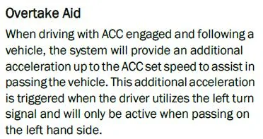

Using the turn signal during adaptive cruise bypasses the vehicle in front of us. Could that be what you felt?

This answer makes more sense than mine. I didn't think of it, because I don't have that system on my Wrangler. If you had the cruise control set, but adaptive was restricting your speed, putting on your turn signal will return you to your set speed and close the gap with the vehicle in front of you.

Very, it's a mixed bag and is frustrating some times.
EDIT: Note, I would think there are more prerequisites than just the blinker, but it's certainly repeatable. It only occurs when you are prevented from making set speed by a vehicle already.

It is watching for that, from the FSM:
Using those same inputs, the DASM also allows for an overtake event to occur. When the host vehicle is trailing a slower moving object and the host driver activates the turn indicator, the DASM applies additional amounts of acceleration while still trailing the object vehicle to aid in a lane shift maneuver. In locations with left hand drive traffic, overtake aid will only be provided on the left hand side. The same applies for the right hand side. The DASM is able to determine the direction of traffic flow by observing oncoming traffic. The DASM will disable overtake aid if the DASM detects an object in the lane the vehicle is attempting to move into in order to pass the slower moving object vehicle. The overtake aid also disables or will not assist if the host vehicle is equipped with a Blind Spot Monitor (BSM) system that is currently detecting a vehicle in the blind spot of the host vehicle.

FYI I have had this alot of times. Cruise is set to 75, I am behind a car going 70. As soon as I see a clearing, I put my turn signal on, and the Jeep speeds up to enter the left lane. It doesn't wait until you enter the lane, it starts speeding up the instant you put on your turn signal. Gotta keep an eye on that.
