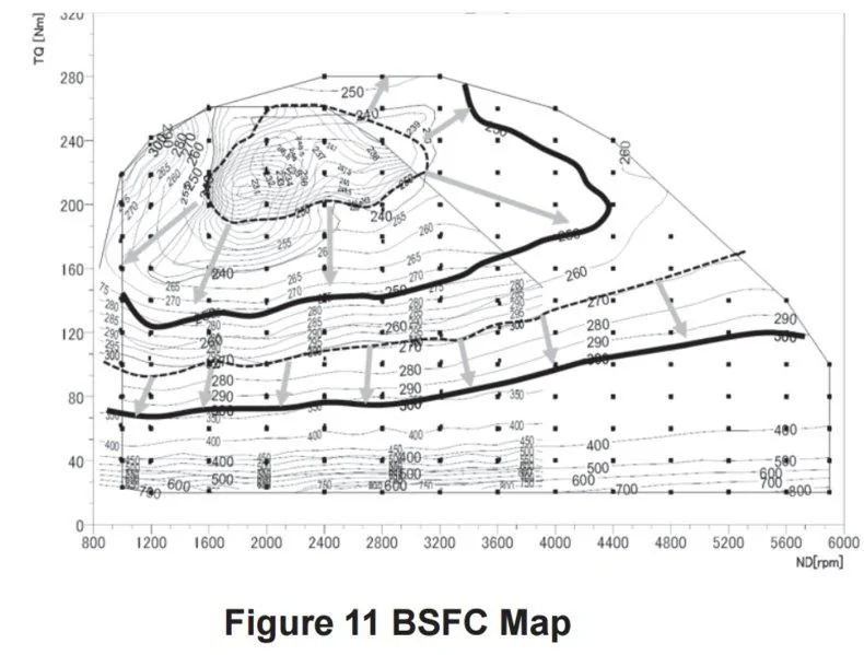

And also add in your 4.10 gears and bigger tires to the mix as well. Your engine will be running about 15% higher RPMs at an equivalent speed with a sport or Sahara.The gap between Rubicon and Sport is like 300 lbs, or about 7%. That should mean a roughly 7% impact on city MPG, for a 1-2 MPG city MPG penalty. Not to mention the increased aero drag due to lift/fenders/tires/etc probably causes a similar or greater highway MPG penalty.
I get the fact that the Rubicon will get less per gallon than a Sport will but not by as much as you're thinking.
